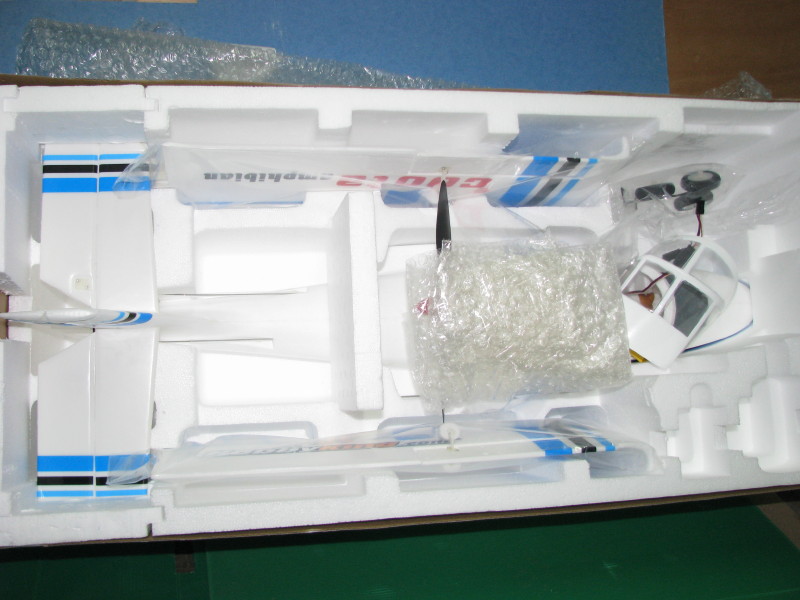

So here it is, the box standing on my desk.
The box arrives very well packed, everything well protected, no shipping damage.
Instructions are not included in the box, but you find one in the HOOBYKING site under the file section of the COOTA.

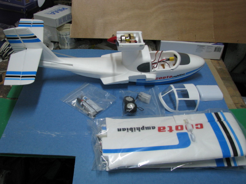

ASSEMBLY:
I don’t know if 10 minutes of preparations is called assembly, but this is the time it needed.
No need to have any tools, no screw driver or pliers, just packing tape
Let's start …

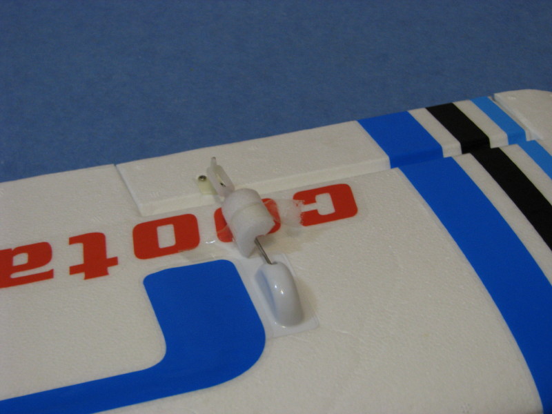

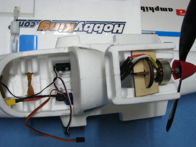

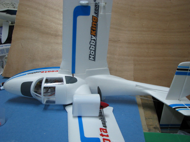

Get rid of the extra foam on the wings and below.
(Advise) connect lead (not included) to the servo connectors and push them to the holes on the fuselage and connect the ailerons servo in order to make the connection easier later.
Glue the wings with the supplied glue (the glue is good!!!) , be aware it is dry fast ,
Mix a little amount from the two tubes together and spread it on the wing route
Open the Clevis of the ailerons and elevator, move/play the surface up and down in order to release point that the glue holding,
Then move the Clevis one hole down in order to increase the movement
Close the cowl with packing tape (don't count on the magnets).
Close any point that water can come in.
קובץ מצורף 36934 קובץ מצורף 36935 קובץ מצורף 36936 קובץ מצורף 36885 קובץ מצורף 36937 קובץ מצורף 36938 קובץ מצורף 36939

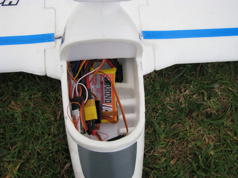

CENTER OF GRAVITY
Check nose weight existence.
Due to historical reason this plane designs for: NI-MH 8.4V, 1000mAh Battery so this nose weight was needed.
But if your nose weight is missing don’t be upset, you can use 2200mah Battery.
Otherwise use batteries 3s 1000 to 1300mAh lipo.
Locate the batteries as far back that you can.

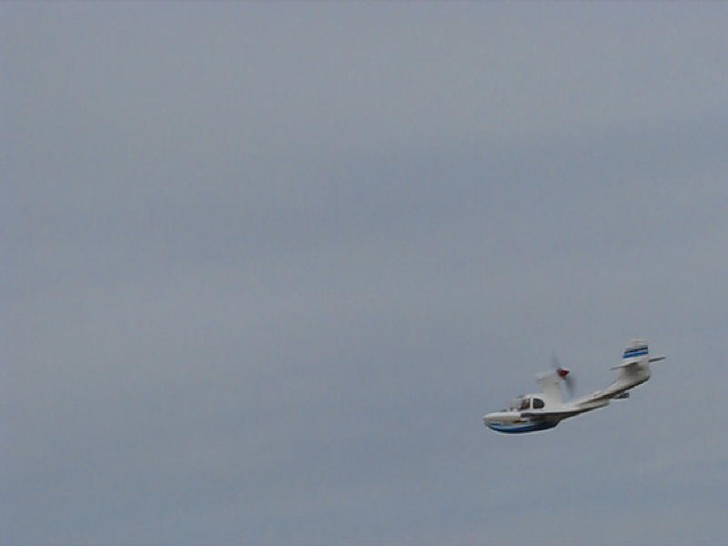

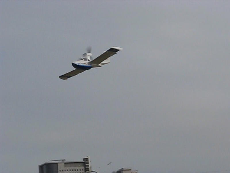

FLYING
Feeling during flight
"Fall in love" will describe my feeling .
The COOTA have Wide envelope of flight, I didn’t feel that the COOTA is twitchy or on the edge, also on all of my maneuvers, I didn’t felt for a moment that I was losing control.
קובץ מצורף 36944 קובץ מצורף 36943 קובץ מצורף 36889 קובץ מצורף 36888

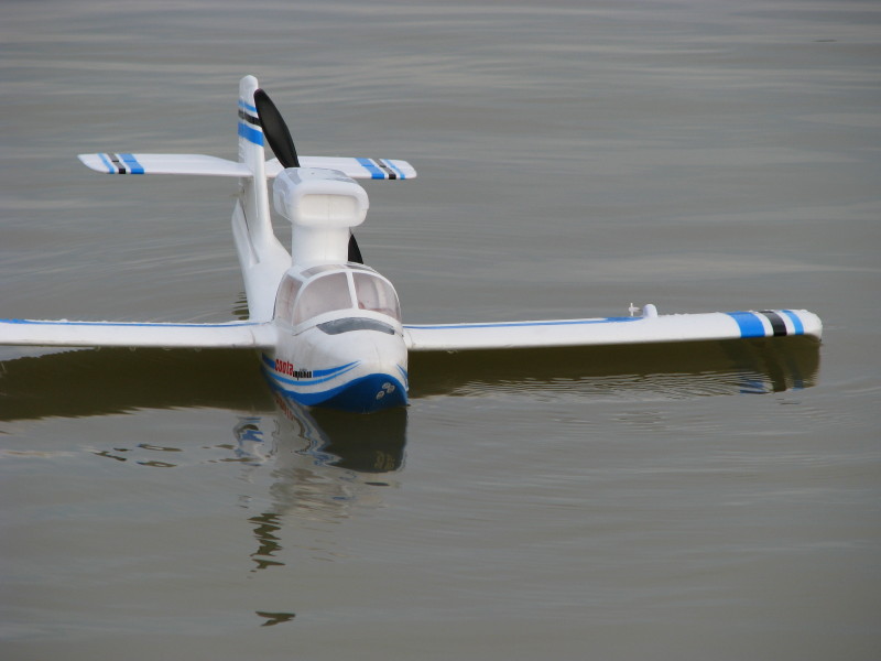

Taking off and landing

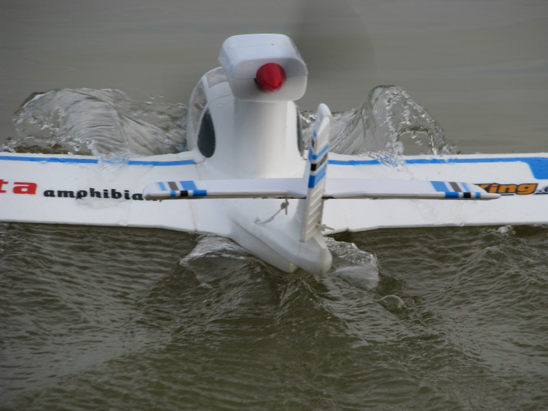

Keeping wing level, I starting to roll on the water smoothly pulling
The up stick till it reaches my stomach
Increasing the throttle until it leaves the ground in a way that just a "scale" plane can give.
קובץ מצורף 36887 קובץ מצורף 36948 קובץ מצורף 36949 קובץ מצורף 36950
