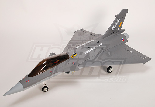

The chosen plane was the Newly Park Flayer EDF "Rafale" which comes in a form that I call MRF - "Mostly Ready To Fly
The kit is manufactured by FMS - Shenzhen Famous Electronic Tech Co. LTD
Specification:
Wing span 660 mm
Length 1000 mm
Weight 610 gr (with 1300 mAh battery)
Channels 4
Servos 9g 1.3 KgxCm 0.12S/60 Deg
As the kit is 97% pre built (according to the site) it takes short time to Assemble and setup

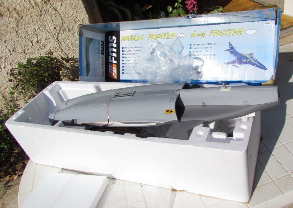

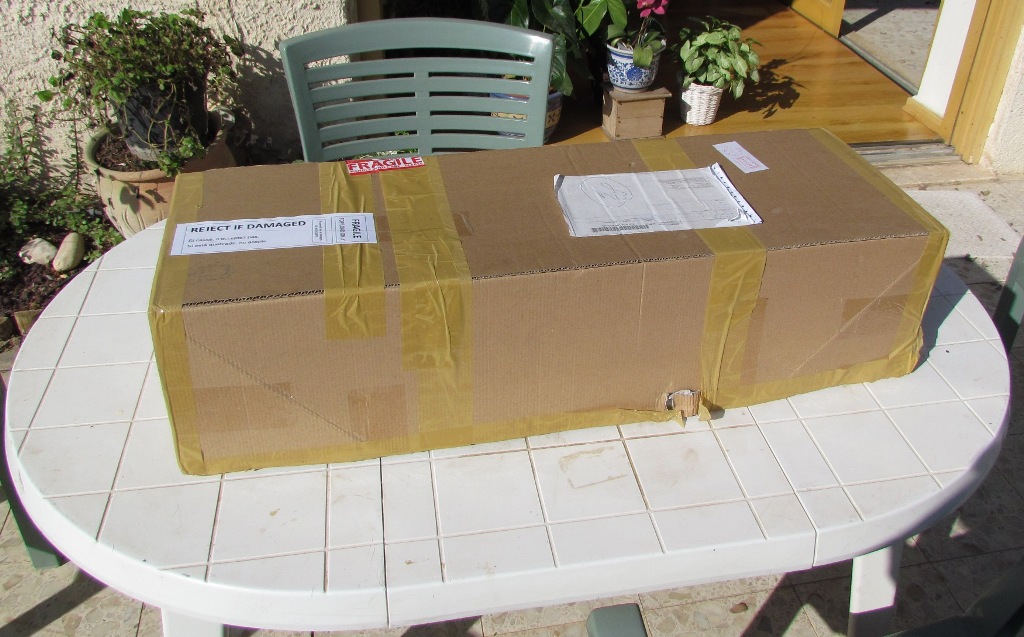

The box came in shortly after
The Box is big, but the weight is surprisingly light, Mail handling of the box made some dents
but the inside was in tucked :

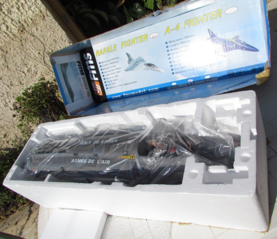

Unpacking the box:
Opening the box reviles a nicely packed almost finished plane
All parts were nicely packed and guarded by EPO cage and nylon wrapping.

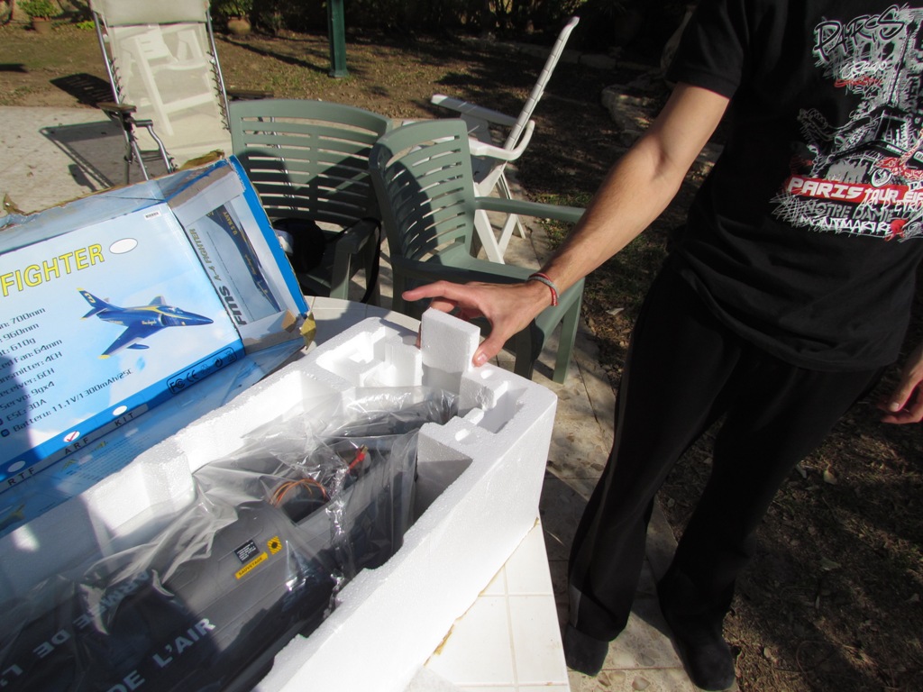

The body of the plane was locked to place by a block of EPO that locked the nose to the side,
Lift it up to loosen the body from the box (see attached picture)
קובץ מצורף 37416

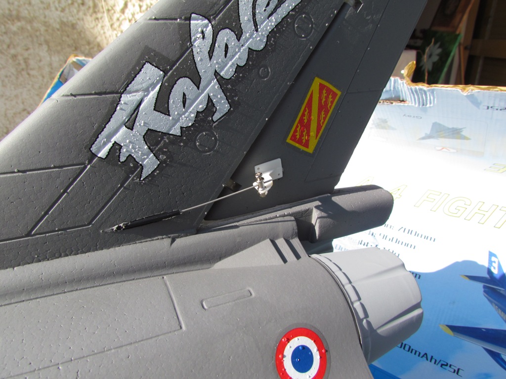

קובץ מצורף 37436
Make sure alignment and matching of the wings and the rudder to the body by positioning the parts in place
Note: the Rudder connecting rod has a
small tube installed in order to safeguard the rudder during installation
קובץ מצורף 37443 קובץ מצורף 37418
Make sure you know how to insert the rudder and don't forget to loosen the rudder hinge bolt so the rod will enter it during installation
