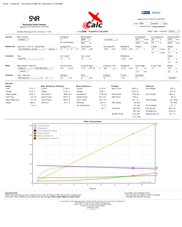

here is an option and calculation that will give you approx 8 min mixed flight with a 13 by 8 electric prop. as you can see
it will give you a nice 100 watts/pound and a nice static and Stall thrust.
Good flying
