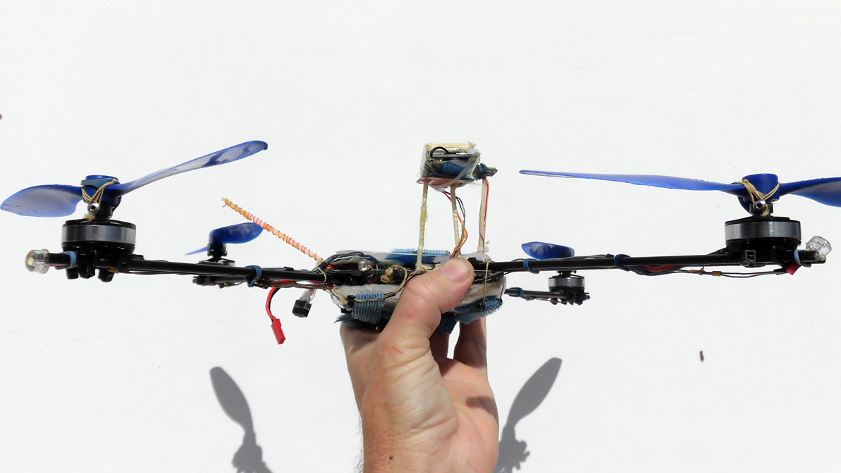

ALL-IN-ONE central plate holds arms and rest of electronics
today flew the new quad with 2d gimbal AUW under 0.5kg
https://www.youtube.com/watch?v=2jwK85V0rHw

אפשר בבקשה הסבר איך מורכב גוף הרחפן?
Could you please send a photo of it to see how its assembled?

can you write all the set up of the quad?
waht are the parts that the quad is made of?
תגובה: בניית רחפן קל ולא מסוכן
this video starts w/ central plate close-up
https://www.youtube.com/watch?v=OUWv-Lj3oig
