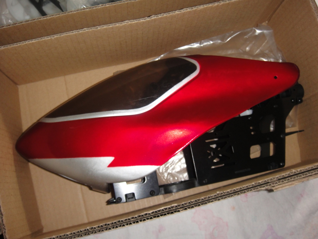

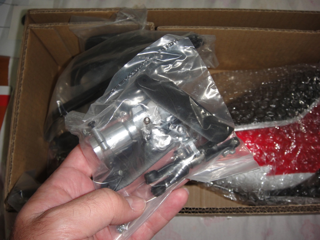

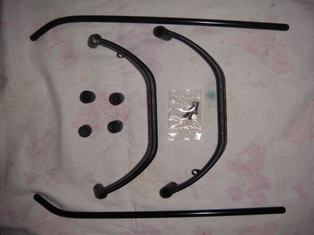

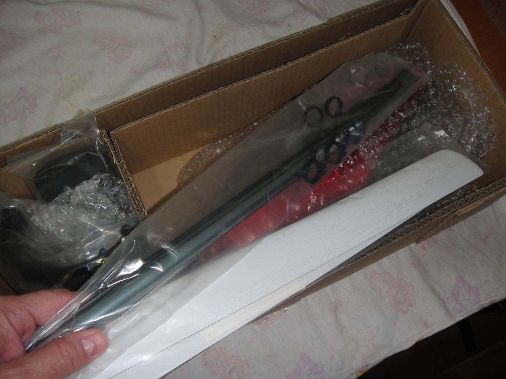

    So, I will begin with a quick look of what’s in the box and the chosen setup for this project.
    The box internal is divided to 3 areas. The biggest contains the main frame and the canopy. Additional area is for most of the smaller parts such as the rotor head, tail case, skids and all other hardware parts. The third area contains the boom and the torque tube, tail boom support rods and the main blades. When opening the box, it is clear that this heli comes more then 80% pre assembled already. The main frame and the rotor head comes completely assembled. Also the tail case with its gearing is pre assembled. One missing item which probably should be considered to be added is an instructions manual. Although most of it comes pre assembled, for a beginner it might be necessary to add such manual.
    By observing the parts from the first impression it seems that they are made of good quality!
    Especially the CNC parts of the rotor head, the frame HW, the boom and tail support rods. All screws are made of great quality! No screw was wearied out.
    However, some other part seems that need a little improvement mainly the plastic parts such as the tail blades, the rudder stabilizer, the polycarbonate canopy and the flybar pedals that seems to be made more for a 450 heli and not for a 500.

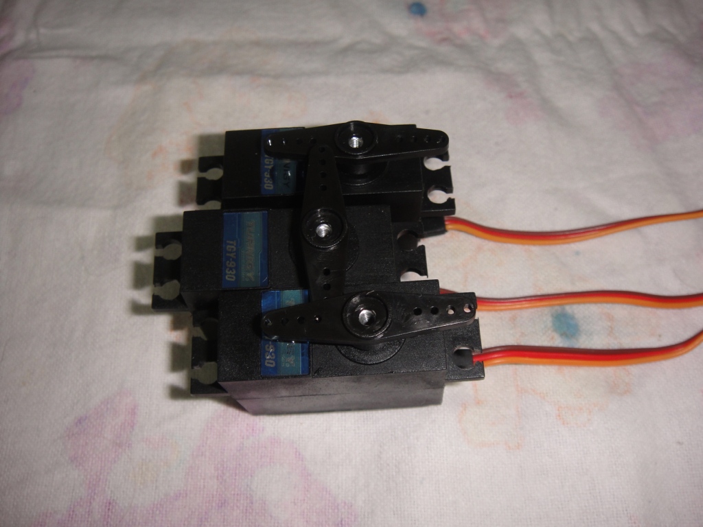

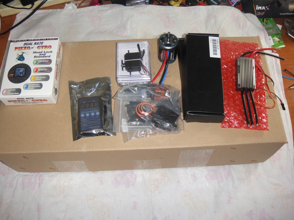

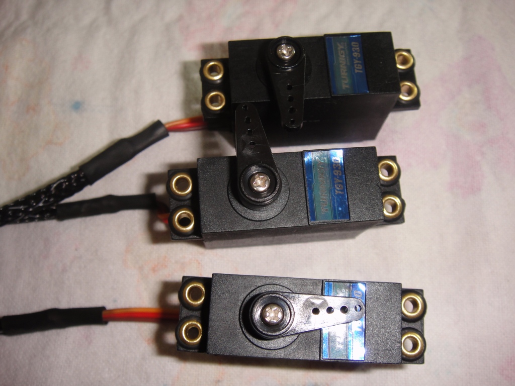

    As I mentioned, lets take a little look on the setup for this project
    • 3 X MG930 metal gear servo for cyclic
    • 1 X Futaba S9257 servo for rudder
    • Turnigy Typhoon 500H 1800KV Brushless motor
    • Turnigy brushless ESC 85A w/5A SBEC + programming card
    • Turnigy Piezo Headlock Gyro.
    • 2 X NanoTech 3 Cell 2650 Mah/25C LiPo batteries which will be connected in series

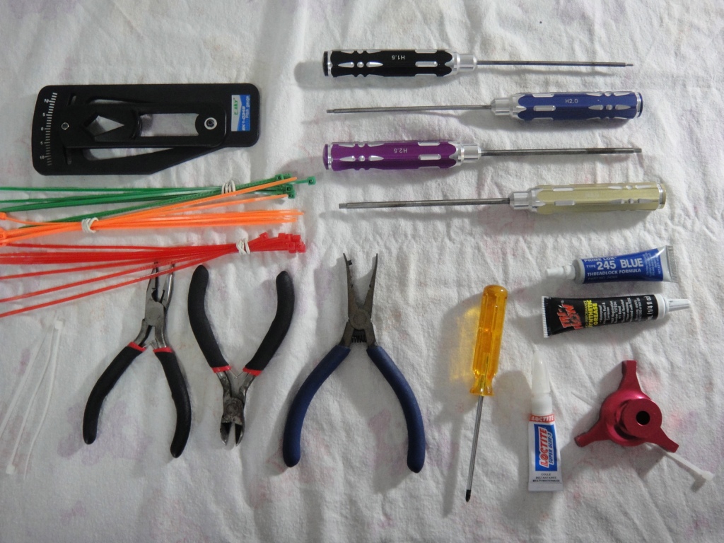

    Before beginning the assembly, it might be necessary to prepare the designated tools which all RC flyers should have and will be used for this purpose:
    Allen screwdrivers
    Cutter and a long nose player
    Ball link remove tool
    Pitch gauge
    Swash leveler
    Loctite and grease
    Some protection sleeves and heat shrink tubes and tie wraps

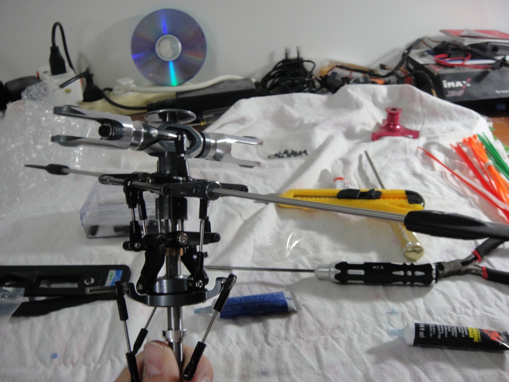

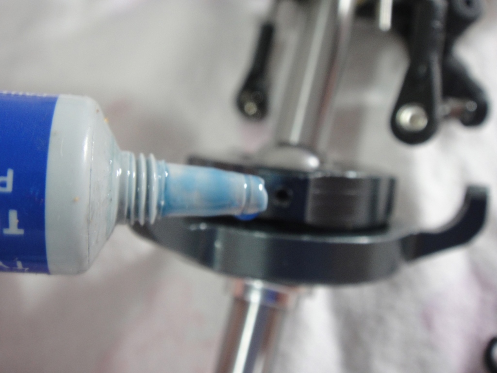

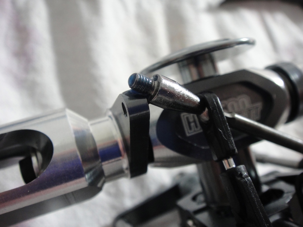

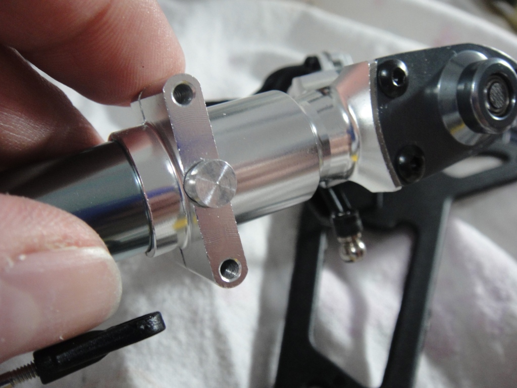

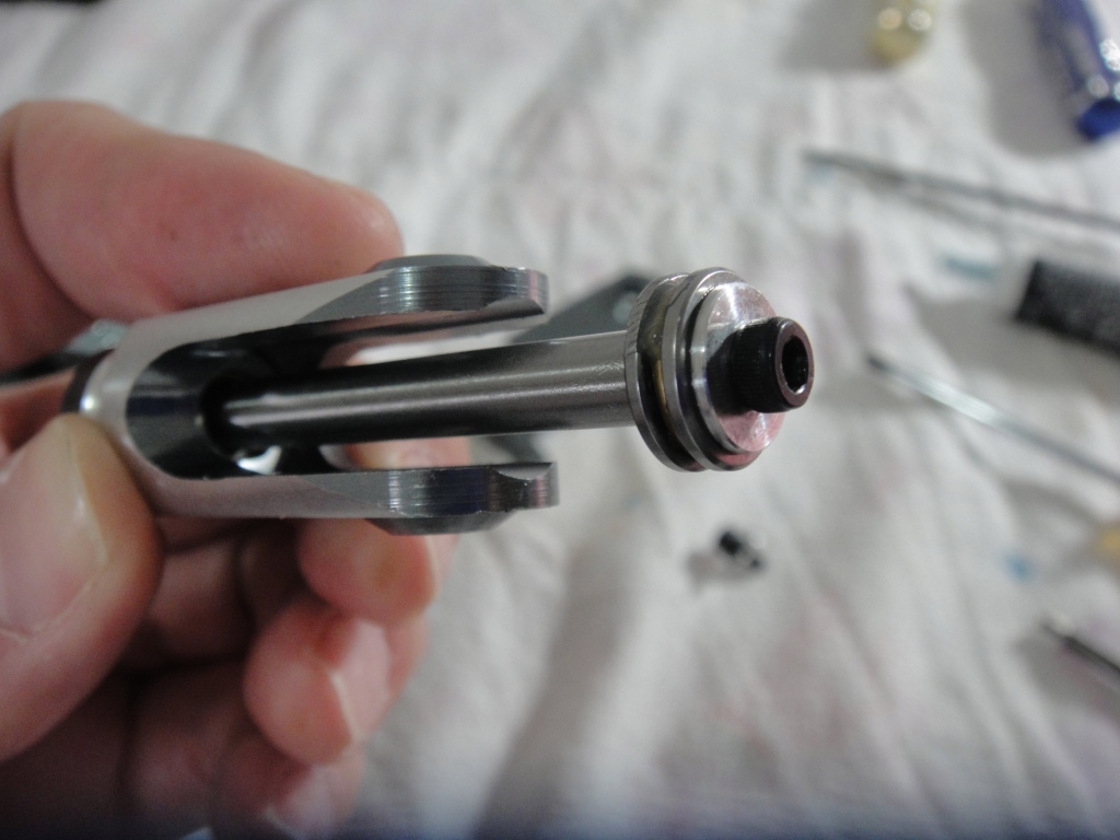

    Rotorhead Assembly

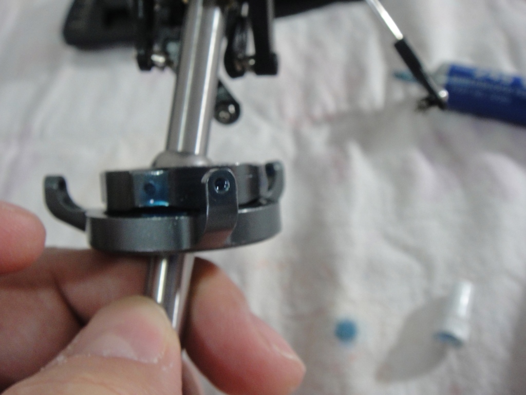

    I will begin the assembly from the rotor head. Although the rotor head comes completely assembled it is extremely recommended to check all metal to metal .screws for loctite
    Therefore, each and every screw will be opened and applied a bit
    In general, almost all the rotor head made of CNC and metal. The part quality and accuracy is OK.
ID:	37842Click image for larger version.
ID:	37843Click image for larger version.
ID:	37844Click image for larger version.
ID:	37845Click image for larger version.
ID:	37846Click image for larger version.
ID:	37847Click image for larger version.
ID:	37848Click image for larger version.
ID:	37849Click image for larger version.

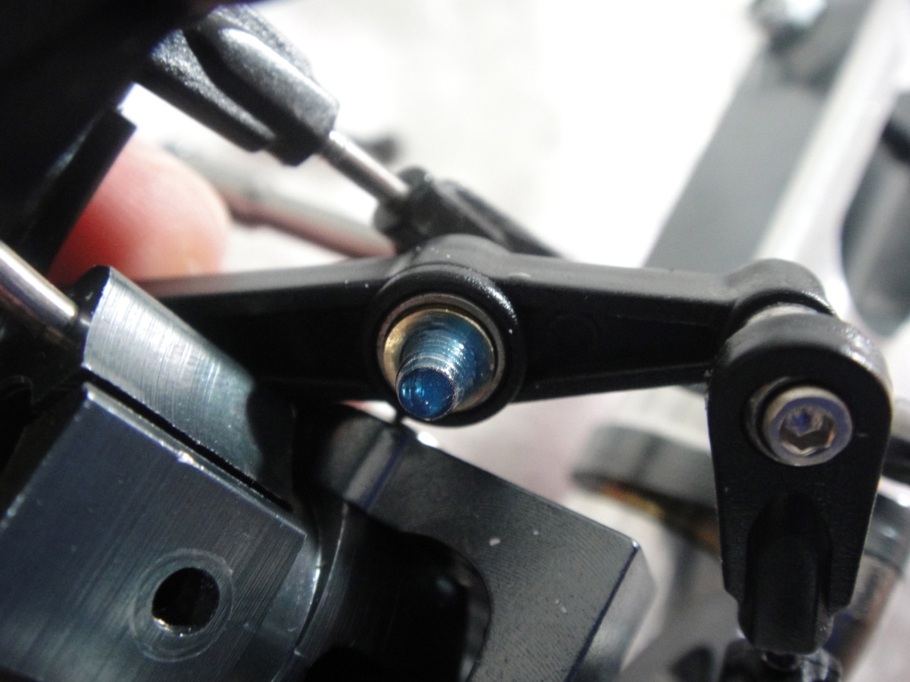

    Rotor head assembly summery

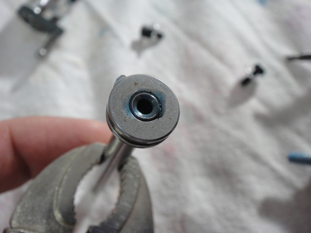

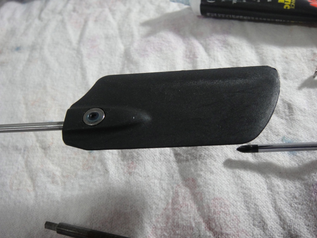

    During rotor head assembly there were found a few unexplained frictions in some parts that I couldn’t found where their source is..
    The flybar seesaw movement and also the blades grips movement weren’t freer enough.
    Also, as I mentioned before, I was a little bit disappointed from the flybar pedals size. They are small and maybe designed for 450 heli
    As a result of these founding I wonder how it will behave in flight.

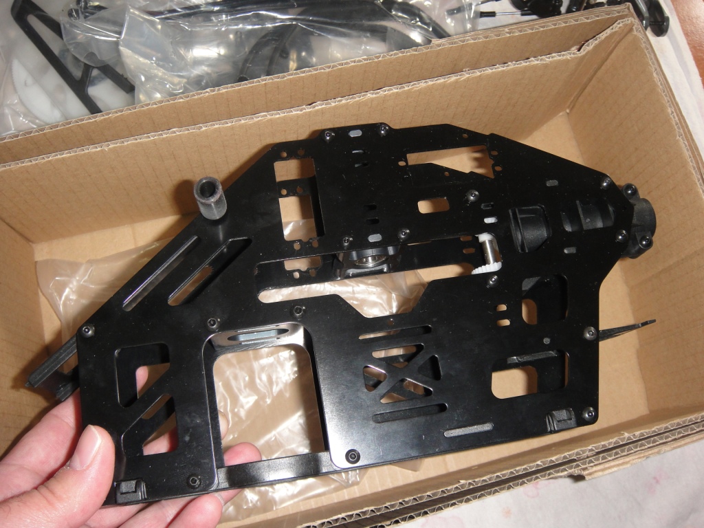

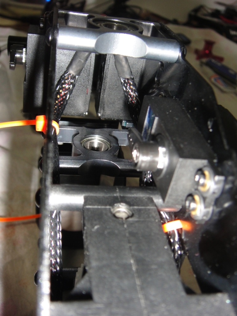

    Main Frame Assembly
    The next part will be the main frame.

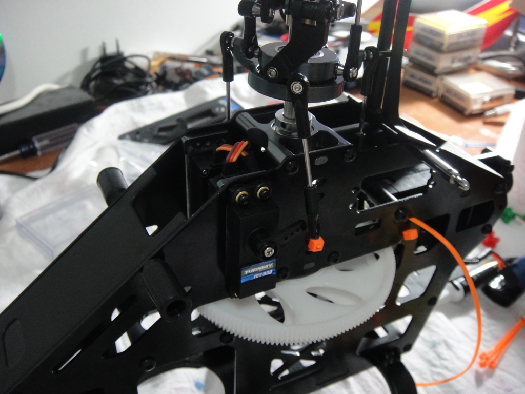

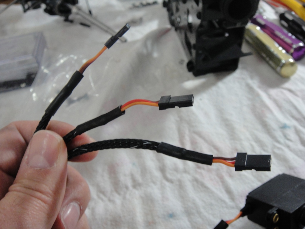

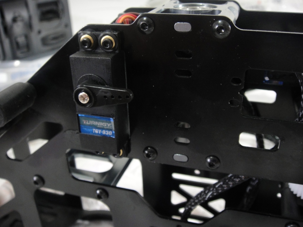

    The main frame comes completely pre-assembled! Although, before continue with all other parts, I would recommend to install the servos first before moving on to the rest! This will save us time because after putting all other part it will be difficult to route the servo wires inside the frame.

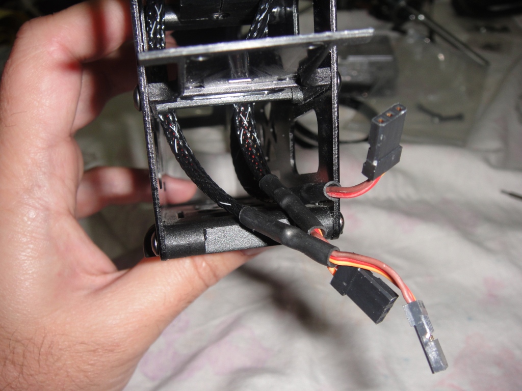

    Before putting the servos in place, I will cover their wires with protection sleeves and heat shrink isolation.
ID:	37851Click image for larger version.
ID:	37852Click image for larger version.
    Install the servos on the frame with the servo mounts supplied with the kit.
    Don’t forget to put loctite on these as well as they made of aluminum.

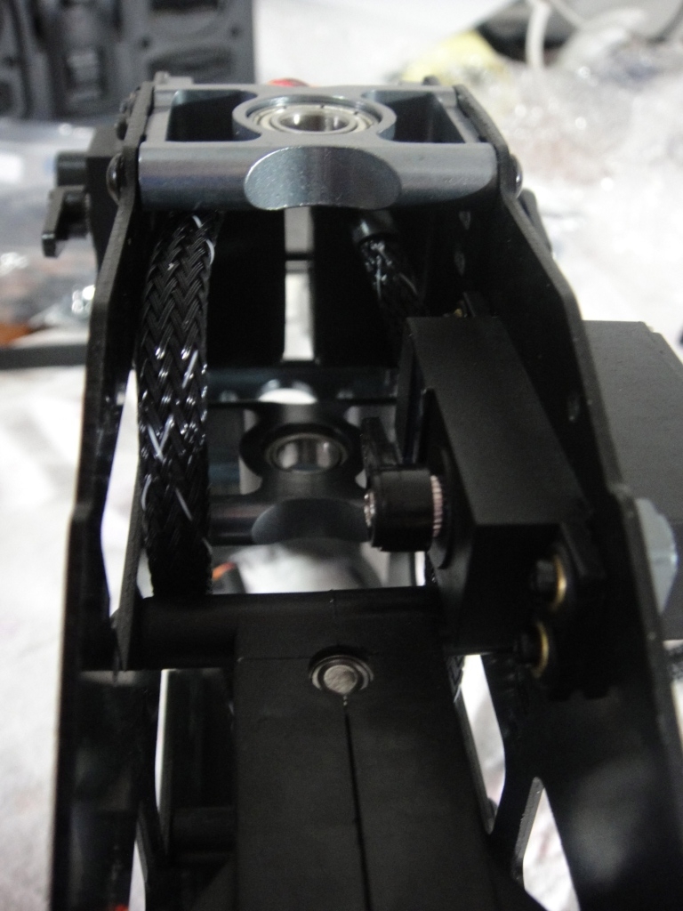

    Navigate the servo wires using tie wraps inside the frame all they way to the receiver mount tray.
ID:	37858Click image for larger version.

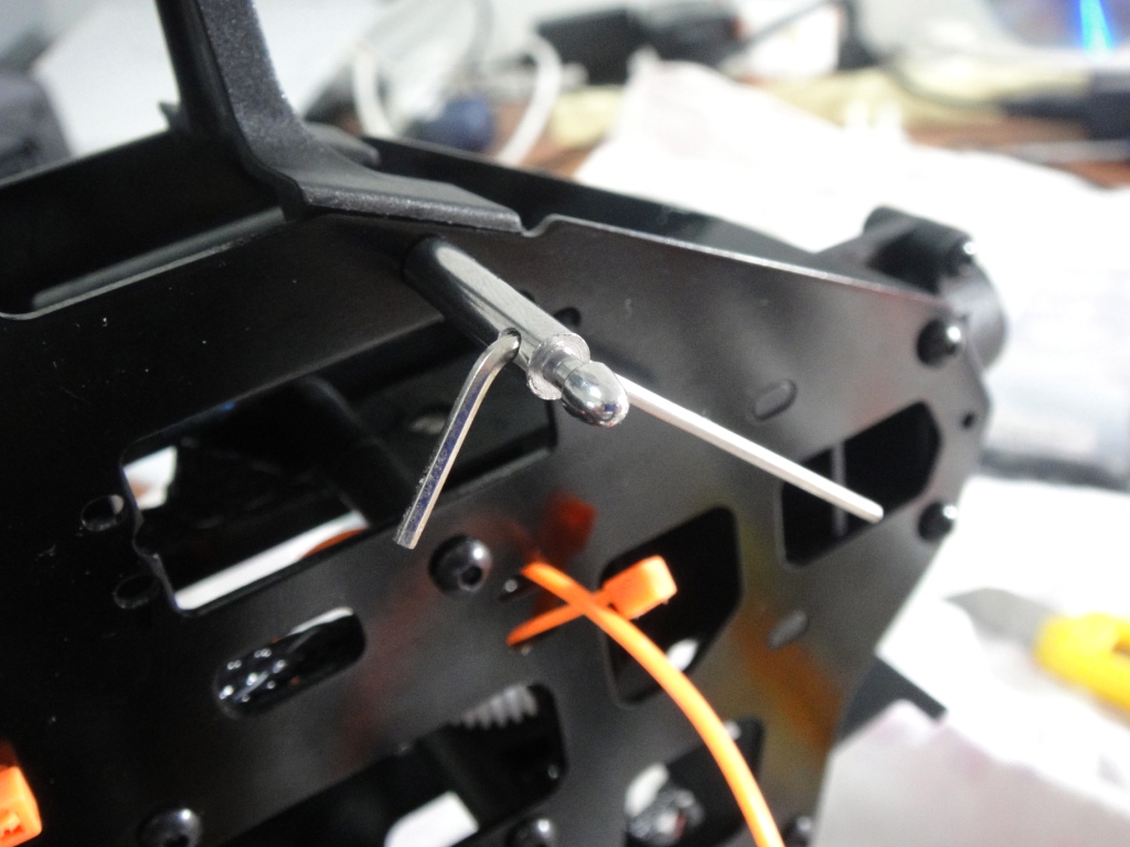

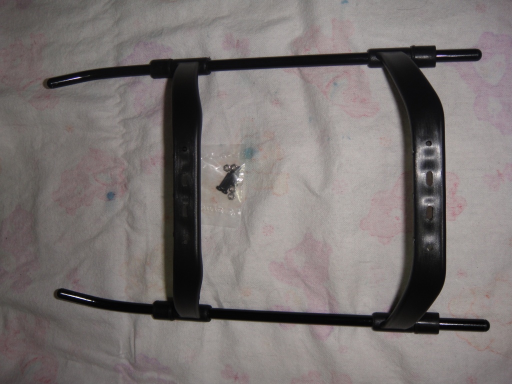

    After installing the servos on the frame, let’s continue with the rest of the frame assembly. Put the skids on it and don’t forget to apply some loctite on the screws that attach the skids to the frame.
    Install the canopy holders and the swash anti rotation bracket. All of these parts quality is excellent!
ID:	37860Click image for larger version.
ID:	37861Click image for larger version.
ID:	37862Click image for larger version.
ID:	37864Click image for larger version.

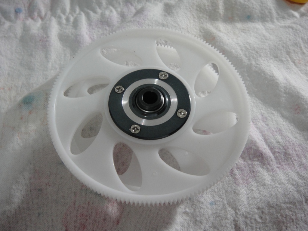

    Next, prepare the main gear for installation. Open the bag and check it. The quality of main gear parts seems to be great, makes it’s installation along with the main shaft and the rotor head easy.

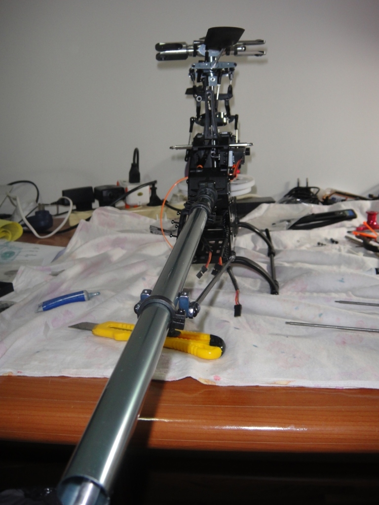

    Tail Assembly
    Prepare all parts and put them together.
ID:	37902Click image for larger version.

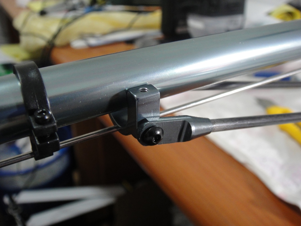

    Next, put together the tail case. Don’t forget to apply loctite on all screws here as well!!
    Adjust the tail case using the adjustment dowel to fix the case orientation. Actually this part of the assembly was a littlie bit of struggle to do.
    I guess the accuracy of this little dowel can be better.

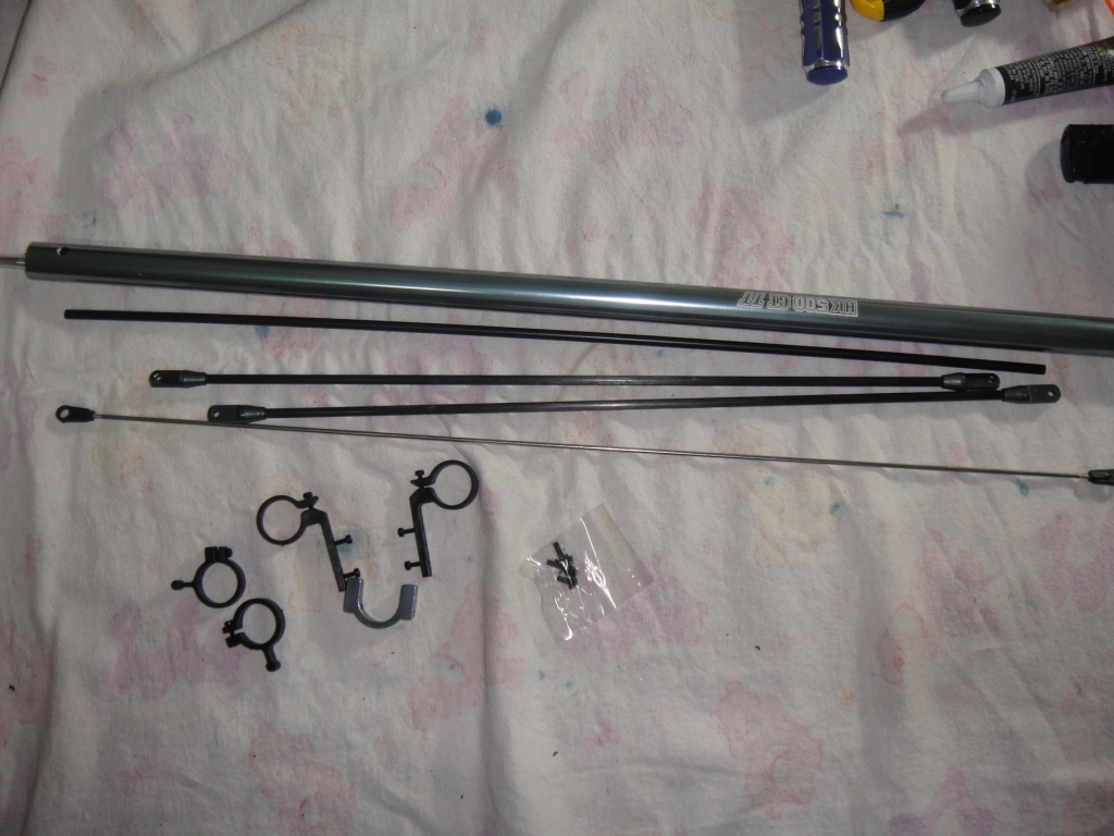

    Next, attach the plastic rudder and the horizontal stabilizer and the boom support rods.
ID:	37904Click image for larger version.
    Motor Setup
    First, put the pinion gear. Don’t forget to apply loctite on the pinion mounting screw.
    At this point, I will suggest disengaging the motor from the main gear until programming and checking the ESC.
ID:	37955Click image for larger version.

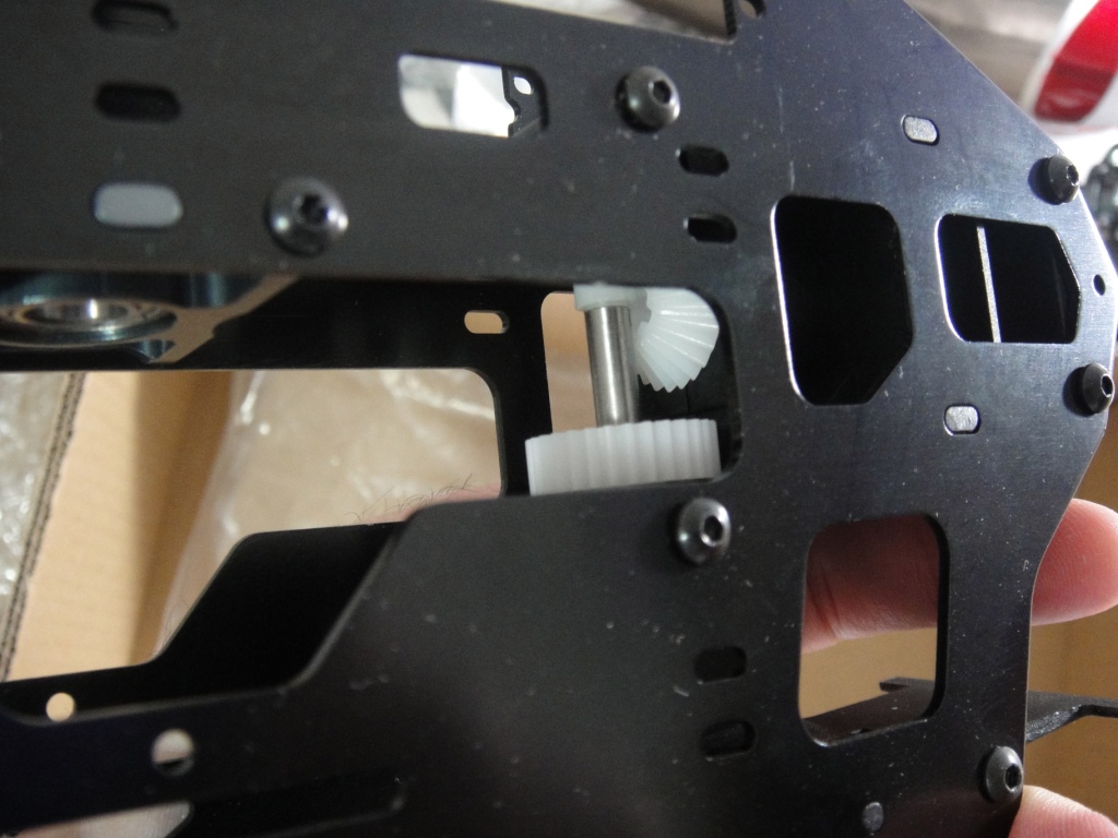

    At this point the heli is 90% assembled!
    Unfortunately, at this point another friction was discovered..
    When turning the rotor head manually it is clearly that something is catchy…
    I tried to check where can this friction comes from and found that the source of it comes from the one way bearing.. I tried to apply some grease on it but still the friction occurs it do the autorotation and it doesn't effect the motor .
    I thinks it can fly fine like this but autorotations but I won't try to do any auto rotations.
    I am quit sure that all these frictions will reduce from the flight performance that might have been given from this heli.
    To know the answer for this, let’s wait for the test flight and find out...

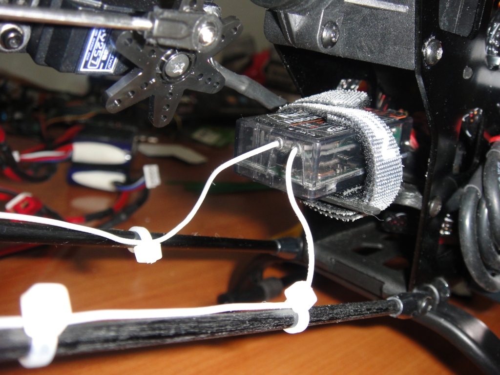

    The gyro, the tail servo and the ESC, mount the receiver and turn ON the system, starting with ESC programming, tuning the cyclic servos and rudder servo.

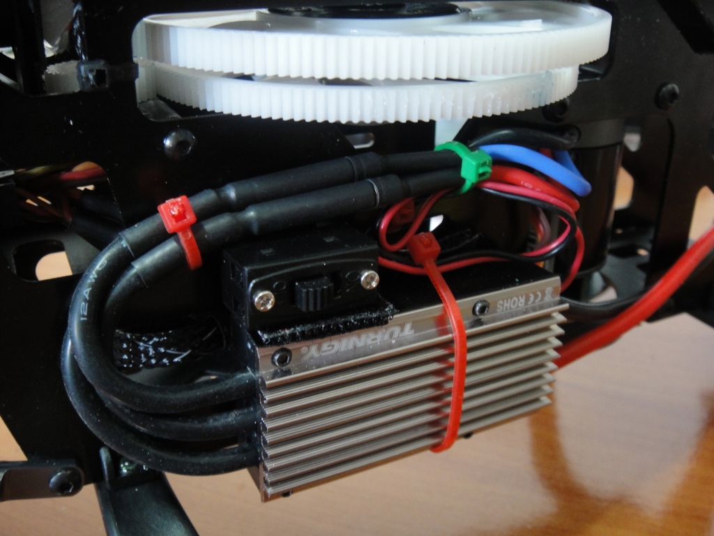

    ESC Programming:
    Well, the best way to program this ESC will be using its programming card. The ESC can be program using the transmitter but it will be much easier and faster to do so with its programming card.
    ESC Programming Video
    One nice thing that this ESC has is a power switch. This is quit useful!
    In general, the ESC seems to be nice and made of a good quality.
    However, the only thing I didn't liked about it is that the soft start function didn't worked at all..
    If you switch to Idle up on the ground by a mistake you better stay a way of the helicopter.

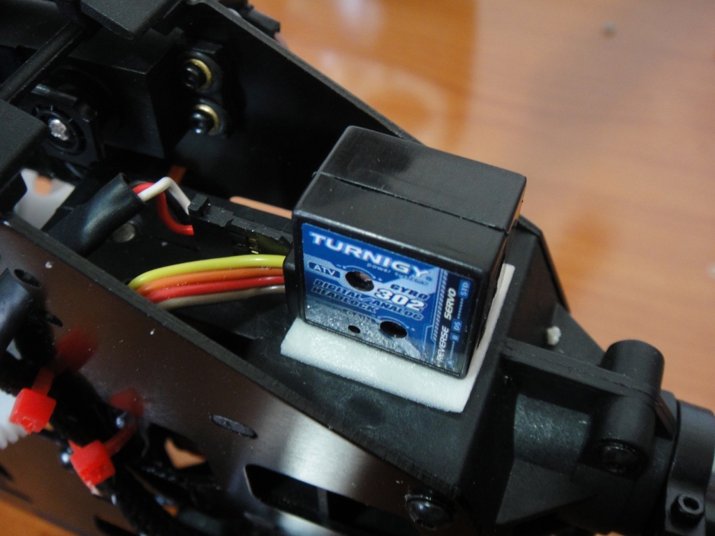

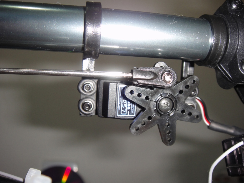

    Continue with the gyro and tail servo.
    The gyro installation was pretty easy and quick.
    Although, its setup is a little bit different then most head lock gyros that are popular today. This one required to inhibit any gyro sens menu on the transmitter and reduce ATV of rudder and gyro channel to 50%. Also, it will require using rudder trim during the setup.
    As I said, the setup was quite easy and quick. Lets wait and see how it will do in flight.
