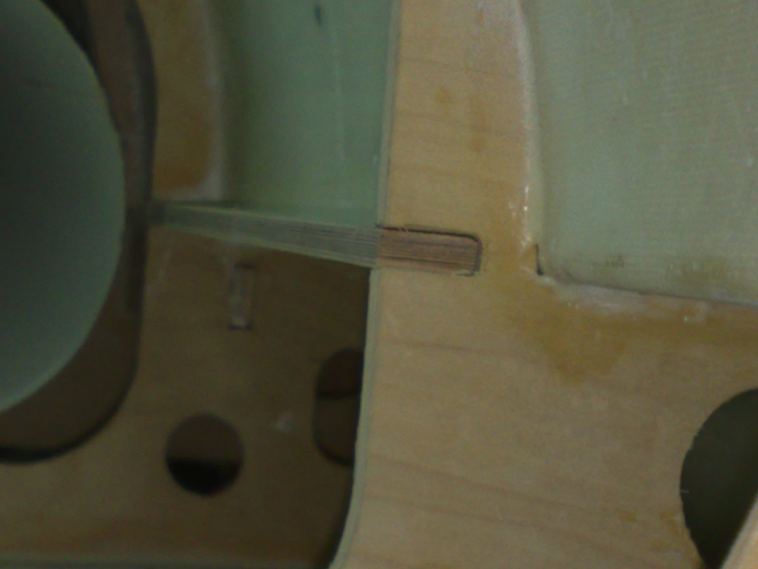

    Reinforcement of the rear stab support former..

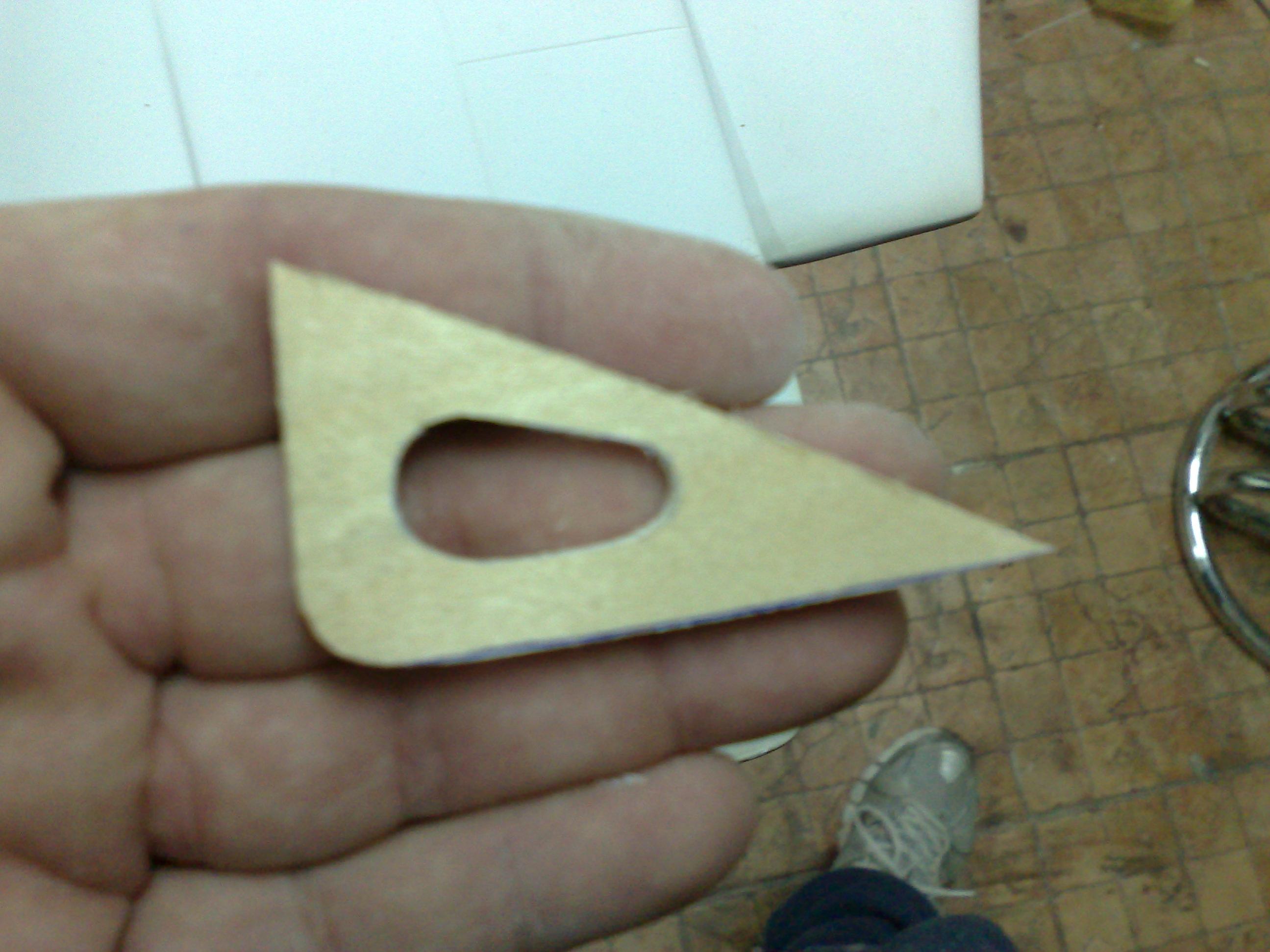

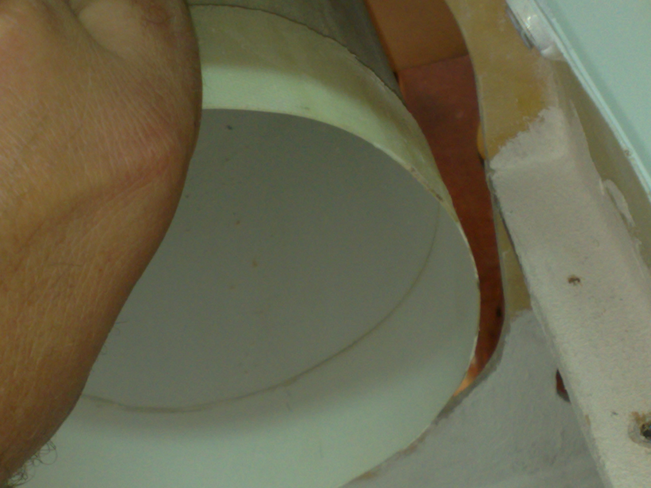

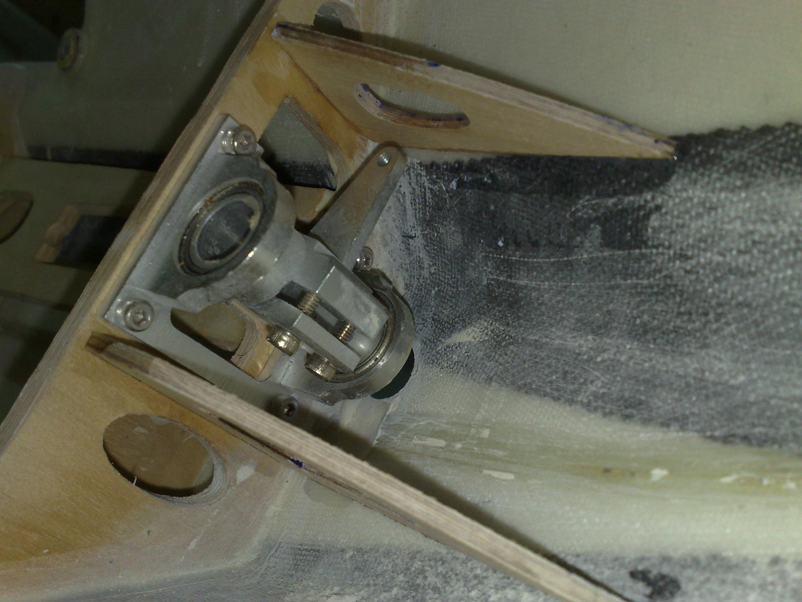

    More ..
    Inspection of former to fuselage glue joints.
Name:	F-14D project 005.jpg‏
ID:	20246   Click image for larger version.
Name:	F-14D project 006.jpg‏
ID:	20247   Click image for larger version.
Name:	F-14D project 007.jpg‏

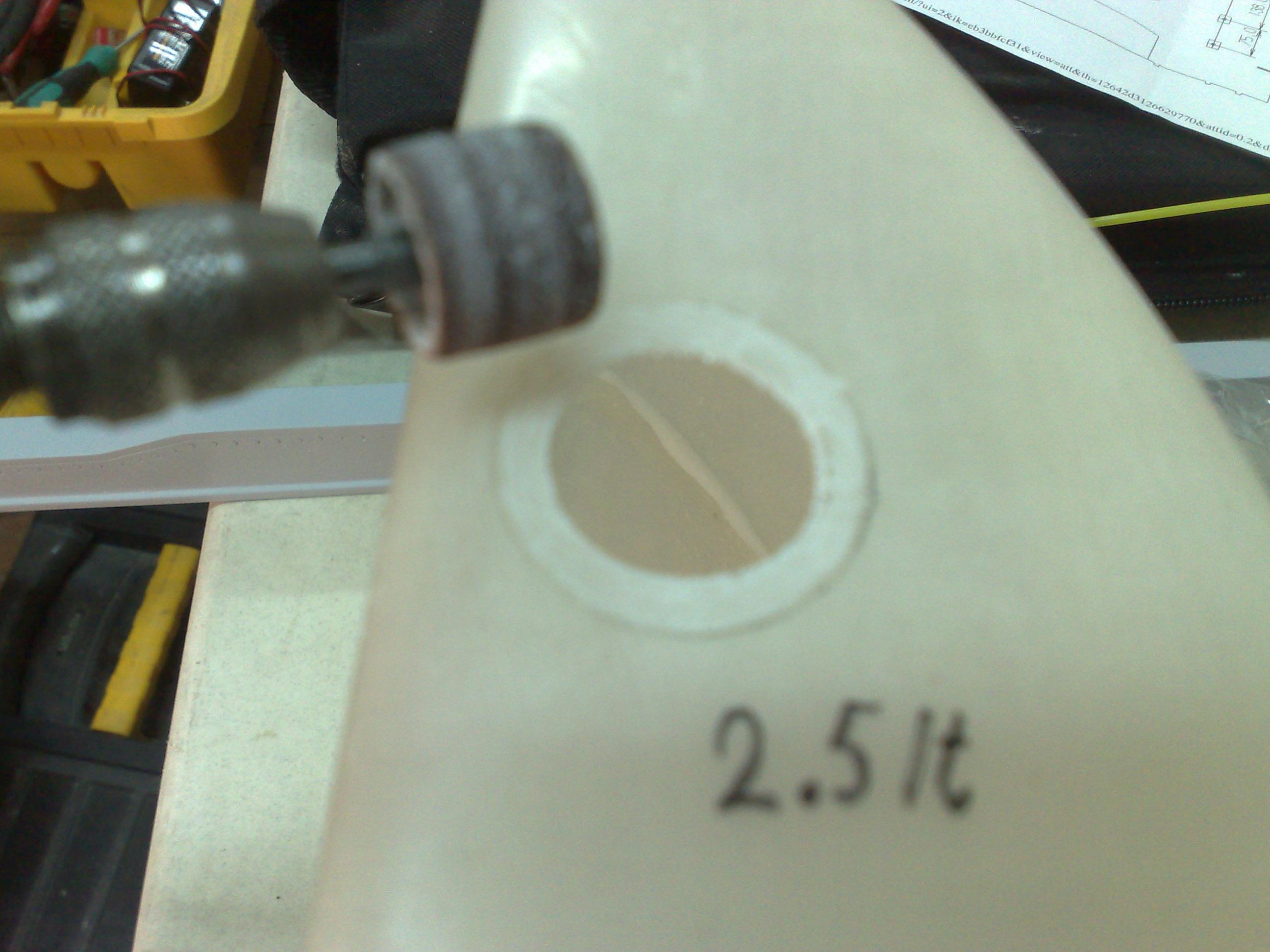

    More ...

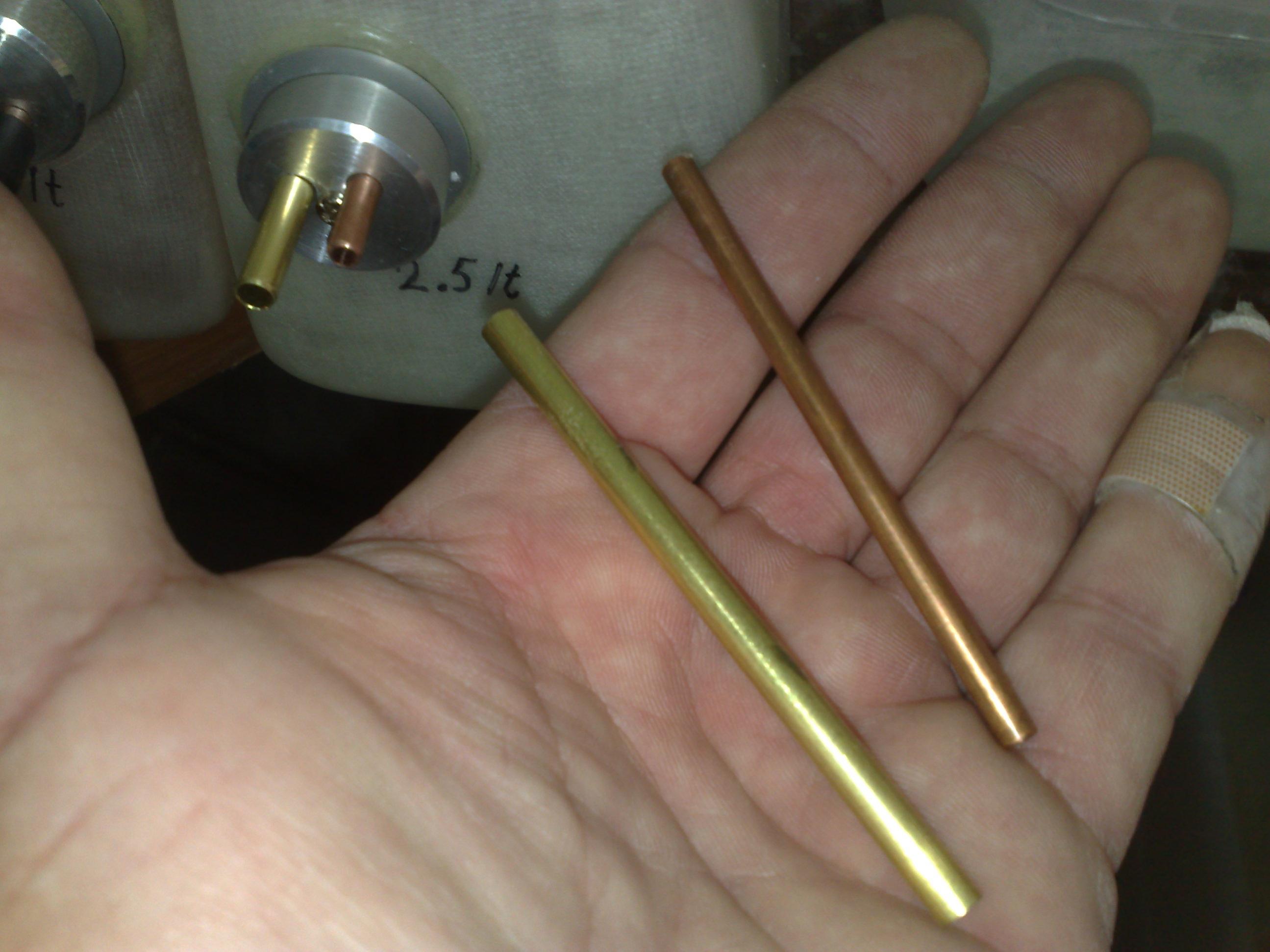

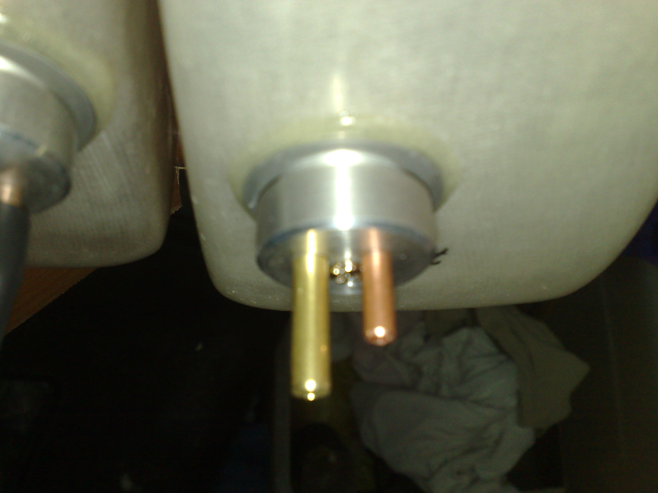

    Fuel tank preparation..
Name:	F-14 Twin engines fuel tanks preparation 001.jpg‏
ID:	20323   Click image for larger version.
Name:	F-14 Twin engines fuel tanks preparation 003.jpg‏
ID:	20324   Click image for larger version.
Name:	F-14 Twin engines fuel tanks preparation 006.jpg‏
ID:	20325   Click image for larger version.
Name:	F-14 Twin engines fuel tanks preparation 007.jpg‏

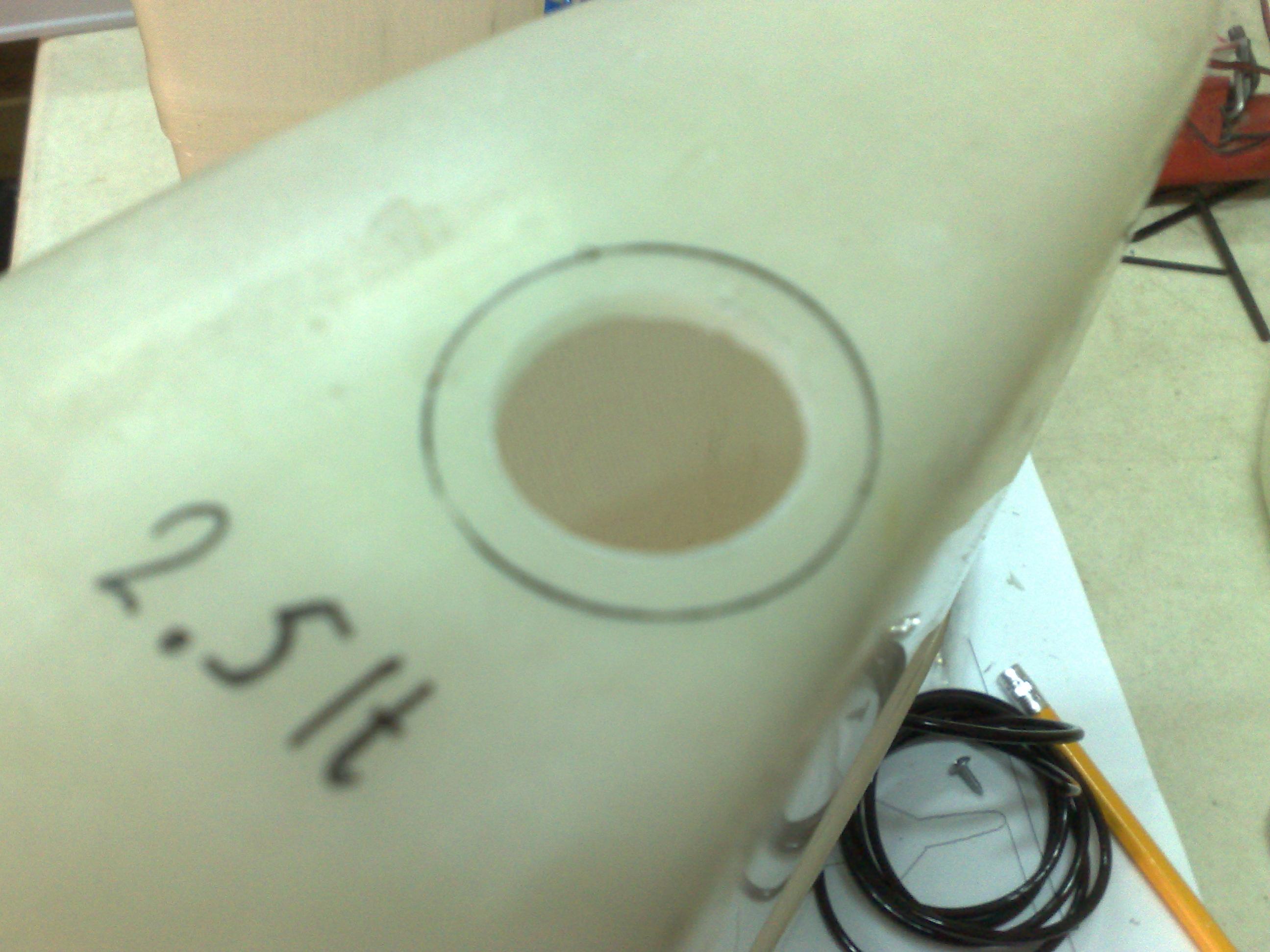

    more...
Name:	F-14 Twin engines fuel tanks preparation 008.jpg‏
ID:	20327   Click image for larger version.
Name:	F-14 Twin engines fuel tanks preparation 009.jpg‏
ID:	20328   Click image for larger version.
Name:	F-14 Twin engines fuel tanks preparation 010.jpg‏
ID:	20329   Click image for larger version.
Name:	F-14 Twin engines fuel tanks preparation 014.jpg‏
ID:	20330   Click image for larger version.
Name:	F-14 Twin engines fuel tanks preparation 013.jpg‏
    Dec 2009
    1,242
    הודה 46 פעמים ב 44 הודעות
    ברירת מחדל תגובה להודעה: F-14D
    Fuel system consists of three fuel tanks for ecah engine of
    one 2.5 lt ,one 1.75 lt and a small hoper tank for each engine
    This will allow for an estimated flight time of ~9 minutes

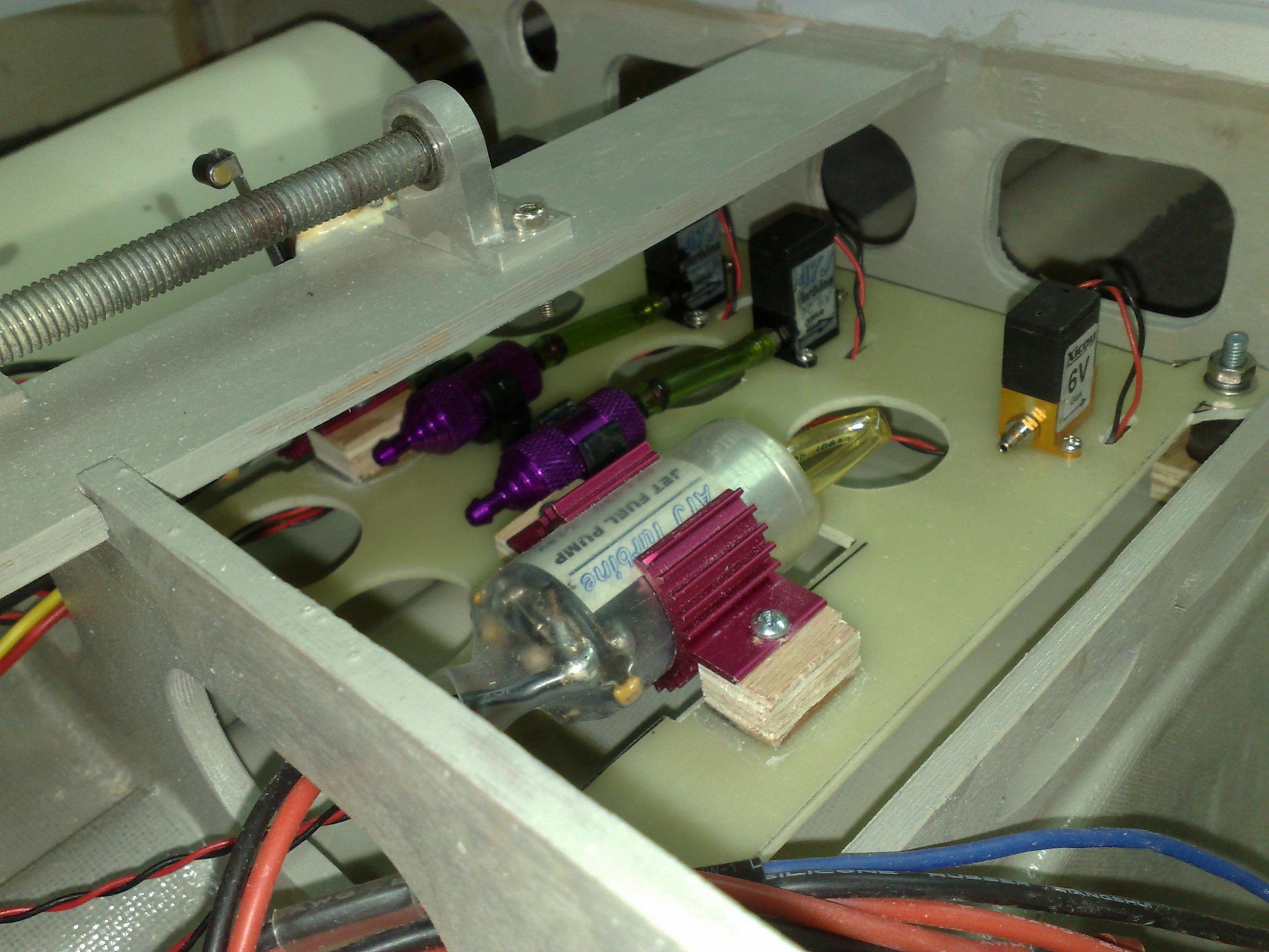

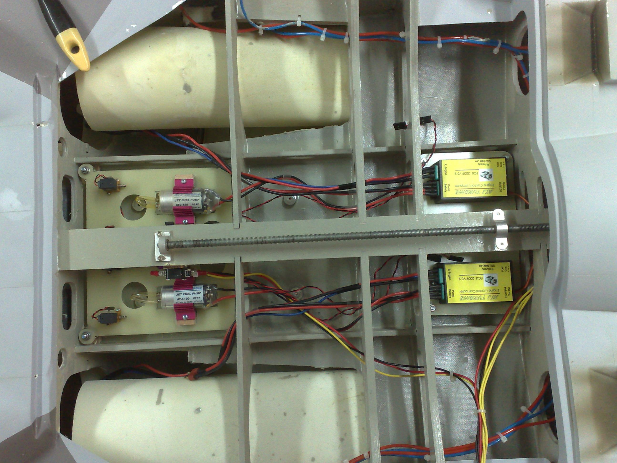

    Next are the engines sub systems shelves installation which include ECU, Fuel pumps , fuel valves ,and fuel filters
Name:	F-14 Twin engines hardware installations 001.jpg‏
ID:	20337   Click image for larger version.
Name:	F-14 Twin engines hardware installations 004.jpg‏
ID:	20338   Click image for larger version.
Name:	ECU mount pic's 001.jpg‏
ID:	20339   Click image for larger version.
Name:	ECU mount pic's 002.jpg‏
ID:	20340   Click image for larger version.
Name:	F-14 Twin engines hardware installations 005.jpg‏

    More in the pics is visible the wings screw jack which when turning is driving the wings from fully extended to fully rewarded possition.

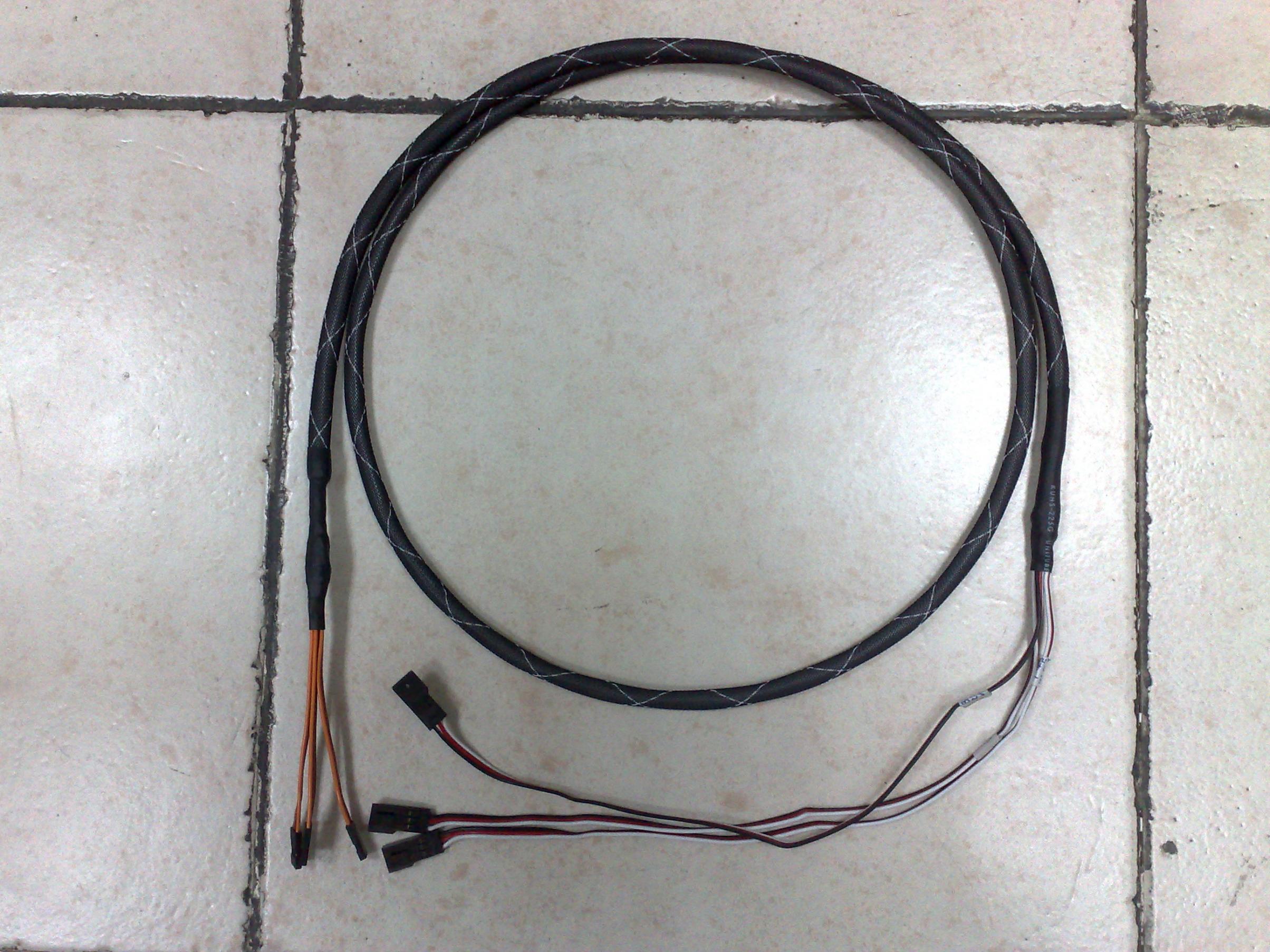

    Servo wire bundle 4 horizontal stabilizers + rudder servo
    made of 22 AWG shielded wire and protective mesh.

    more...
    Engine ECU shelf & batteries
Name:	F-14 Twin project misc' pics 009.jpg‏

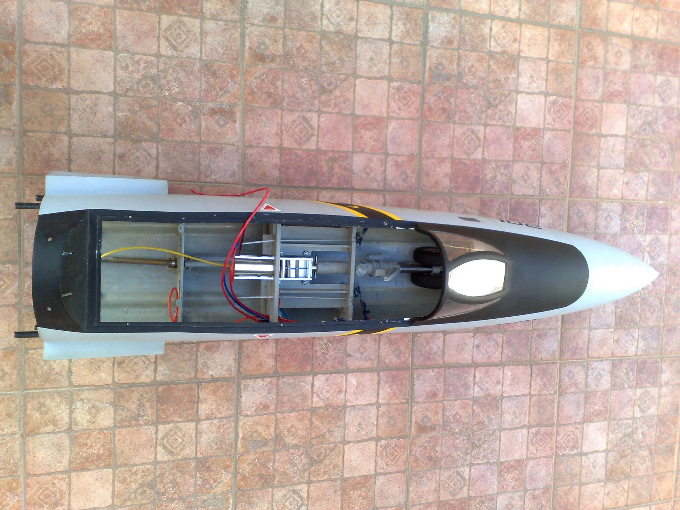

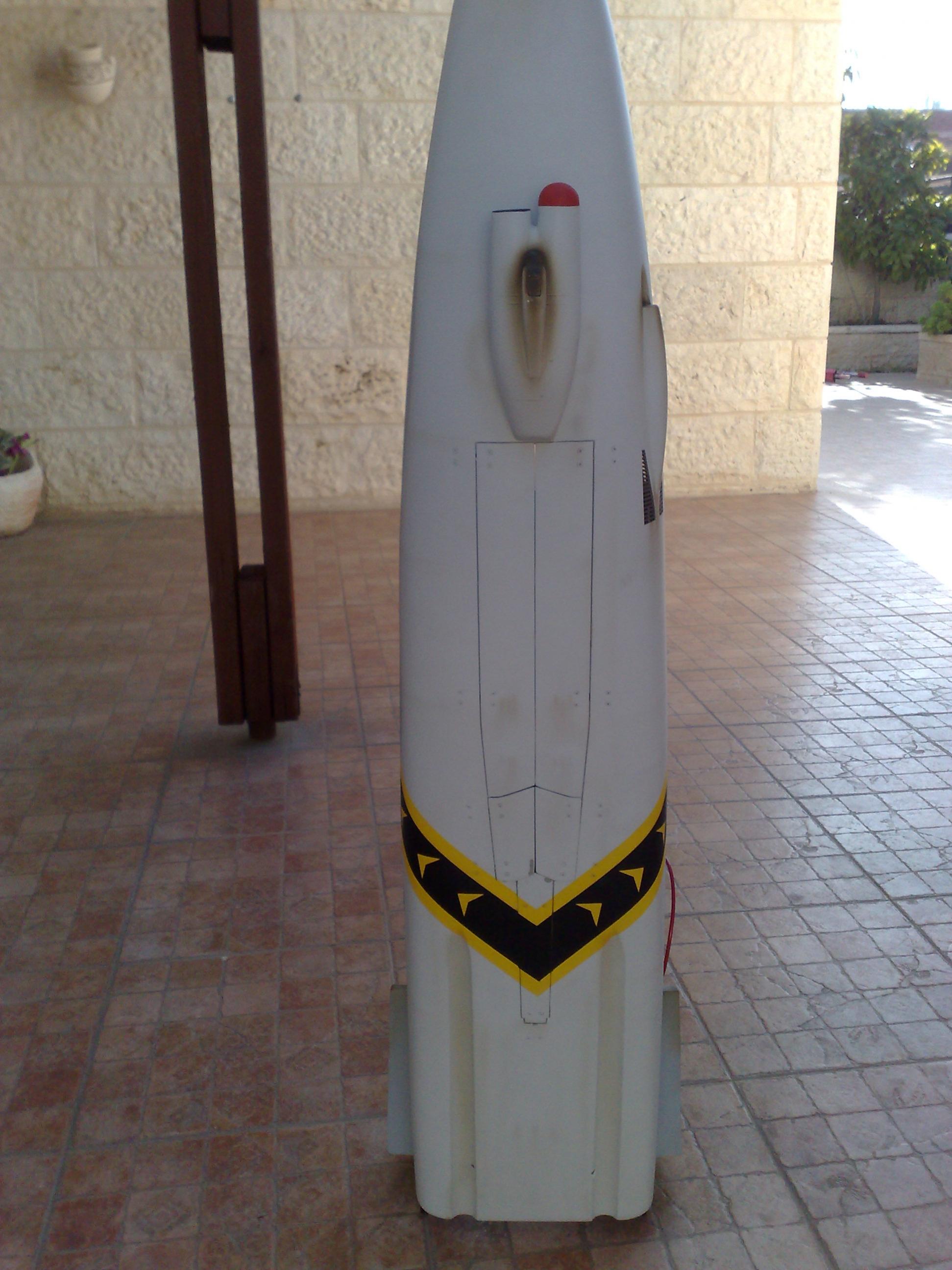

    Fuselage front end...

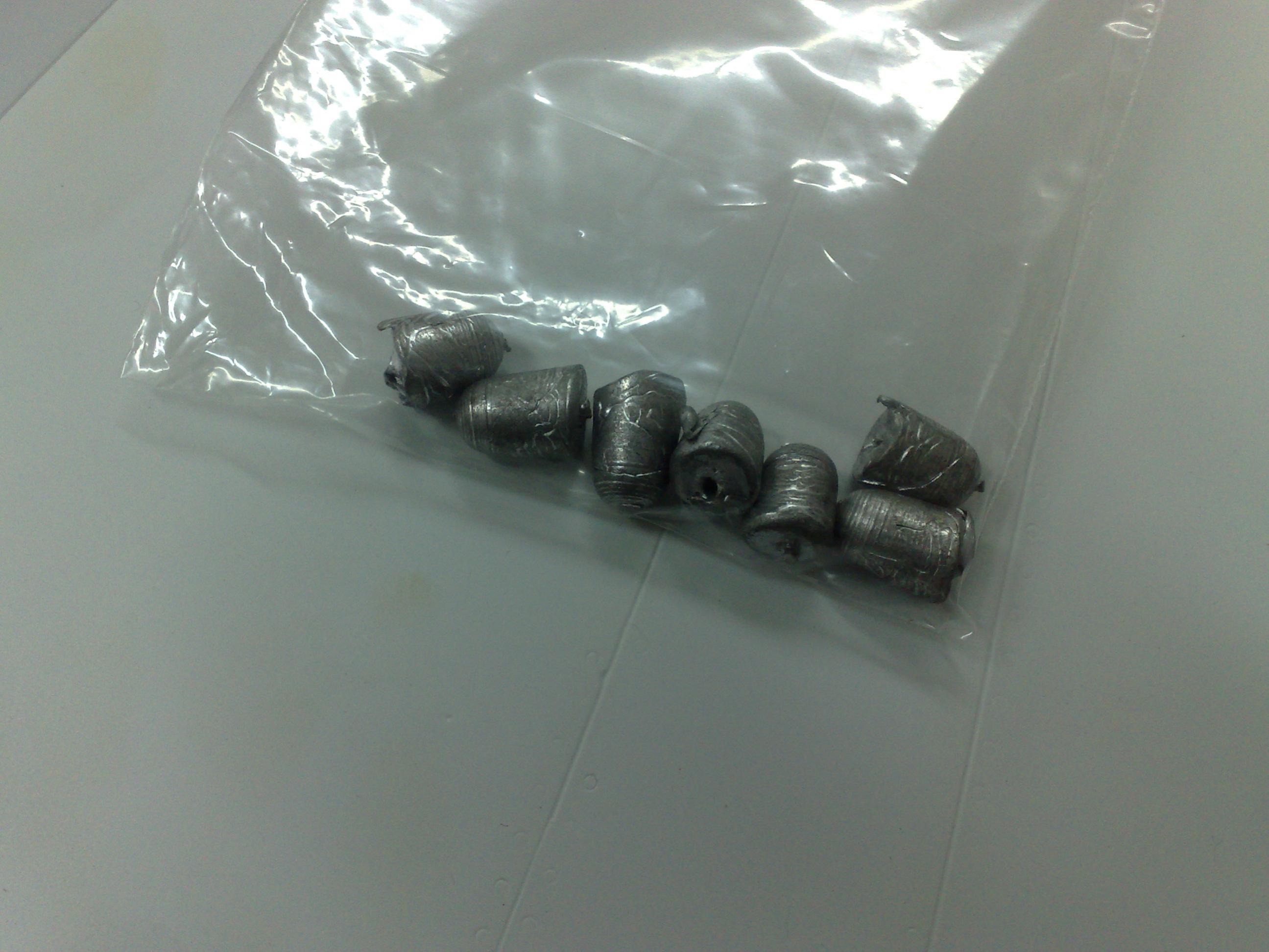

    Horizontal Stabilizer static Balancing ...

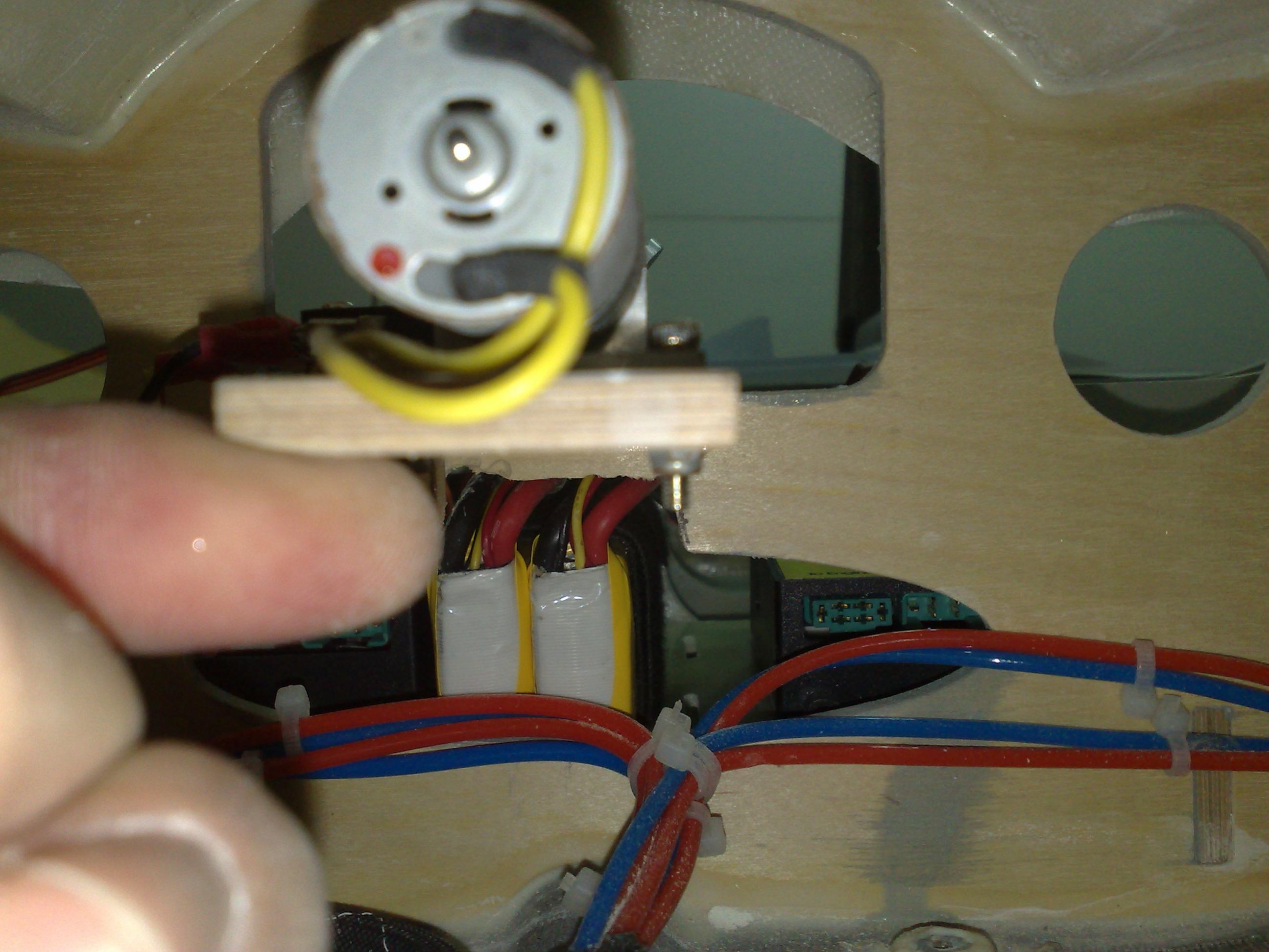

    Some of the air tubing in the fuse + wing folding mechanism elec' motor...

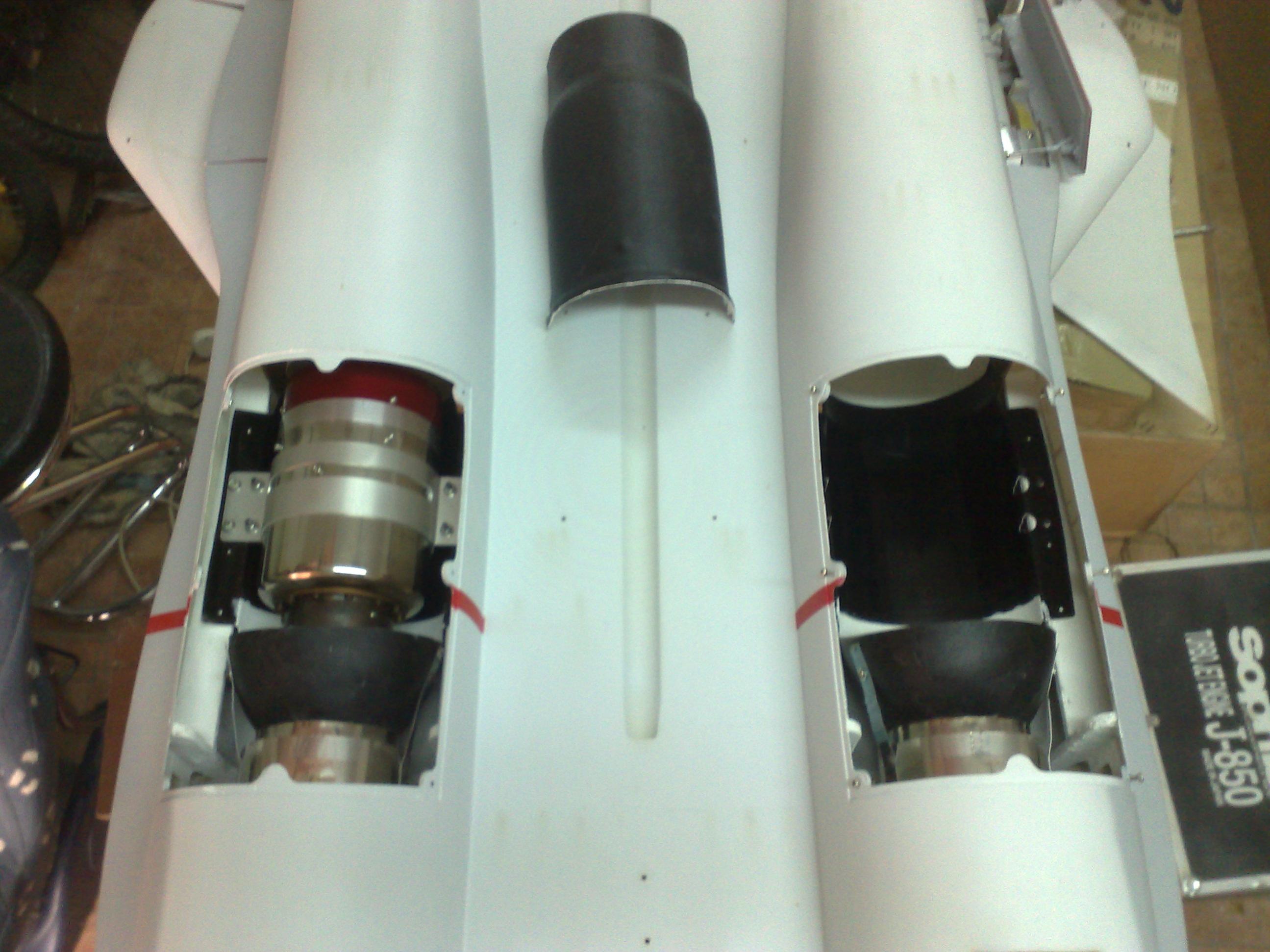

    the beginning of engine installations...
Name:	F-14D project 053.jpg‏
ID:	20386   Click image for larger version.
Name:	F-14D project 021.jpg‏
ID:	20387   Click image for larger version.
Name:	F-14D project 020.jpg‏
ID:	20388   Click image for larger version.
Name:	F-14D project 019.jpg‏

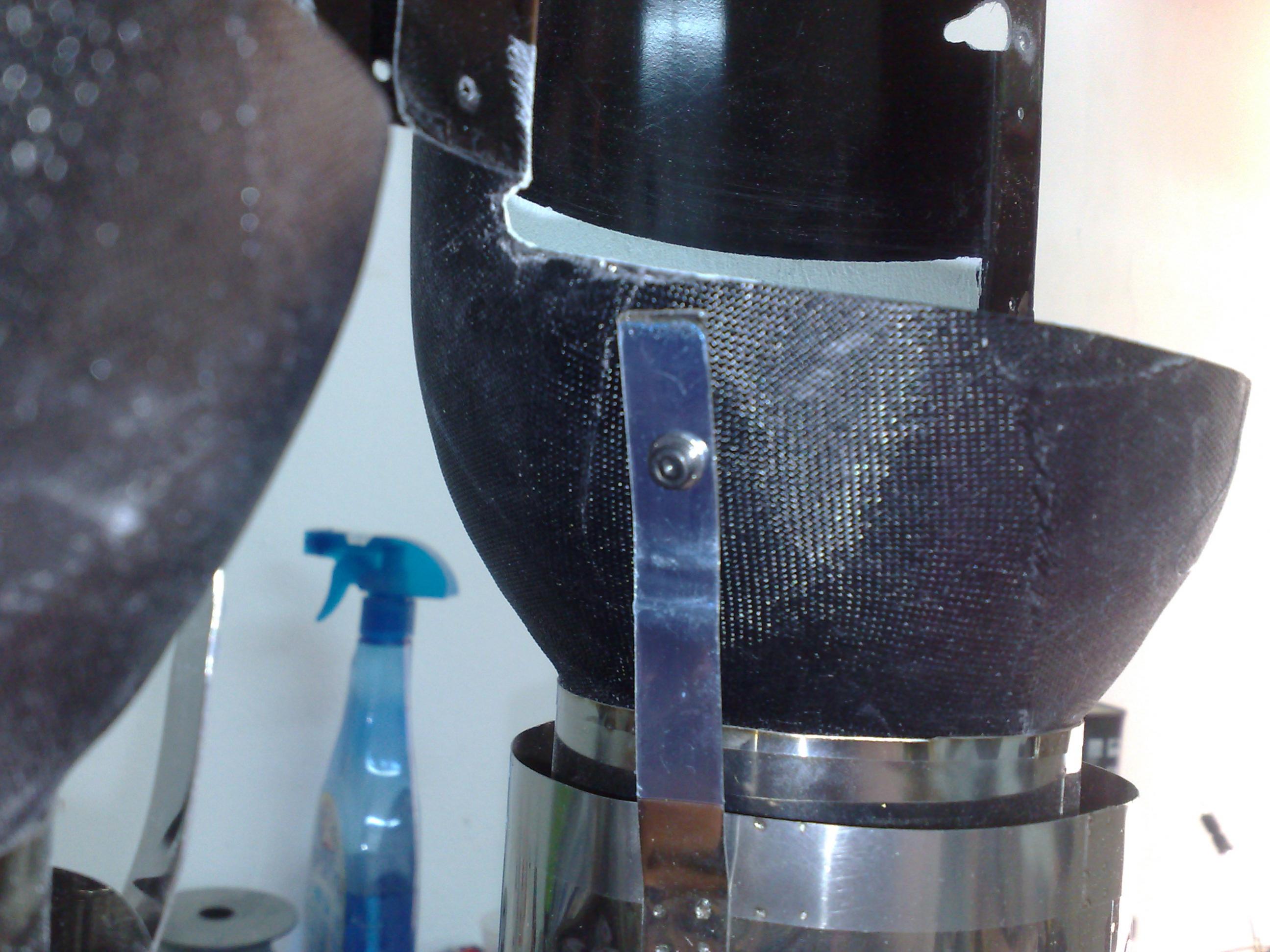

    Dec 2009
    1,242

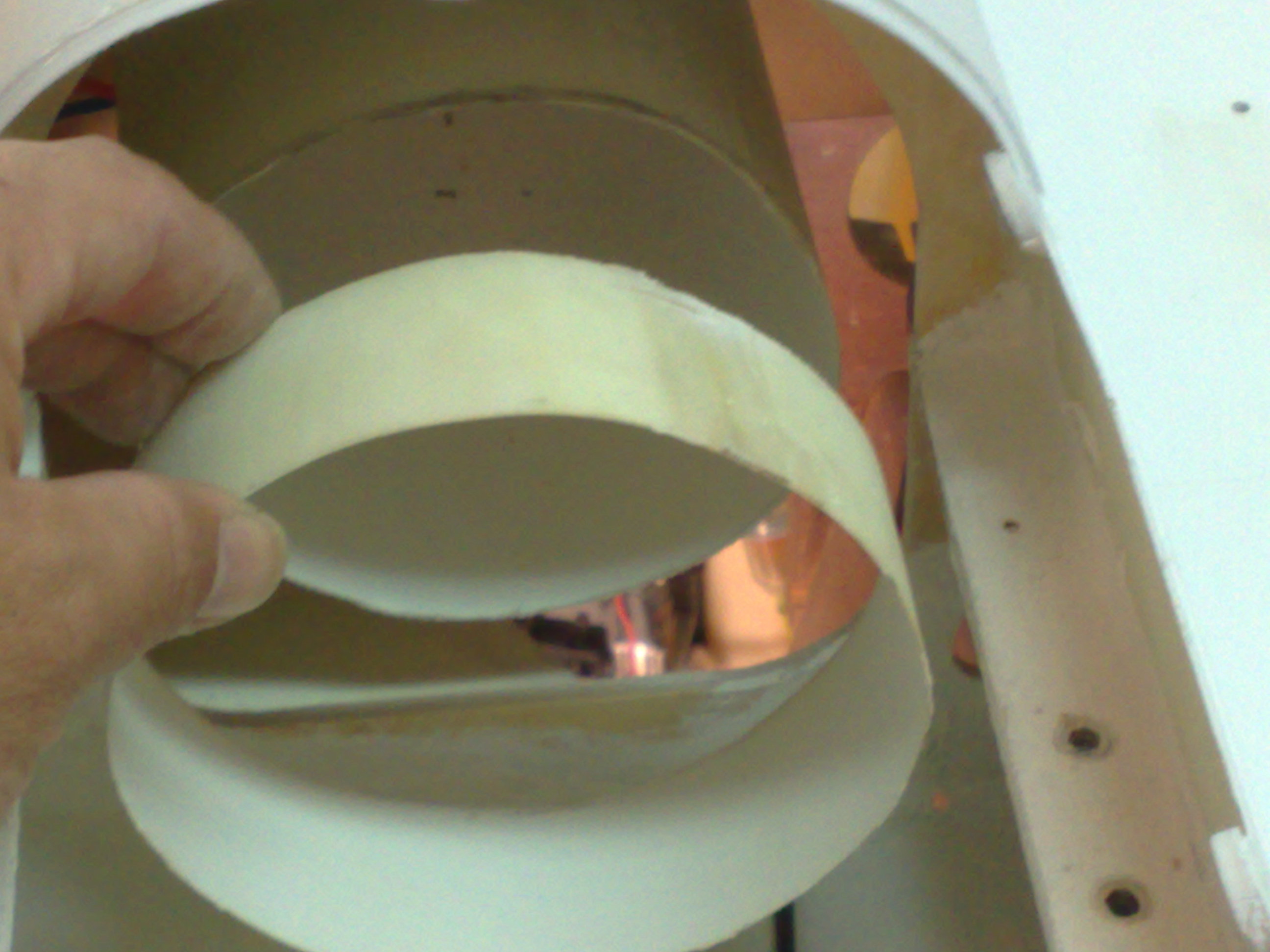

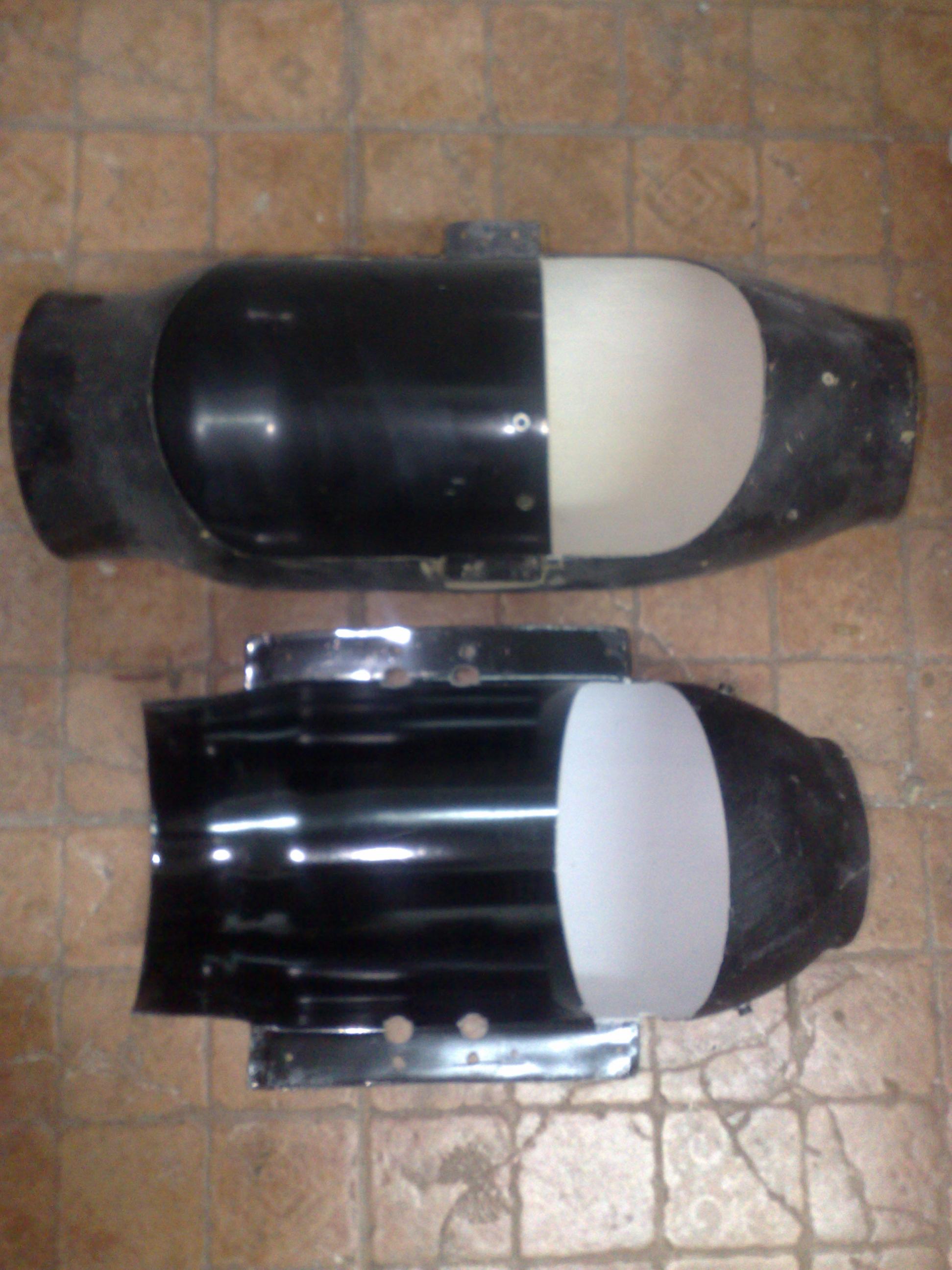

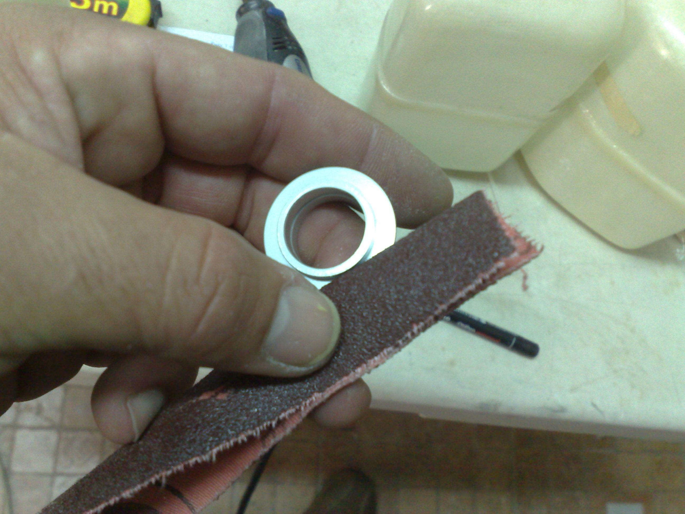

    preparation of the bypass and tail pipe matching + painting the bypass inner surface with BV's "heat shield" a water based ceramic paint.

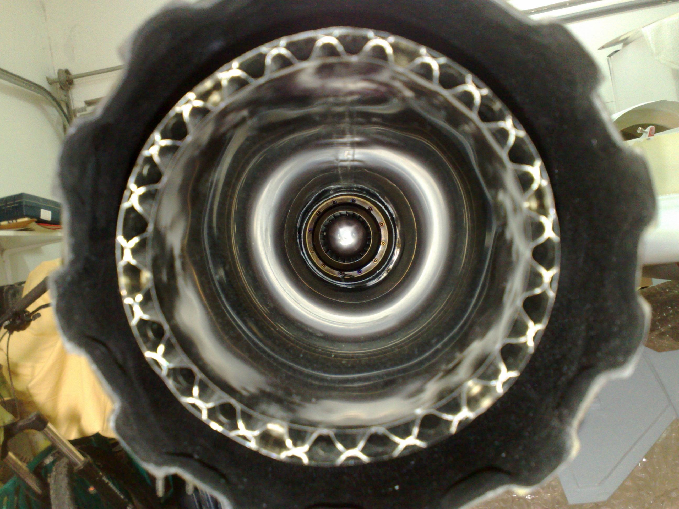

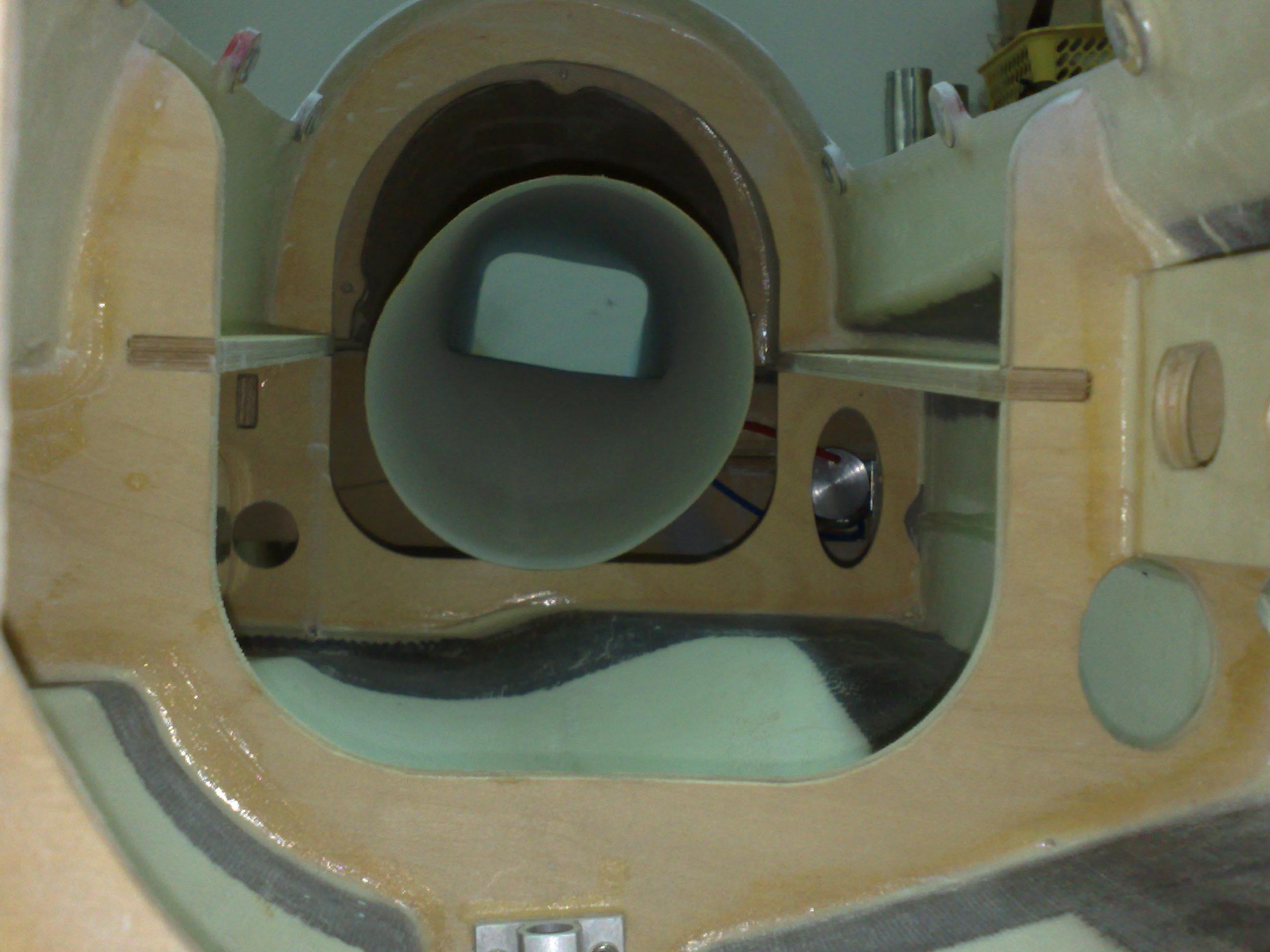

    first steps of engine possitioning ...
    also inlet trim and centering of the engine exhaust in the tail pipe
Name:	F-14D project 017.jpg‏
ID:	20392   Click image for larger version.
Name:	F-14D project 018.jpg‏
ID:	20393   Click image for larger version.
Name:	F-14D project 022.jpg‏
ID:	20394   Click image for larger version.
Name:	F-14D project 023.jpg‏
ID:	20395   Click image for larger version.
Name:	F-14D project 024.jpg‏

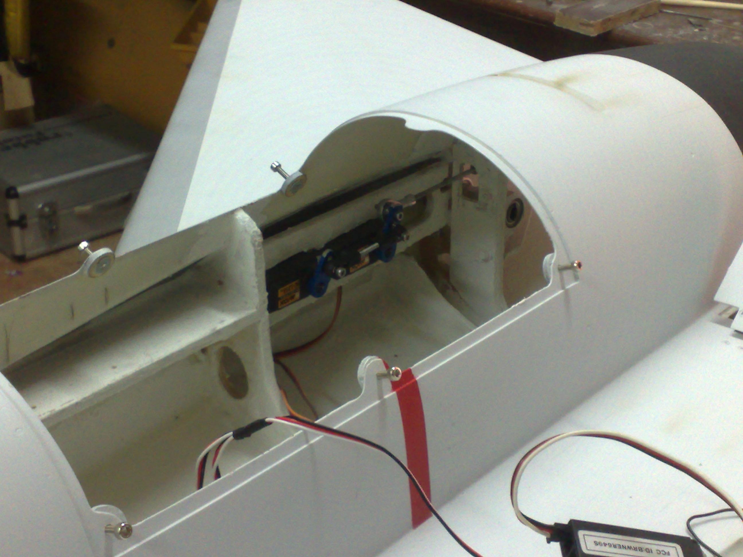

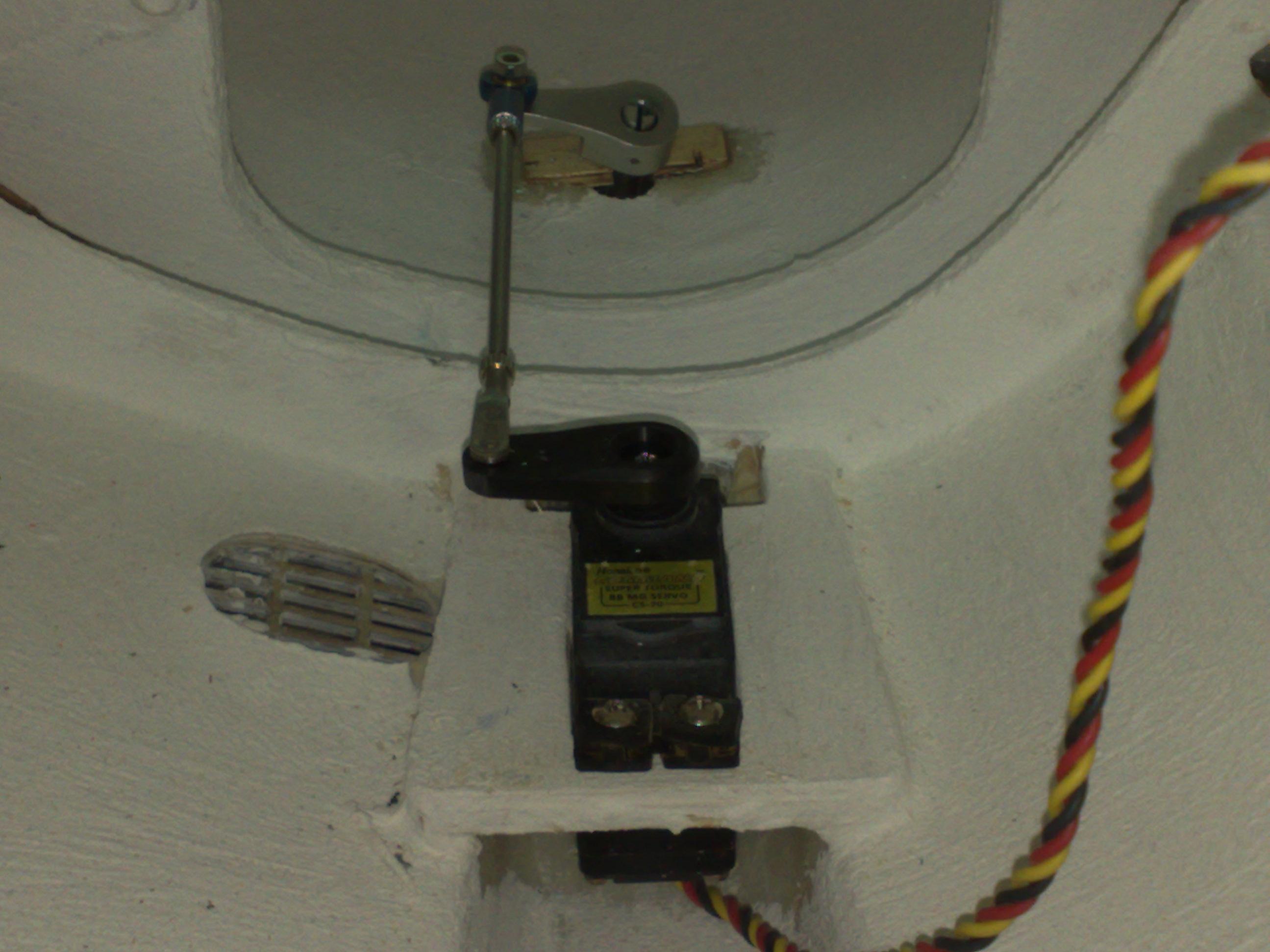

    Rudder servo... + twin stabilizer servo arrangement
Name:	F-14D project 043.jpg‏
ID:	20400   Click image for larger version.

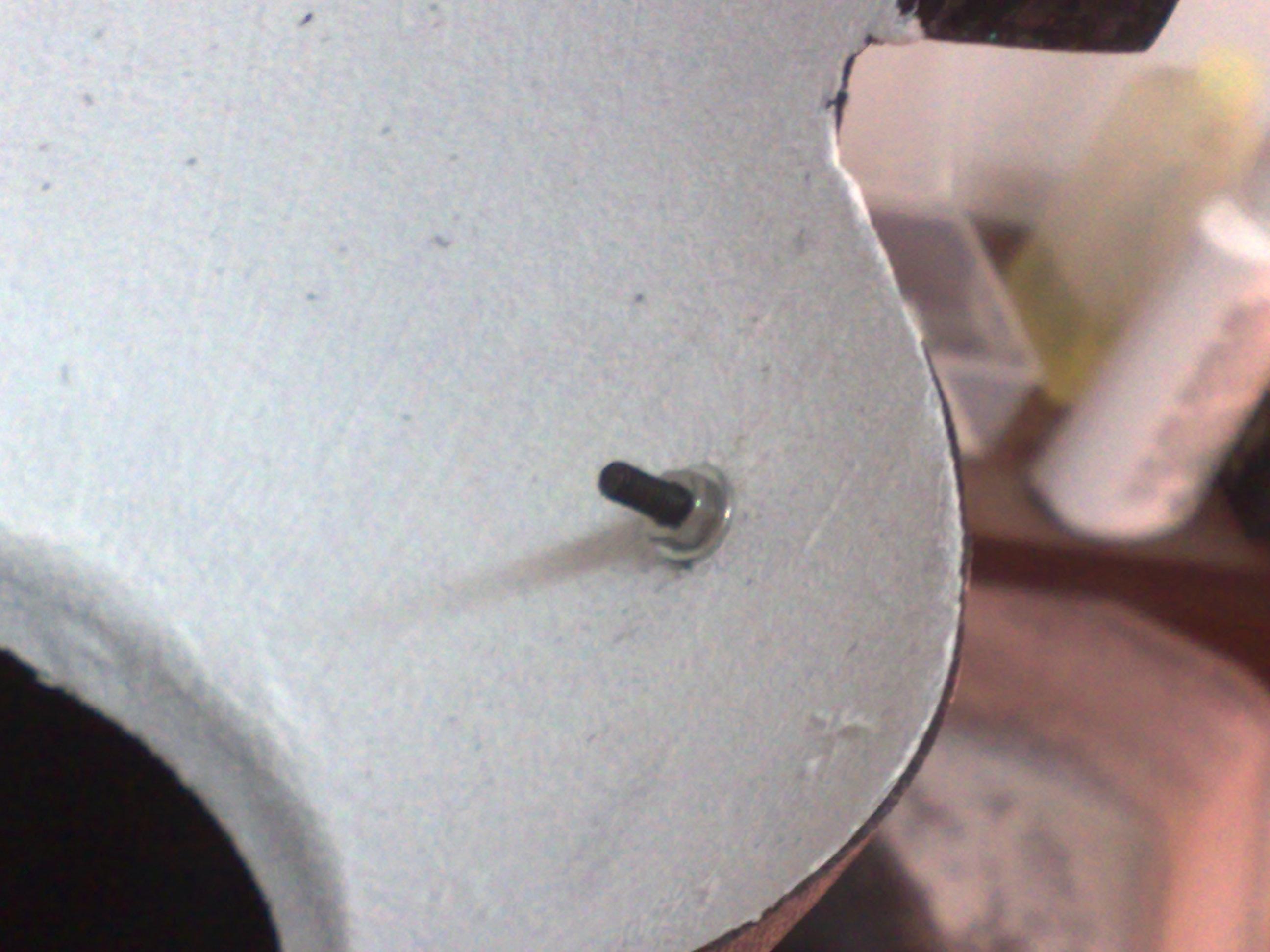

    It is evident from the pictuers that the entire area of the engine and exhaust bay have been treated with BV's Heat Shield protective paint.

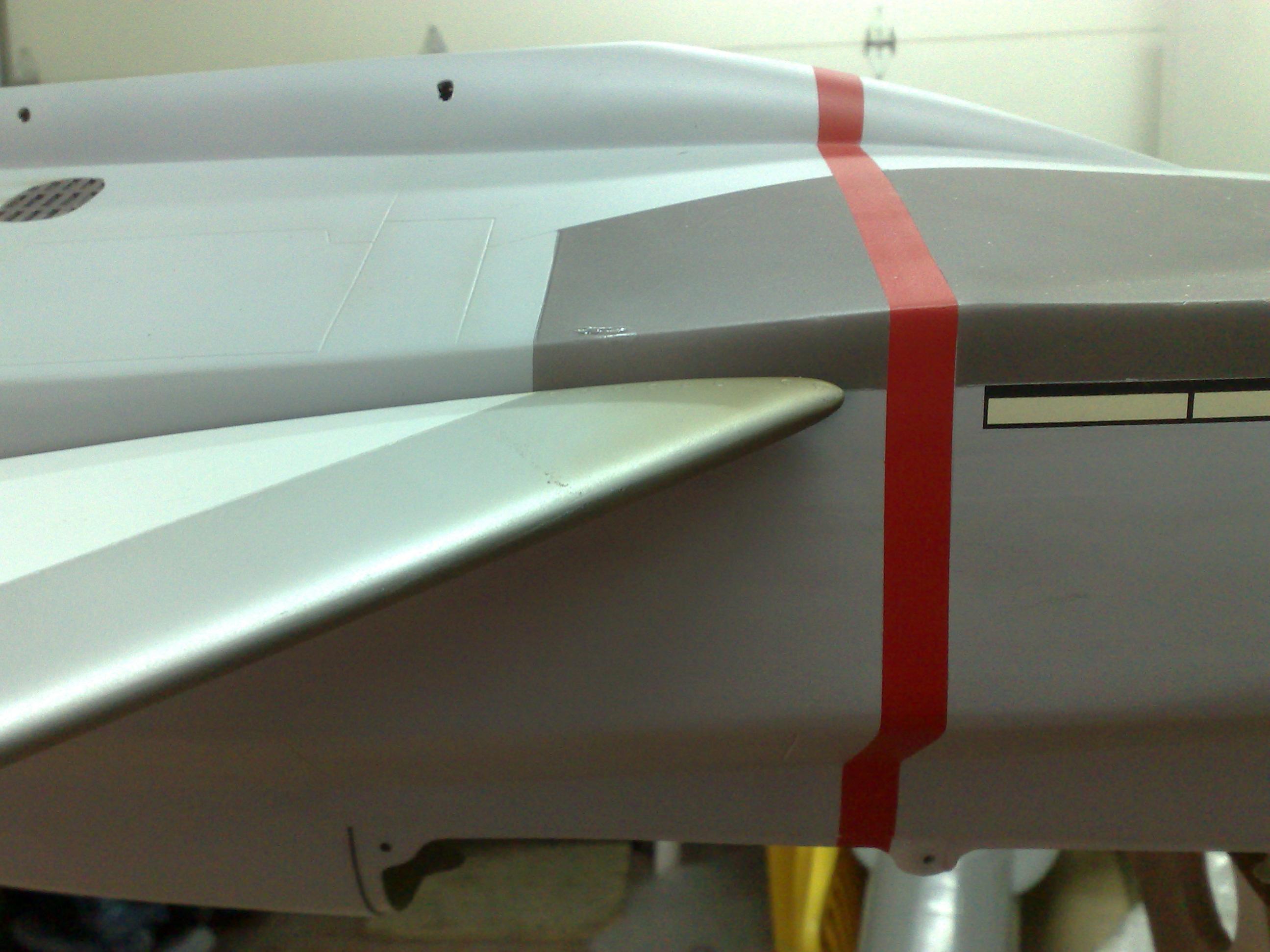

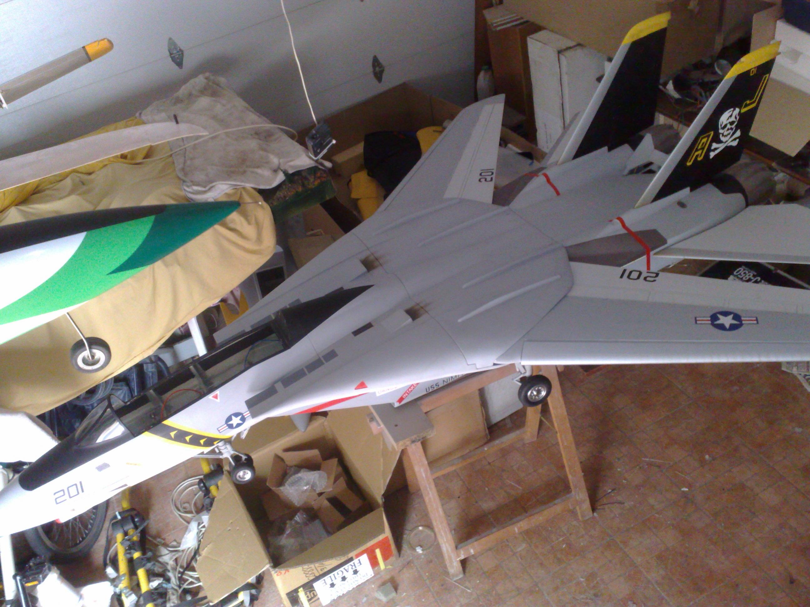

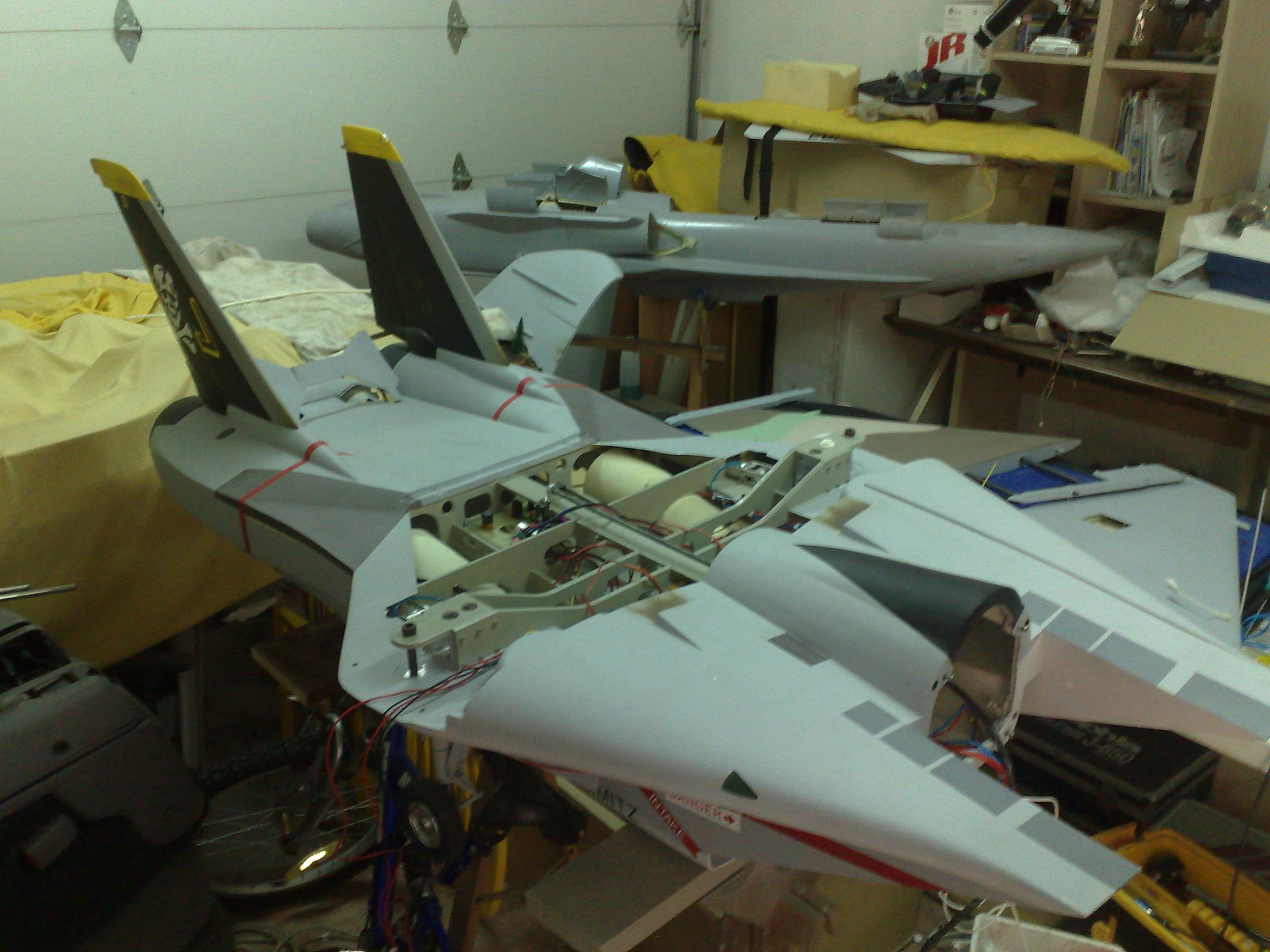

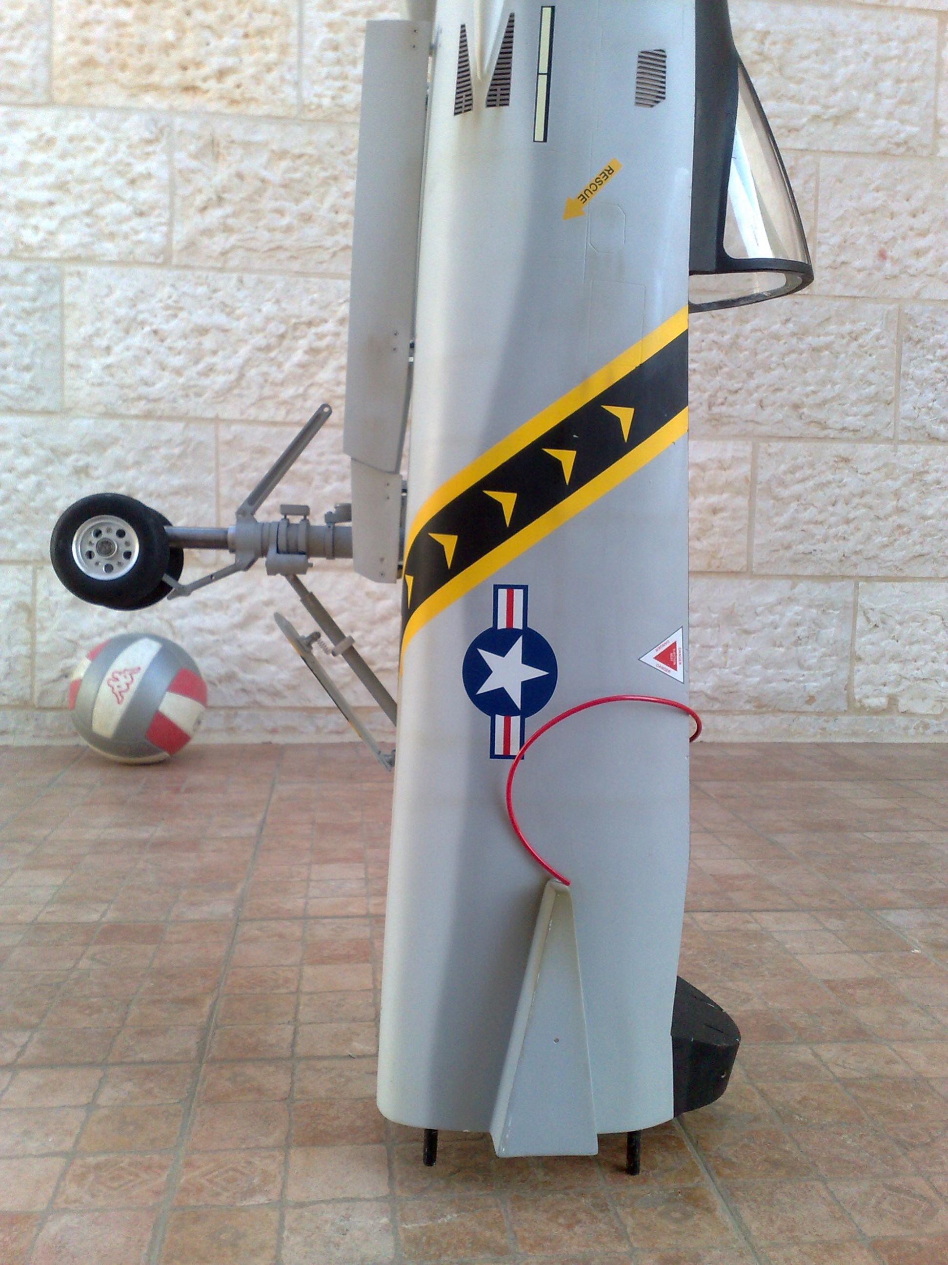

    Here is a picture of it in all...
Name:	F-14D project 057.jpg‏
