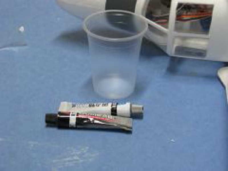

    Glue the wings with the supplied glue (the glue is good!!!) , be aware it is dry fast ,
    Mix a little amount from the two tubes together and spread it on the wing route

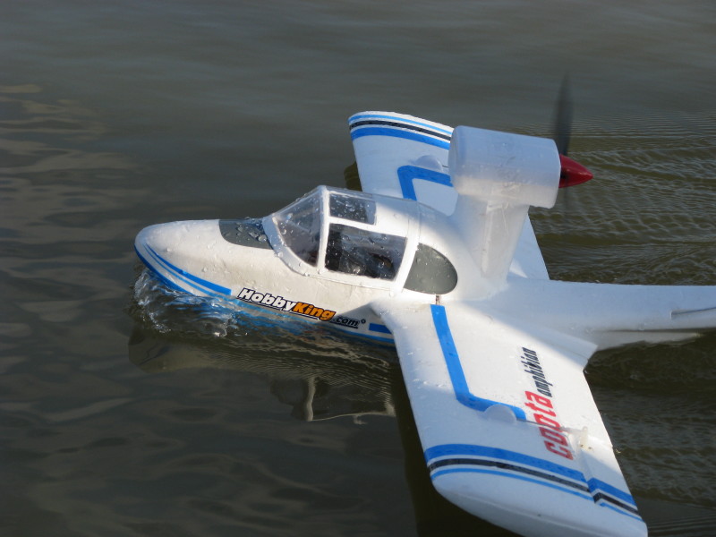

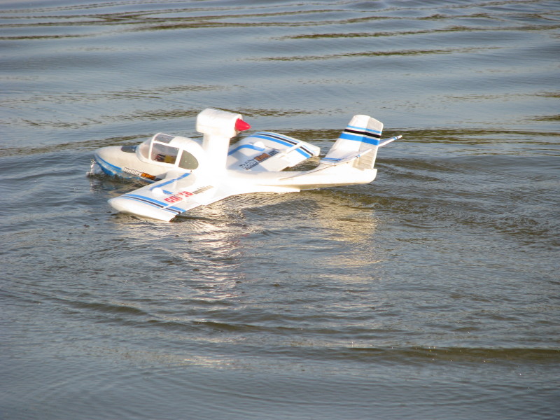

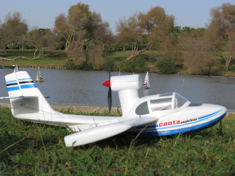

    From the moment it laid on the water until the landing, it was just pure fun,
    The plane flies great at any speed, gives me the feeling
    That I really know what I am doing.
    It's overpower let you clear quickly from any obstacle in the way (like trees near the pond) , Throttle Between 1/3 and 2/3 will give you (bat. 1300mah) 10min. of flight.
    The COOTA handle winds up to 15 mph very well, I didn’t notice any problem that would cause me to avoid flight during the winds.
    Aerobatics is not its best part, I admit, not my either,
    I see people on the YouTube doing some basic aerobatics with it,
    But I am almost sure that the plane told me before the flights,
    "Aerobatics? With me? You see "3d" wrote somewhere on my body?"
    So I leave this testing part open, kidding, I felt that the bank ratio is not
    Fast enough for me to do rolls

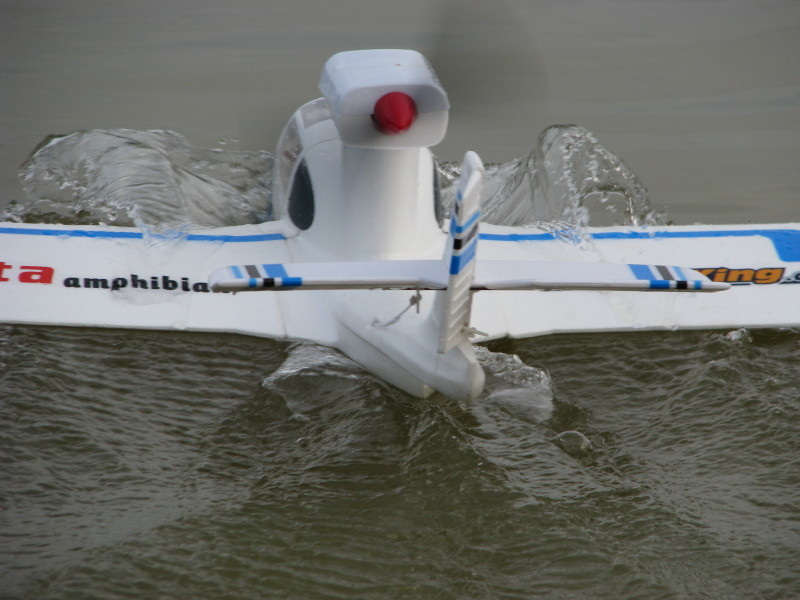

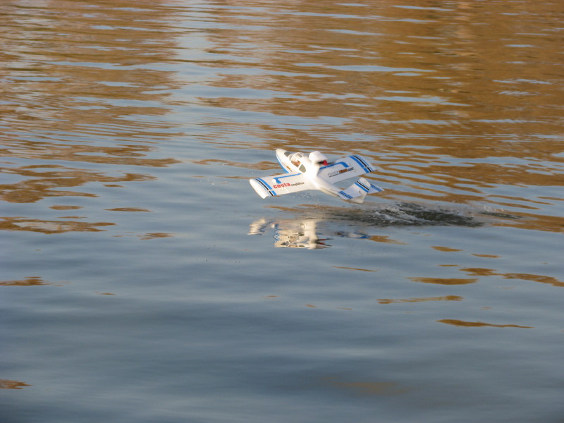

    Taking off and landing
    Keeping wing level, I starting to roll on the water smoothly pulling
    The up stick till it reaches my stomach
    Increasing the throttle until it leaves the ground in a way that just a "scale" plane can give.
ID:	36887 Click image for larger version.
ID:	36948 Click image for larger version.
ID:	36949 Click image for larger version.

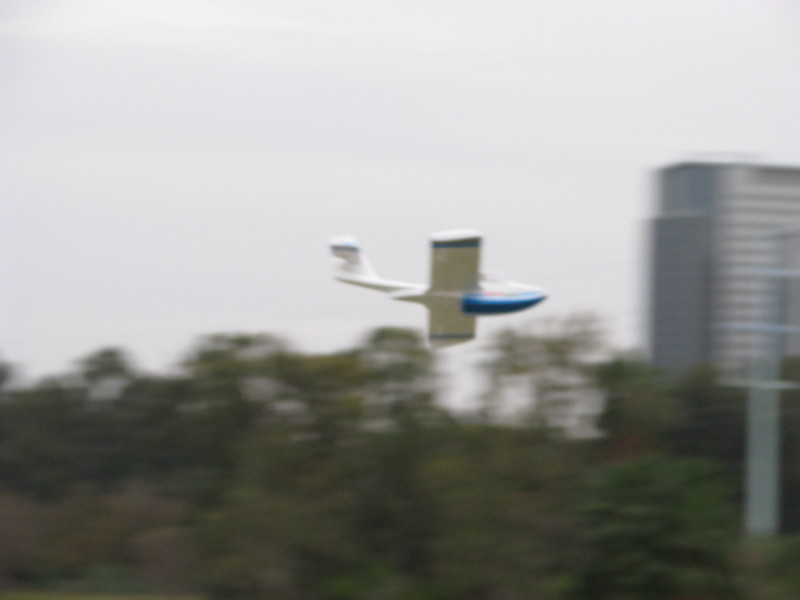

    During Flight
    During flights I try "slow and low", "fast passing", "emergency landing (no motor)"
    Gliding*, Climbing during fast turning, all the way the plane was gentle,
    As expected, and looking so beautiful in the sky,
    I wanted to start the aerobatics, but I remember my promise, and so I didn’t try.
    * Gliding, the COOTA have bad ratio of gliding but I don’t think it's too bad,
    I don’t need gliding in this plane I want to set a point for landing and touch there
    And not find myself keep on gliding until the end of my little pond
    Water Landing
    With or without motor,
    Flies like any plane, smooth landing is guaranteed.
    No something special for water landing

    הדבק את הכנפיים בעזרת הדבק המסופק (הוא טוב ) , ערבב את הדבק שבא בשני שפורפרות
    ומרח על שורש הכנף , זכור הדבק מתייבש מהר !!!

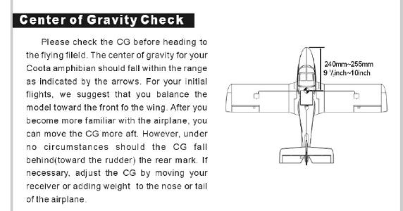

    אם אין לך כזו , תוכל להשתמש אף ב סוללות 2200 MAH
    במידה והמשקולת קיימת ניתן להשתמש במשקולת של 1000 עד 1300 MAH
    את הסוללה יש למקם כמה שיותר אחורית

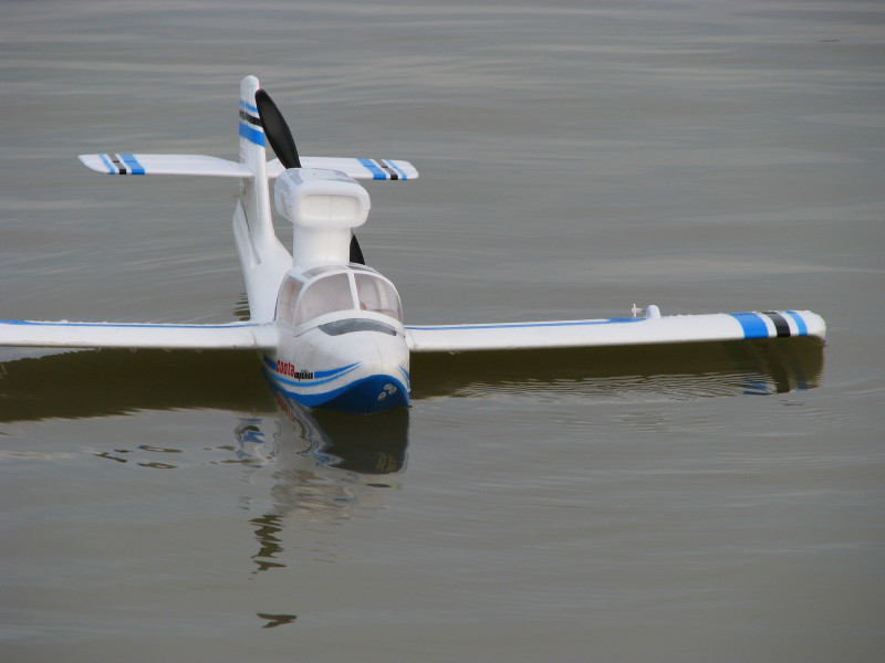

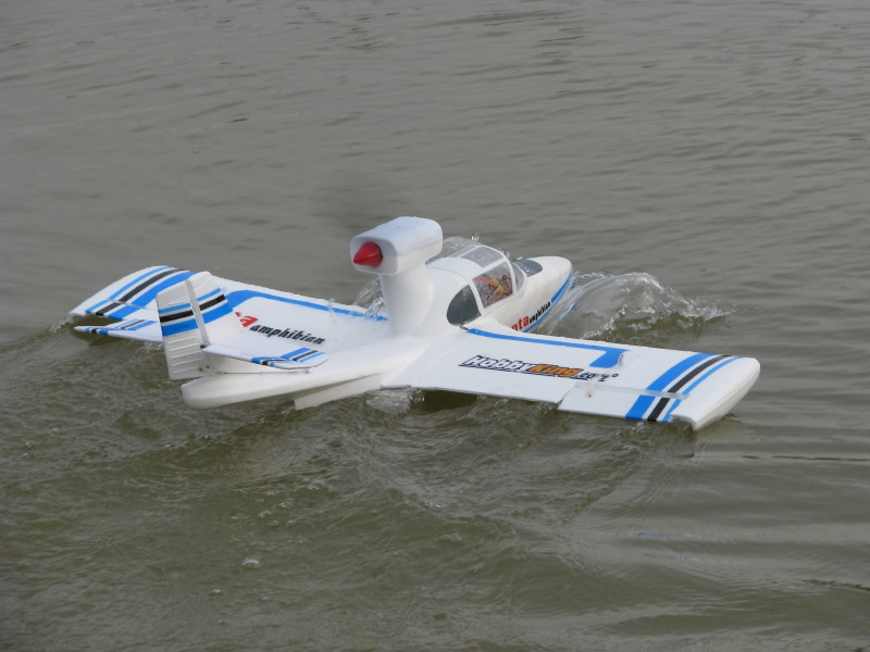

    הטיסה
    תחושות במהלך הטיסה
    "התאהבתי" , יתאר את תחושותי במדוייק
    לאגמית יש מעטפת טיסה רחבה , לא הרגשתי בשום שלב שהטיסן עצבני או על הקצה ,
    בכל התמרונים שלי לא חשתי שאני מאבד שליטה .
    מהרגע שהנחתי אותו במים ועד הנחיתה הוא היה פשוט הנאה צרובה
    הטיסן טס נפלא בכל מהירות ונתן לי הרגשה שאני באמת יודע מה אני עושה .
    עודף הכוח שלו מאפשר לך לברוח ממכשולים בקלות (לדוגמא עצים בקצה האגם ) ,
    בשליש עד שני שליש מצערת יש לך כ10 דקות טיסה עם סוללה 1300 MAH
    גם ברוח הטיסן מסתדר נהדר , לא הרגשתי שאני צריך לבטל טיסה עד רוח של 15 מייל .
    אירובטיקה זה לא החלק החזק שלו , ולמען האמת , גם לא שלי .
    ראיתי סרטונים ברשת שאנשים עושים אירובטיקה בסיסית ,
    אני אני כמעט מוכן להשבע שהטיסן אמר לי :
    "אירובטיקה? איתי ? , אתה רואה שרשום לי 3D על המצח ?"
    טוב , אז עזבתי את זה , טיפה ברצינות , שיעור הגלגול שלו נמוך ולא נתן לי הרגשה שאני
    אוכל להשלים רול .
    המראה ונחיתה
    שמור על כנפיים מאוזנות ,
    מהרגע שהטיסן מונח במים ועד ההמראה שמור על הגה גובה ב UP , שהסטיק יגע לך בבטן
    תרים מצערת בעדינות עד שהטיסן יתנתק מהמים כמו שרק מטוס סקייל יכול לתת לך
    במהלך הטיסה טסתי "נמוך ולאט" "מעברים מהירים" , "תרגול חרומים(בלי מנוע)" דאיה*
    "טיפות בפניות" בכל הטיסות ההתנהגות של הטיסן היתה מדוייקת רגועה צפויה ויפה
    כמו המטוס היפה הזה , רציתי בכל זאת לבצע אירובטיקה , אבל נזכרתי שהבטחתי לו לא לבצע
    ולא ביצעתי .
    לגבי דאיה , לאגמית יש כושר דאיה נמוך , אבל לדעתי זה ממש לא חסרון , במטוס מים
    אני רוצה לקבוע נקודה שבה המטוס יגע במים ולא ימשיך לדאות עד קצה האגם הקטן שלי .
    נחיתה במים
    עם או בלי מנוע , כמו בכל טיסן , מציפים ונוגעים במים , אין פה משהו מיוחד למטוס מים
    עדיף , להגיע עם כנפיים מאוזנות .
    לסיכום
    במילה אחת לתאר את המטוס : הפתעה
    הטיסן אמנם לא למתחילים , אך ממש עם מעט ניסיון ניתן להטיס אותו ללא שום בעיה
    אהבתי
    קלות ההרכבה
    האריזה
    המראה של מטוס אמיתי
    הטיסה החלקה
    לא צריך שום כלי בהרכבה או בשטח , רק סלוטייפ
    החלפת הסוללות קלה.
    לא אהבתי
    החופה , המגנטים של החופה , ללא סרט הדבקה מים יכנסו או שהחופה תעוף
    מגש הסוללות (גומיות מחזיקות ת'סוללה ) , לא ממש יעיל , ניתן להשתמש בו ,
    אבל אם יתוכנן מגש מוצלח יותר יהיה עדיף .
    תודה על הקריאה
    אילן לכיש
    מנהל פורום סירות ב EFLY
