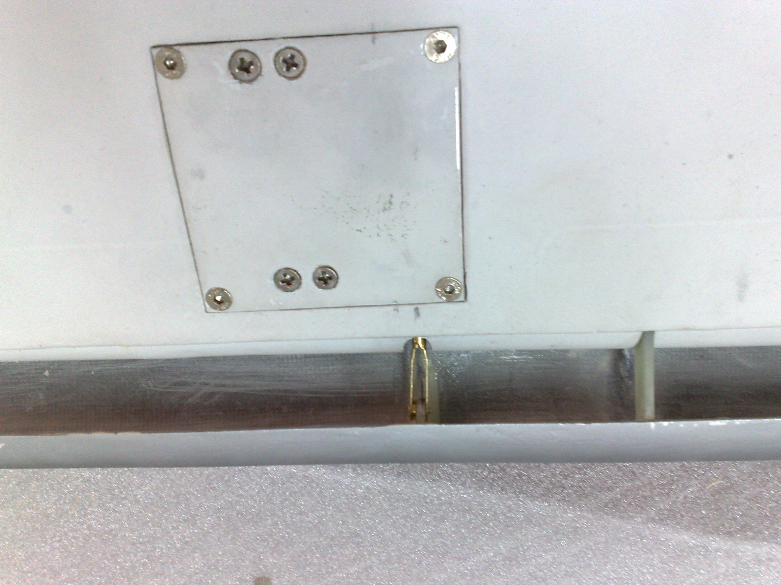

    Next done were the slots for the L/E push rods openings
Name:	F-14 Twin project misc' pics 035.jpg‏
ID:	33533   Click image for larger version.
Name:	F-14 Twin project misc' pics 037.jpg‏
ID:	33534   Click image for larger version.
Name:	F-14 Twin project misc' pics 036.jpg‏

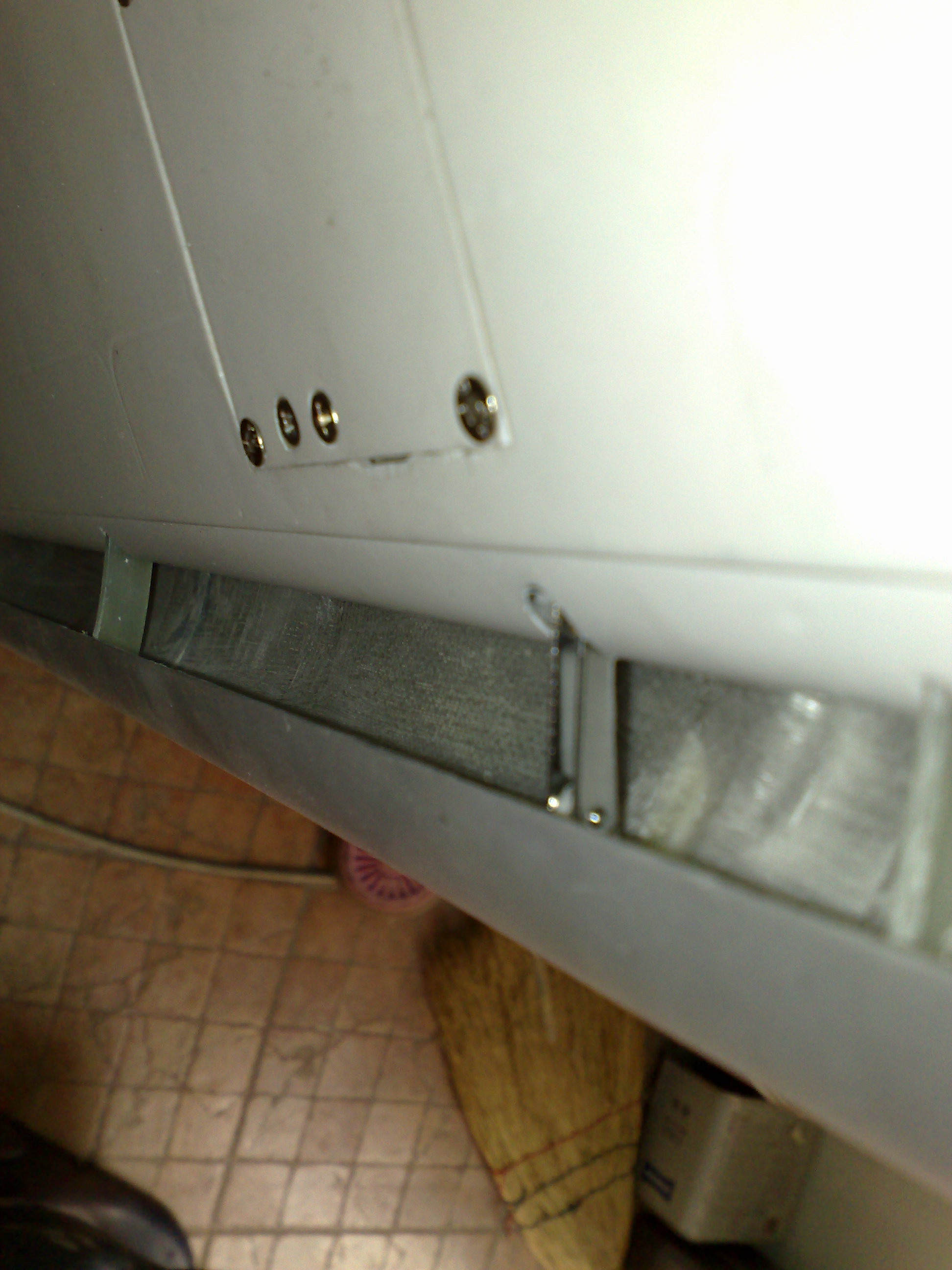

    L/E Slat actuator push rods seen through the ready made opennings
Name:	F-14 Twin project misc' pics 038.jpg‏
ID:	33536   Click image for larger version.
Name:	F-14 Twin project misc' pics 040.jpg‏

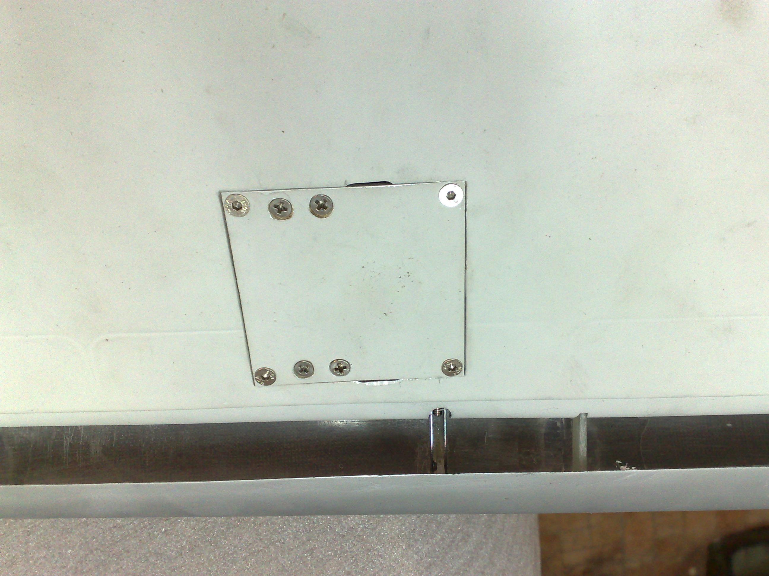

    L/E Slats installed and running
Name:	F-14D Project 043.jpg‏
ID:	33606   Click image for larger version.
Name:	F-14D Project 044.jpg‏
ID:	33607   Click image for larger version.
Name:	F-14D Project 046.jpg‏
ID:	33608   Click image for larger version.
Name:	F-14D Project 047.jpg‏
ID:	33609   Click image for larger version.
Name:	F-14D Project 049.jpg‏

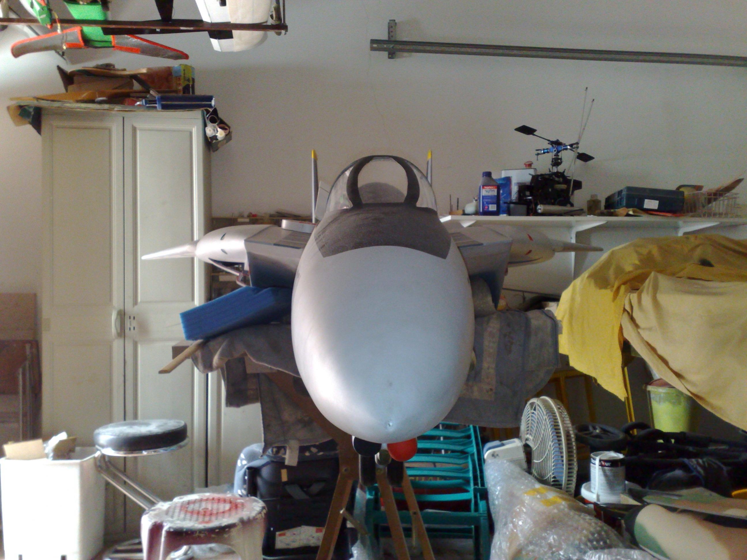

    Dec 2009
    1,242
    הודה 46 פעמים ב 44 הודעות
    ברירת מחדל תגובה להודעה: F-14D

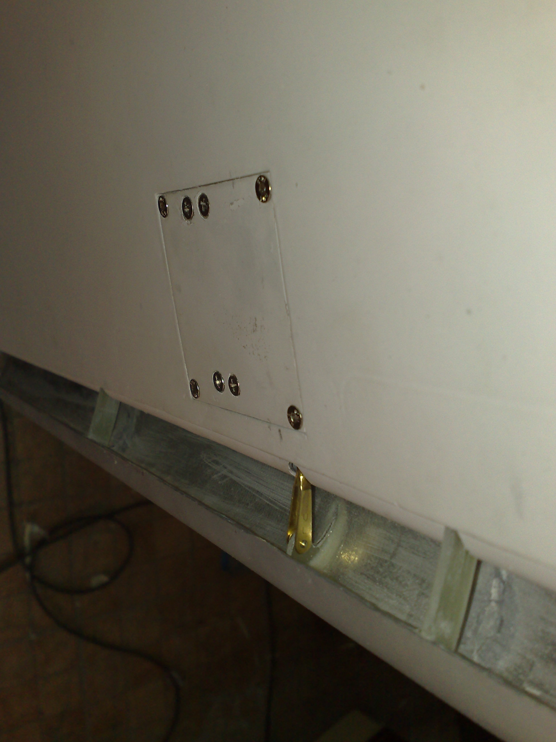

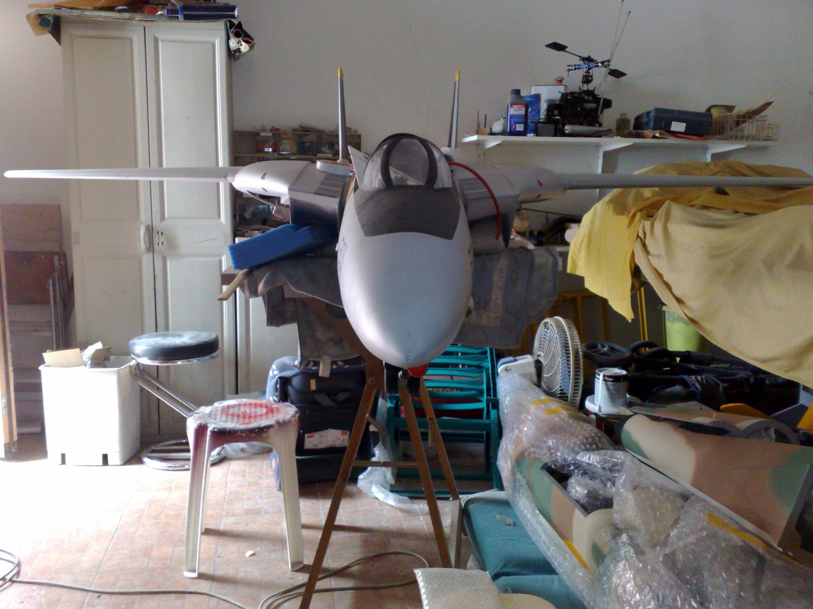

    A minor disaster struck today when I found that the starboard wing is misaligned with the port wing in means of dihedral (both lateral and incidence), the problem lays with the fact that the wing is supported by a large bushing that is secured within the inner structure itself . After some thought I finally came to a conclusion that there is no other way to fix this but to cut open the wing and get access to the mentioned part , cutting it loose and reposition it in the right angle by means of securing the wing in it's correct position while the glue sets. After some tedious work the results are more than satisfying ....now what is left is to further reinforce the area with carbon rovings and close back the cavity...
Name:	F-14 Twin project misc' pics 041.jpg‏
ID:	33785   Click image for larger version.
Name:	F-14 Twin project misc' pics 042.jpg‏
ID:	33786   Click image for larger version.
Name:	F-14 Twin project misc' pics 045.jpg‏
ID:	33787   Click image for larger version.
Name:	F-14 Twin project misc' pics 044.jpg‏
    Dec 2009
    1,242
    Just to explain ...the pictures show the status prior the fixing.
