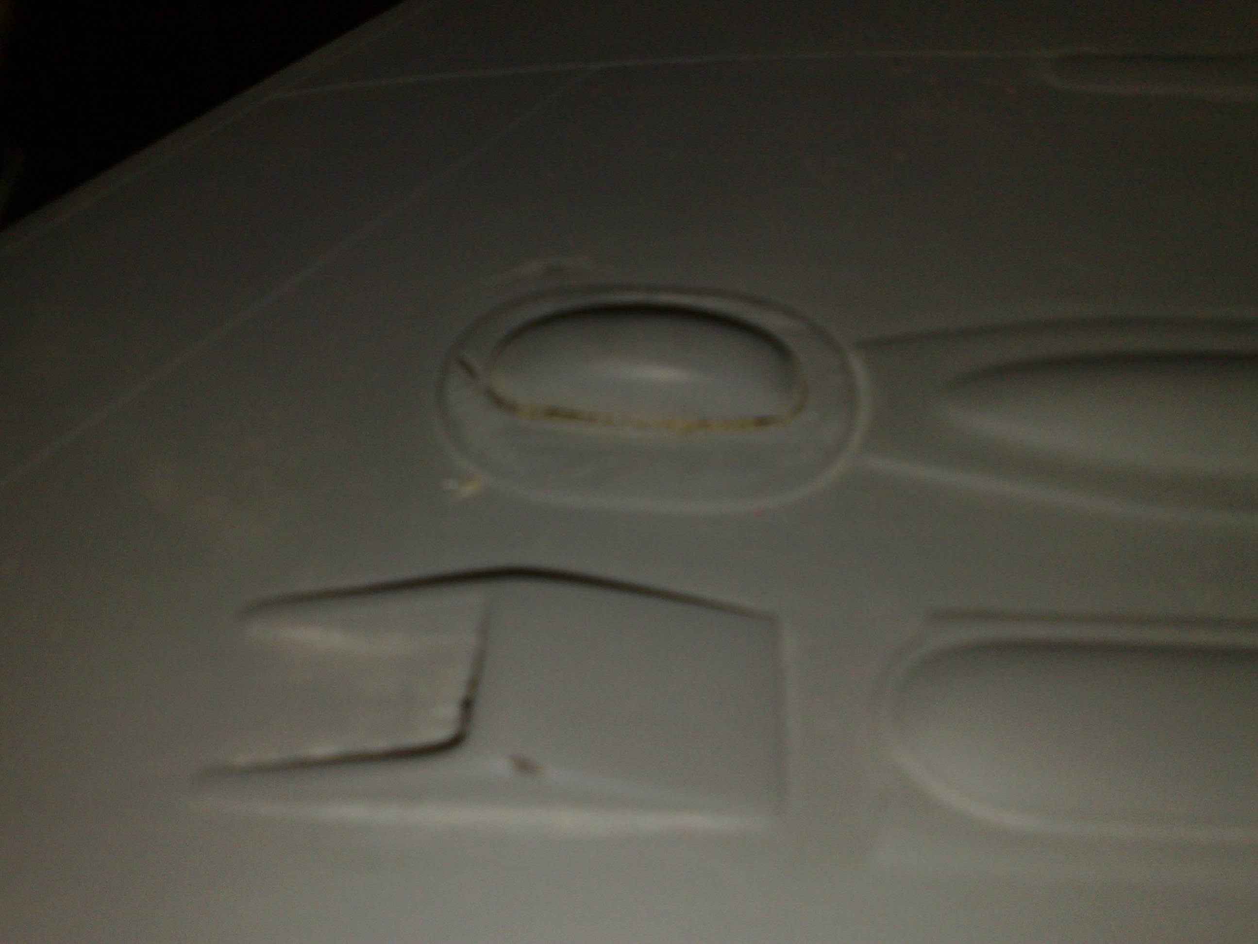

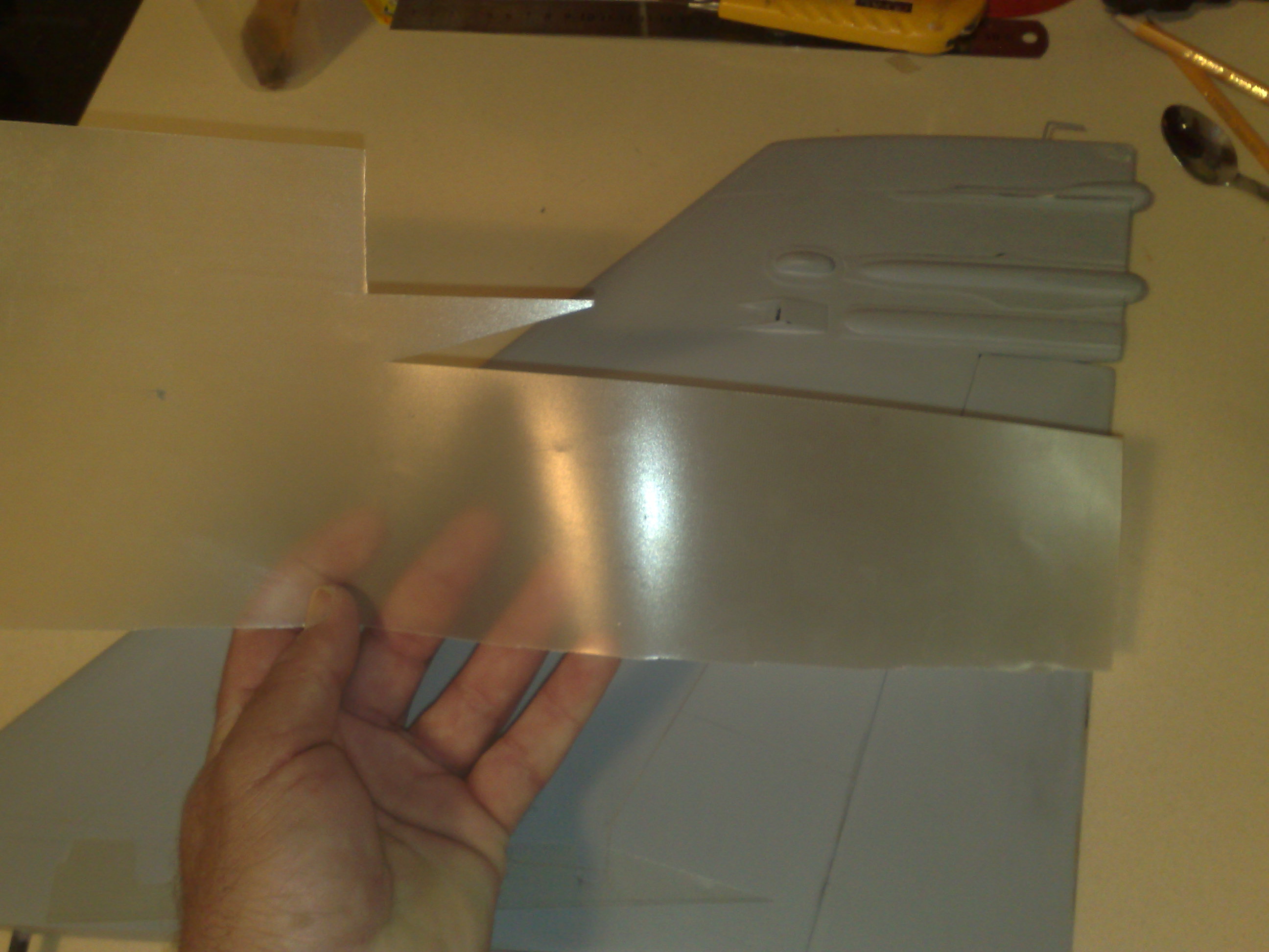

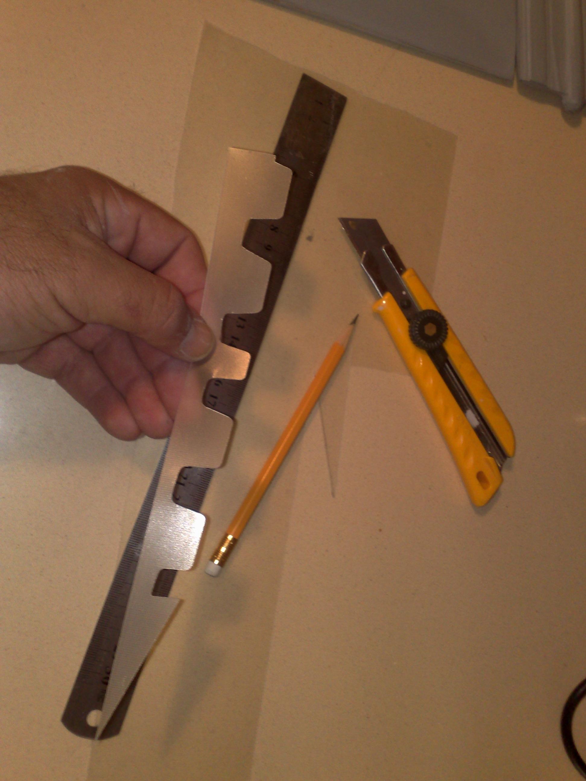

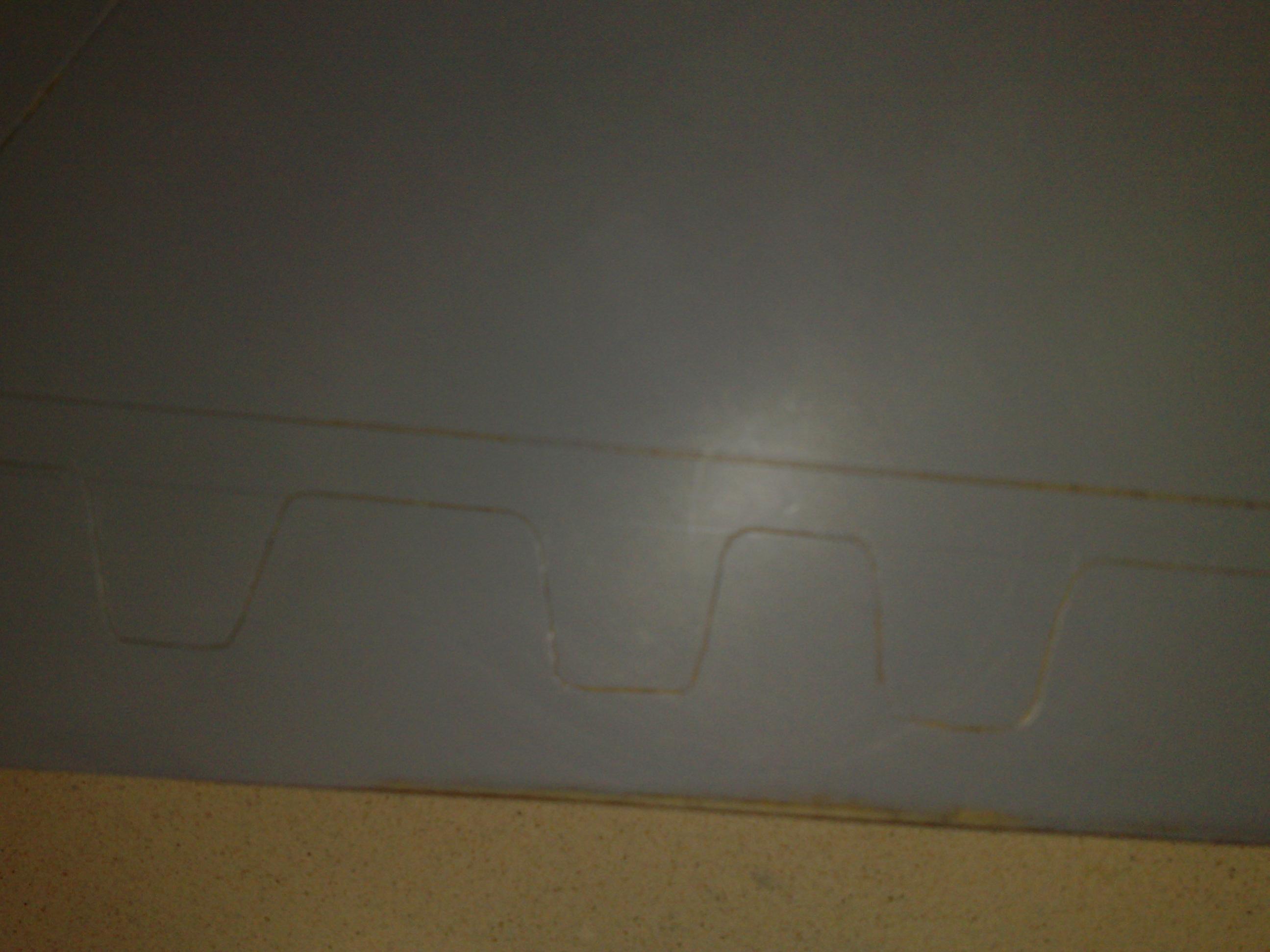

    hardly seen are panel lines engraved in the surface....

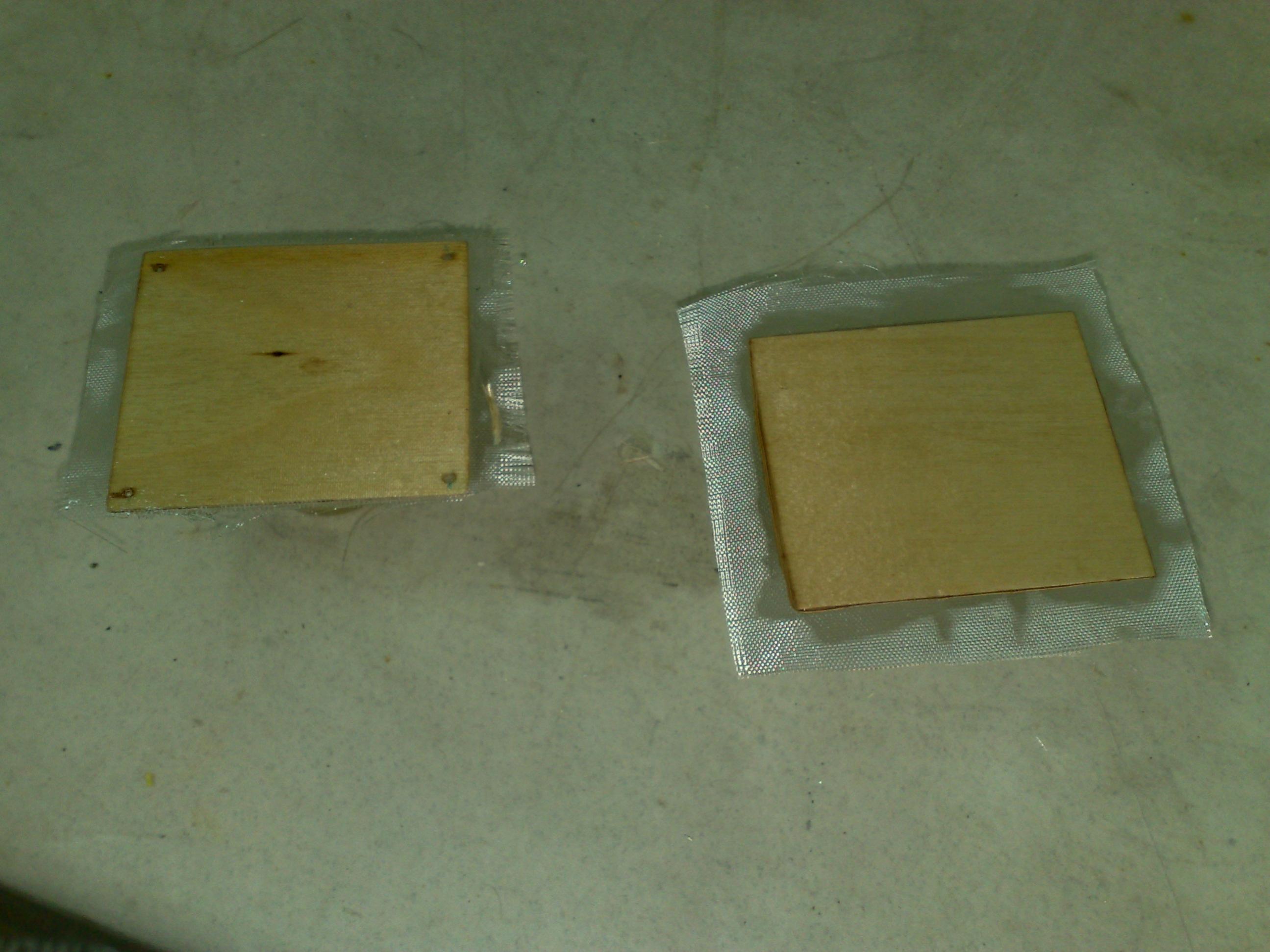

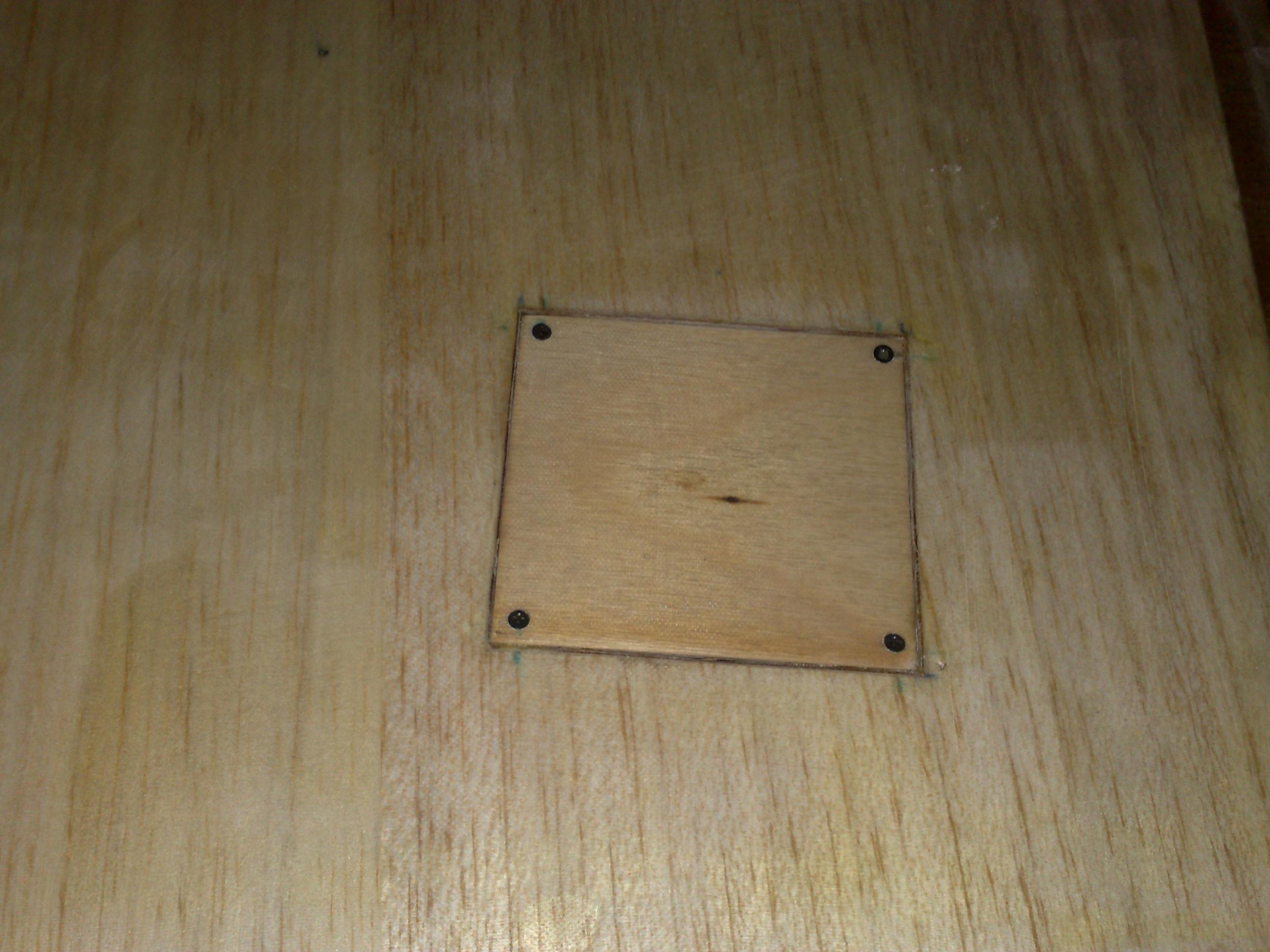

    Preparation of servo hatches...

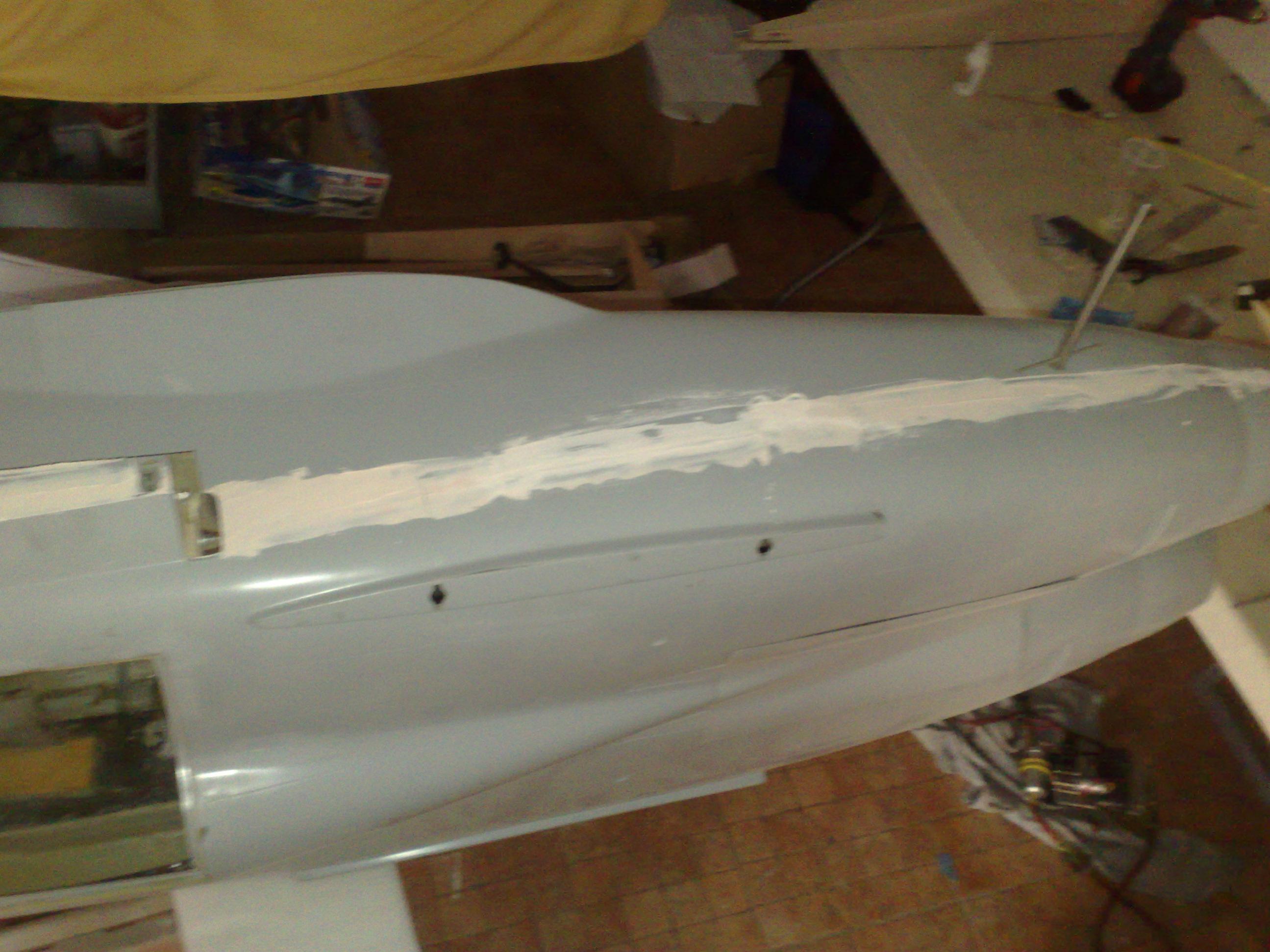

    Filling the fuselage separation mold line with car putty...

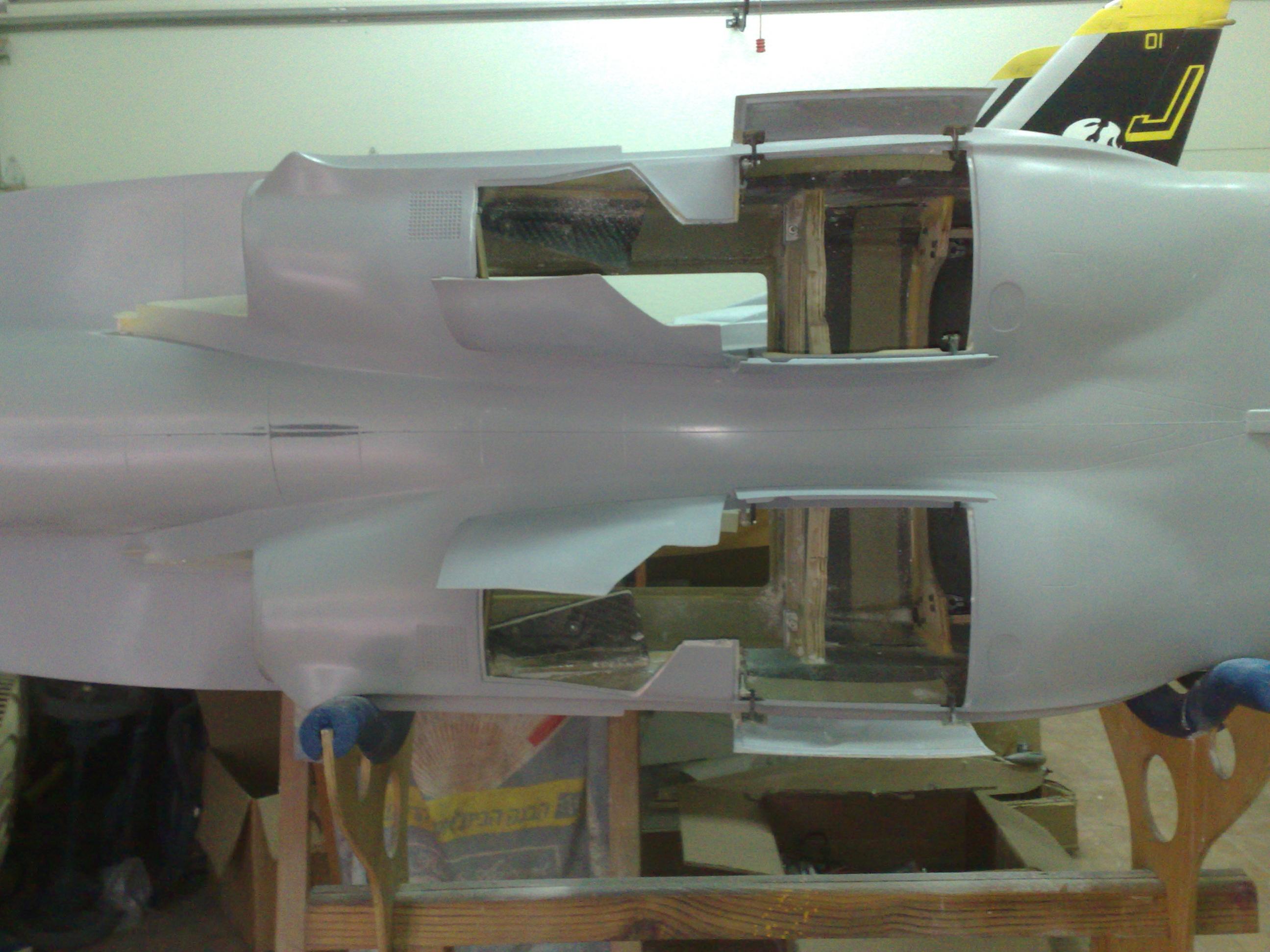

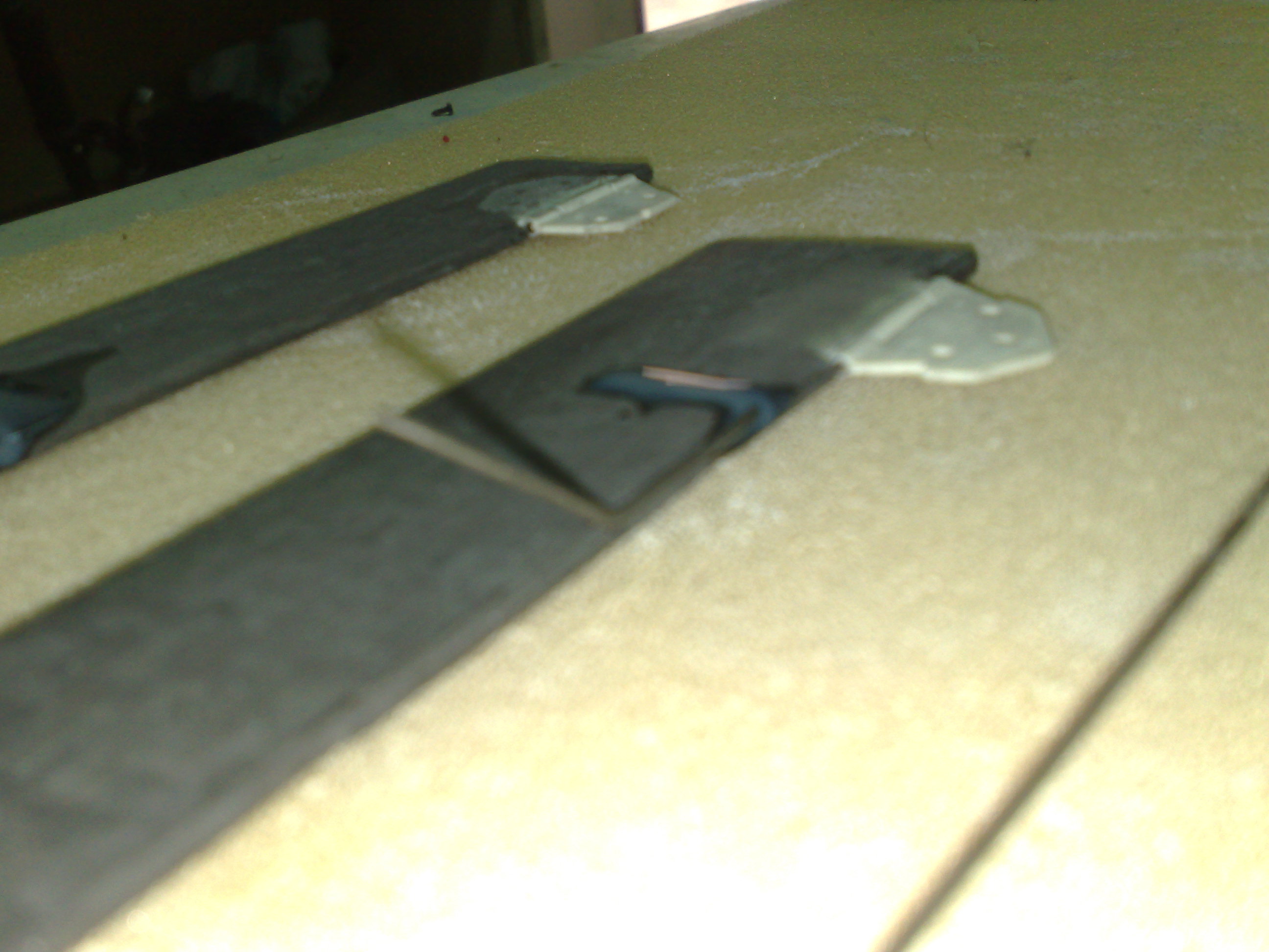

    more work on the wings....flaps at fully deployed position, "takeoff" and flight...

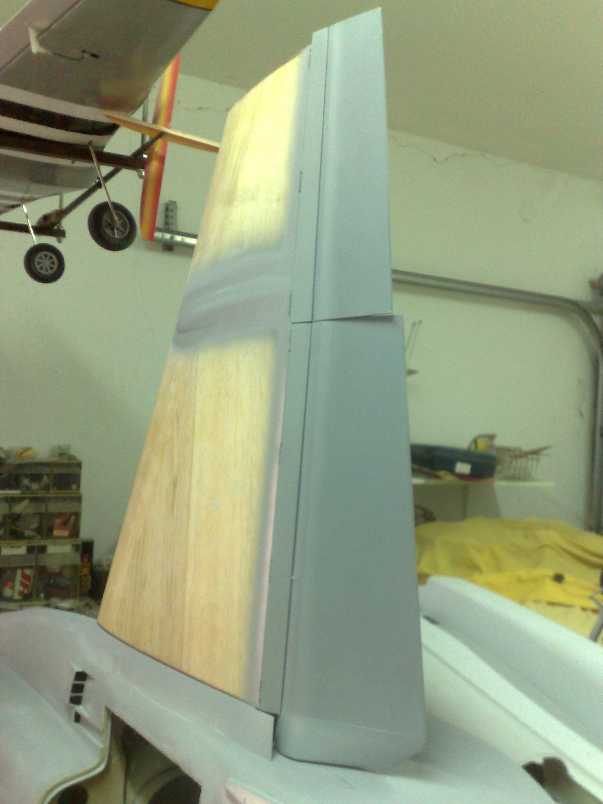

    Fins under work,filling gaps,:mad applying primer..... sanding

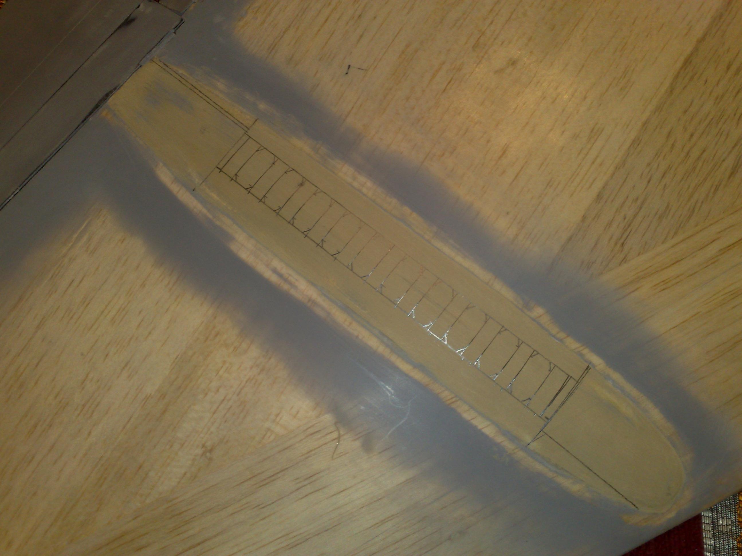

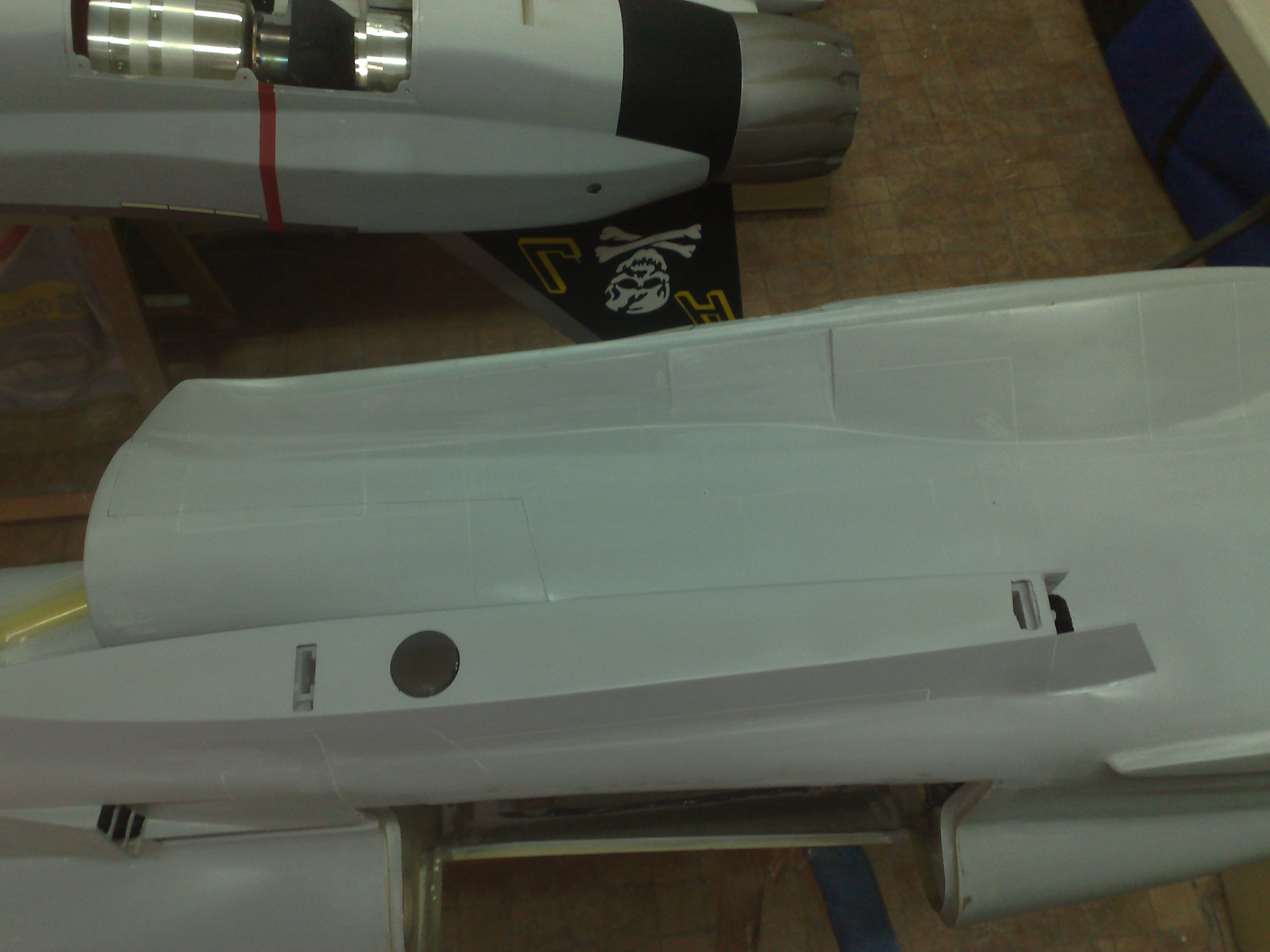

    Applying engraved panel lines

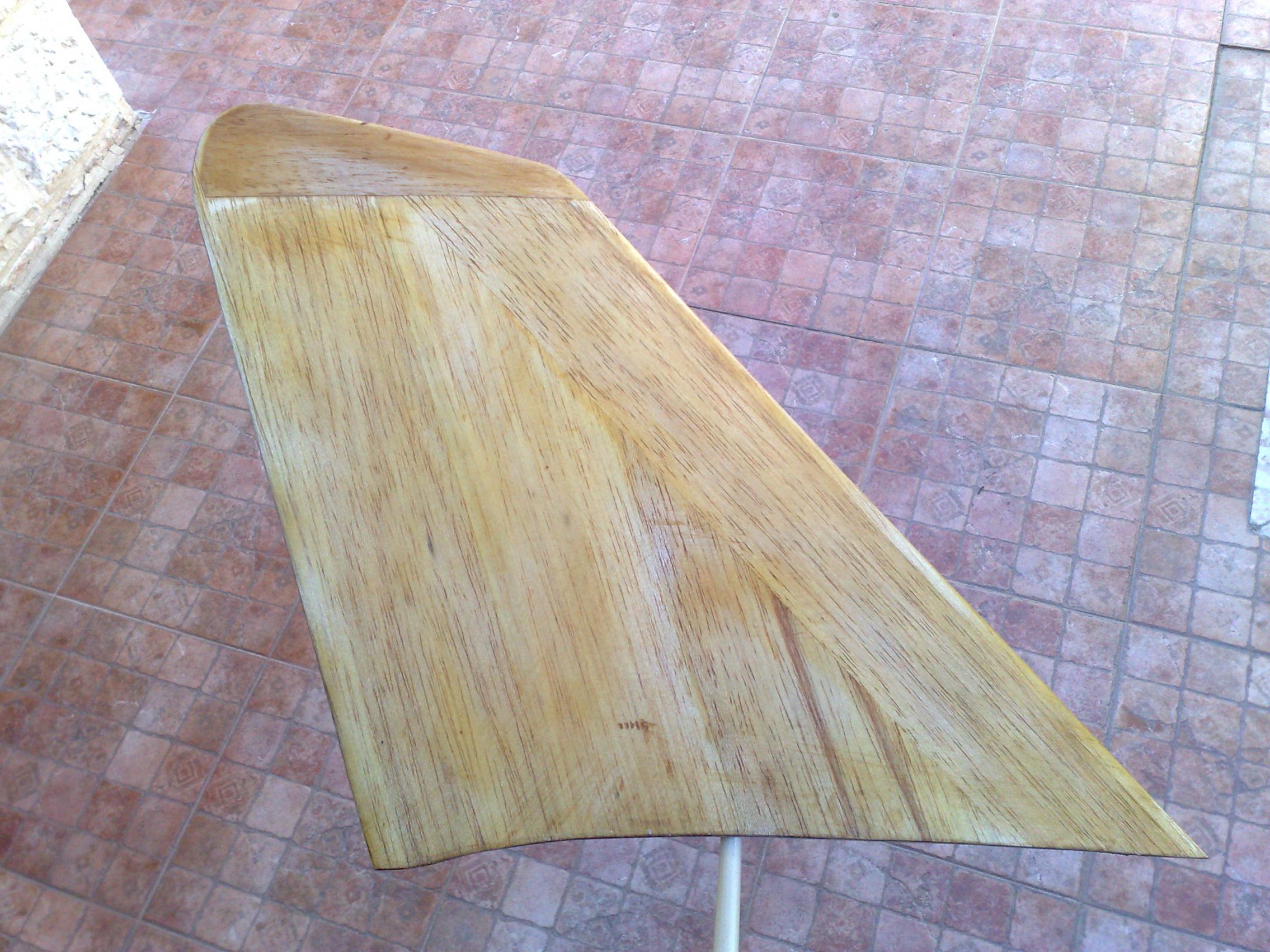

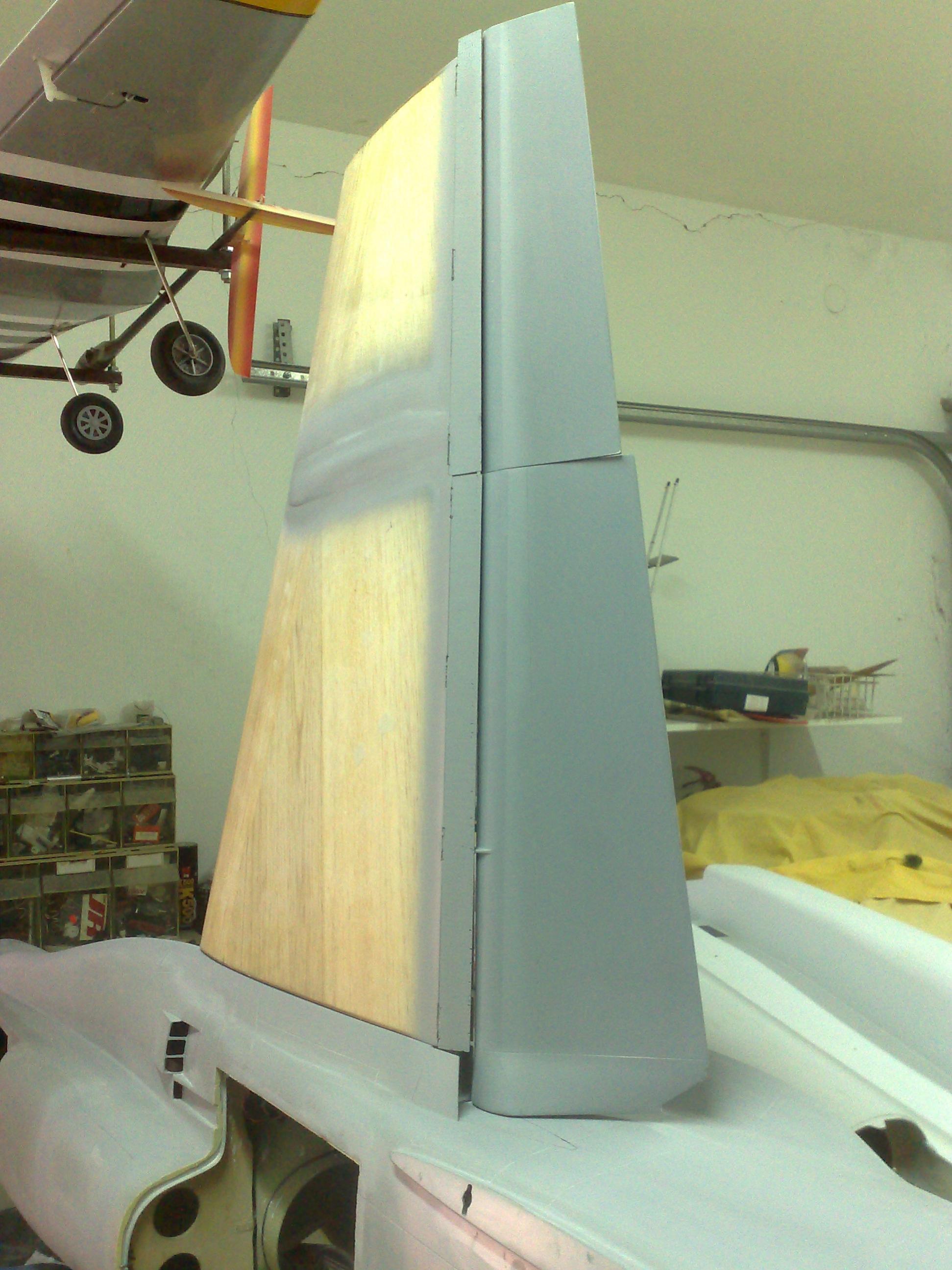

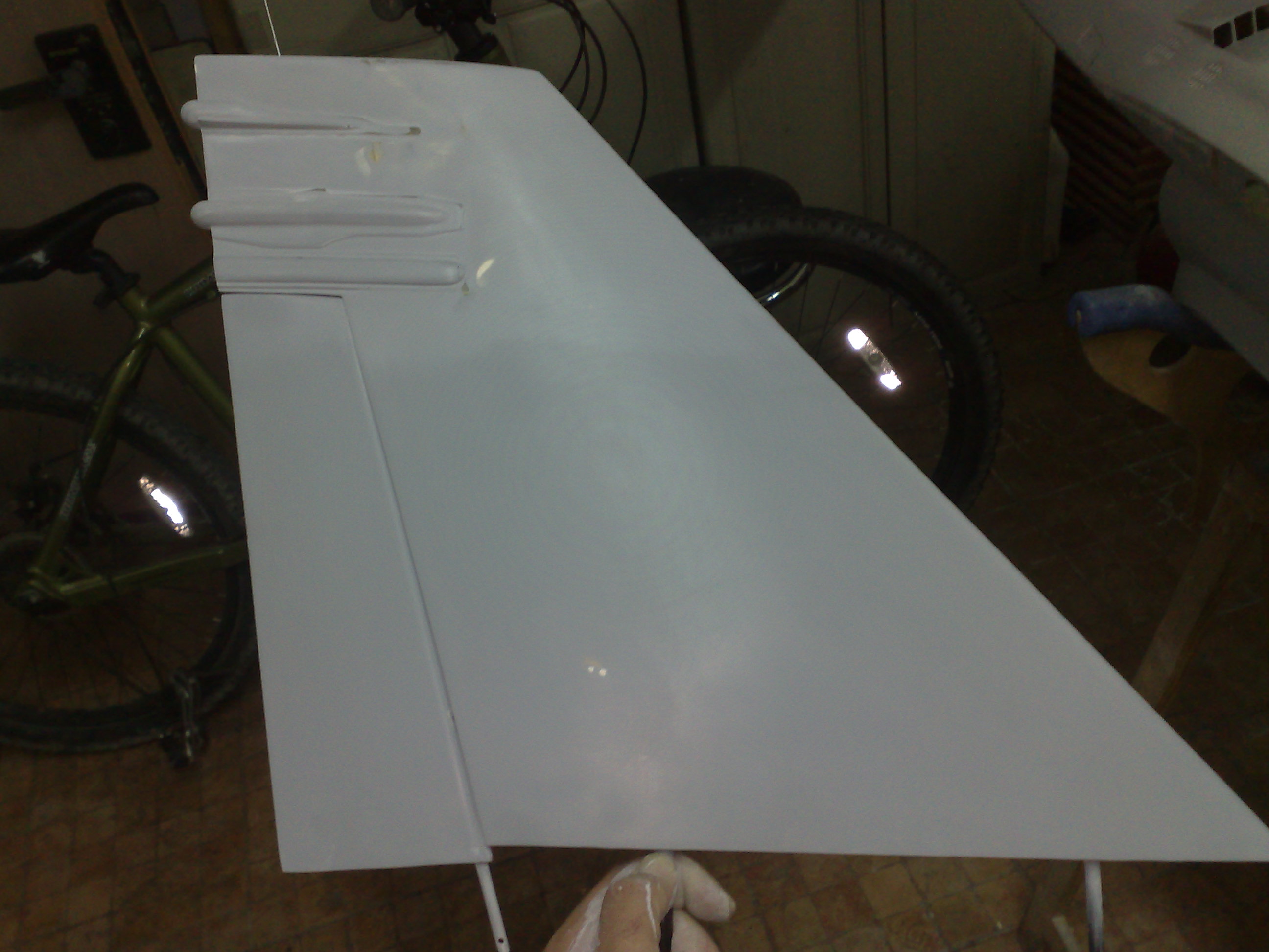

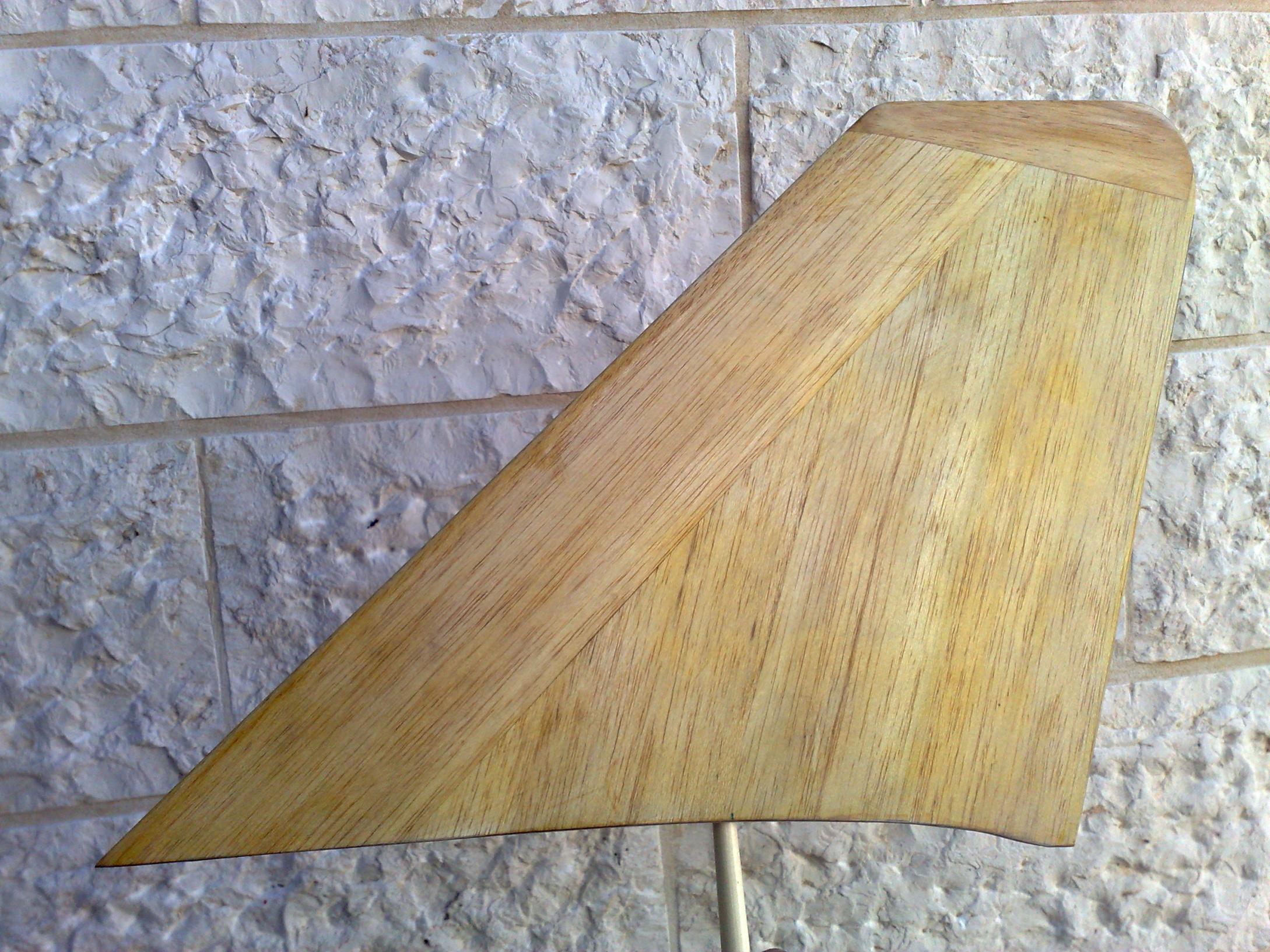

    Stabilizers finish under go...
Name:	Yellow Aircraft  F-18C twin build  project 037.jpg‏
ID:	28186   Click image for larger version.
Name:	Yellow Aircraft  F-18C twin build  project 038.jpg‏
ID:	28187   Click image for larger version.
Name:	Yellow Aircraft  F-18C twin build  project 044.jpg‏

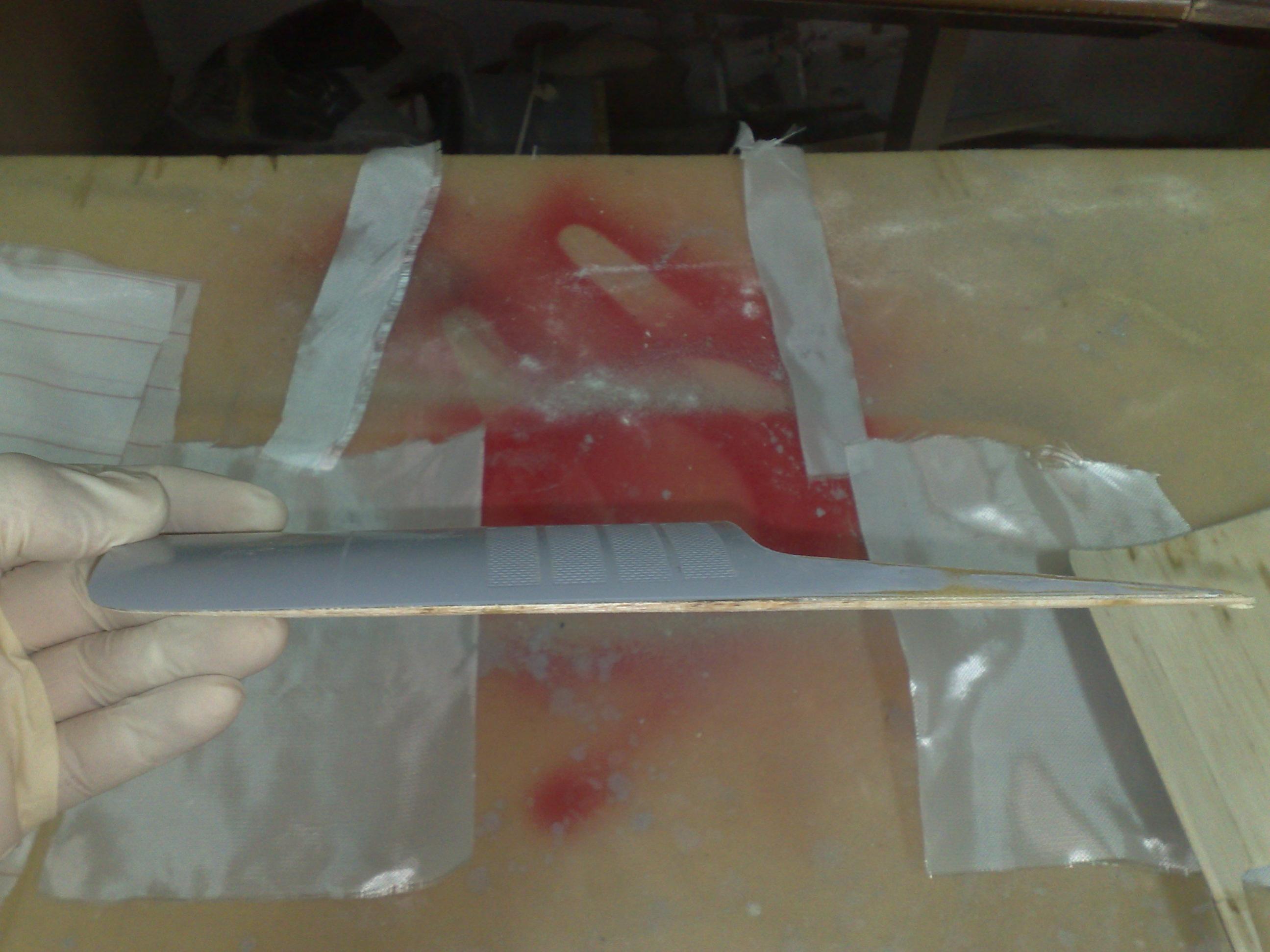

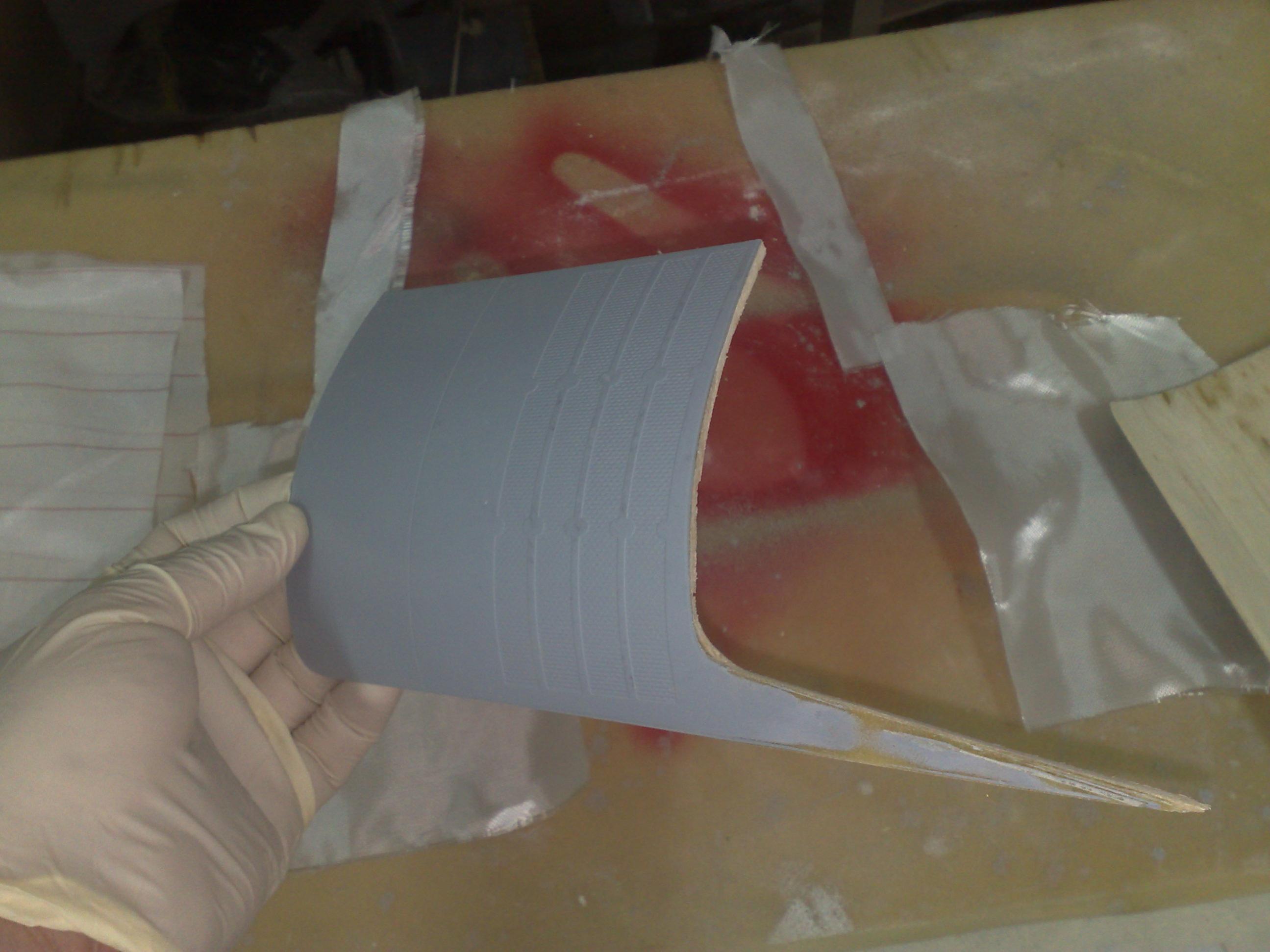

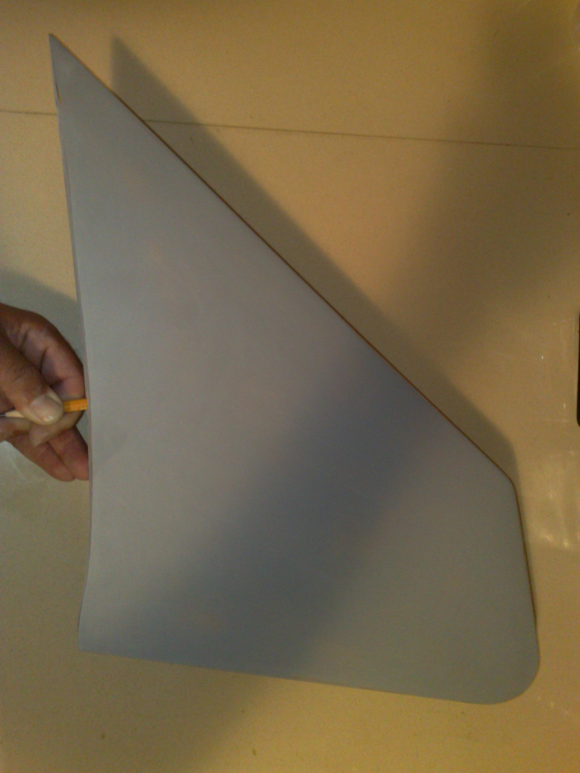

    Next I deal with the splitter plates, first step is laminating 1/8 balsa plank on the inner surface of the part and sanding down to a minimum the LE's
    after that covering the surface with 120g cloth and resin ....
Name:	Yellow Aircraft  F-18C twin build  project 046.jpg‏
ID:	28474   Click image for larger version.
Name:	Yellow Aircraft  F-18C twin build  project 047.jpg‏
ID:	28475   Click image for larger version.
Name:	Yellow Aircraft  F-18C twin build  project 048.jpg‏
ID:	28476   Click image for larger version.
Name:	Yellow Aircraft  F-18C twin build  project 049.jpg‏

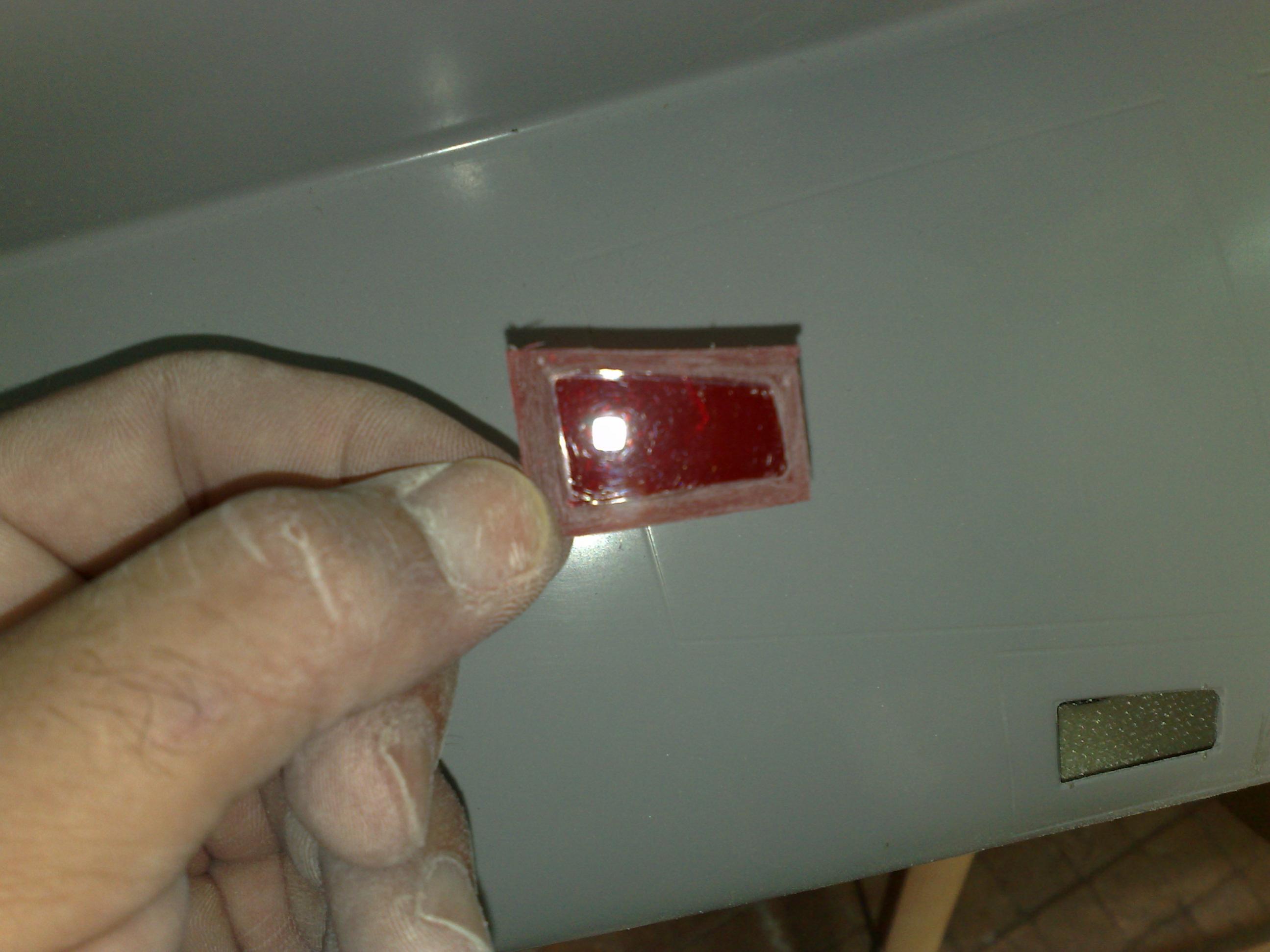

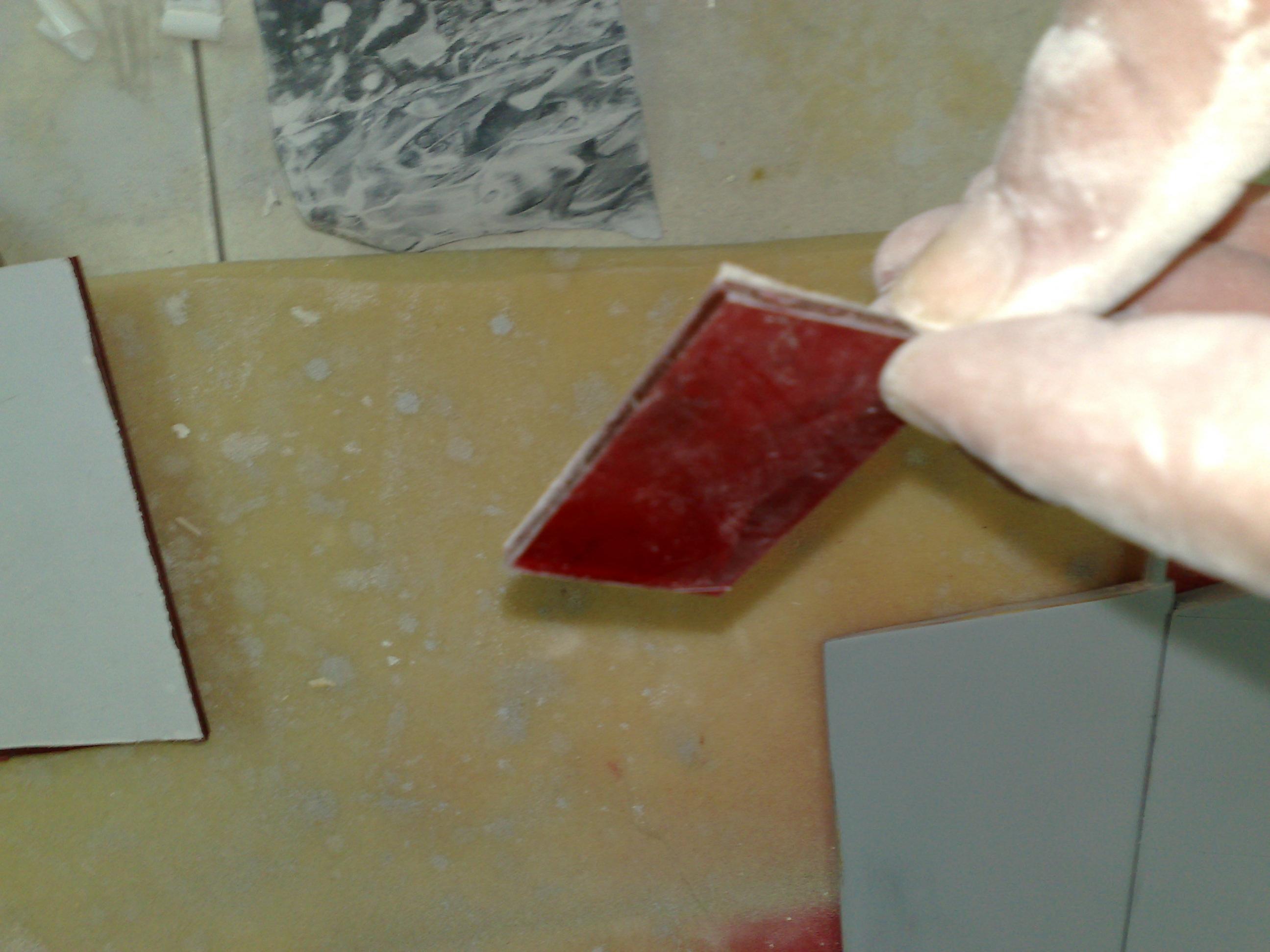

    Dec 2009
    1,242
    הודה 46 פעמים ב 44 הודעות
    Cool תגובה להודעה: שרשור בניה של F/A-18 1/7 של חברת YELLOW AIRCRAFT
    After glassing ,sanding filling and co for so long I've decided to do something diffrent today.....
    Preparation of possition lights red port side first...
