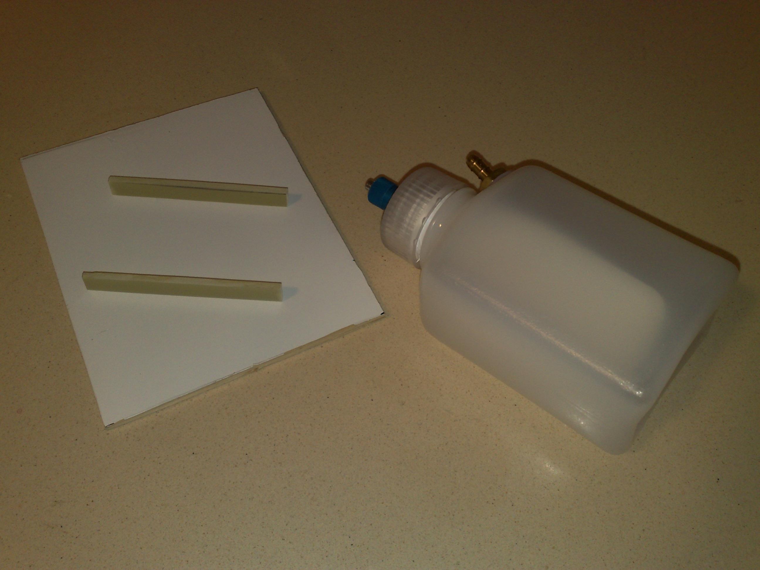

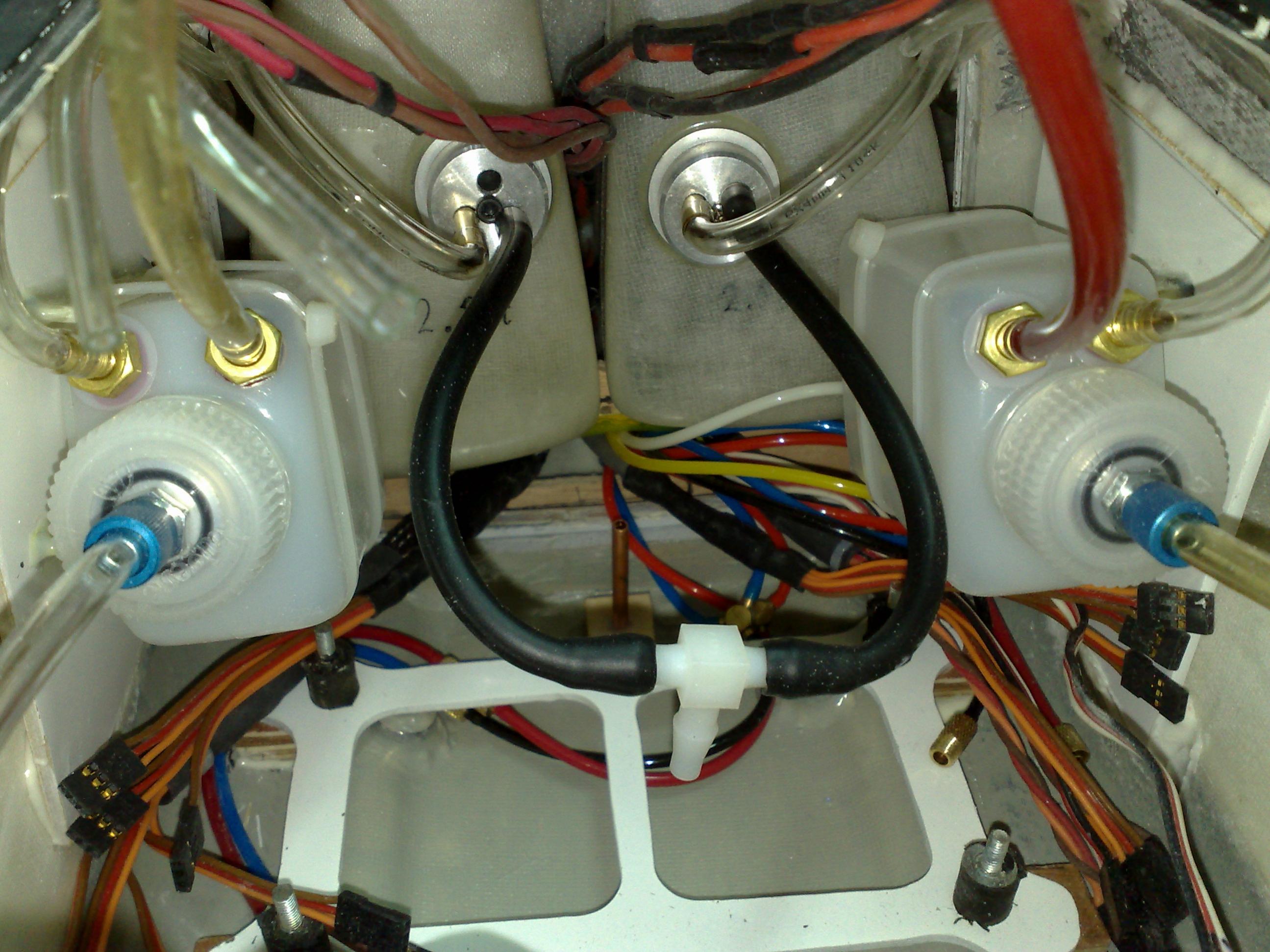

    Some pictures to describe the U.A.T mounts preparation....I have found that the most suitable location for the two hopper tanks is in front of the two main tanks in the forward section of the fuselage
    in the last picture tha two U.A.T's installed ..wiring yet to be neatly tied away....so please disregard the "mess" folks ..

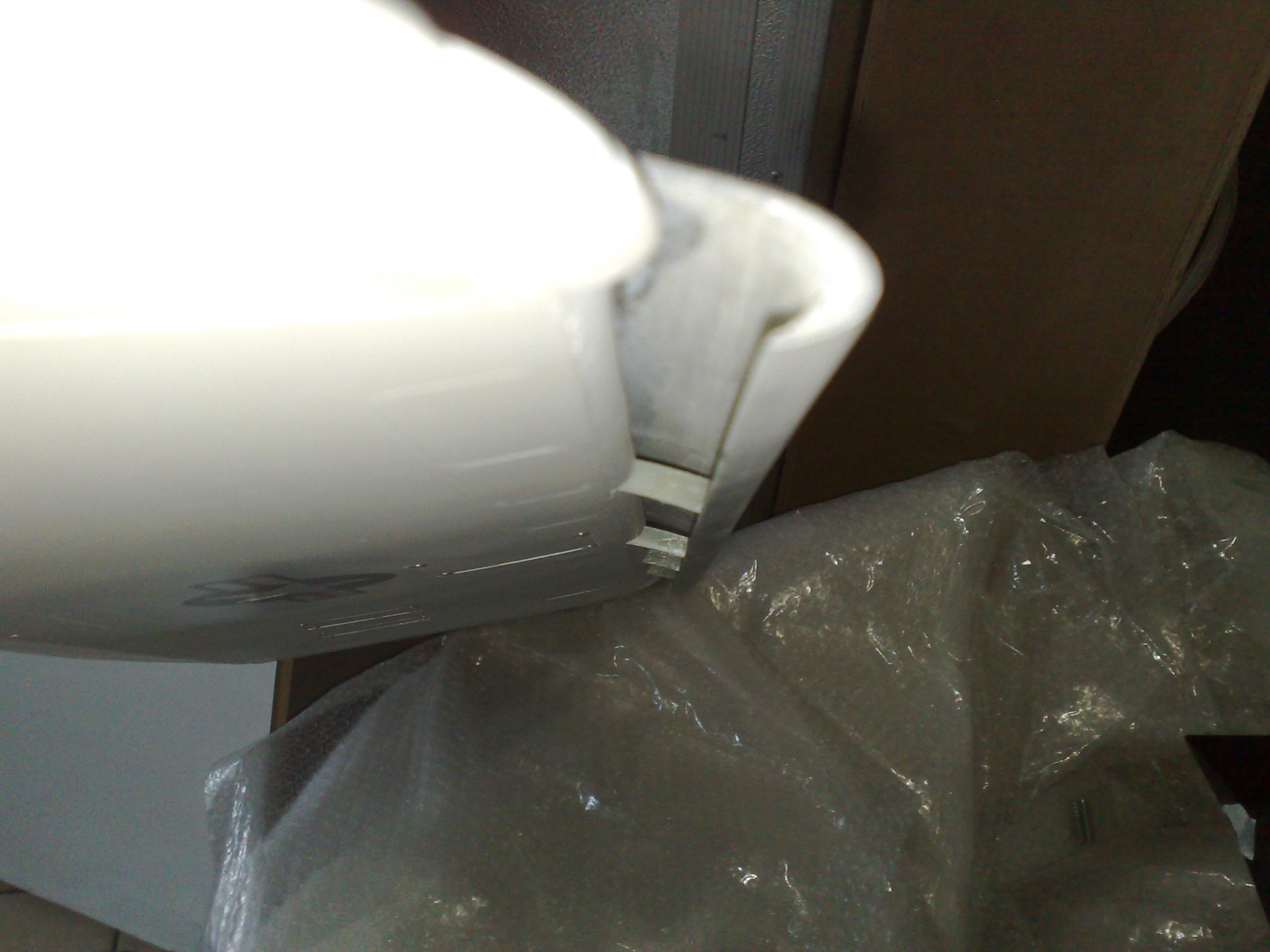

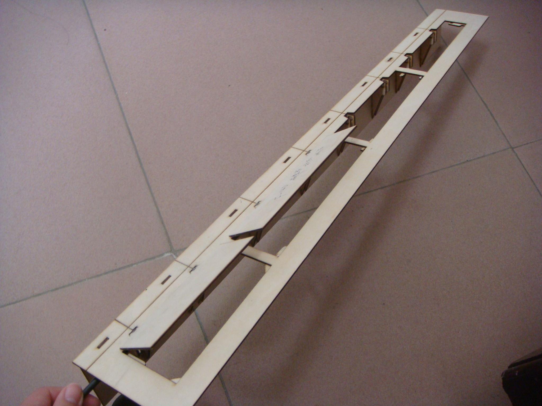

    Some more updates on the wings development first the new L/E slats....

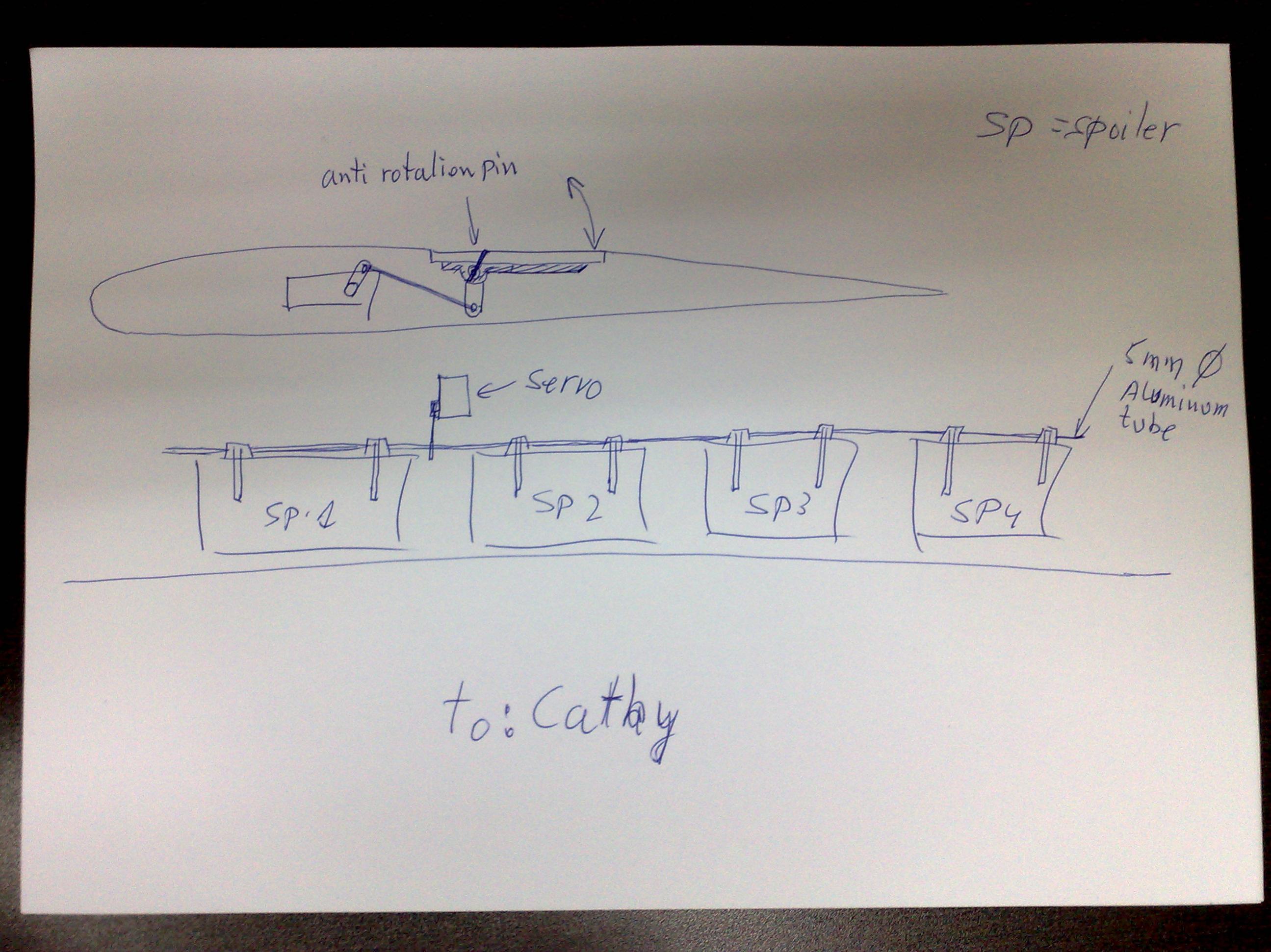

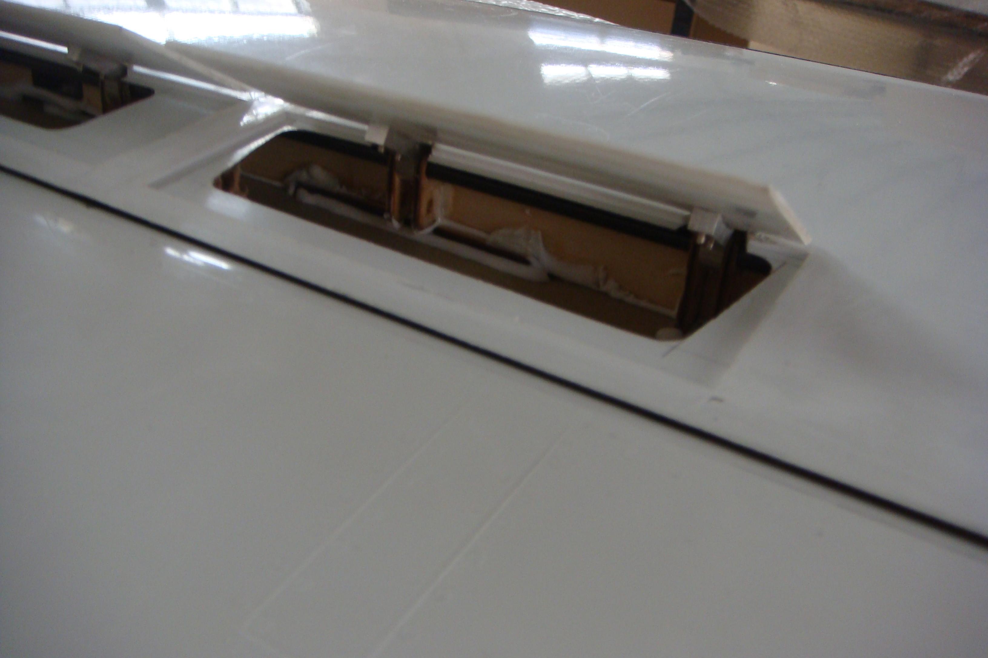

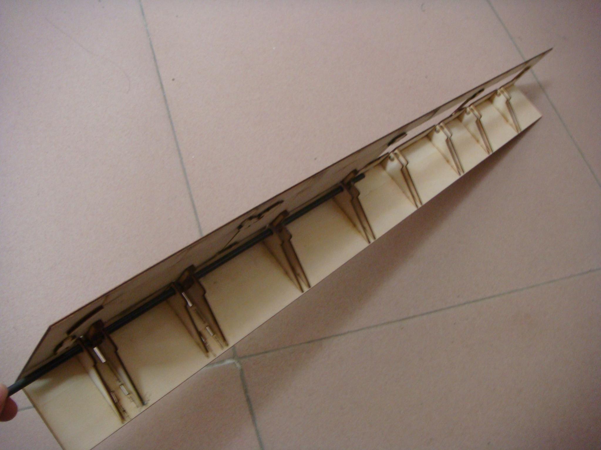

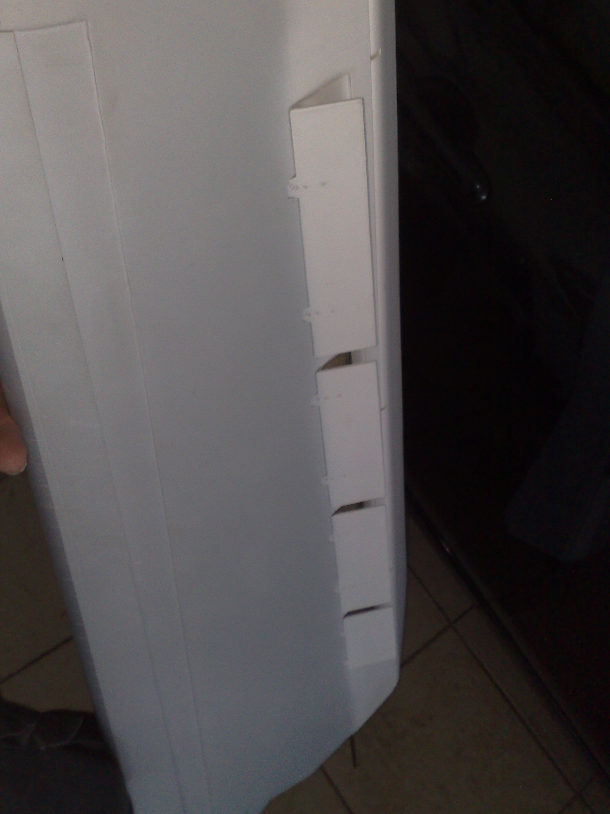

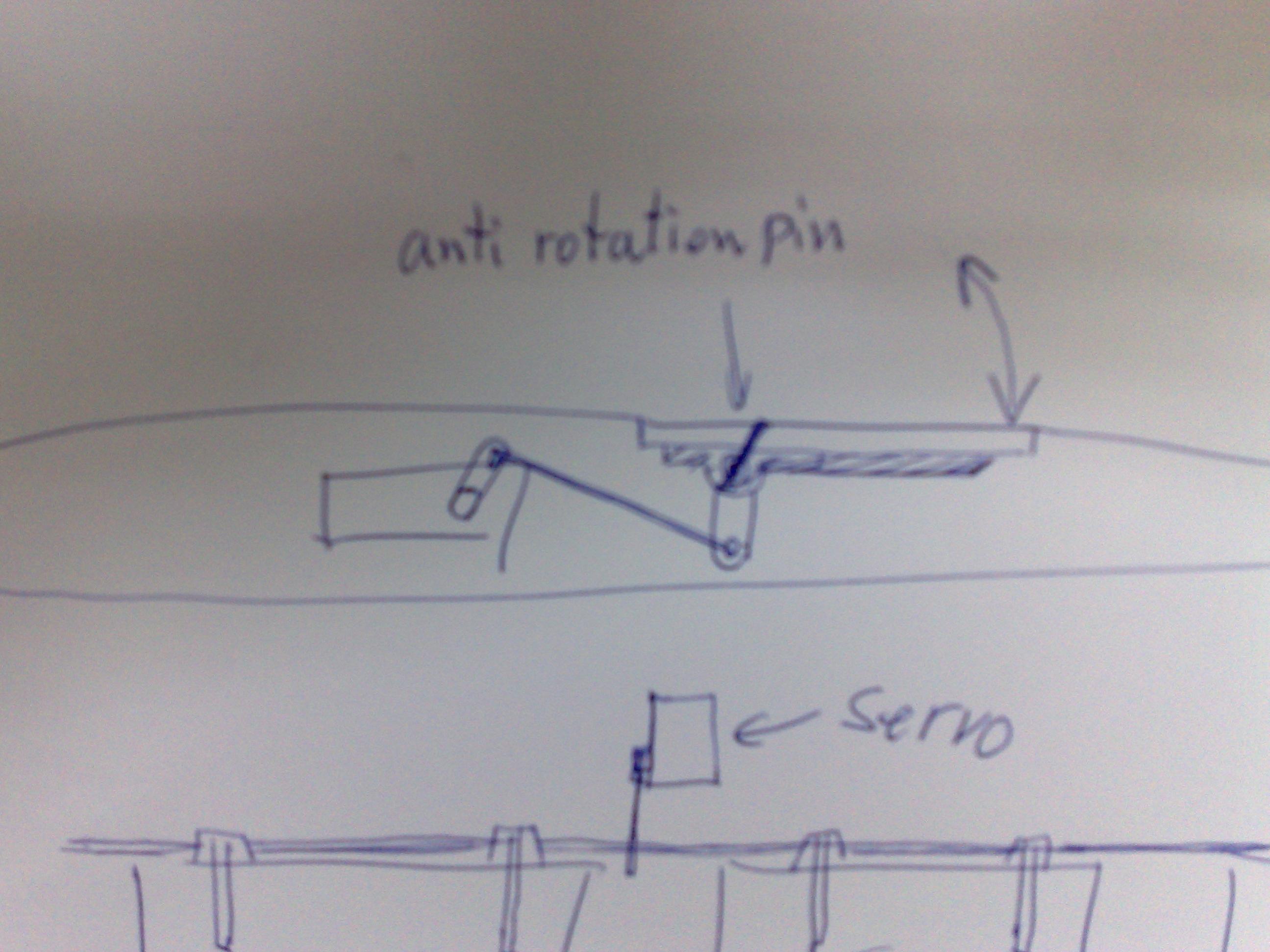

    Next.....the upper wing spoilers from scribles i.e free hand drawing to prototype part form
Name:	Fouga project 001.jpg‏
ID:	24448   Click image for larger version.
Name:	Fouga project 002.jpg‏
ID:	24449   Click image for larger version.
ID:	24450   Click image for larger version.

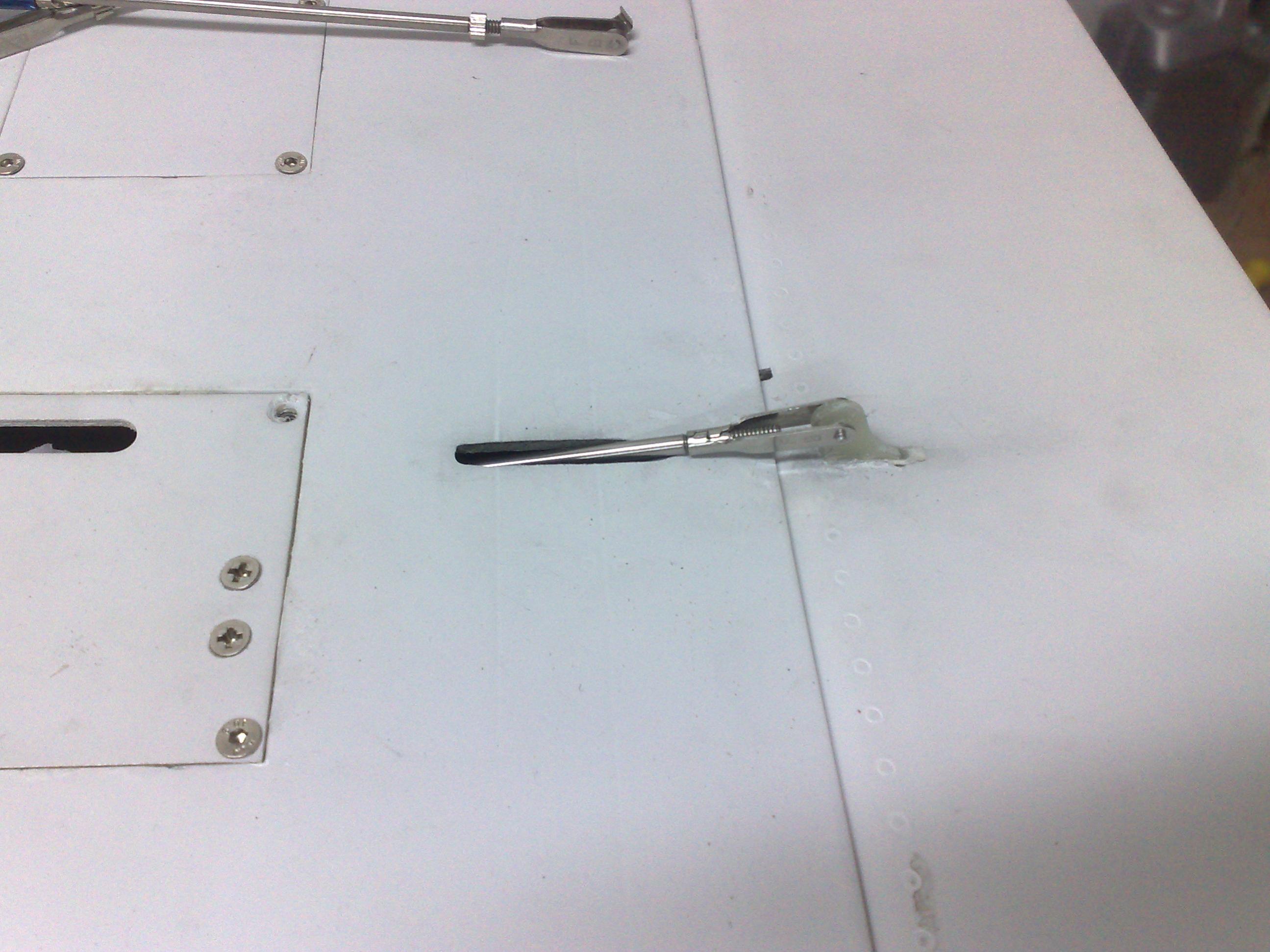

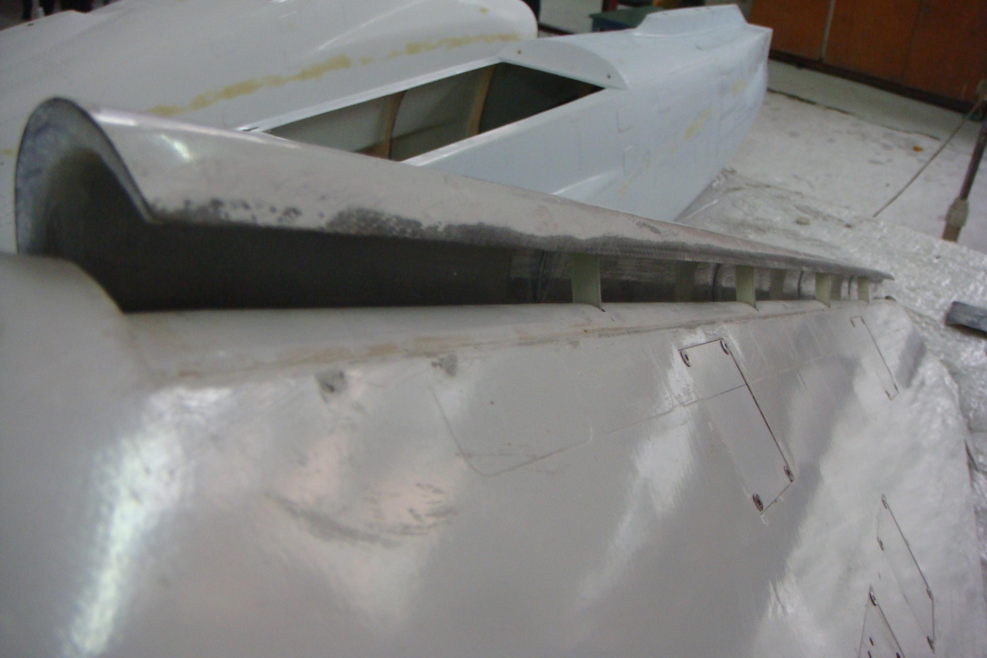

    Some more pic's of the wings L/E slats open.....

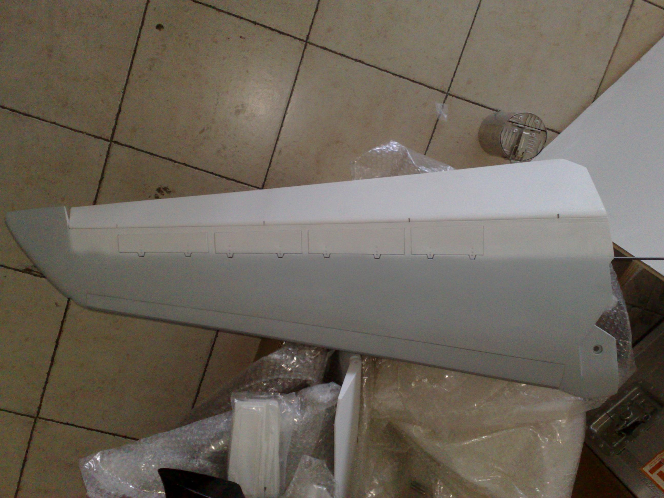

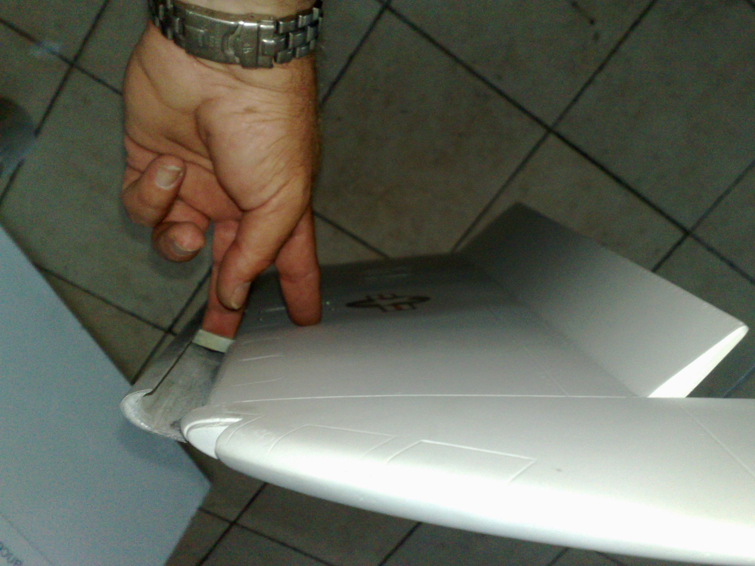

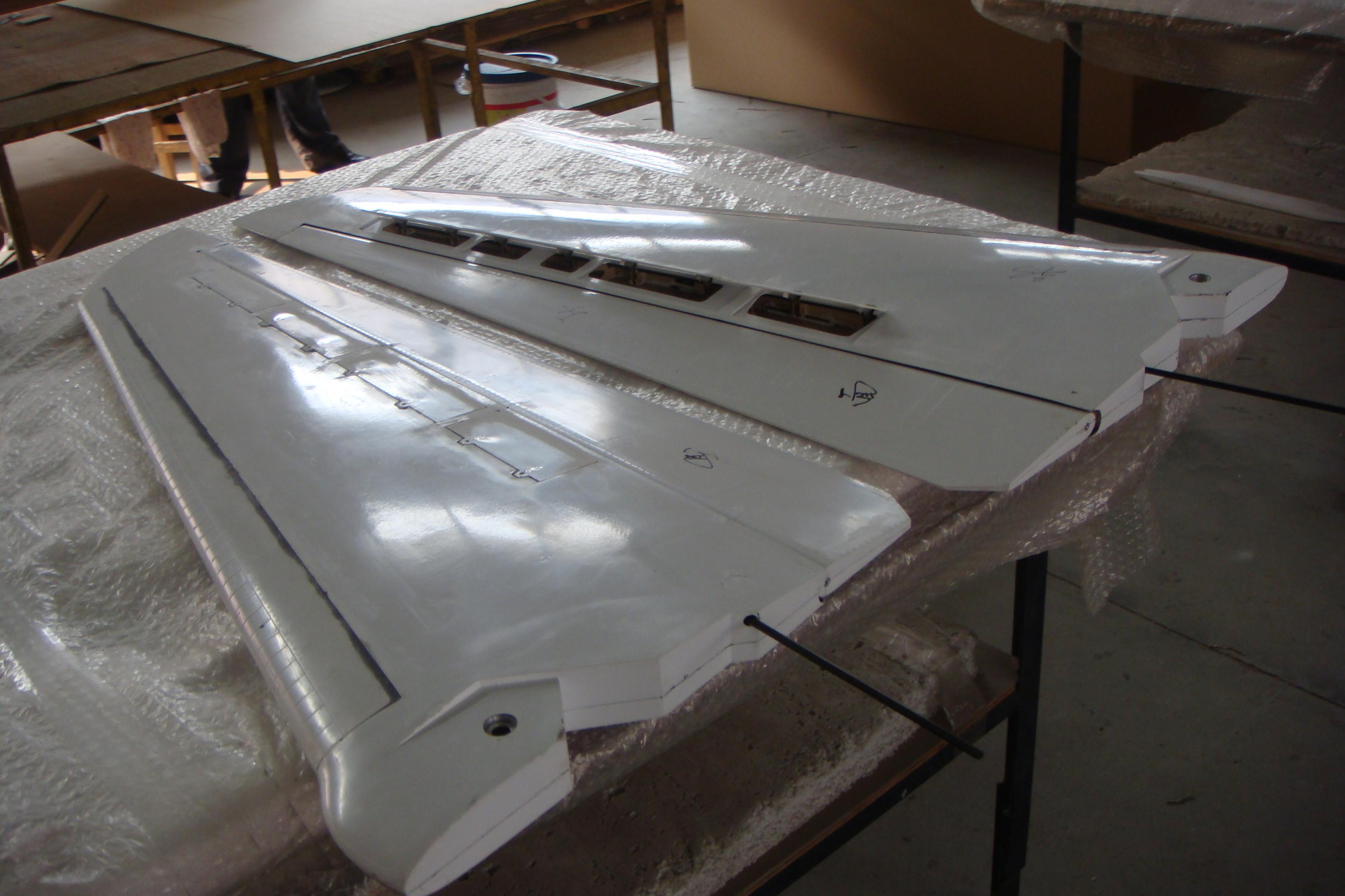

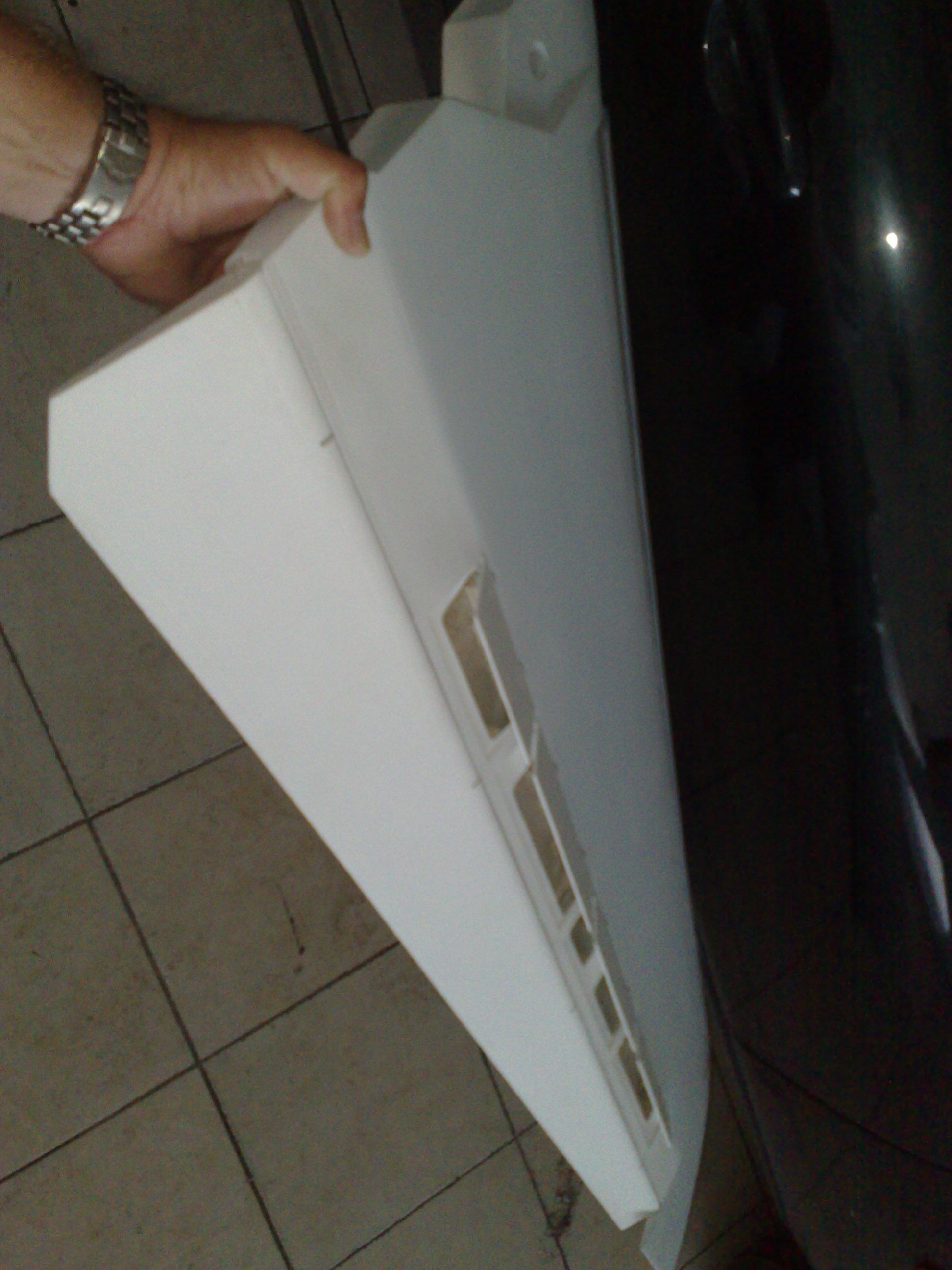

    Finally new wings are done and in my hot little hands
Name:	F-14 Twin project misc' pics 009.jpg‏
ID:	32111   Click image for larger version.
Name:	F-14 Twin project misc' pics 010.jpg‏
ID:	32112   Click image for larger version.
Name:	F-14 Twin project misc' pics 011.jpg‏
ID:	32113   Click image for larger version.
Name:	F-14 Twin project misc' pics 012.jpg‏
ID:	32114   Click image for larger version.
Name:	F-14 Twin project misc' pics 013.jpg‏

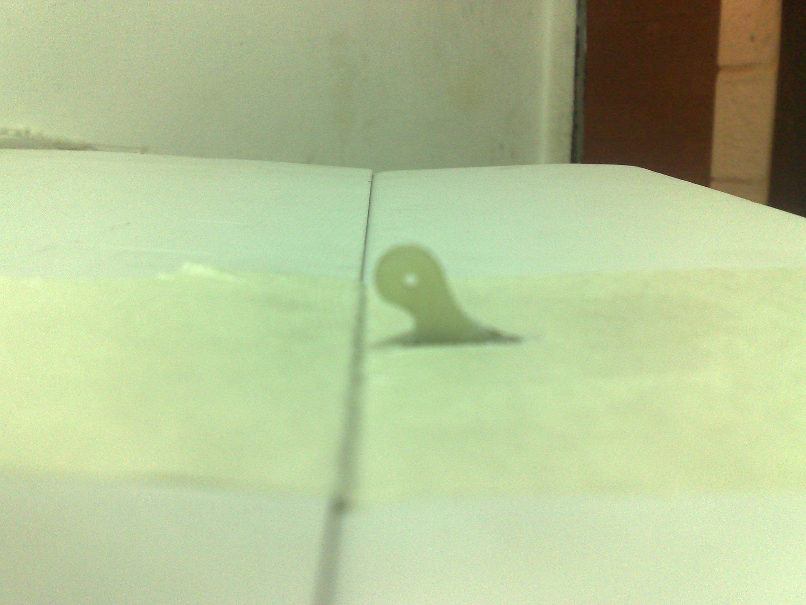

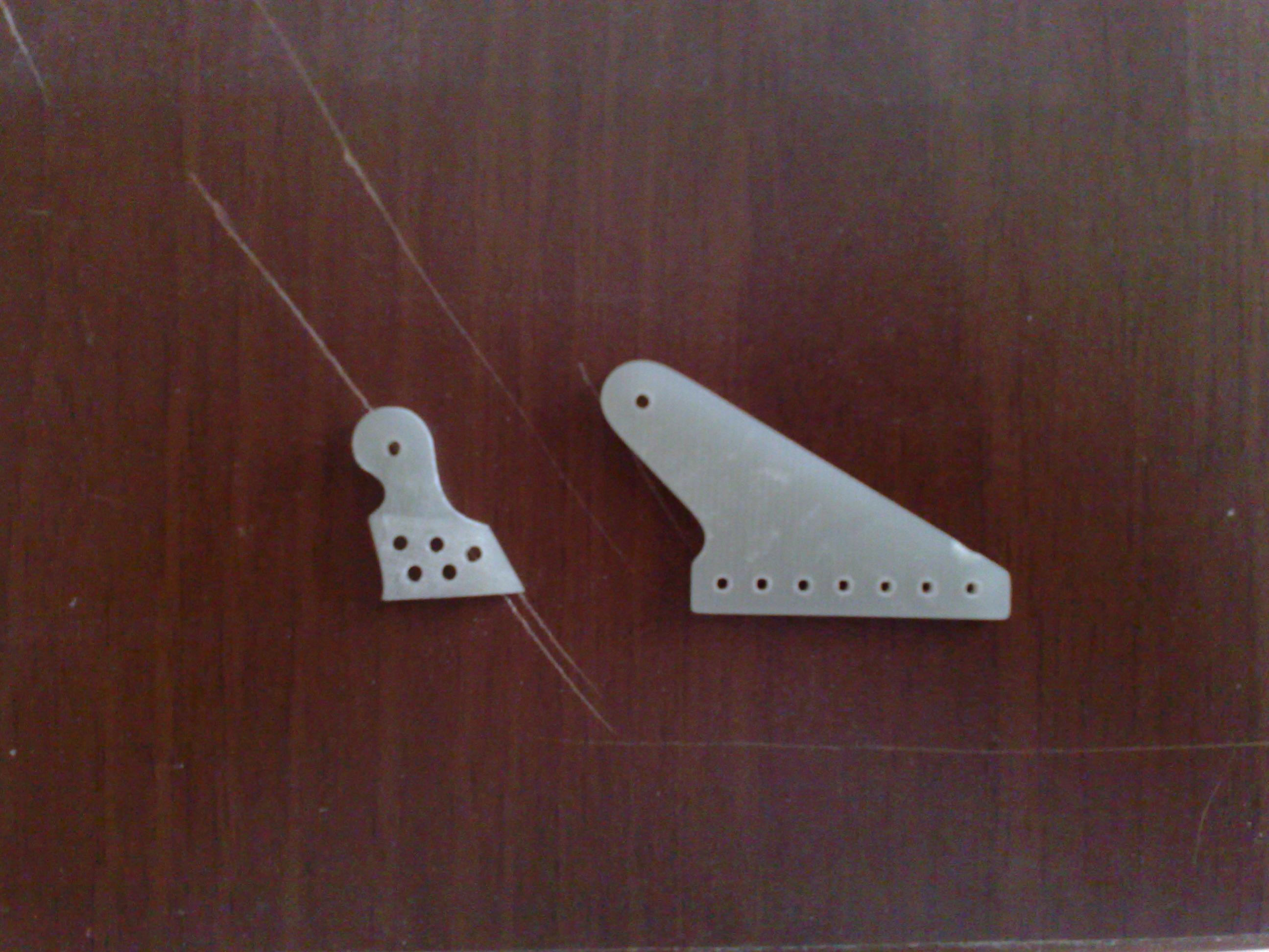

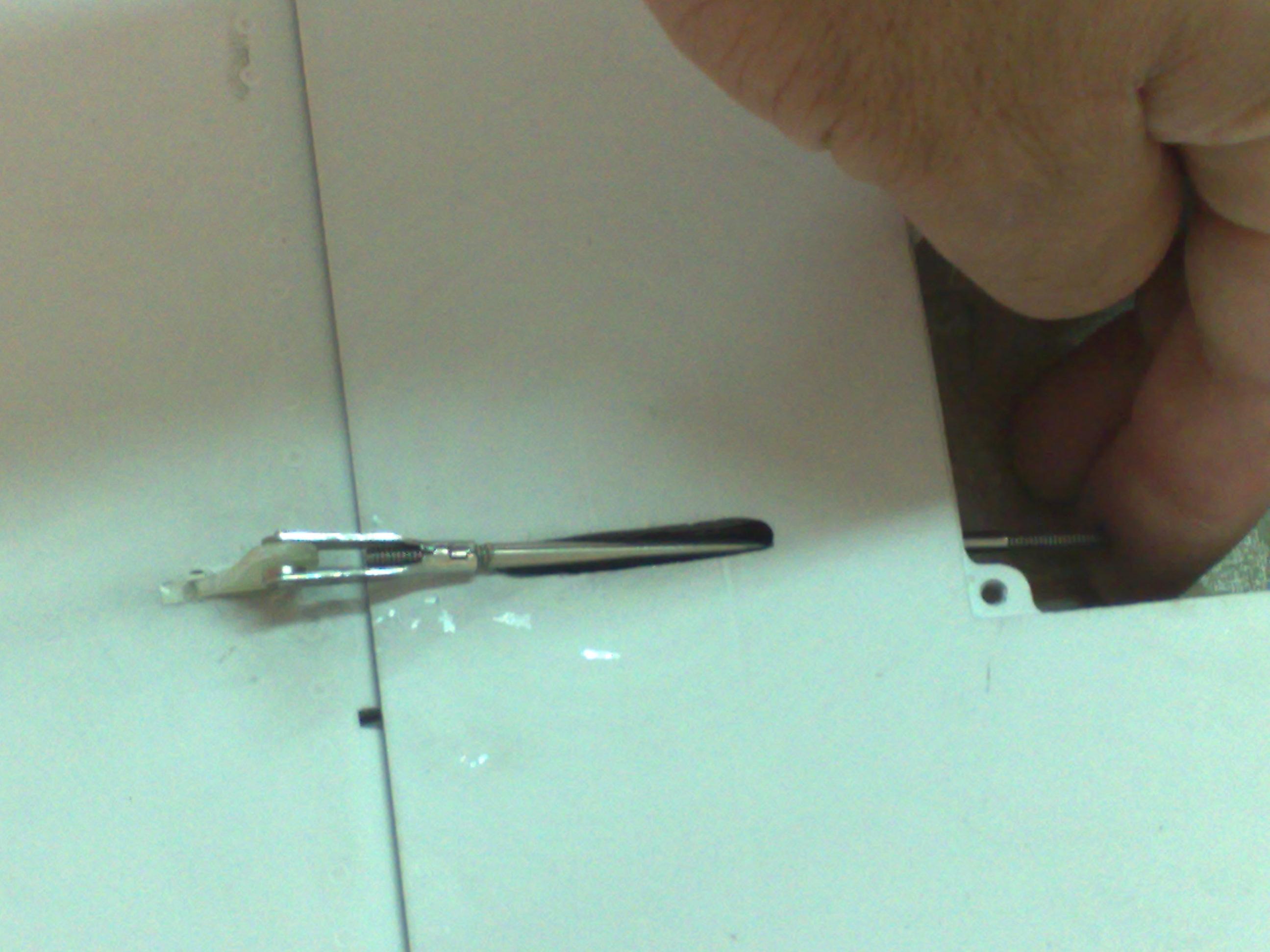

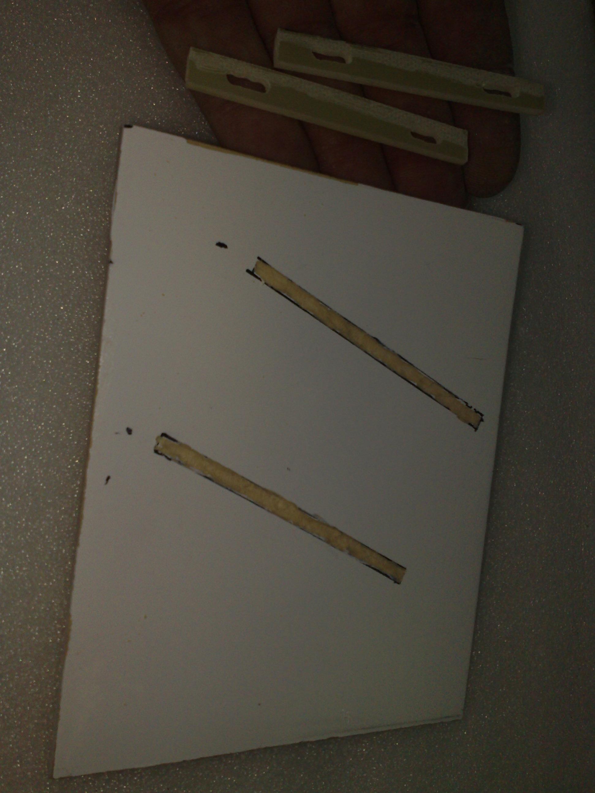

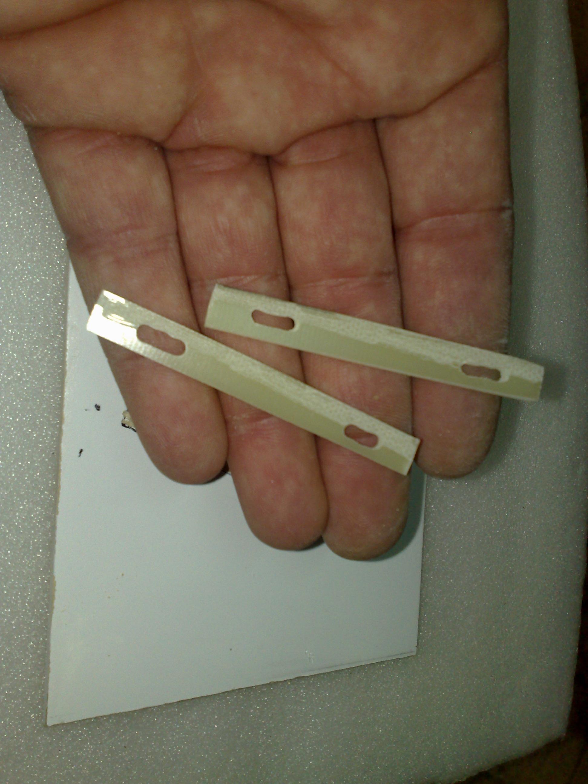

    Preparation of Flap Horns.....
Name:	F-14D Project 019.jpg‏
ID:	32568   Click image for larger version.
Name:	F-14D Project 023.jpg‏
ID:	32569   Click image for larger version.
Name:	F-14D Project 020.jpg‏
ID:	32570   Click image for larger version.
Name:	F-14D Project 021.jpg‏
ID:	32571   Click image for larger version.
Name:	F-14D Project 022.jpg‏

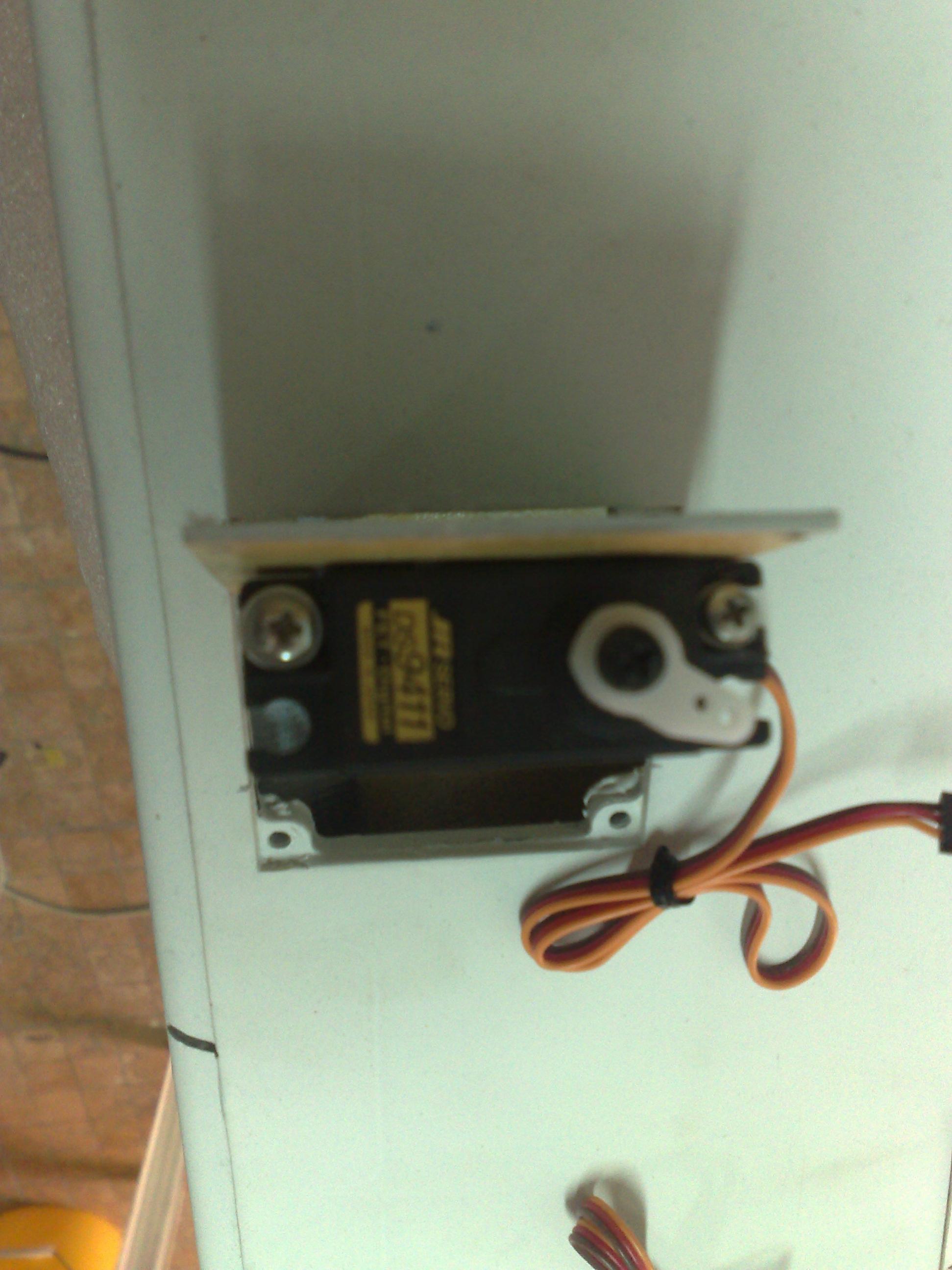

    ברירת מחדל תגובה להודעה: F-14D

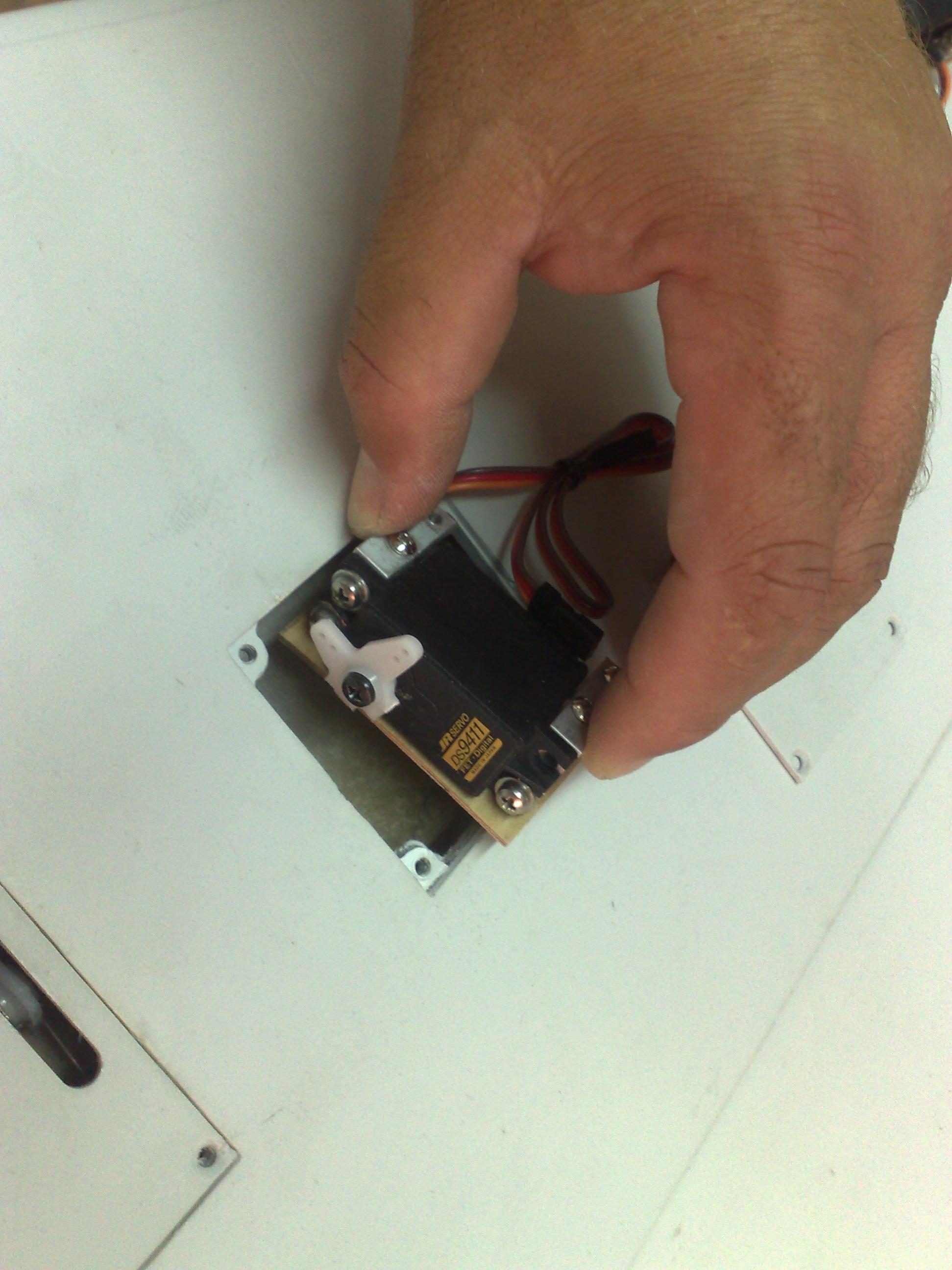

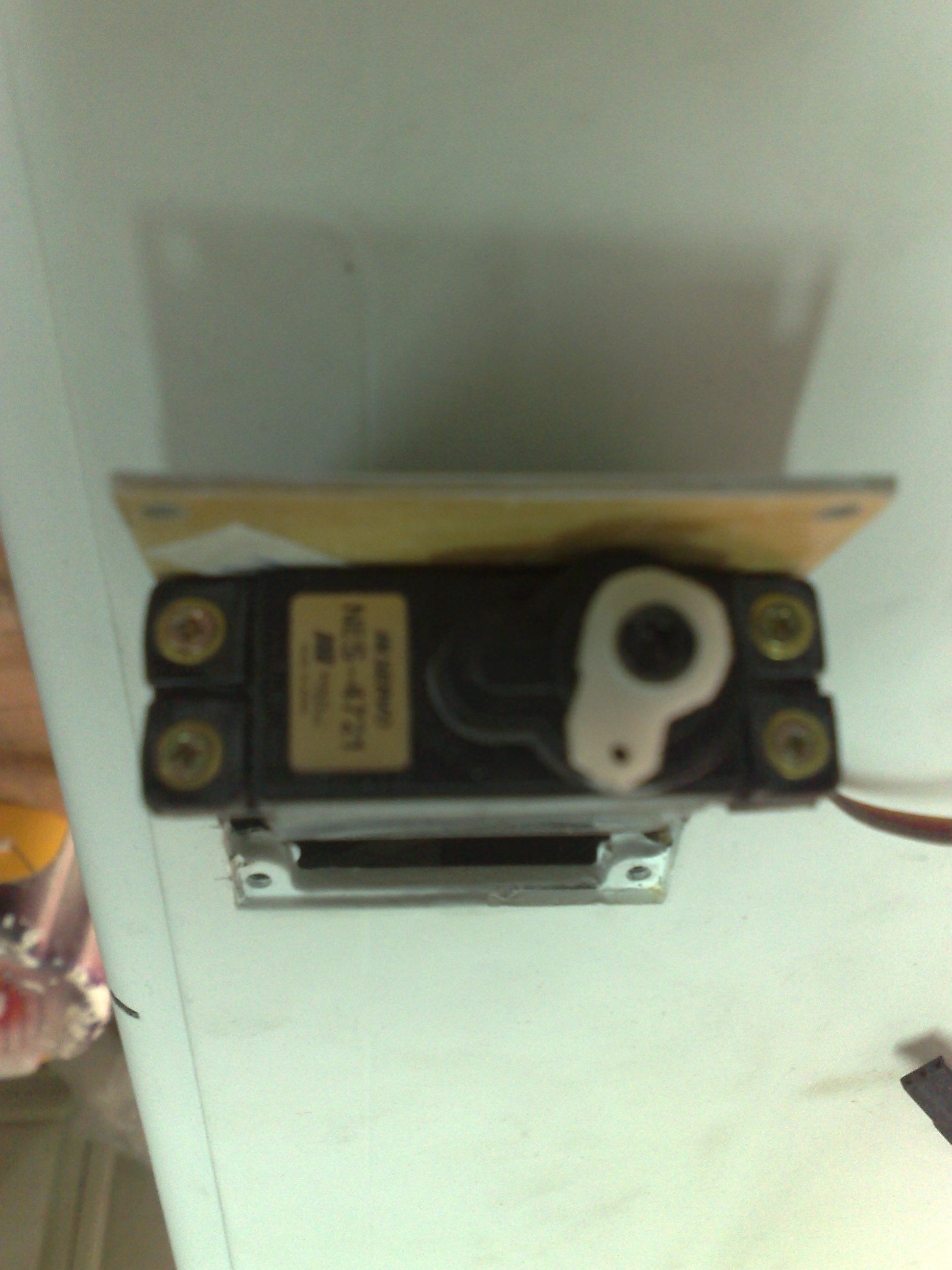

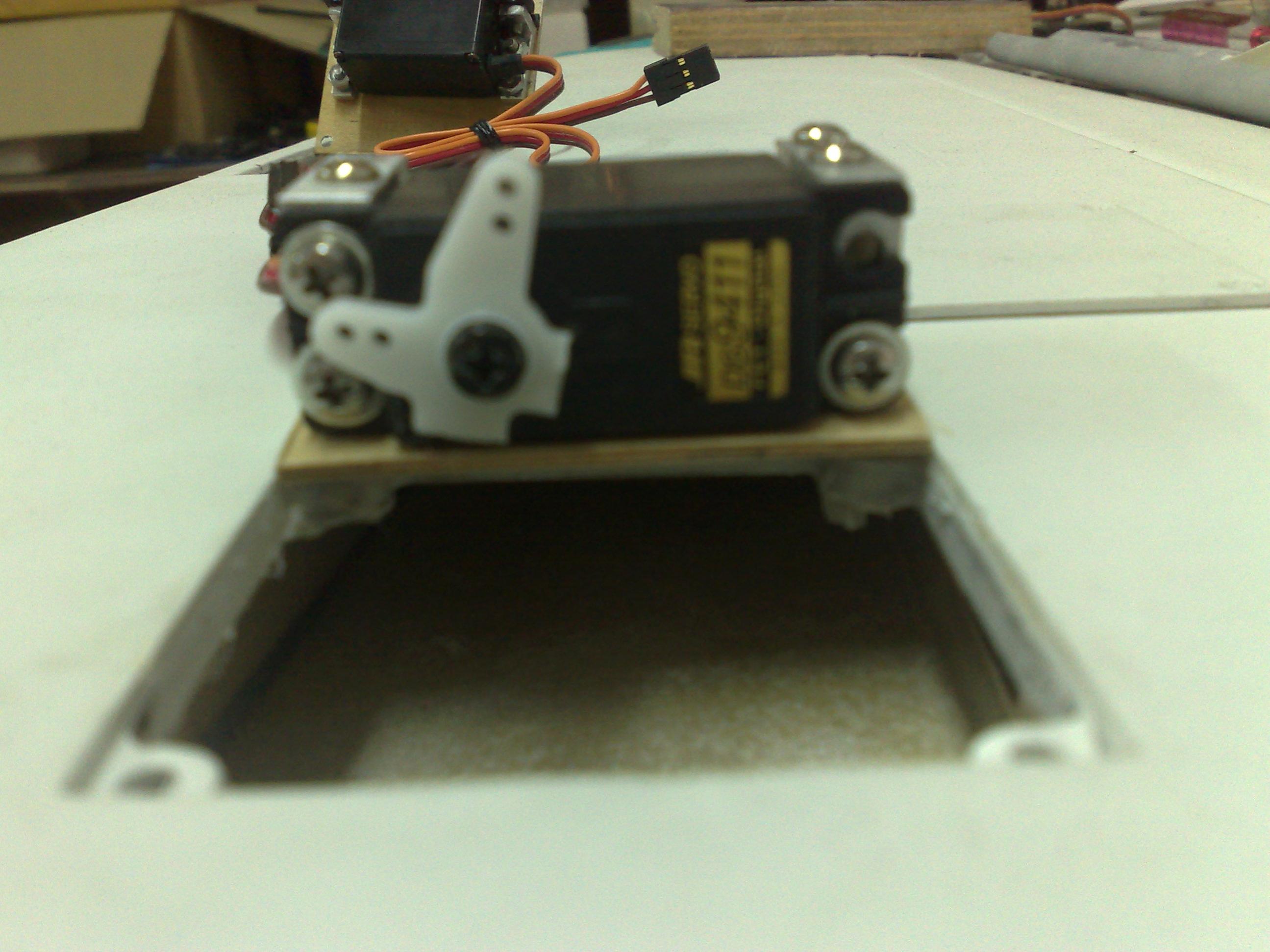

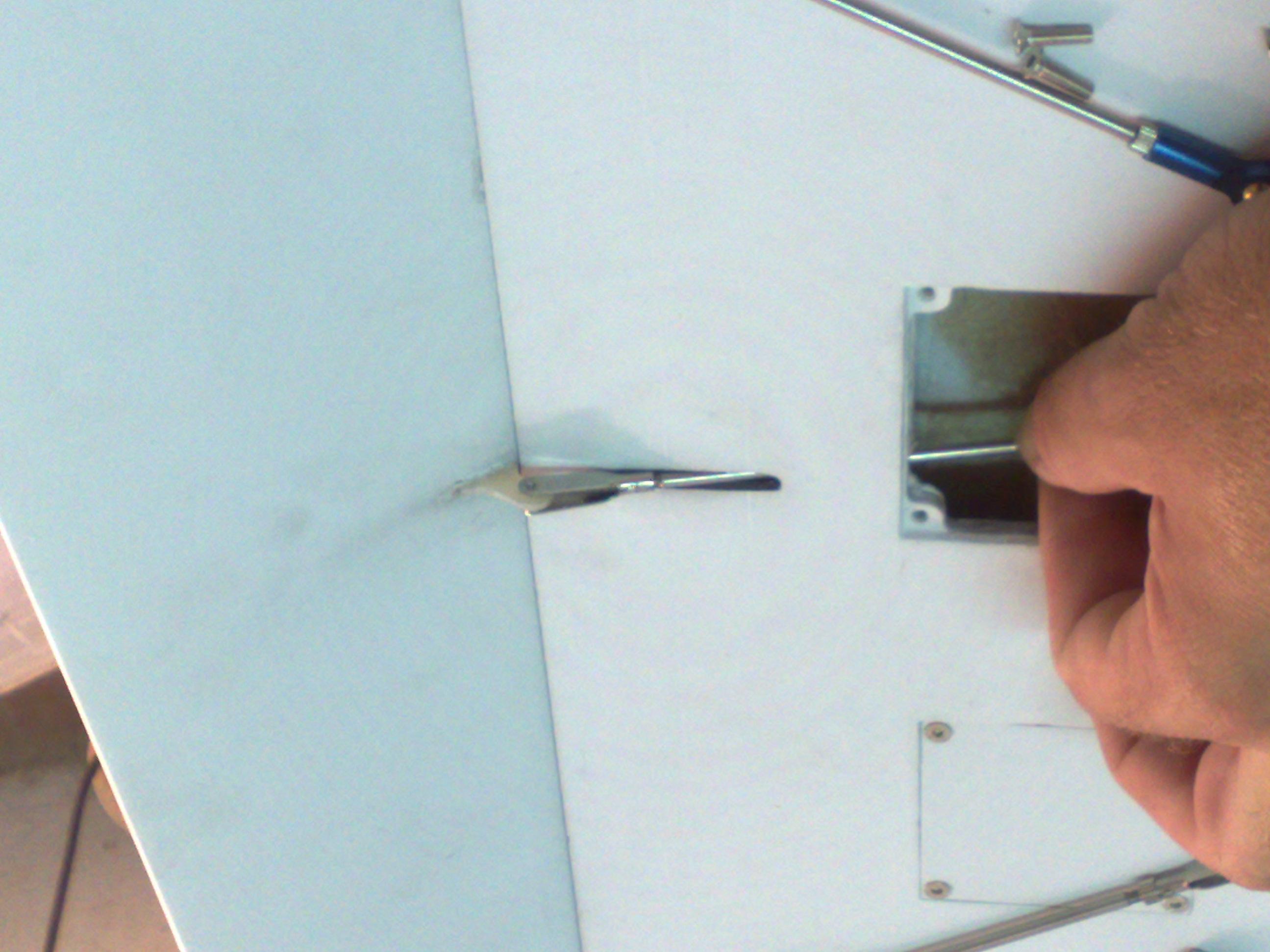

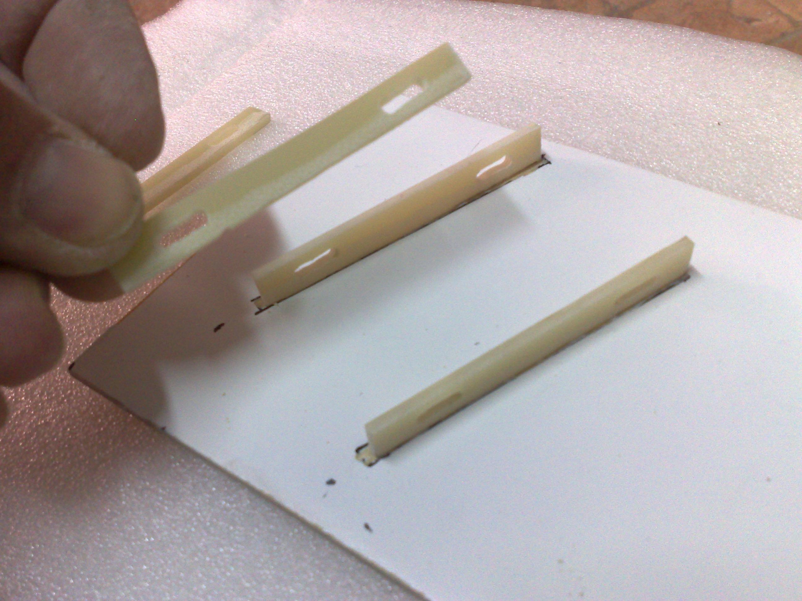

    More servo installations this time these are the Leading Edge Slats actuator
    servos and Spoiler servos
    The servos picked for the L/E Slats are JR mid size DS9411 for the outer servo location and JR 2741 for the inner location in the wing ...inner means closer to the wing root
Name:	F-14 Twin project misc' pics 021.jpg‏
ID:	33525   Click image for larger version.
Name:	F-14 Twin project misc' pics 022.jpg‏
ID:	33526   Click image for larger version.
Name:	F-14 Twin project misc' pics 023.jpg‏

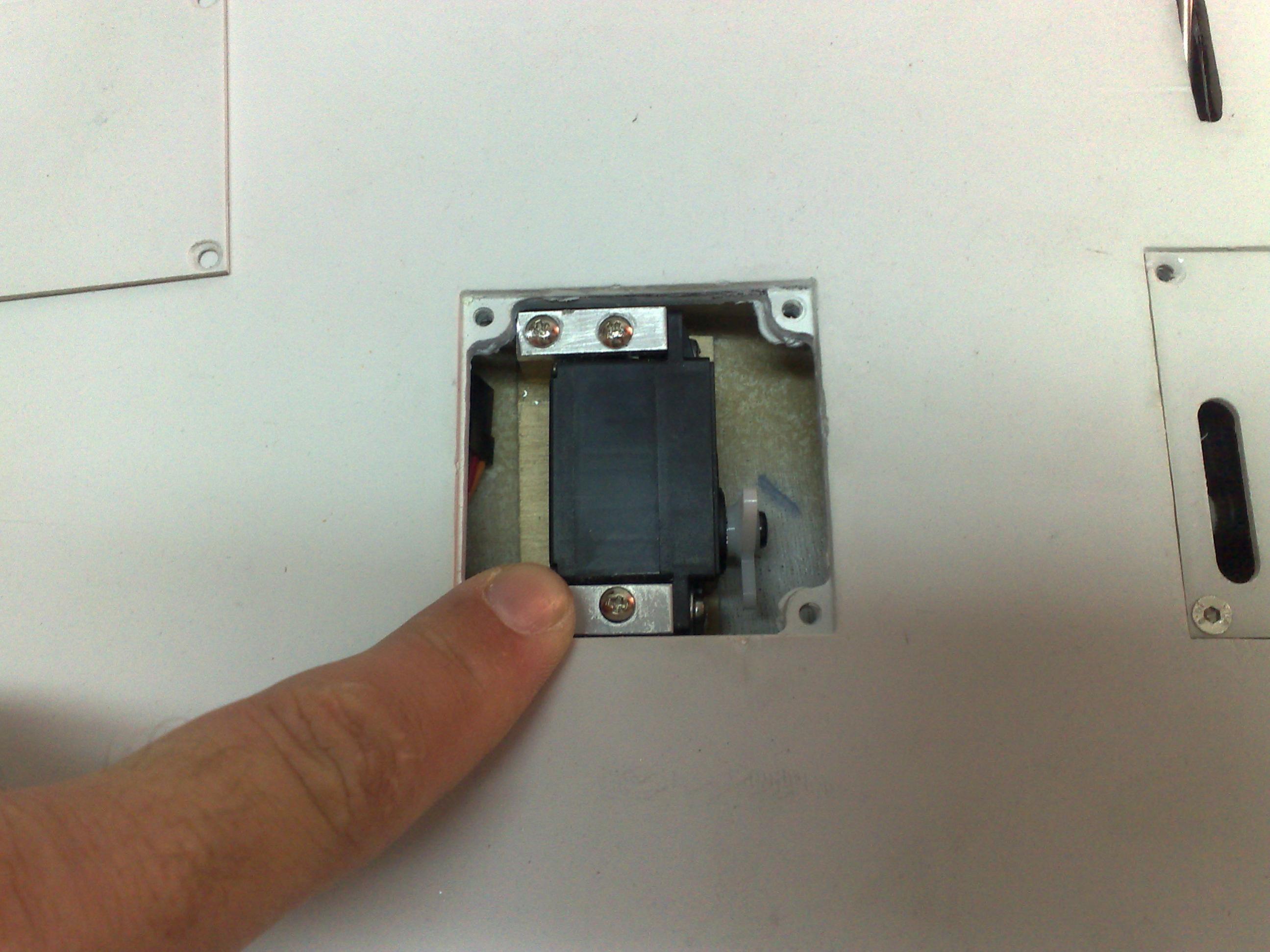

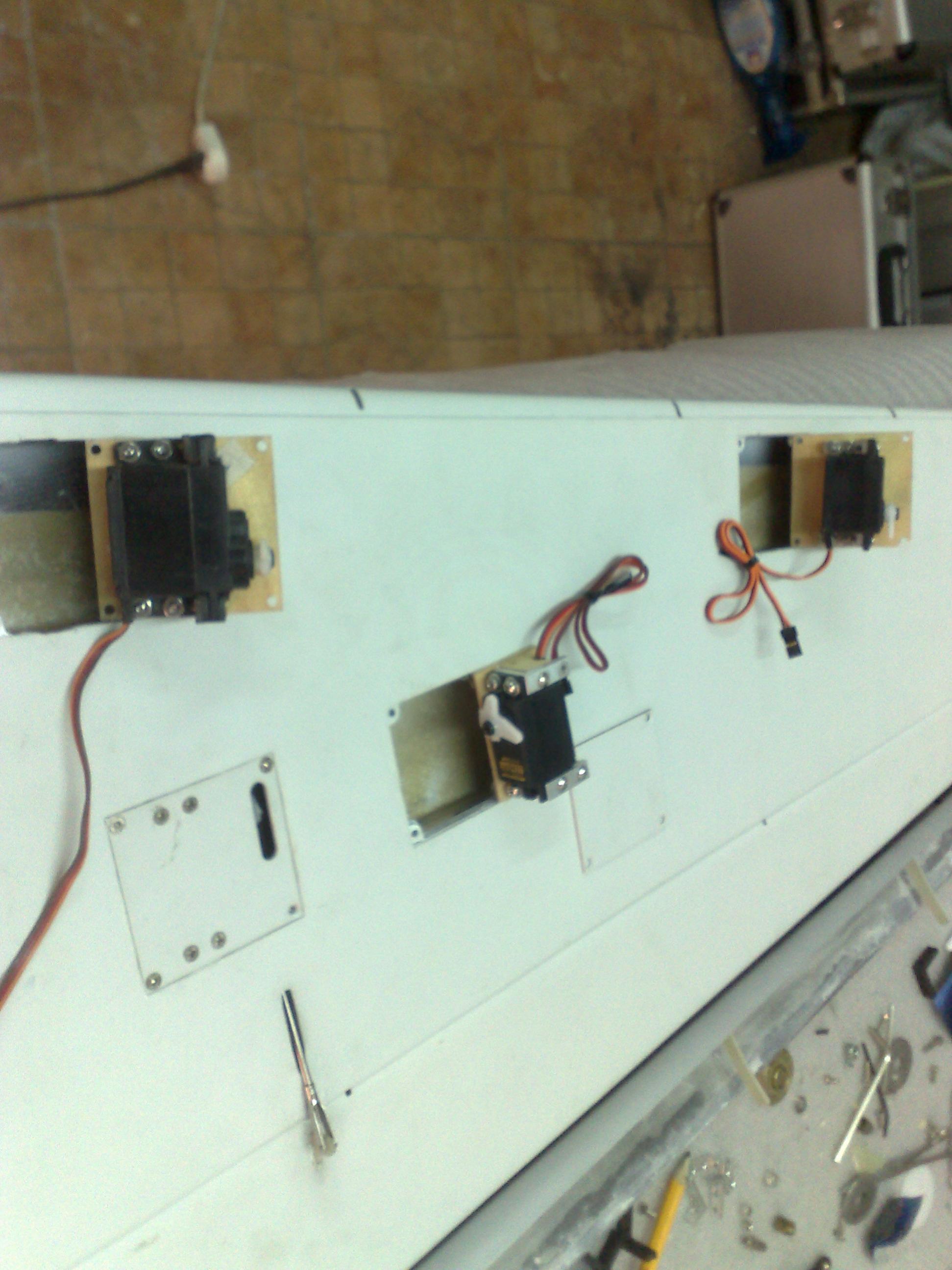

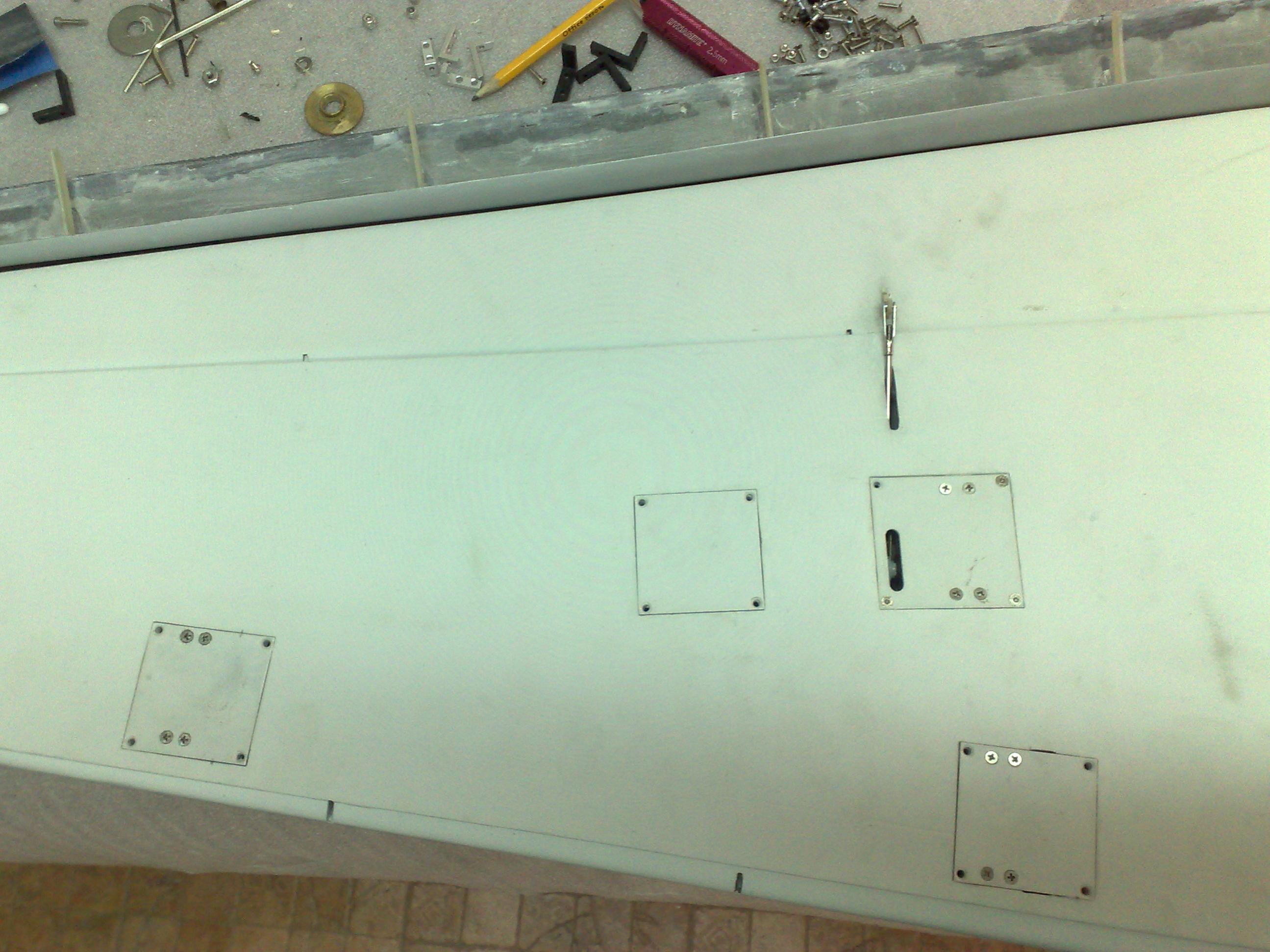

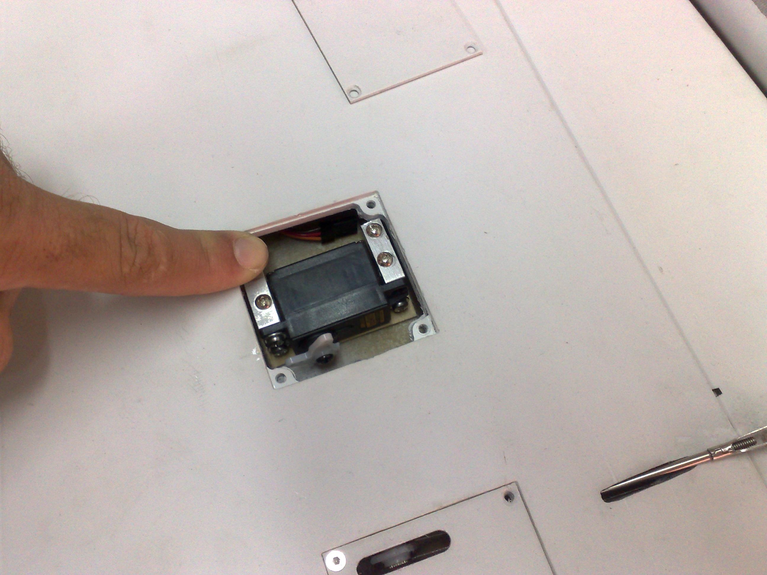

    The servo chosen to activate the Spolier is the JR DS9411 mid size
Name:	F-14 Twin project misc' pics 024.jpg‏
ID:	33528   Click image for larger version.
Name:	F-14 Twin project misc' pics 025.jpg‏
ID:	33529   Click image for larger version.
Name:	F-14 Twin project misc' pics 026.jpg‏
ID:	33530   Click image for larger version.
Name:	F-14 Twin project misc' pics 027.jpg‏
  23. #23
    Dec 2009
    1,242
    הודה 46 פעמים ב 44 הודעות
    servos installed....
Name:	F-14 Twin project misc' pics 034.jpg‏
