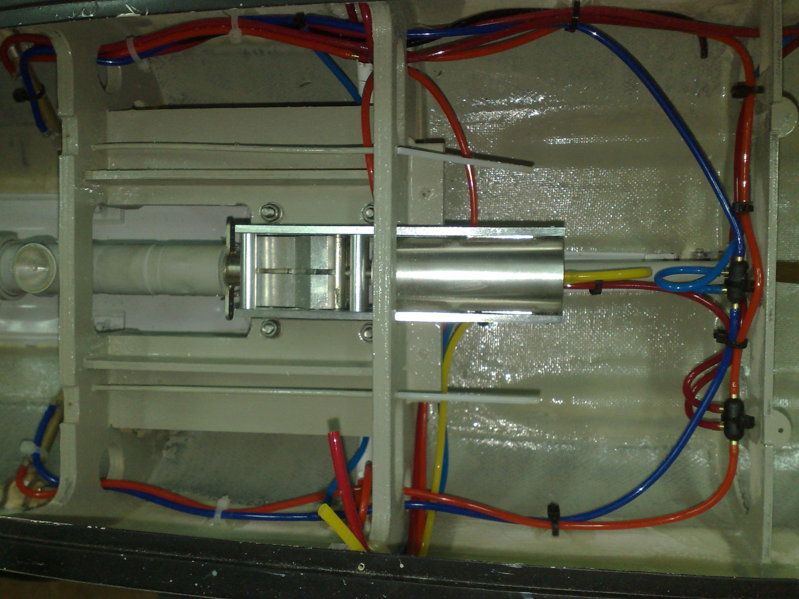

    Fuel system consists of three fuel tanks for ecah engine of
    one 2.5 lt ,one 1.75 lt and a small hoper tank for each engine
    This will allow for an estimated flight time of ~9 minutes
    Next are the engines sub systems shelves installation which include ECU, Fuel pumps , fuel valves ,and fuel filters

    Dec 2009
    1,242
    הודה 46 פעמים ב 44 הודעות
    ברירת מחדל תגובה להודעה: F-14D
    More in the pics is visible the wings screw jack which when turning is driving the wings from fully extended to fully rewarded possition.

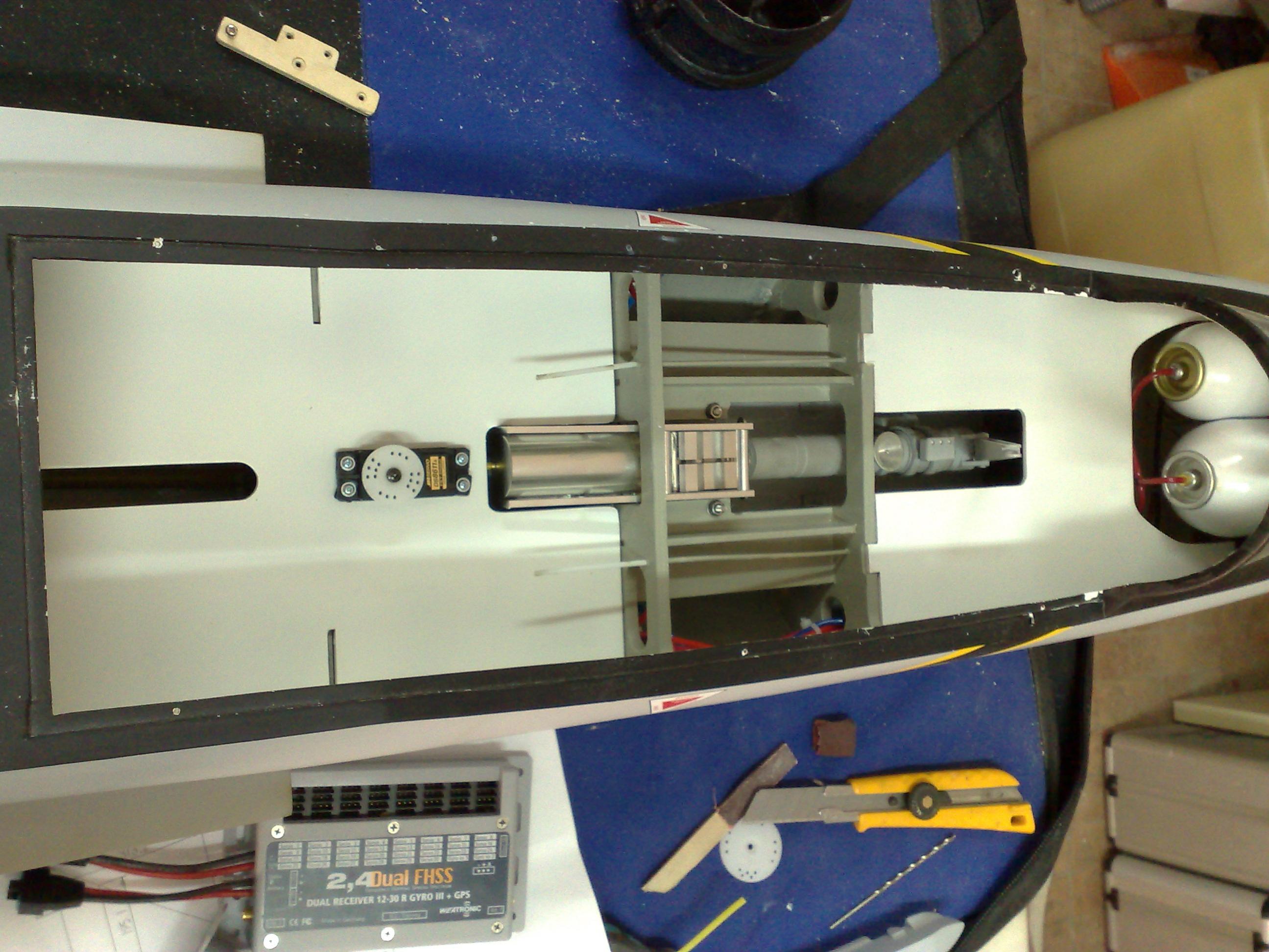

    Preparation of equipment trays including paint finish + positioning in the front section of the fuselage

    Preparation of Weatronic 2.4 Dual FHSS receiver mounting tray...
