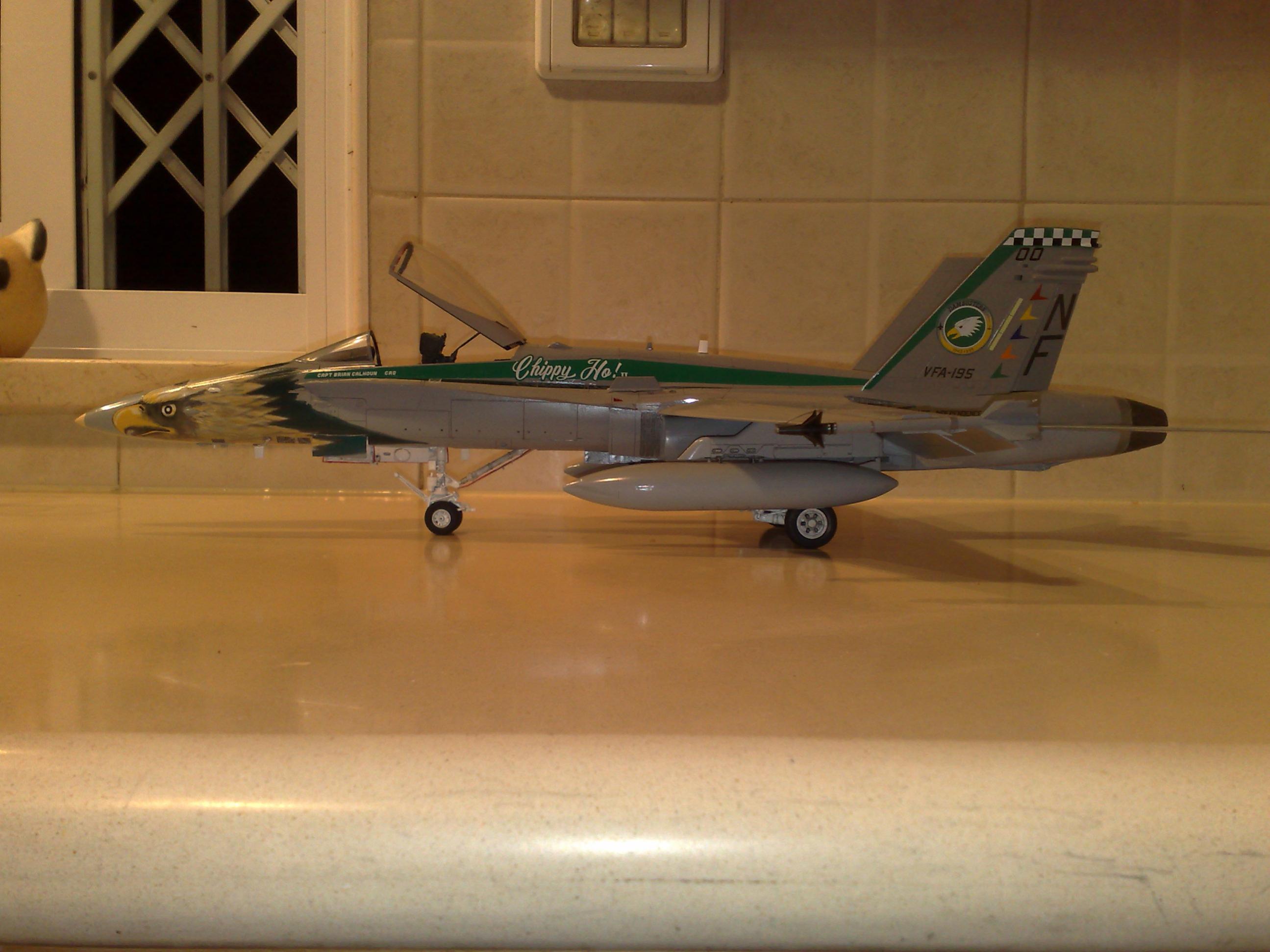

    Smile שרשור בניה של F/A-18 1/7 של חברת YELLOW AIRCRAFT

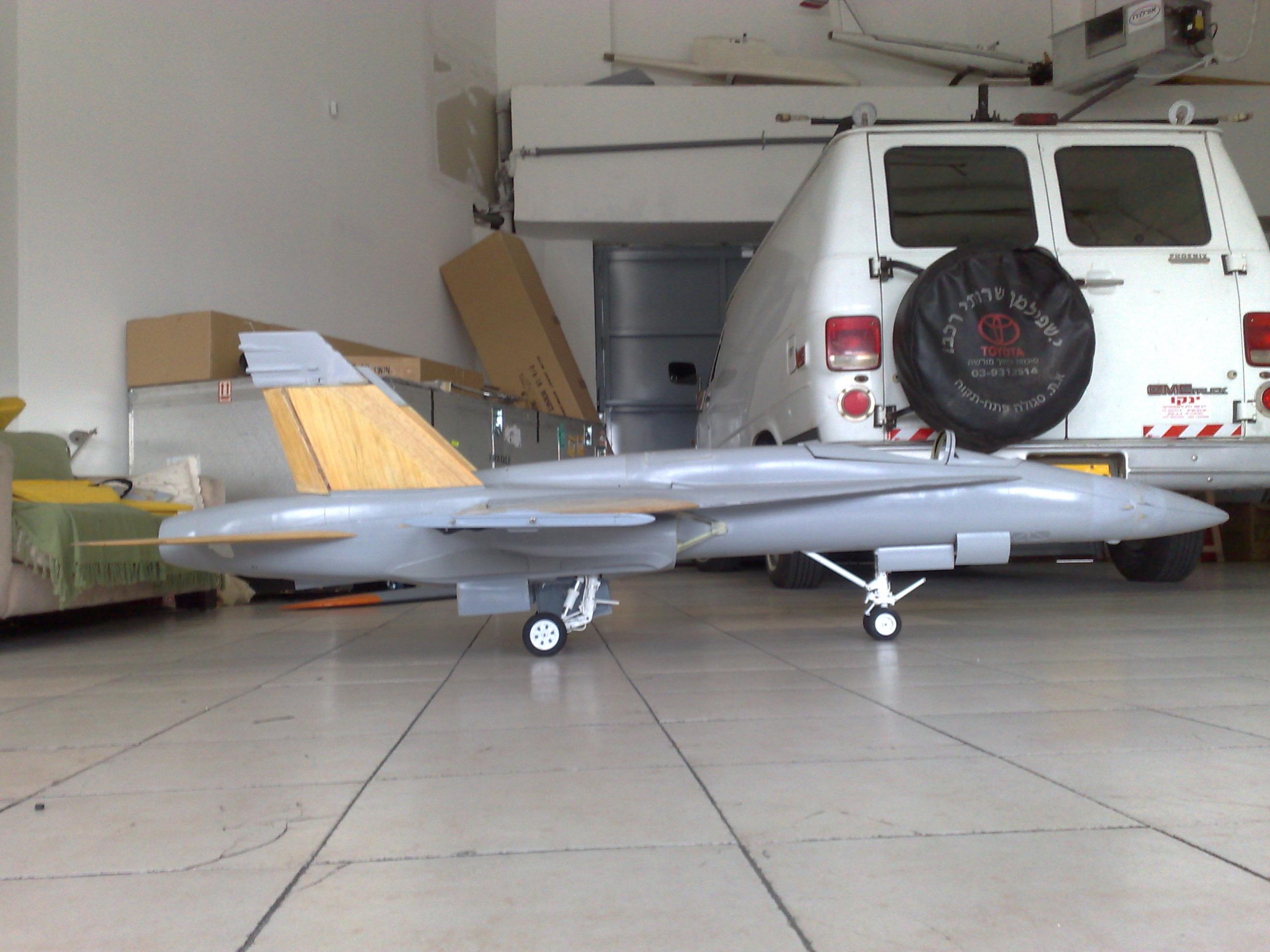

    מכובדיי.
    אני פותח כאן שרשור בניה של קיט של טיסן 18- F/A של חברת YELLOW AIRCRAFT
    בקנ''מ של 1/7 ....
    השרשור ילווה בהסברים בשפה האנגלית עמכם הסליחה.

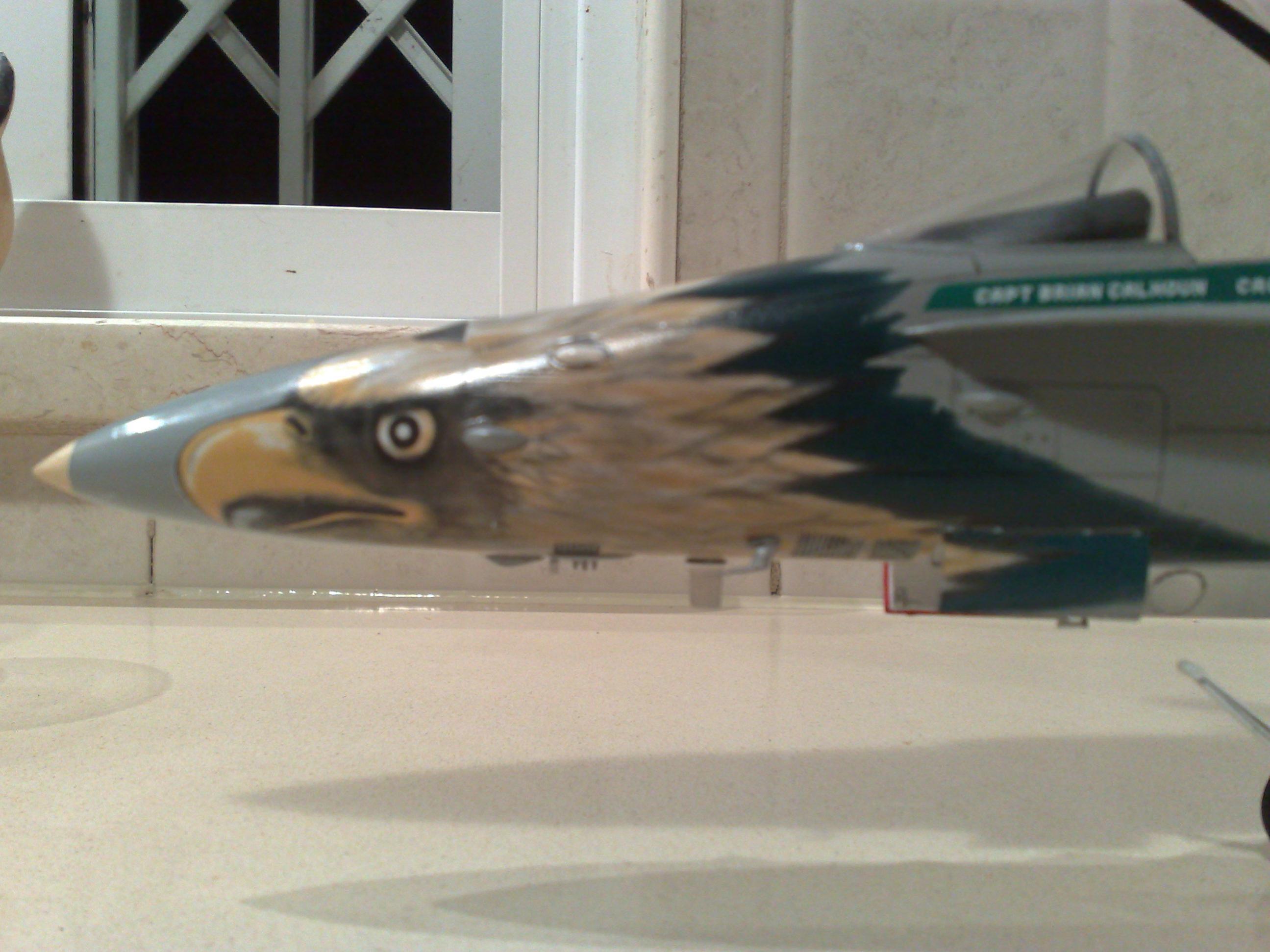

    ברירת מחדל תגובה להודעה: שרשור בניה של F/A-18 1/7 של חברת YELLOW AIRCRAFT

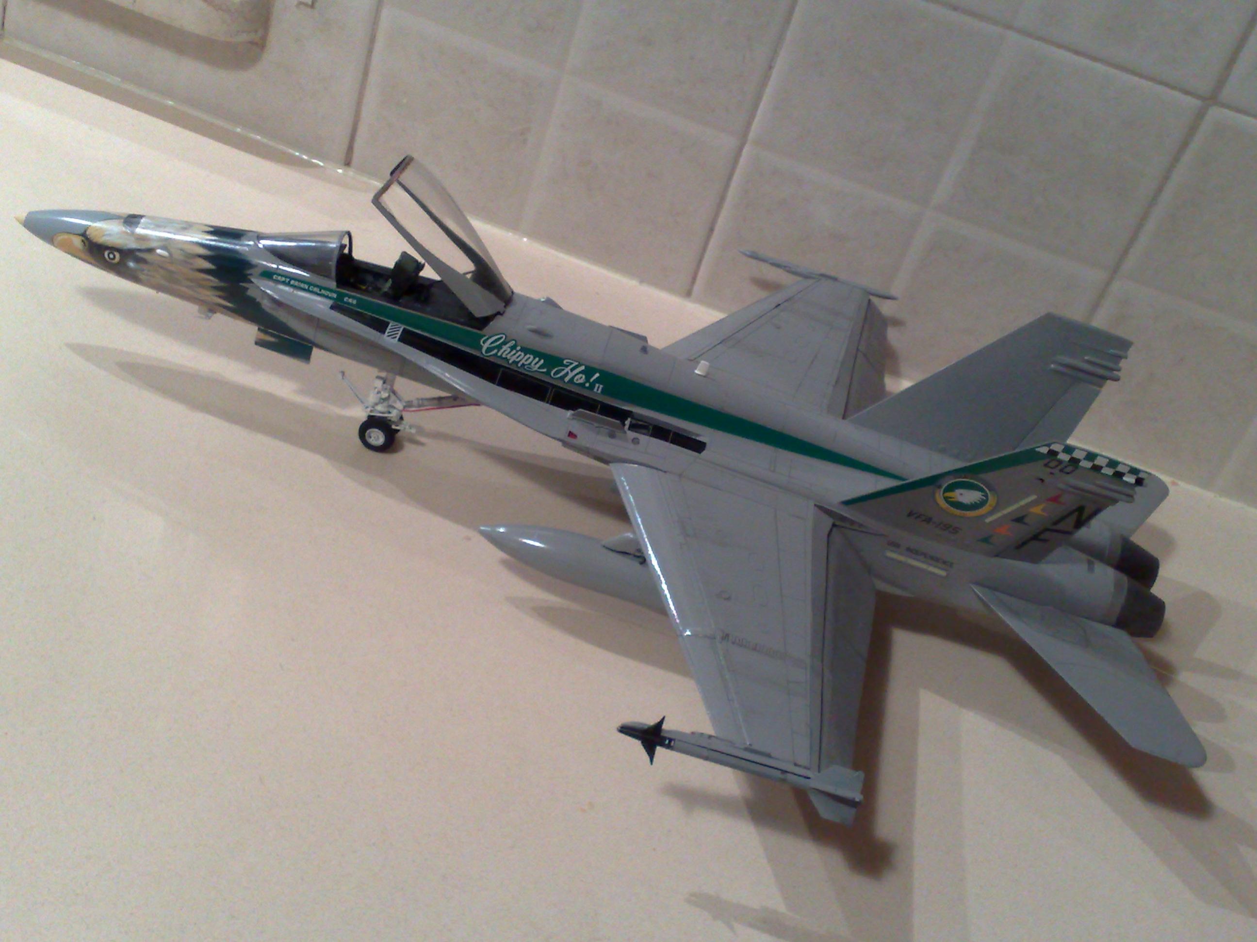

    Hello everybody I'm starting here a thread build of the Y/A F/A-18 Twin "BUG" .....This kit has been on and off my desk in the past 4,5 years and I've decided to bring it to completion ....
    enjoy...above is a picture of the full scale and here is a 1/32 scale plastic model that I've built for my purposes the model will be painted according to it..

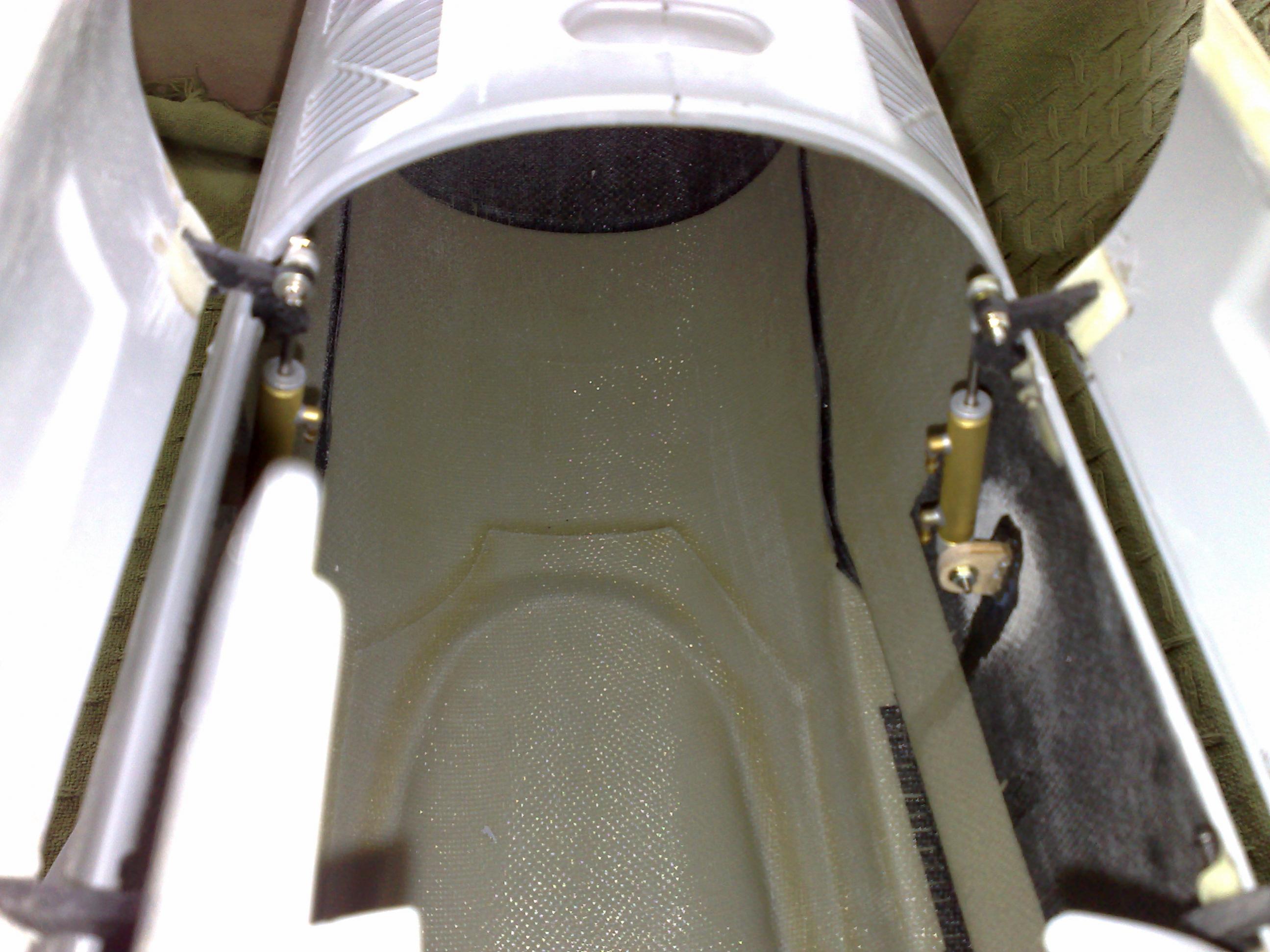

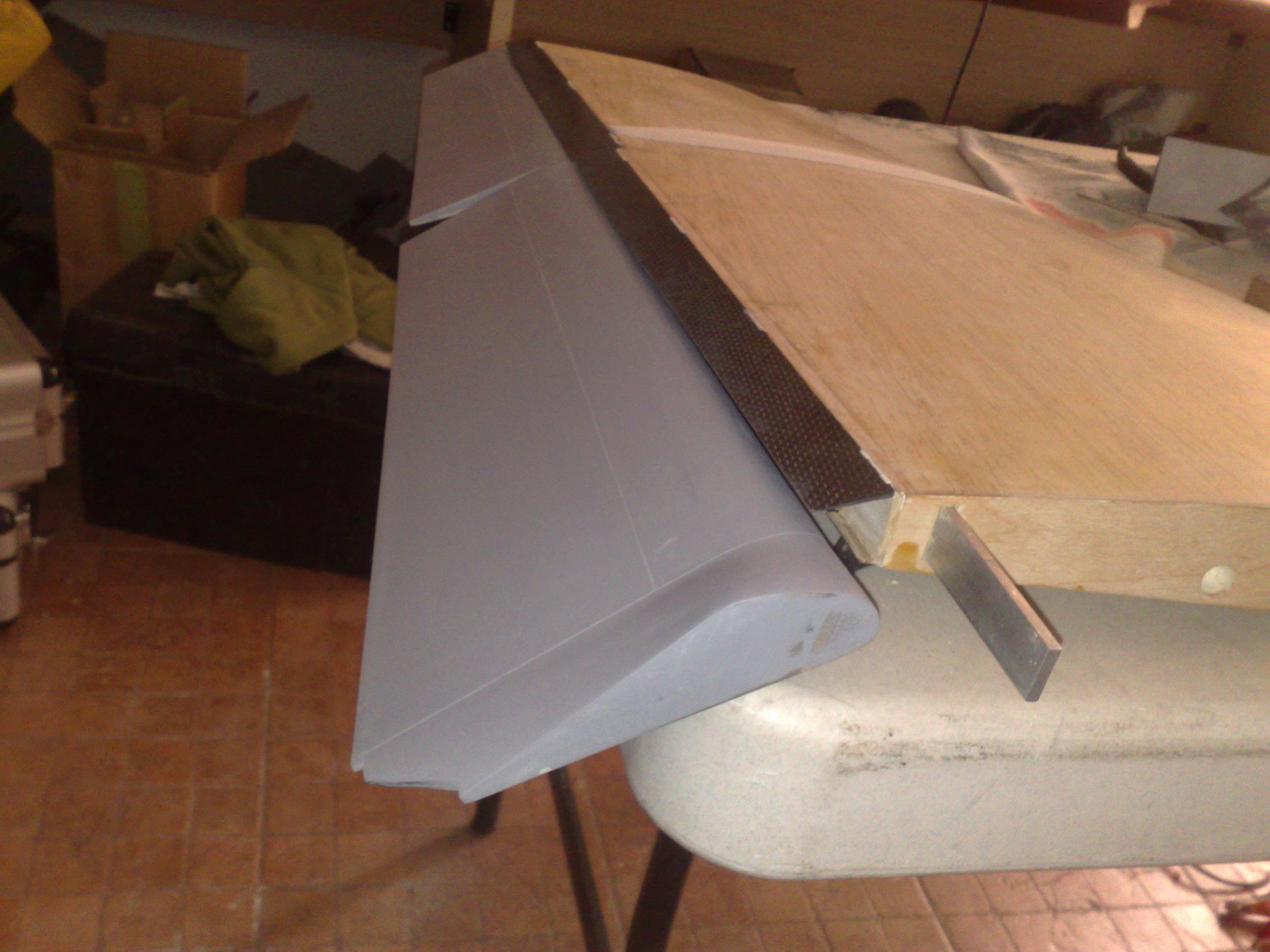

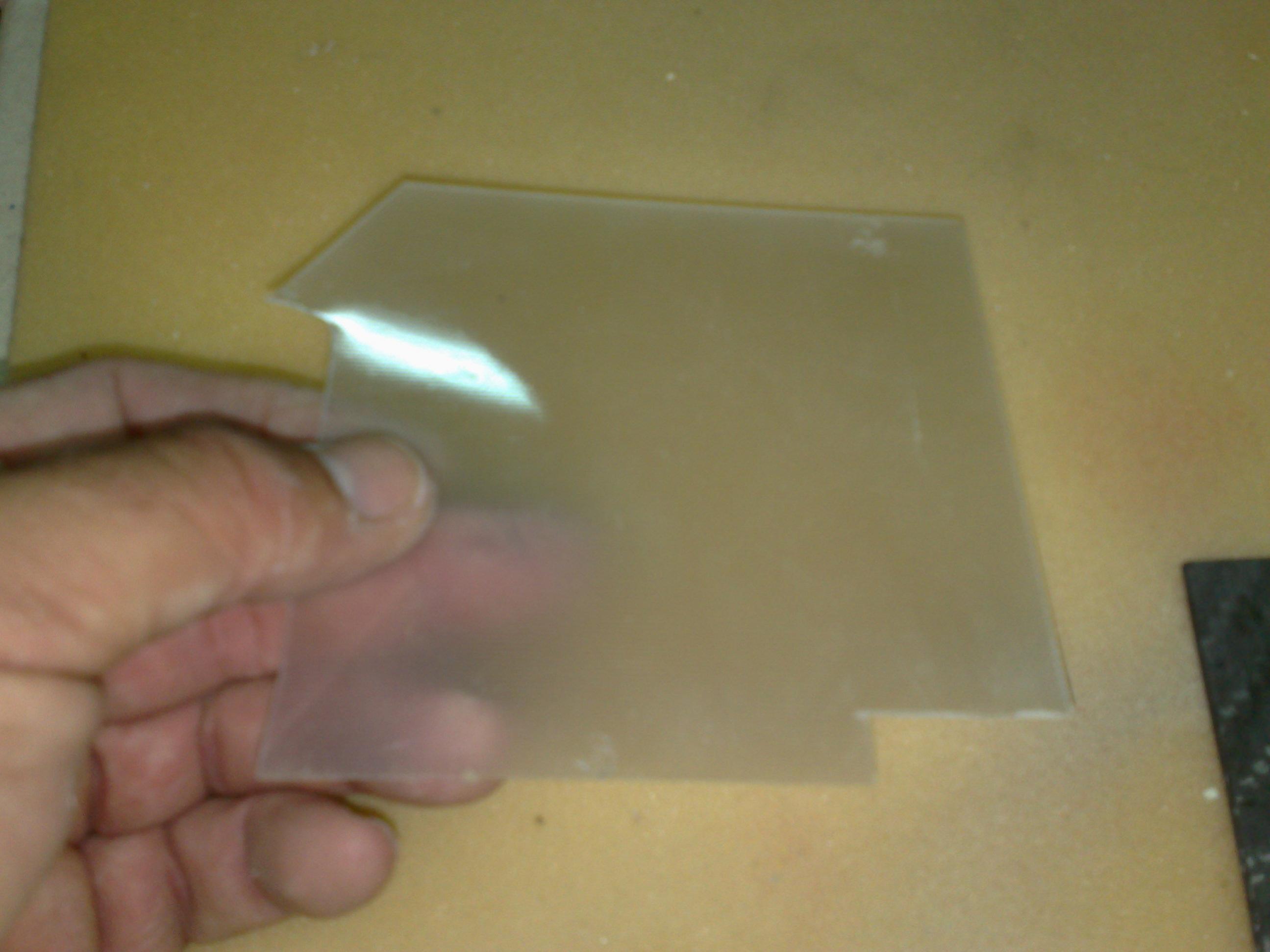

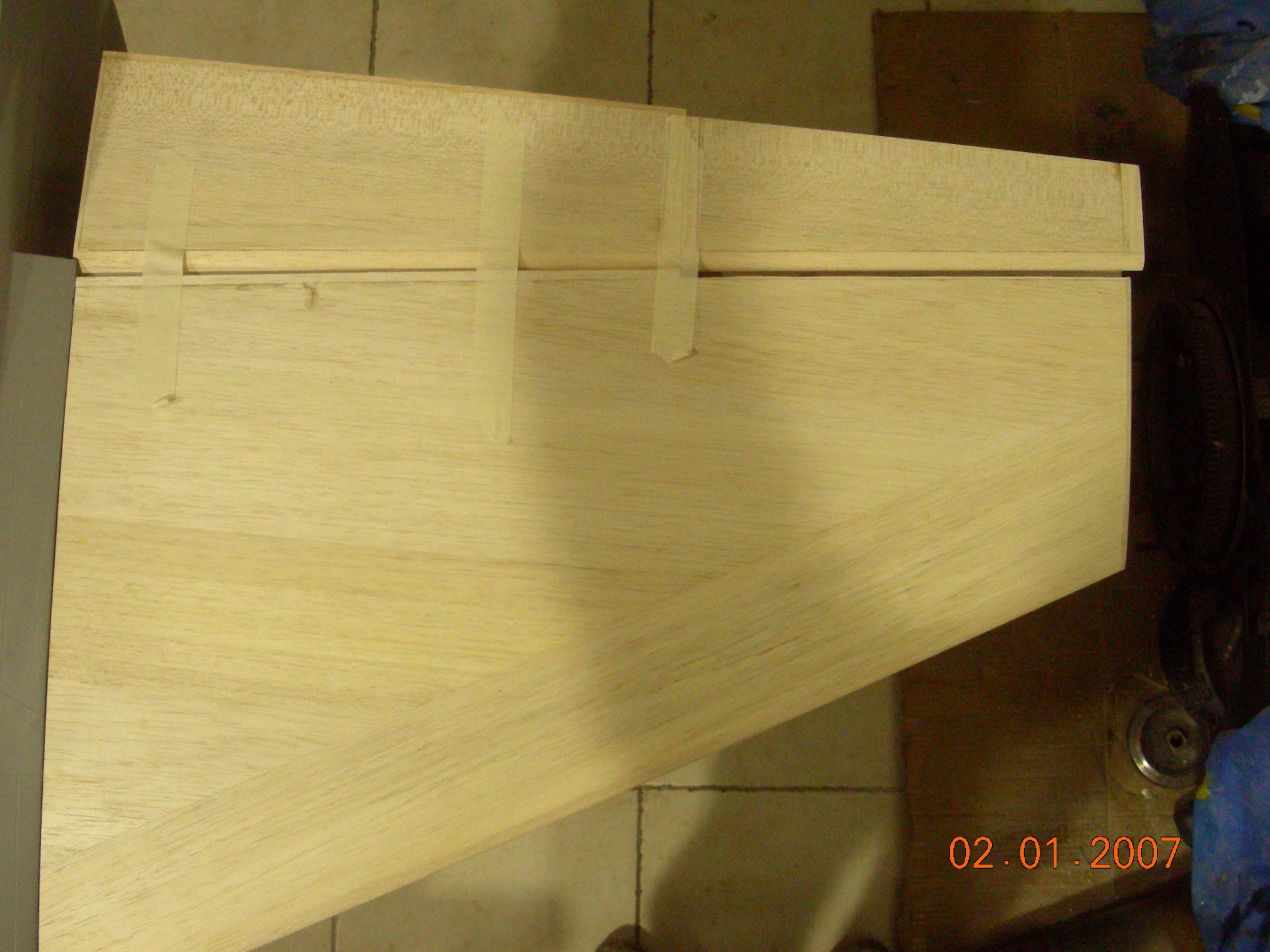

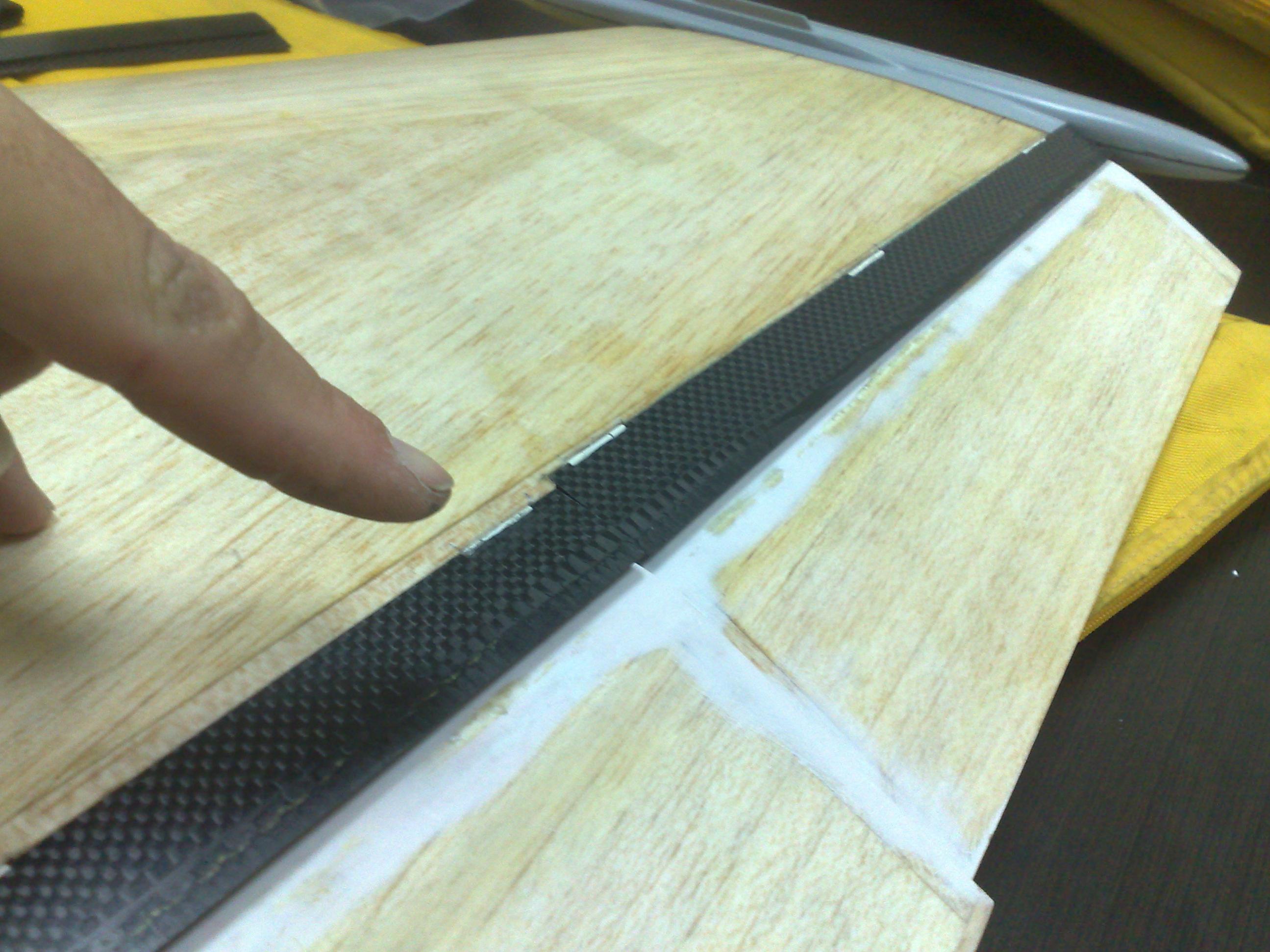

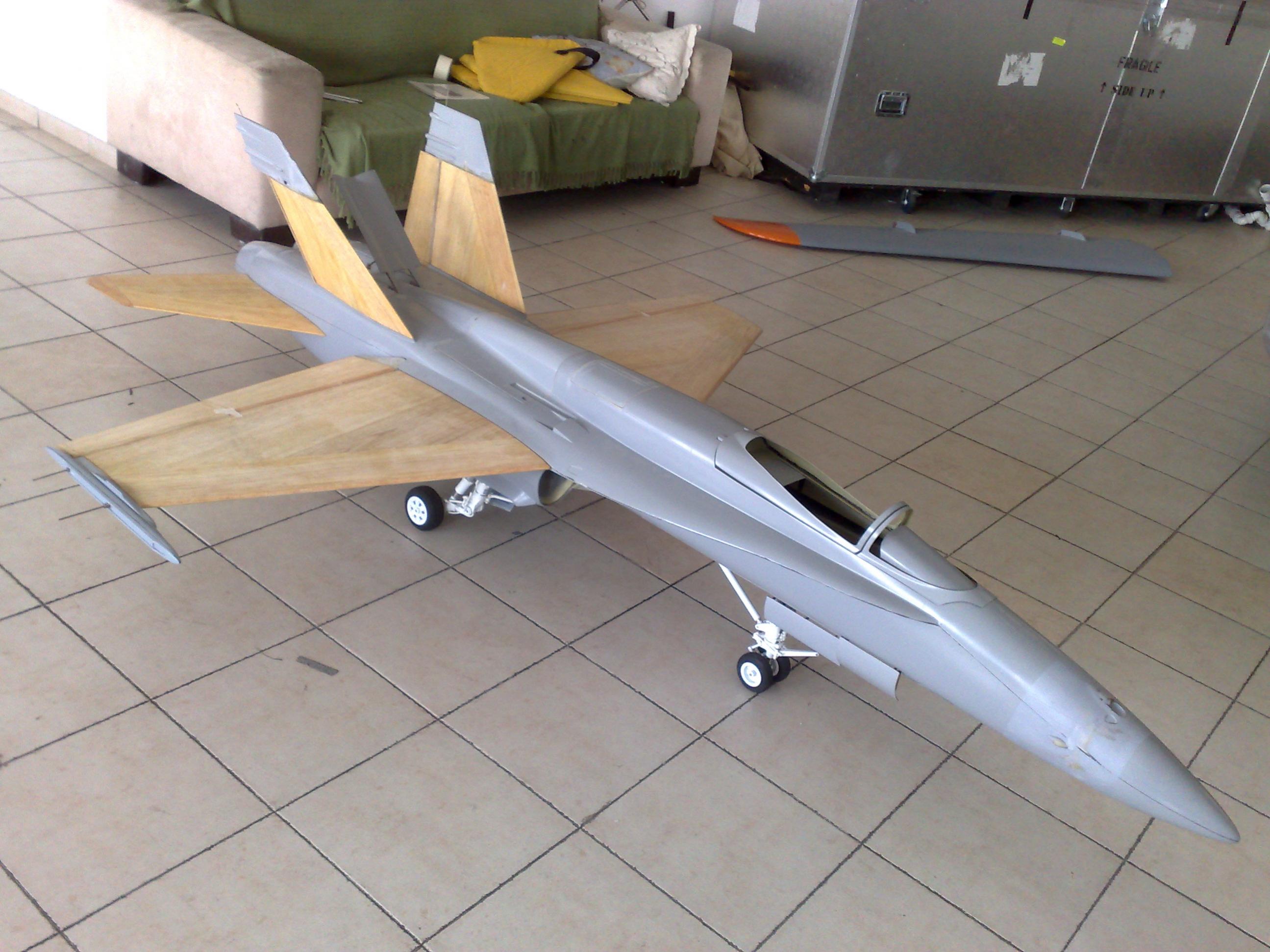

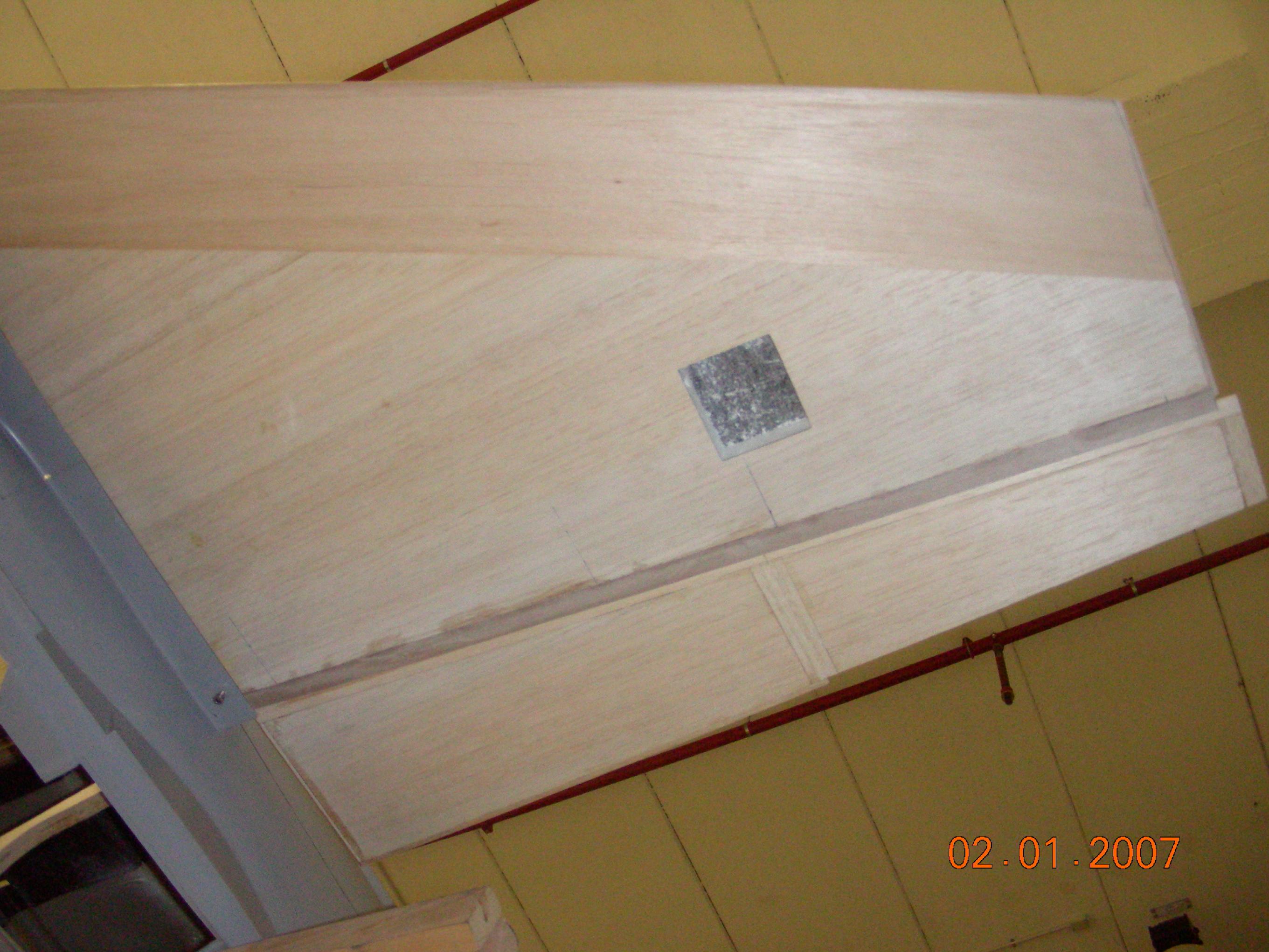

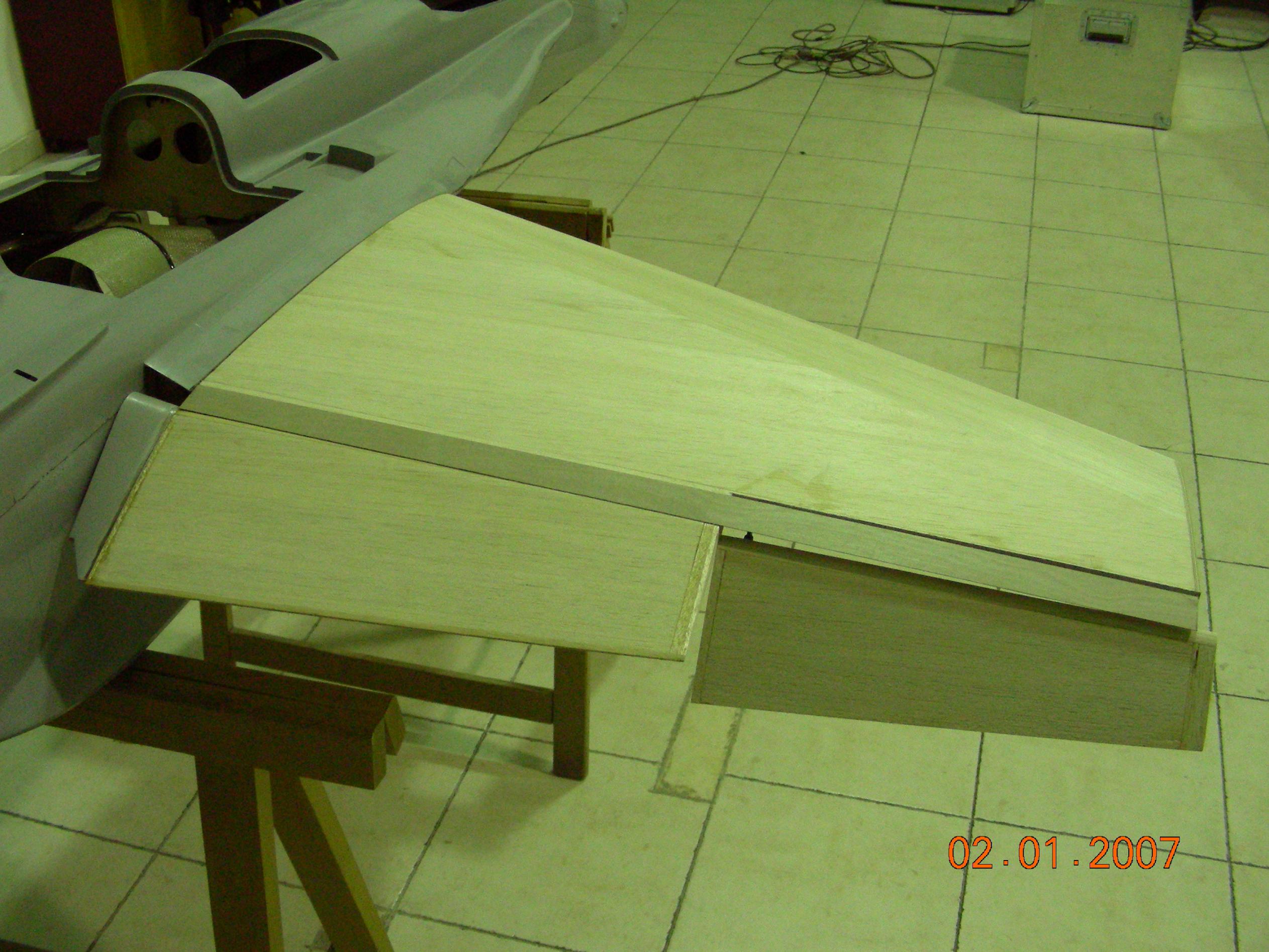

    At this stage the "BUG" is more or less built i.e all formers in the fuse are installed , wings are glassed including fins and stabs. . Also all gear doors are done too.
    The wings control surfaces have been altered from the original plans to a state where they more or less have resemblance to the ones on the full size.
    Following are some pictures which describe the various parts done. A more spesific picture gallery will follow.Starting with the wings

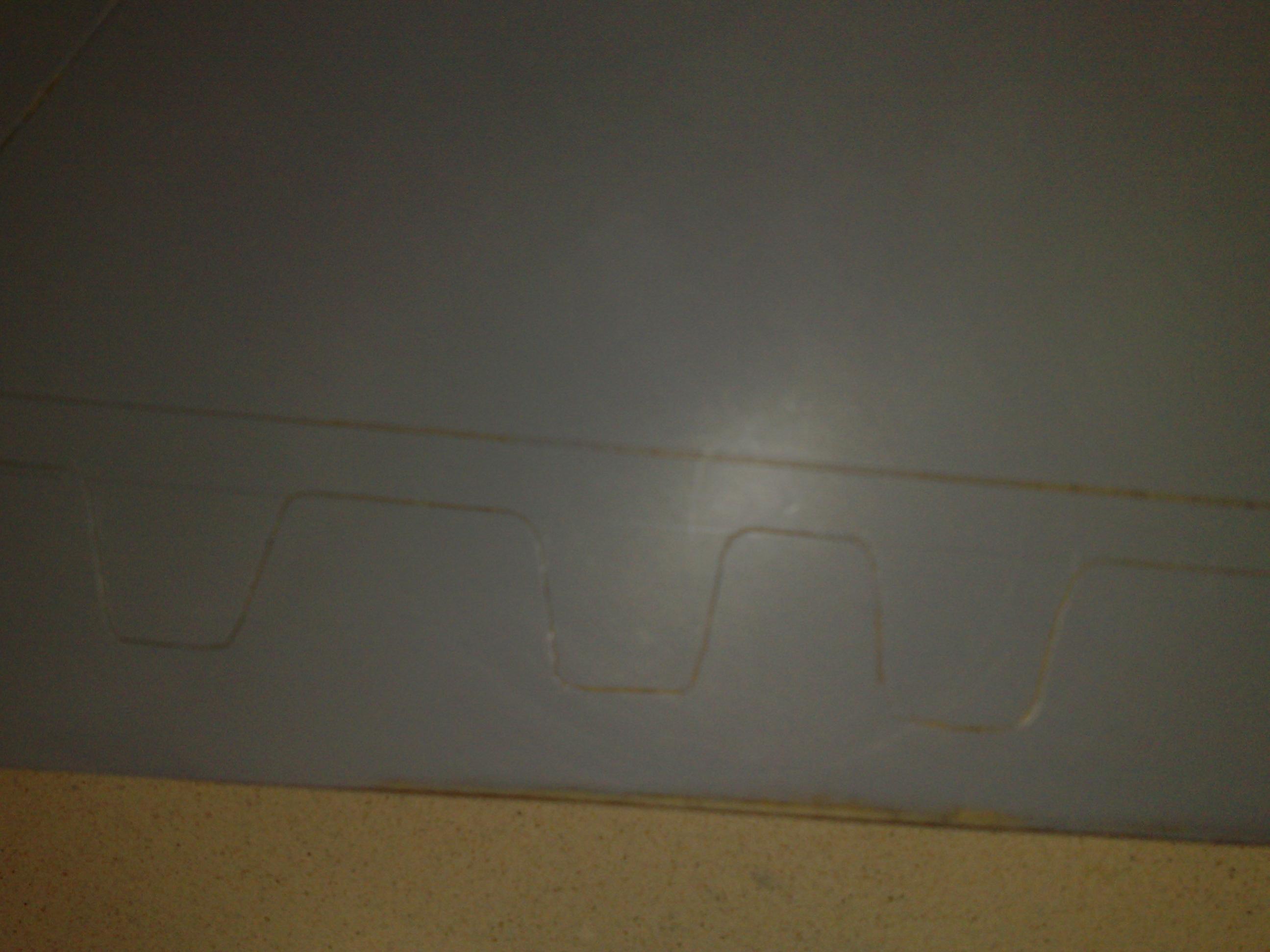

    Seen above are the wings with control surfaces in their advanced preparation stage where the wings have been sheeted and ailerons together with the flaps have been removed from the core , trimmed and boxed also is seen the aileron servo housing been reveiled

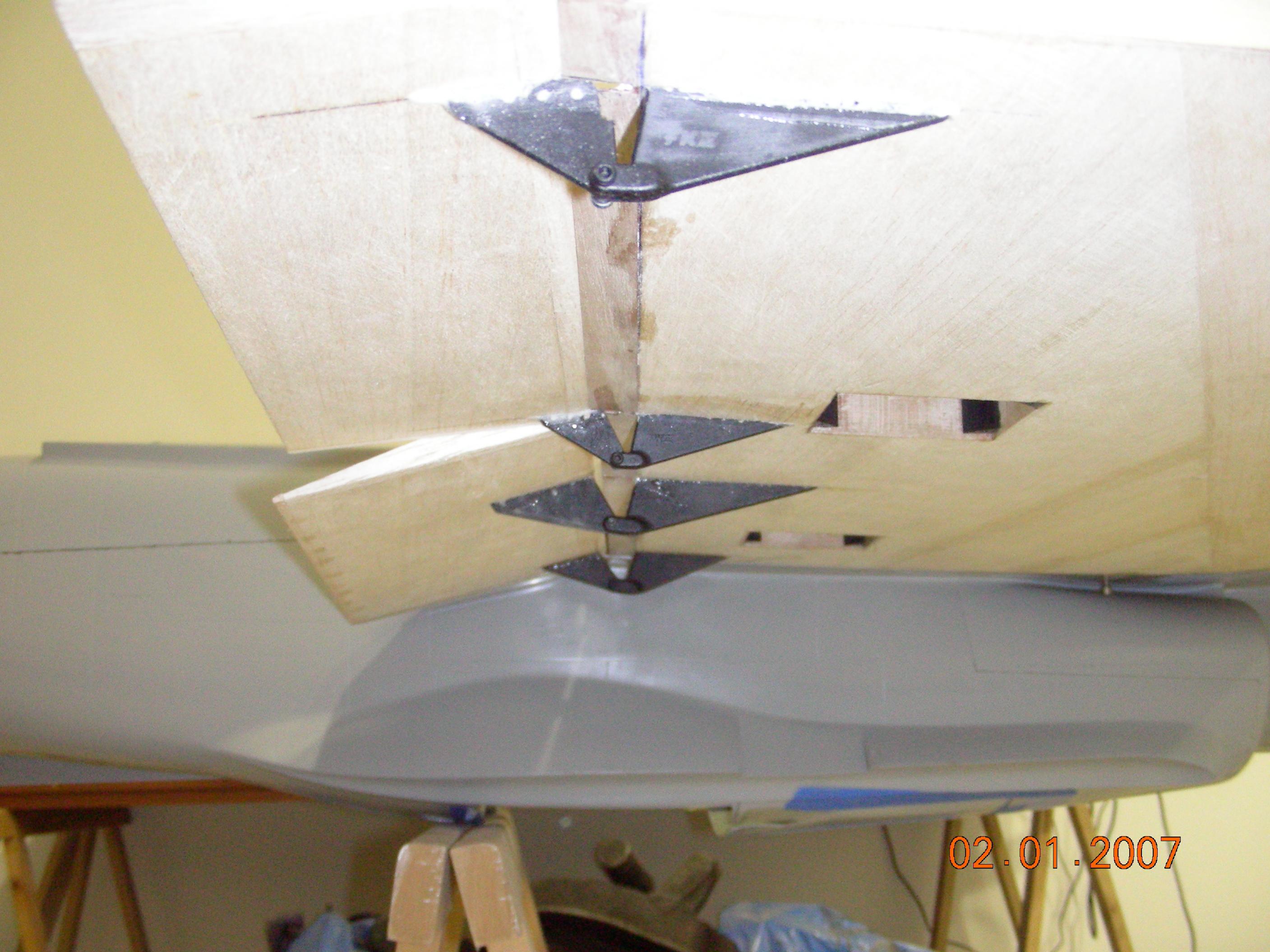

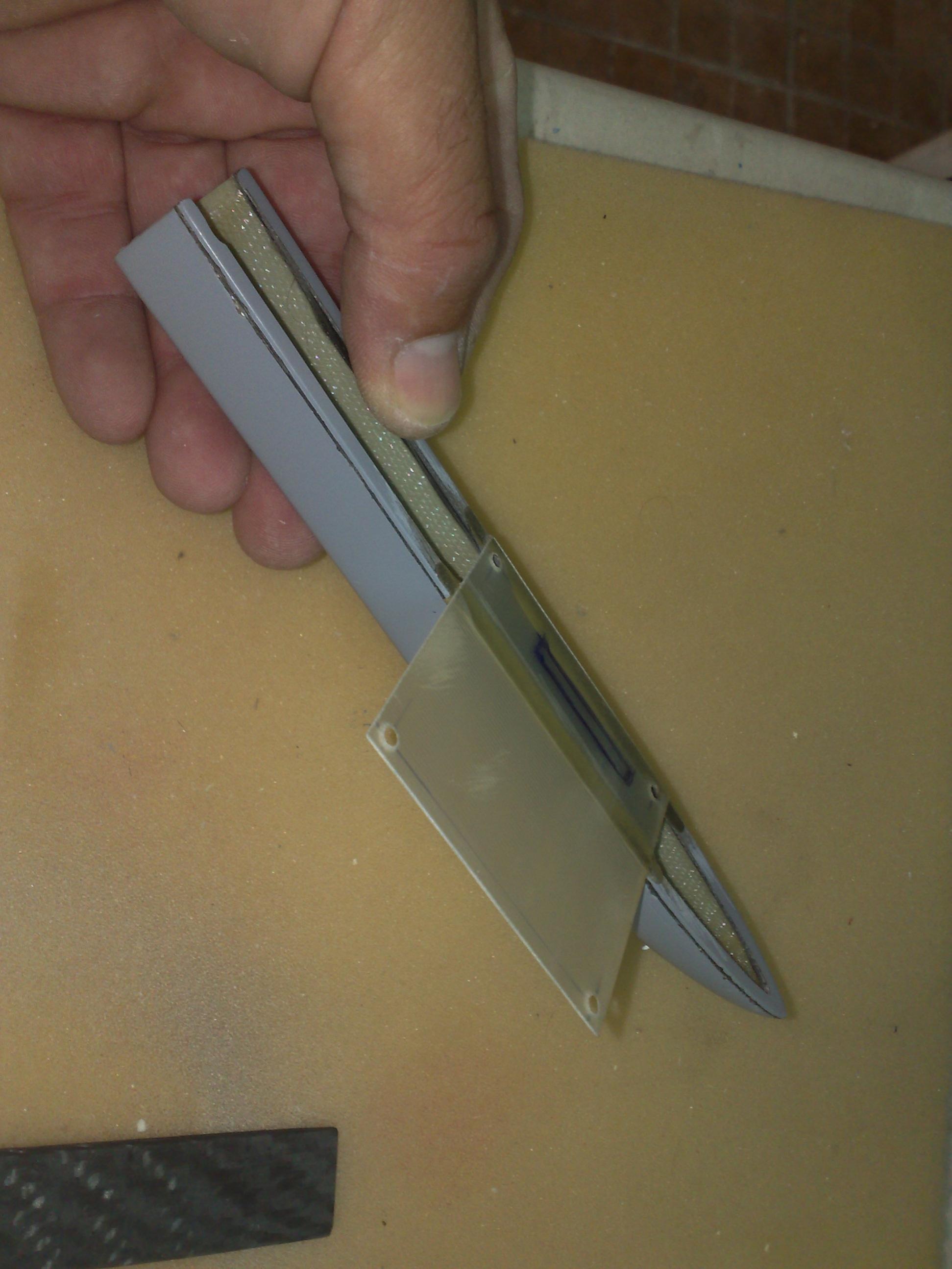

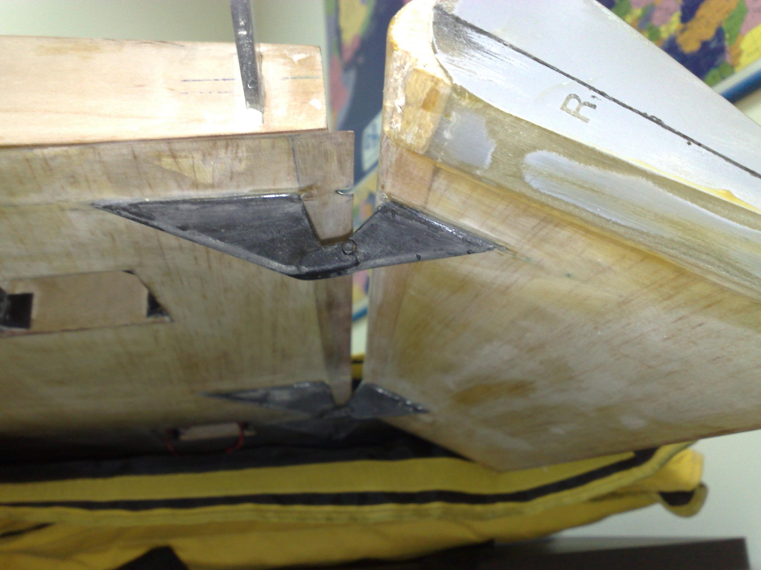

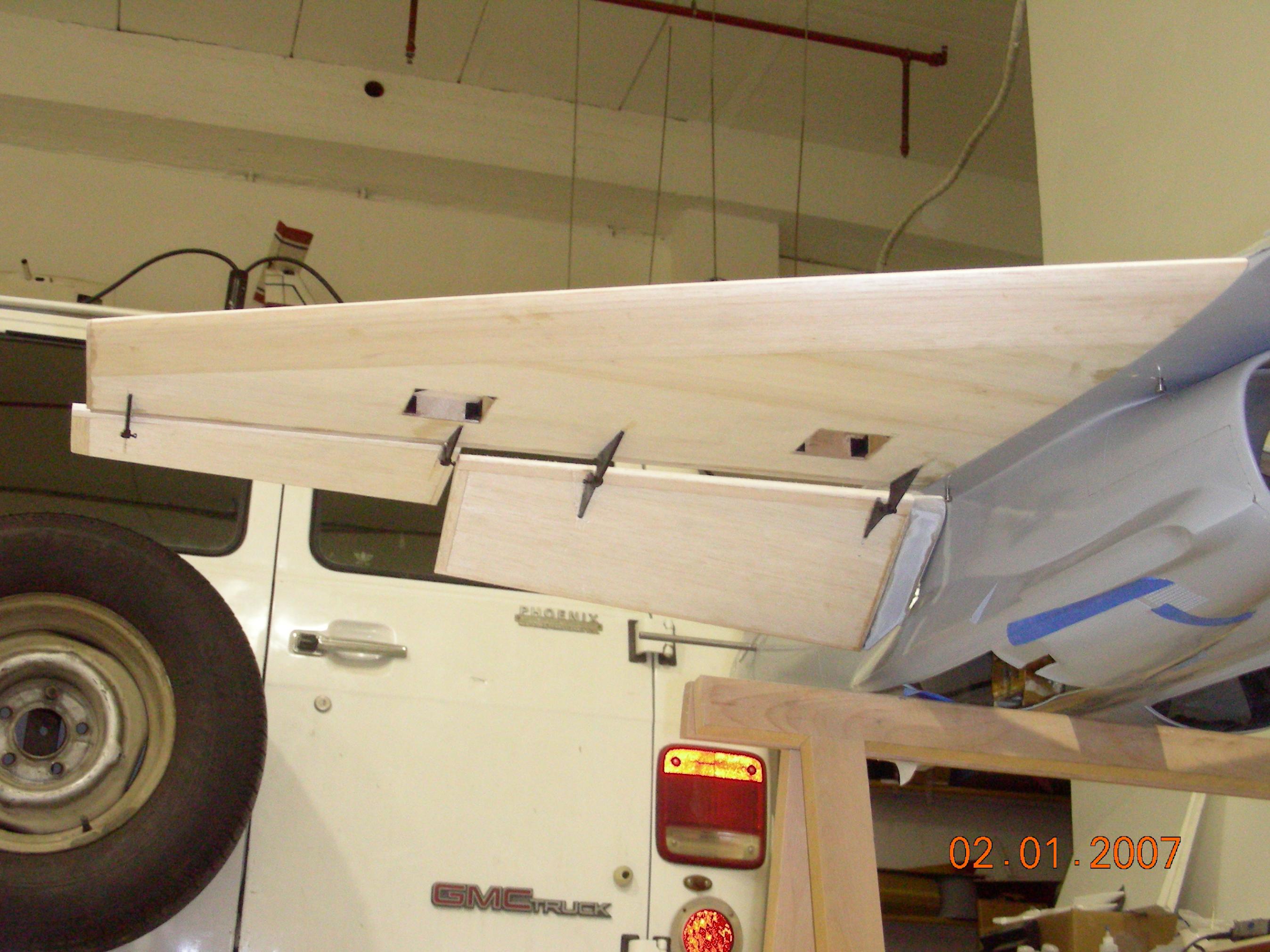

    Next are pictures of the special offset hinges that were made for the scale actuation of the flaps and ailerons...
Name:	F-18 build pics.jpg‏
ID:	25829   Click image for larger version.
Name:	All sorts of pics F-4E and other 068.jpg‏
ID:	25830   Click image for larger version.
Name:	All sorts of pics F-4E and other 070.jpg‏
    Dec 2009
    1,242
    הודה 46 פעמים ב 44 הודעות
    The offset hinges are being produced by Dr.Charles Tsee
    and can be purchased separately they are not made specially for the F/A-18
    back then...(2006~7) today they are used in numerous kits. Observe the different sizes to match the mechanical geometry of movement.

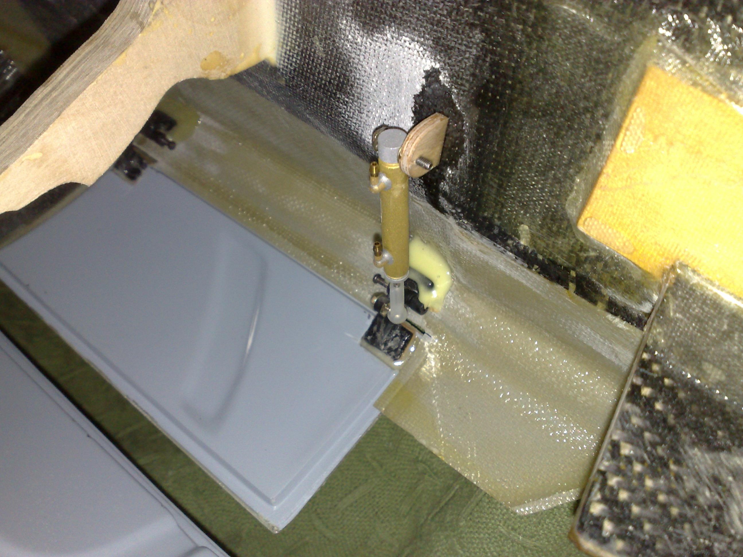

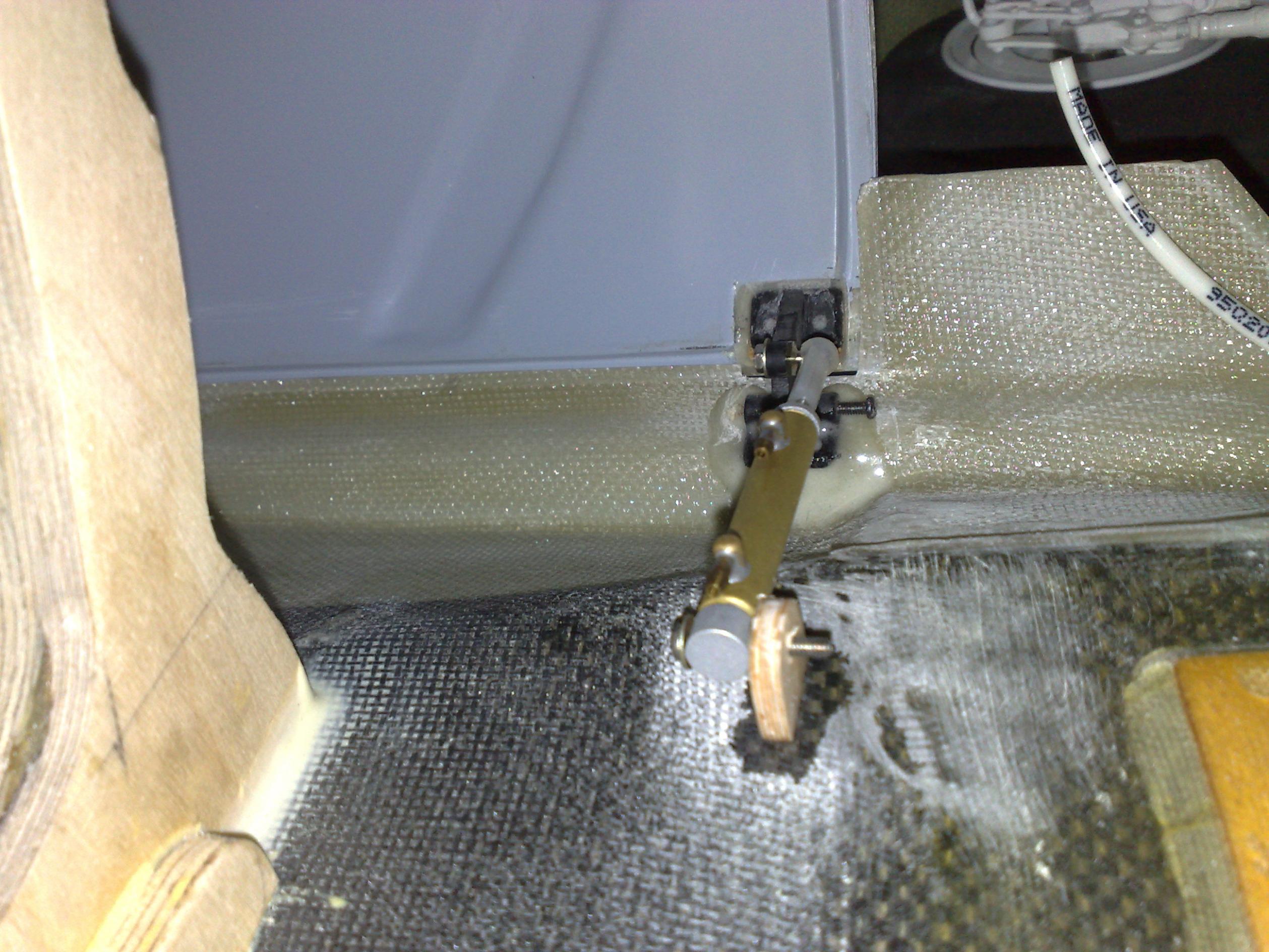

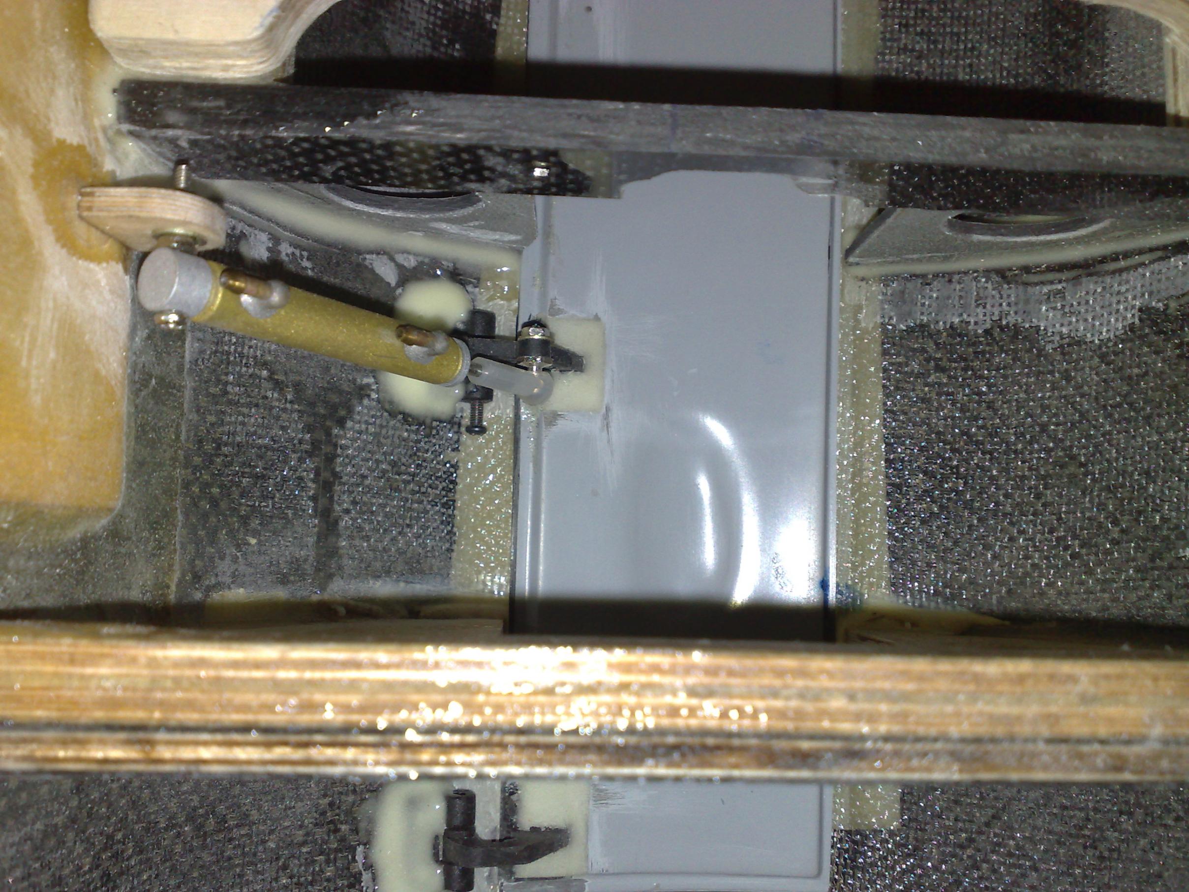

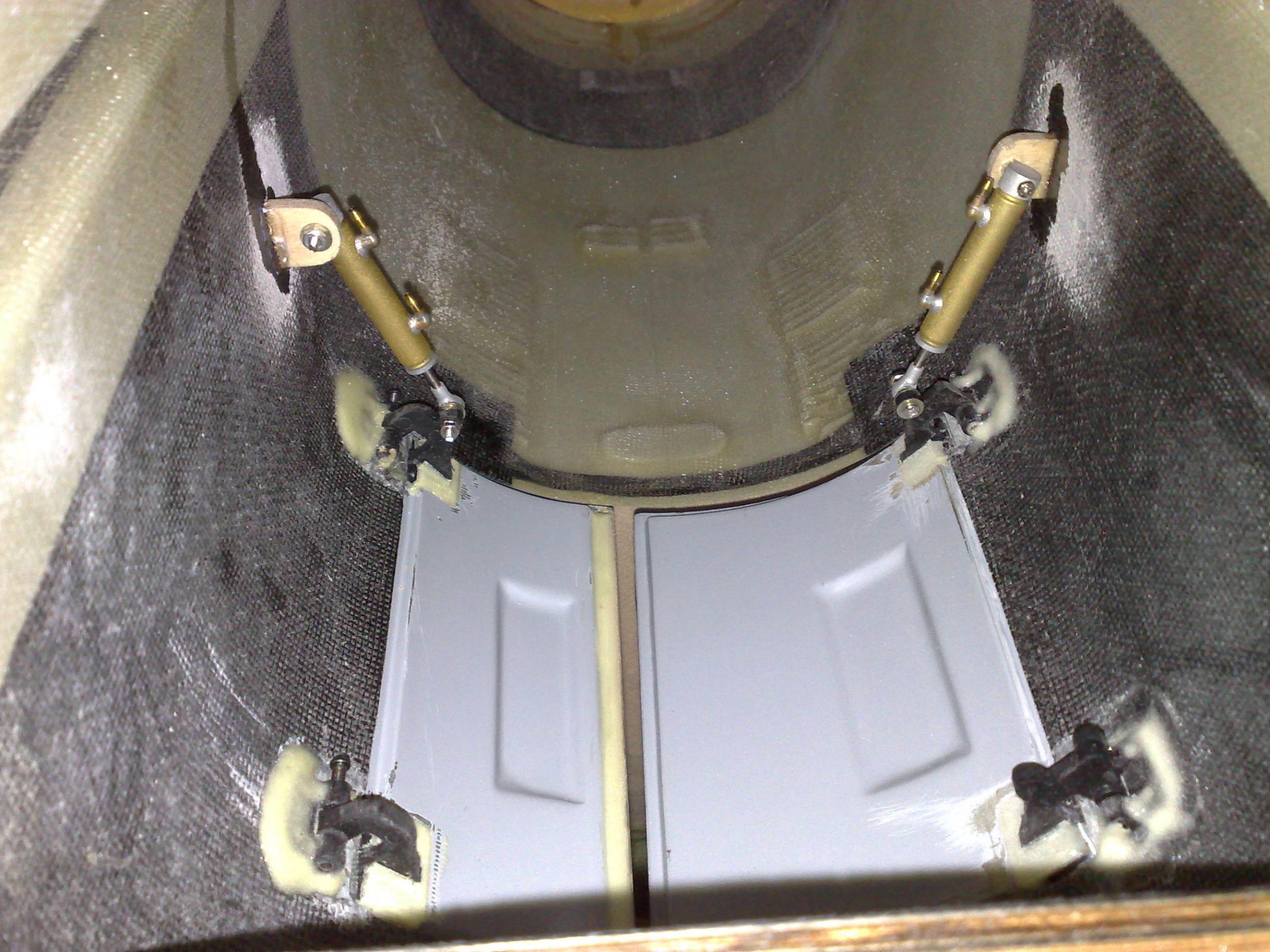

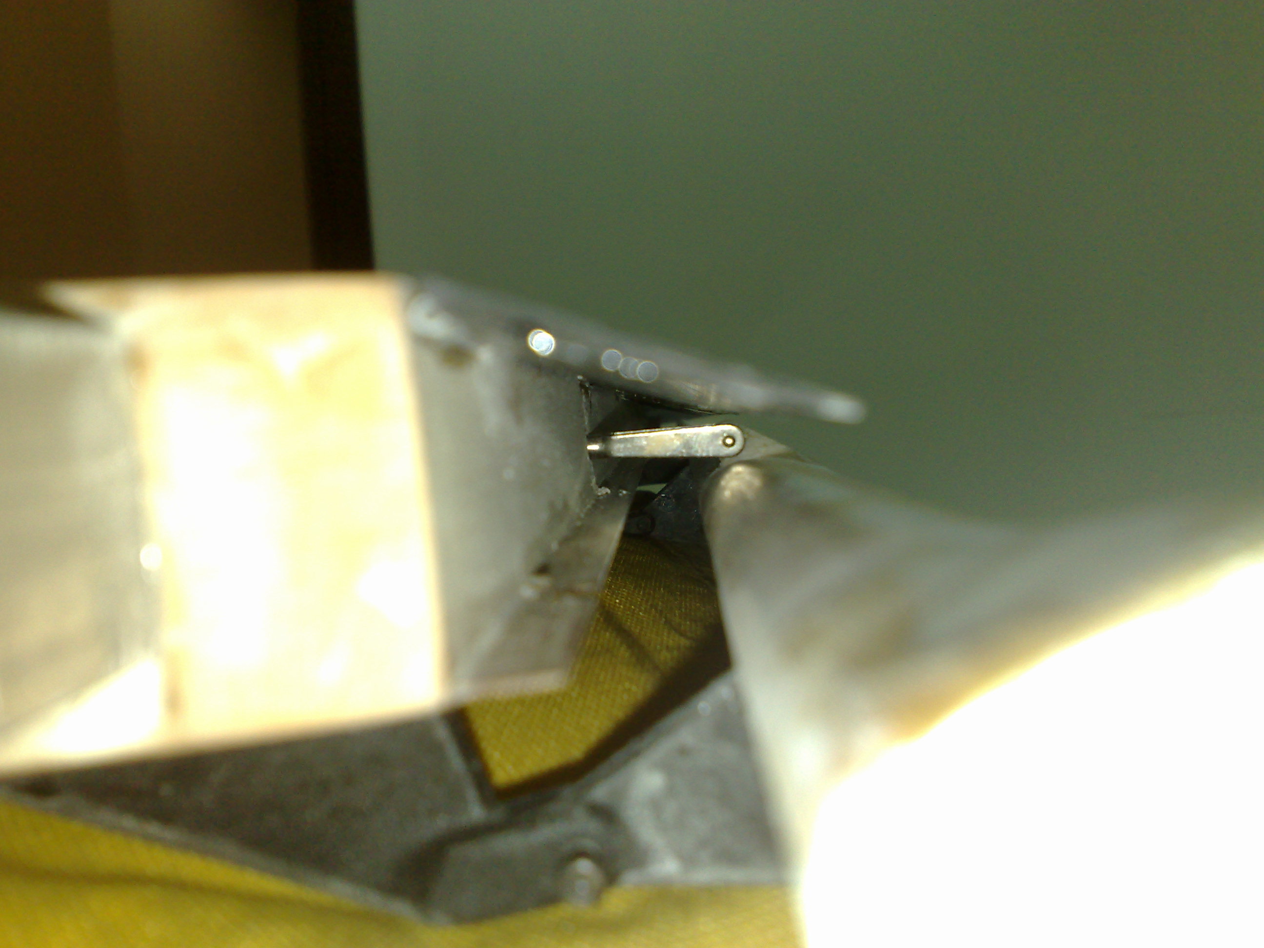

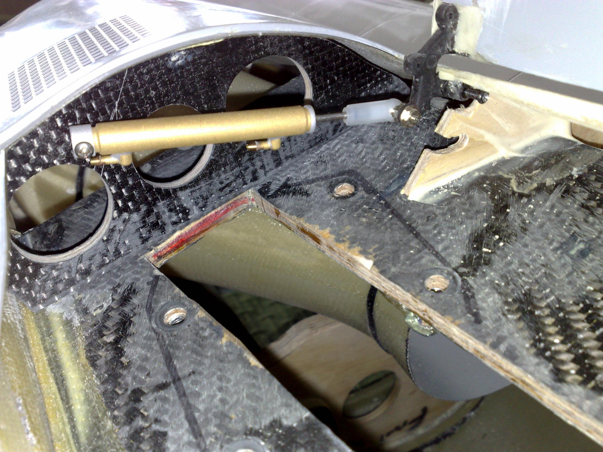

    Some more pictures of various parts of the airframe ... gear doors and air cylinders
Name:	Fuga & F-18 build progress 010.jpg‏
ID:	25923   Click image for larger version.
Name:	Fuga & F-18 build progress 011.jpg‏

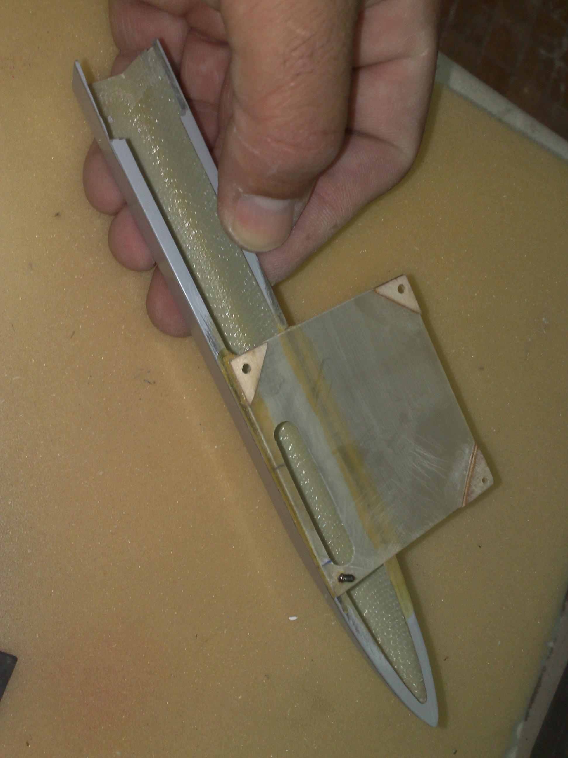

    Speed brake
Name:	Fuga & F-18 build progress 015.jpg‏
ID:	25928   Click image for larger version.
Name:	Fuga & F-18 build progress 014.jpg‏

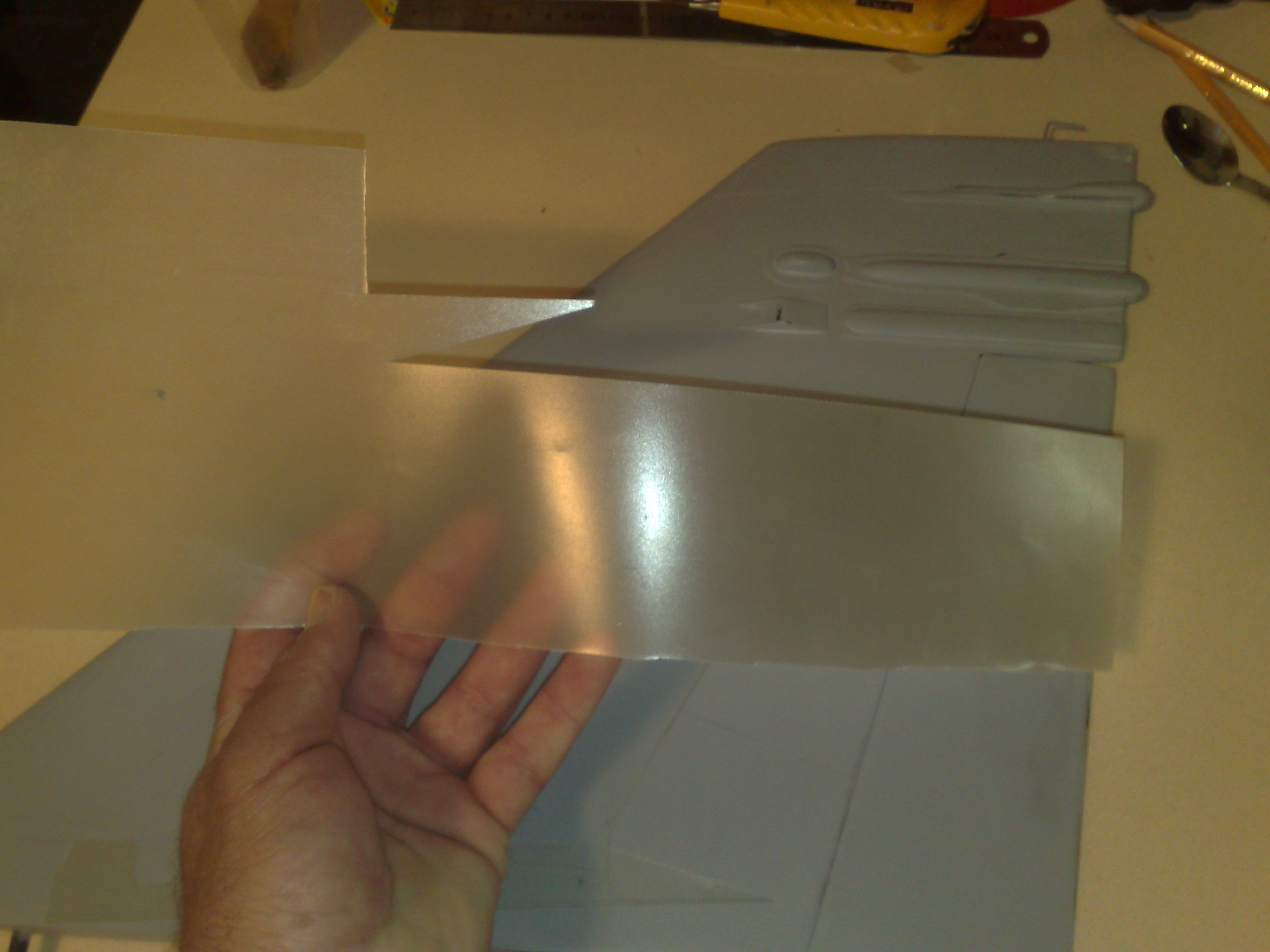

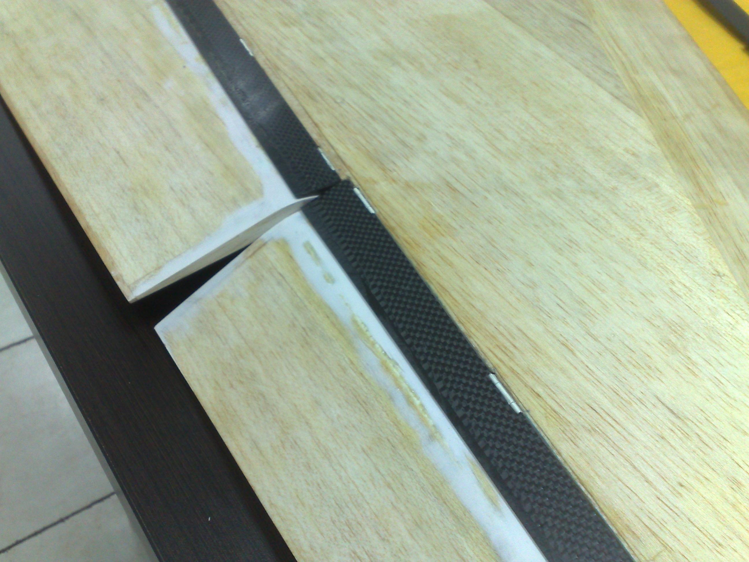

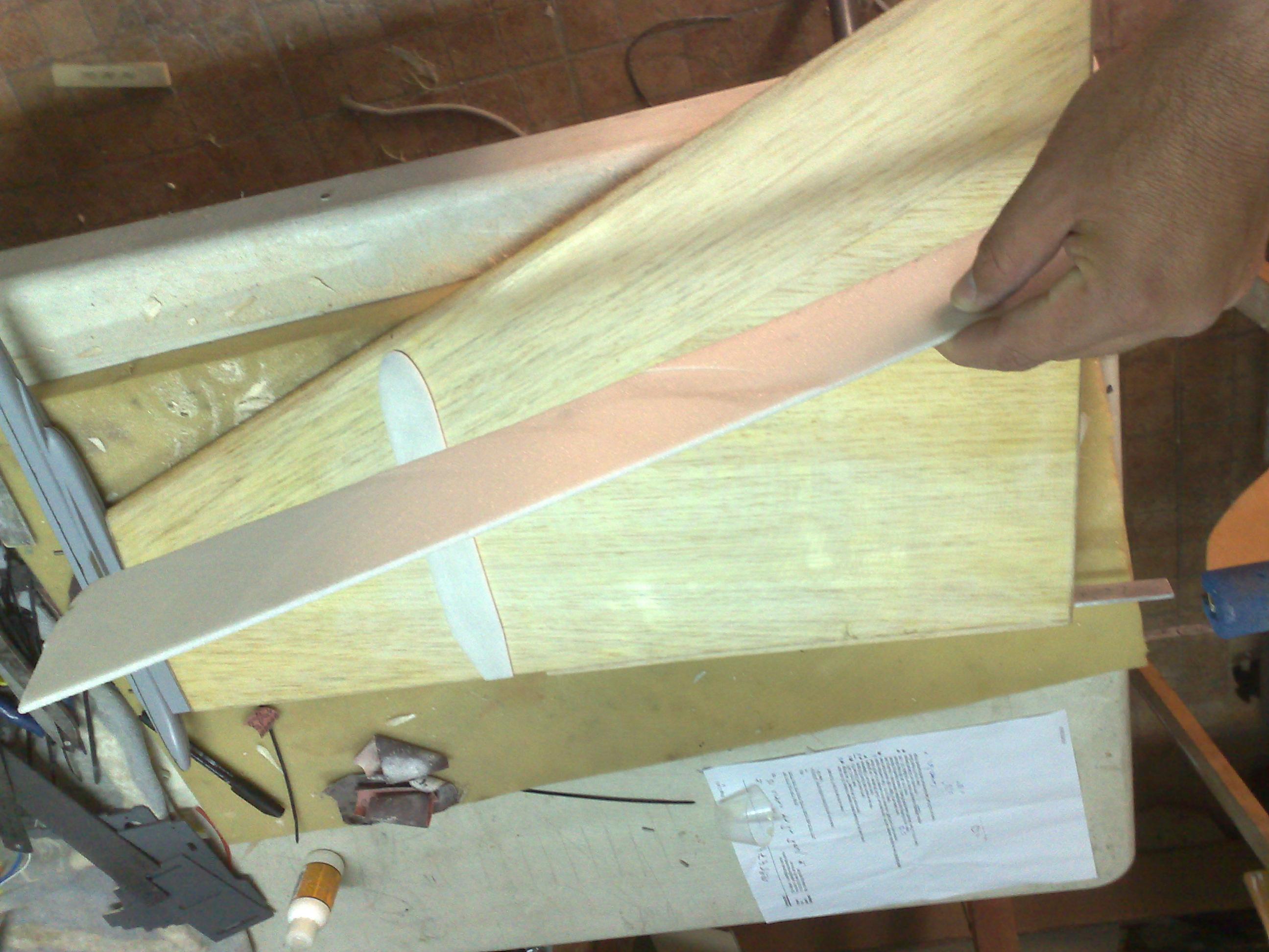

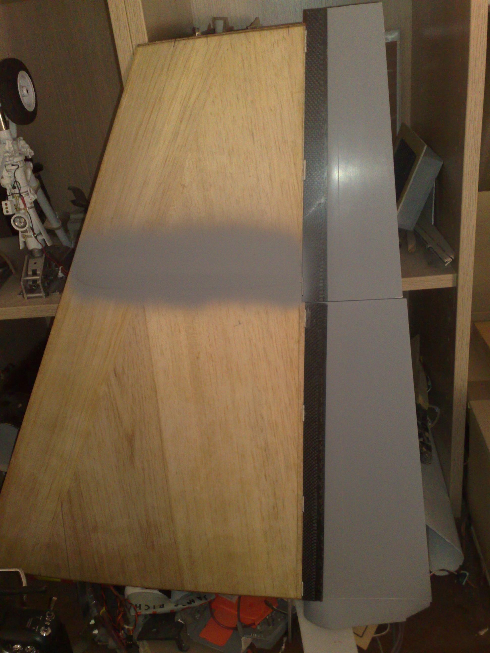

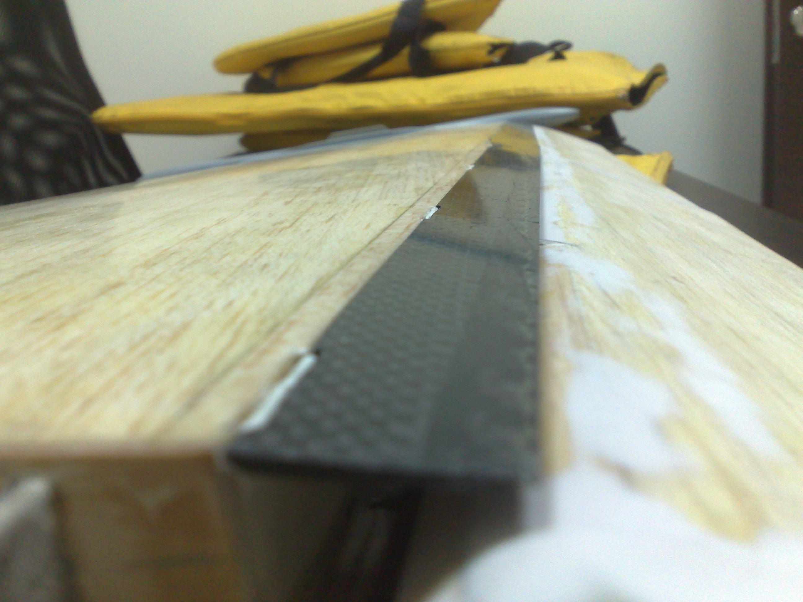

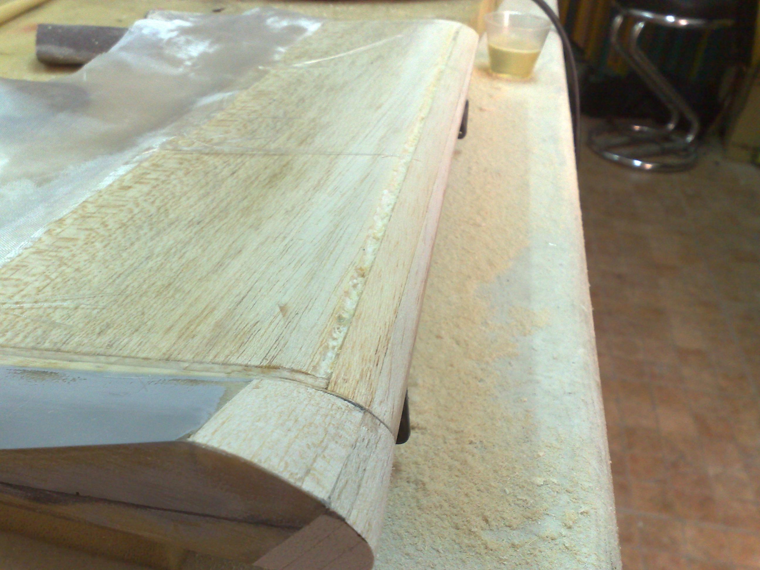

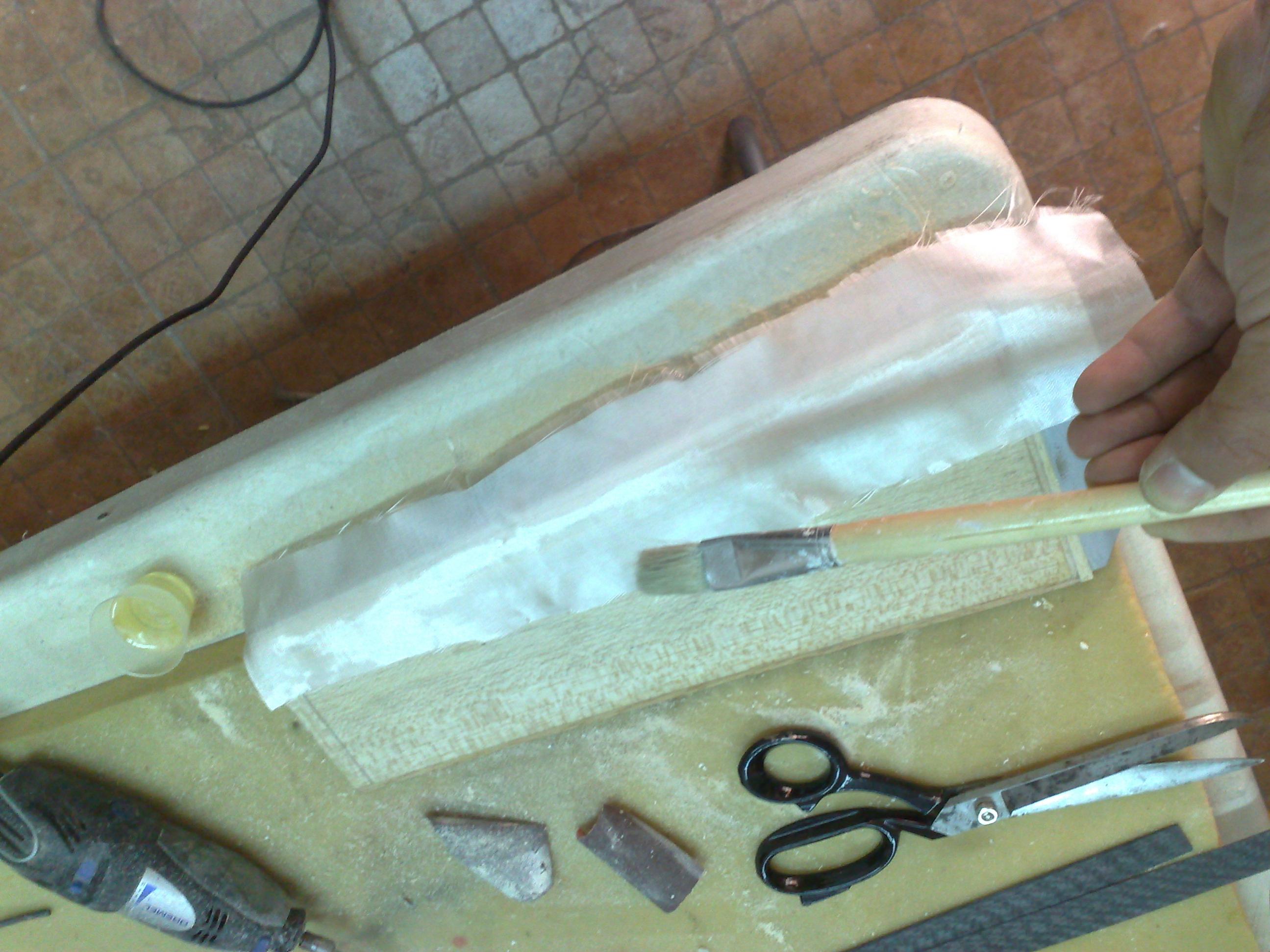

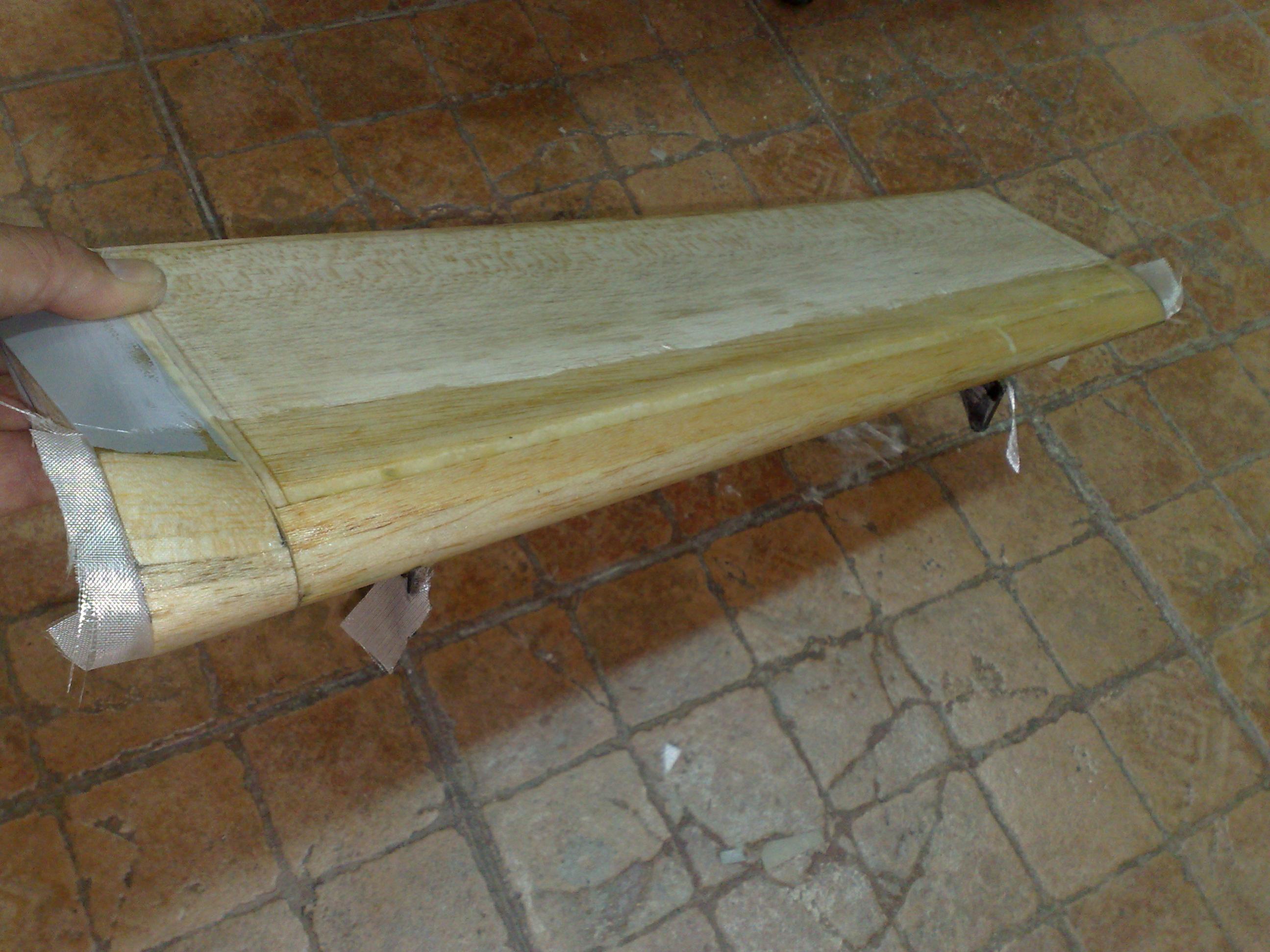

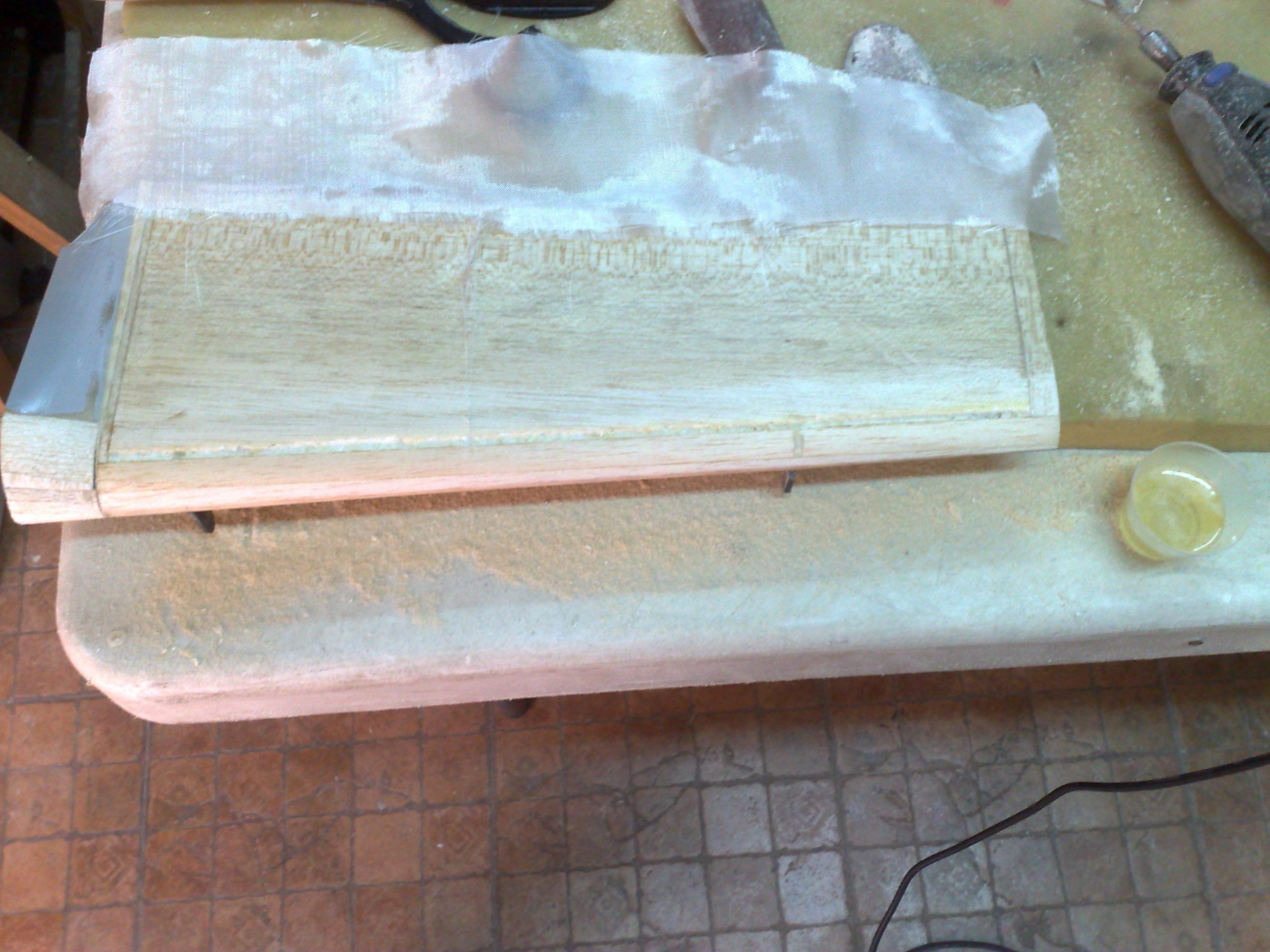

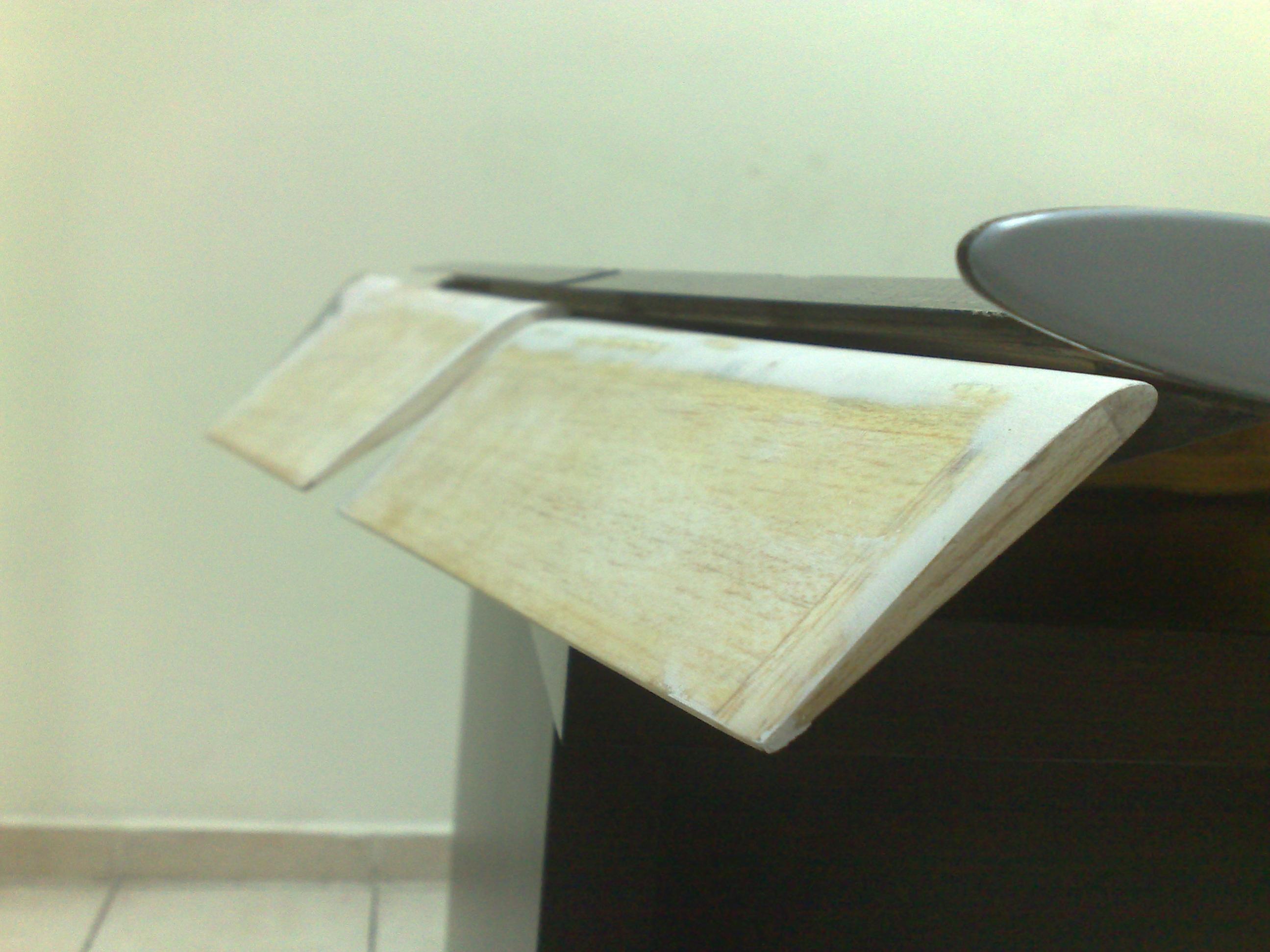

    More work on the wings control surfaces...
    glassing and sanding..
Name:	Yellow Aircraft  F-18C twin build  project 002.jpg‏
ID:	26006   Click image for larger version.
Name:	Yellow Aircraft  F-18C twin build  project 001.jpg‏
ID:	26007   Click image for larger version.
Name:	Yellow Aircraft  F-18C twin build  project 003.jpg‏
ID:	26008   Click image for larger version.
Name:	Yellow Aircraft  F-18C twin build  project 004.jpg‏

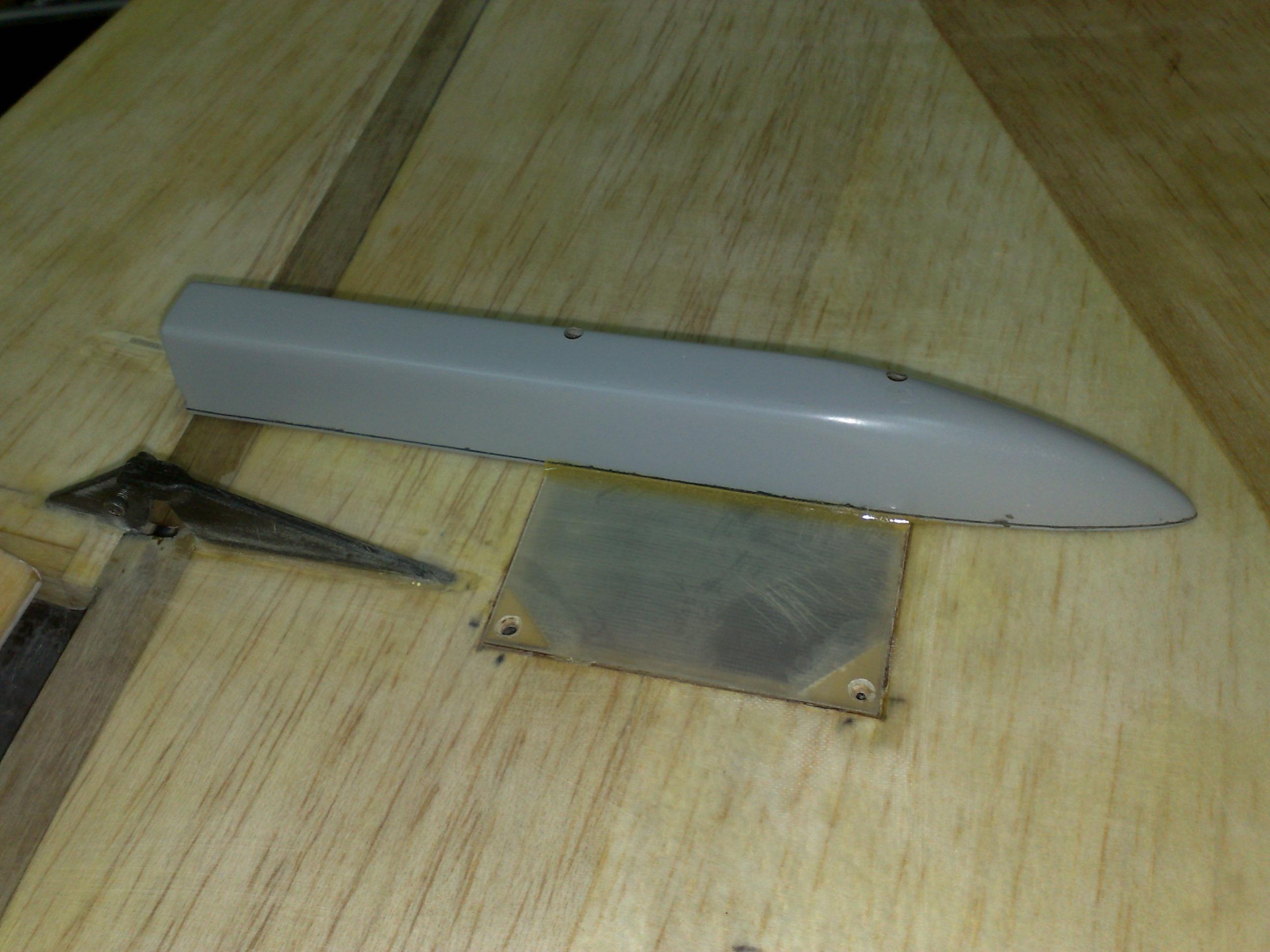

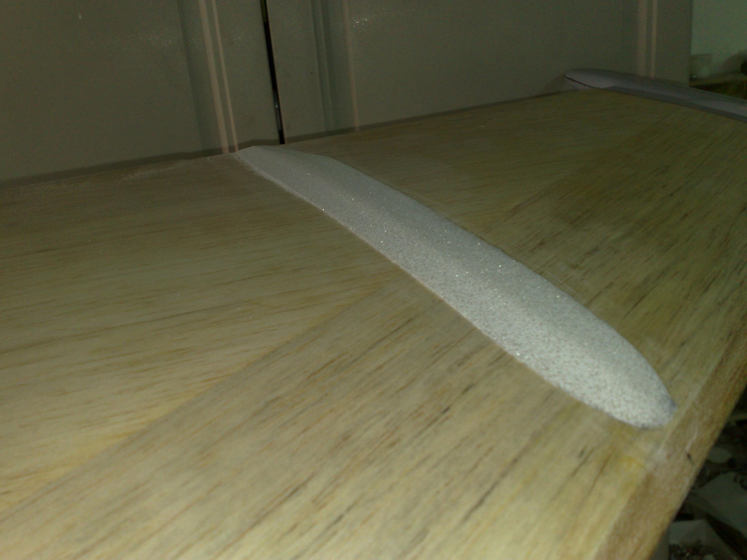

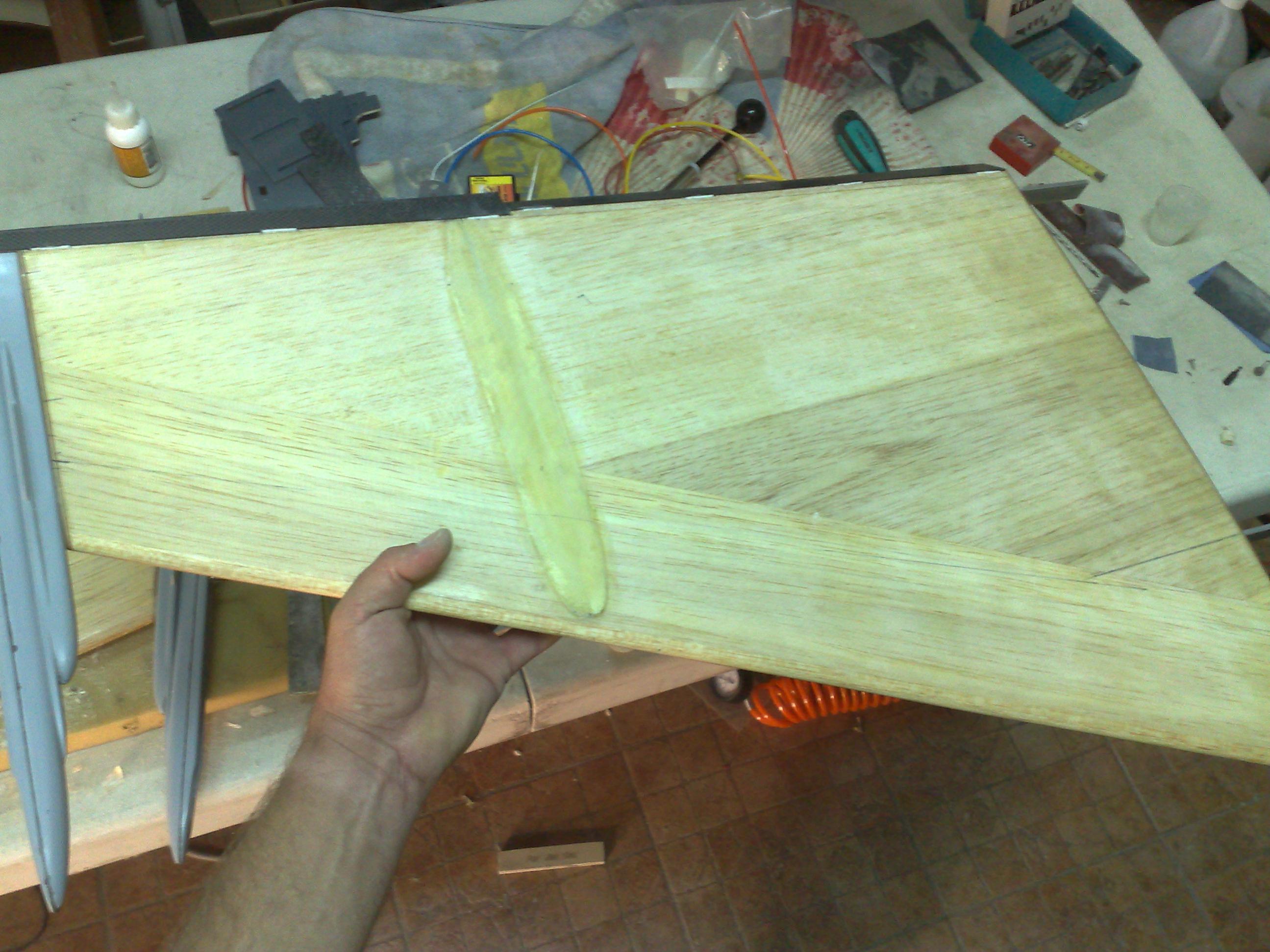

    creating the scale wing folding hump on the top surface of the wing

    more gear doors

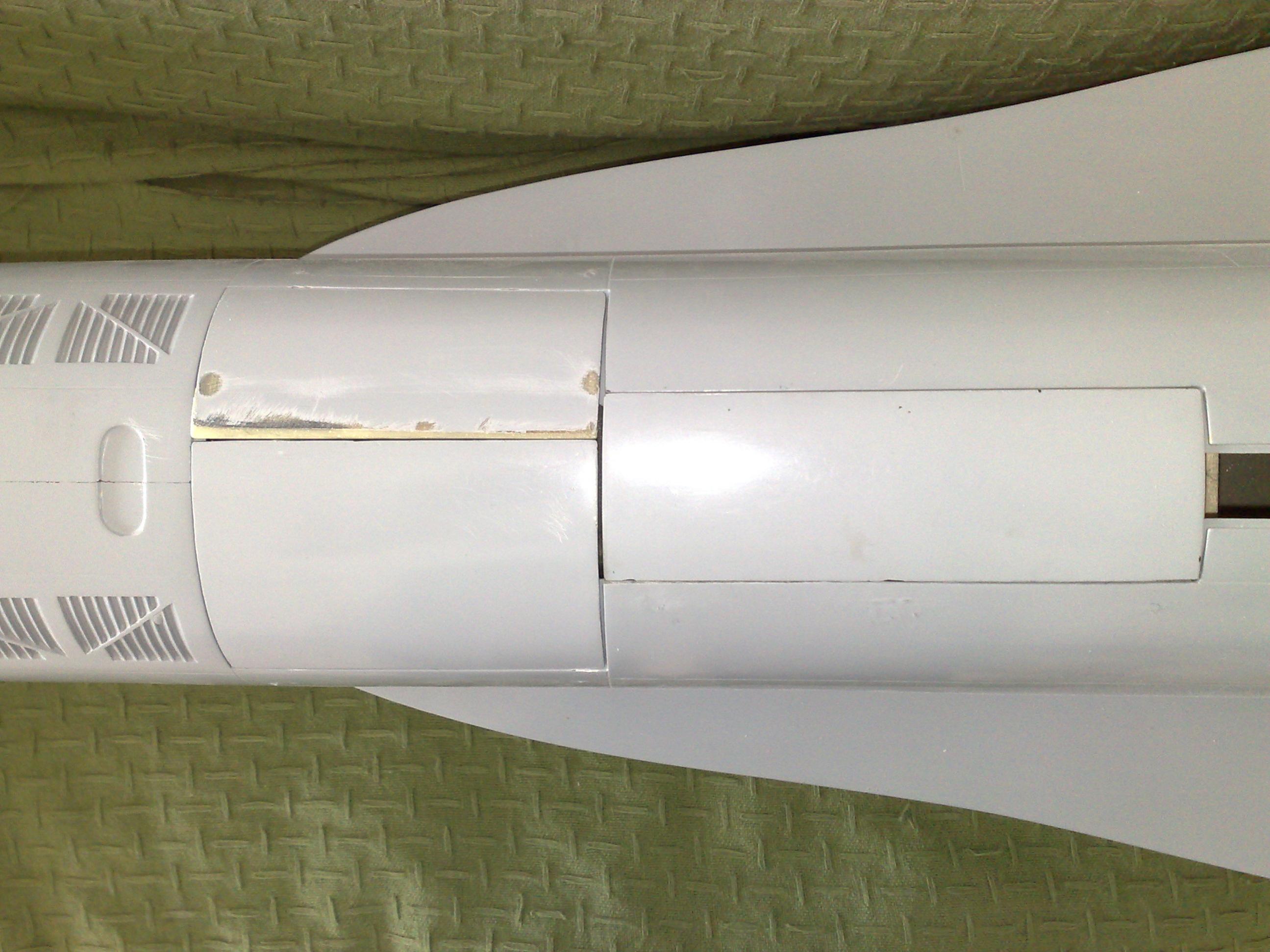

    secondary flap covers
Name:	All sort of pics....Mf-1 antena instalation Micro falcon instal 018.jpg‏
ID:	26019   Click image for larger version.
Name:	All sort of pics....Mf-1 antena instalation Micro falcon instal 017.jpg‏
ID:	26020   Click image for larger version.
Name:	All sort of pics....Mf-1 antena instalation Micro falcon instal 019.jpg‏
ID:	26021   Click image for larger version.
Name:	All sort of pics....Mf-1 antena instalation Micro falcon instal 021.jpg‏
ID:	26022   Click image for larger version.
Name:	All sort of pics....Mf-1 antena instalation Micro falcon instal 020.jpg‏

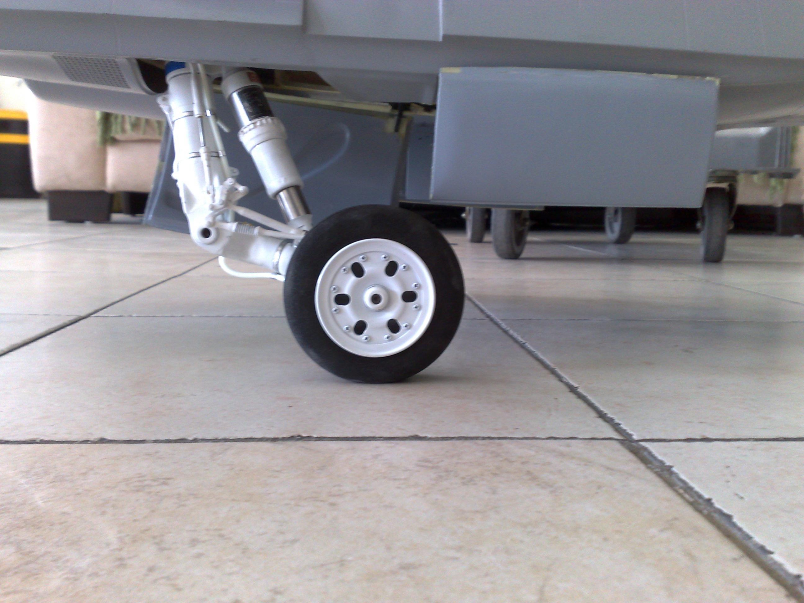

    main port strut
Name:	F-18 build pics part II + gear and gear door stance 006.jpg‏

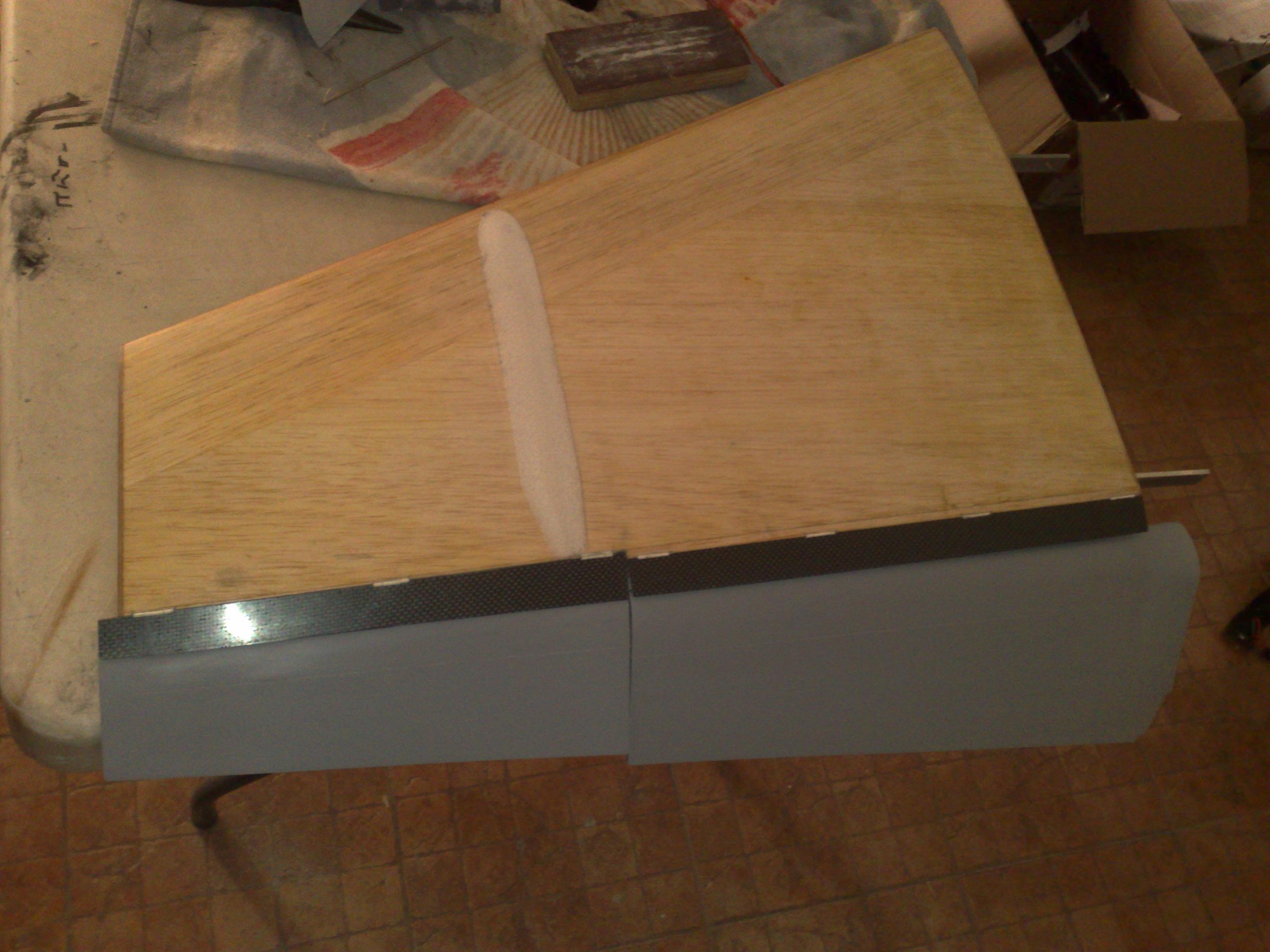

    Flaps and Ailerons after primer been applied
