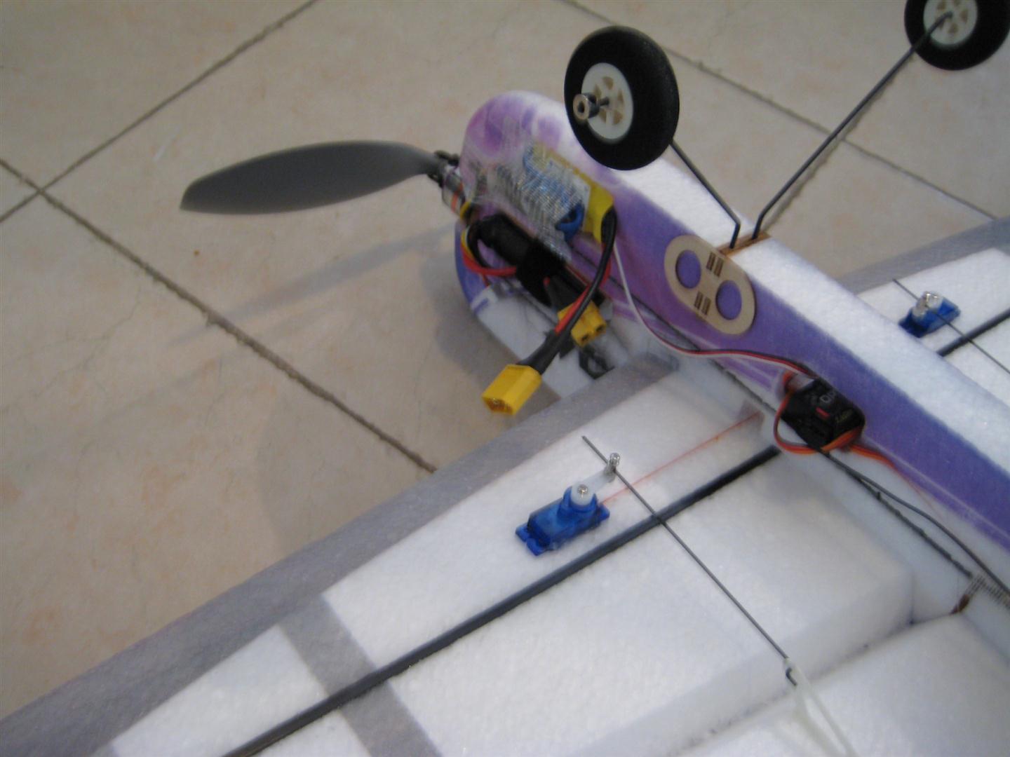

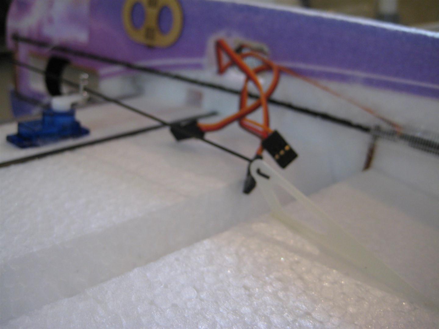

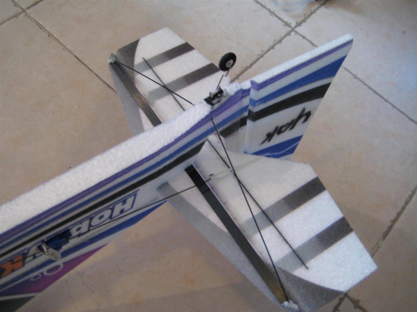

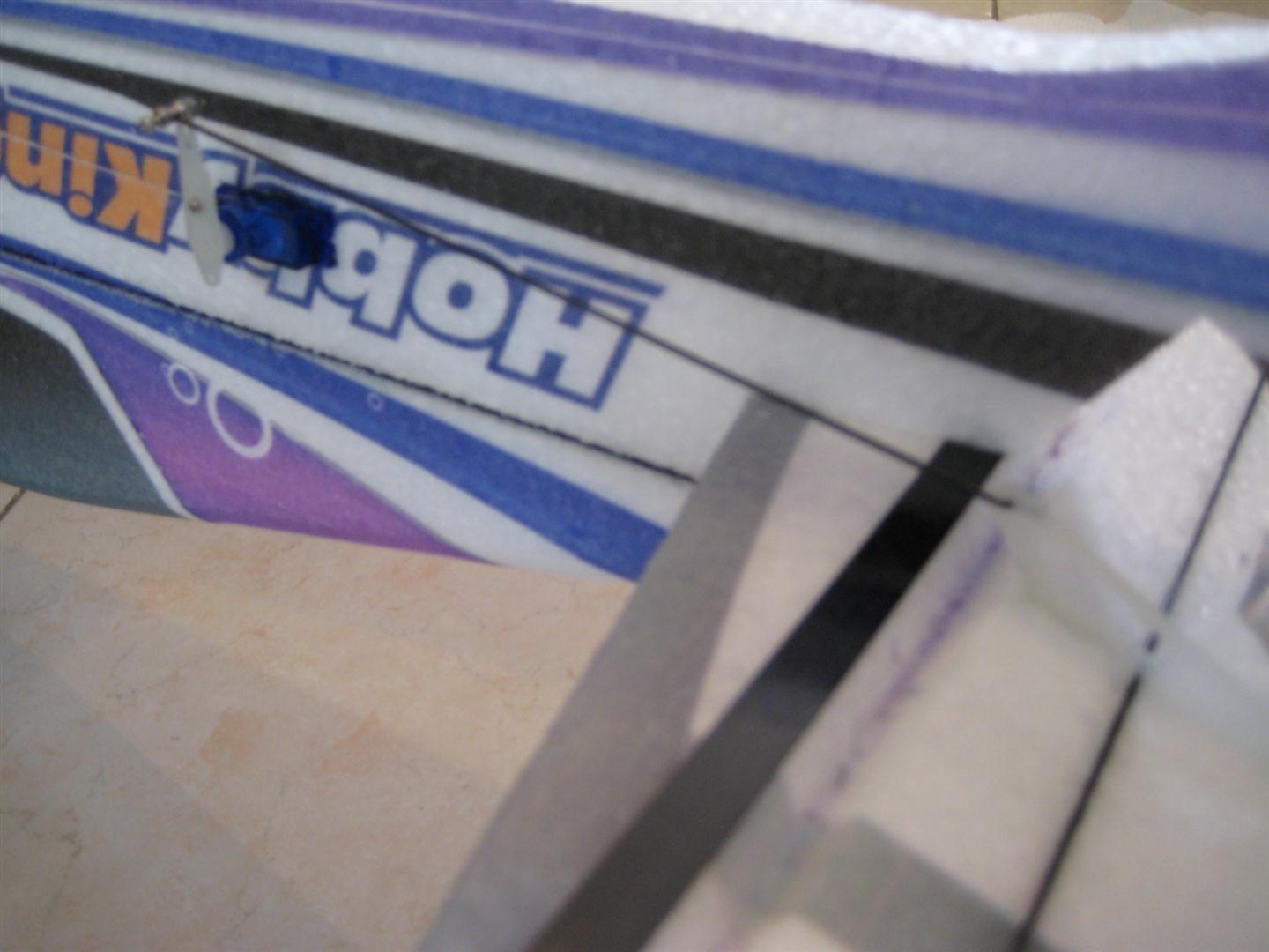

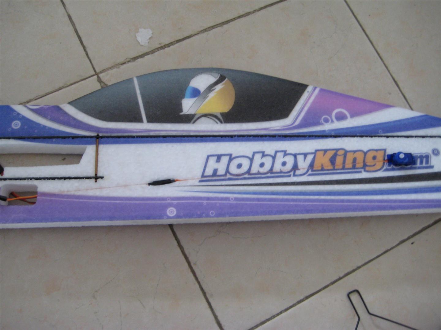

The Hobbyking Yak54 3D will require some assembly work to have it complete. This KIT was ready with about 5 hours of work
The quality of this KIT is execellent. The instructions manual is one of the best I have seen.
Fuselage

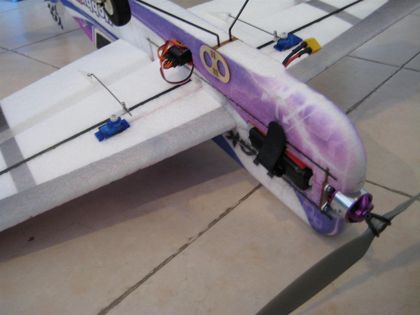

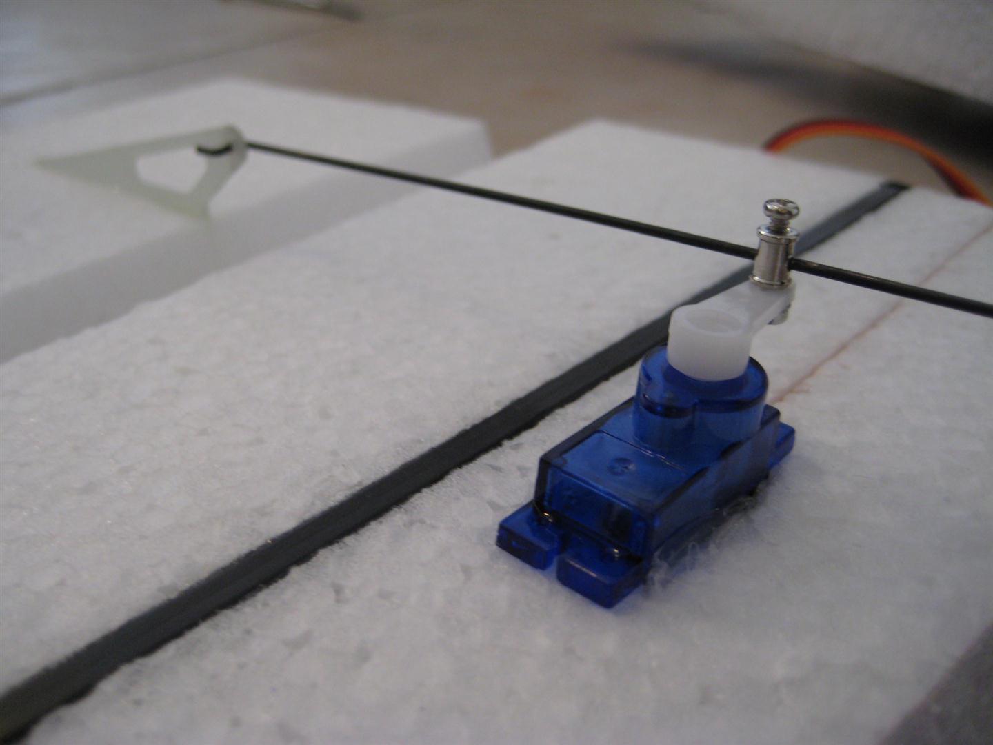

I used hot glue to install the rudder, ailerons and elevator servos instead of the wood frame provided.

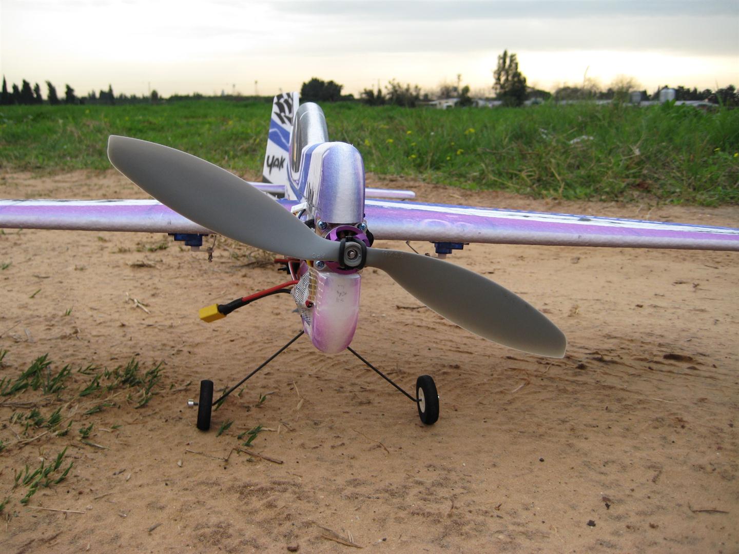

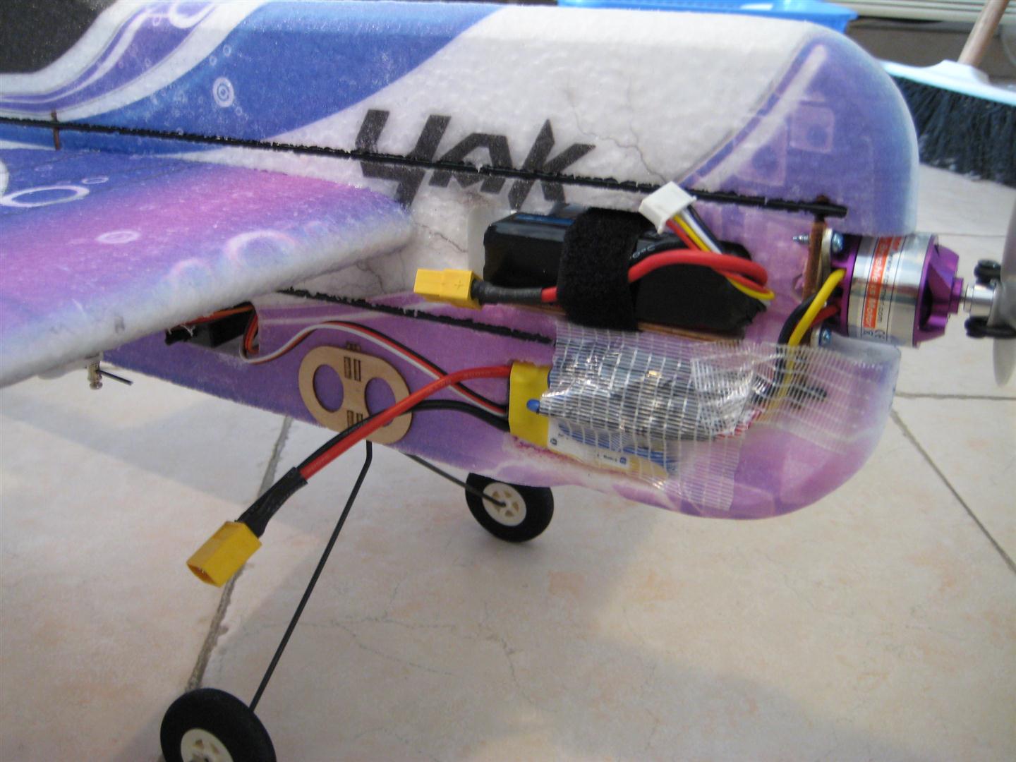

Power system
Rctimers 2830-13 850KV Outrunner Brushless Motor
30A ESC
4x HXT900 servos
prop 11x3.8
Watt meter results: 12-13A with ~135Watts.

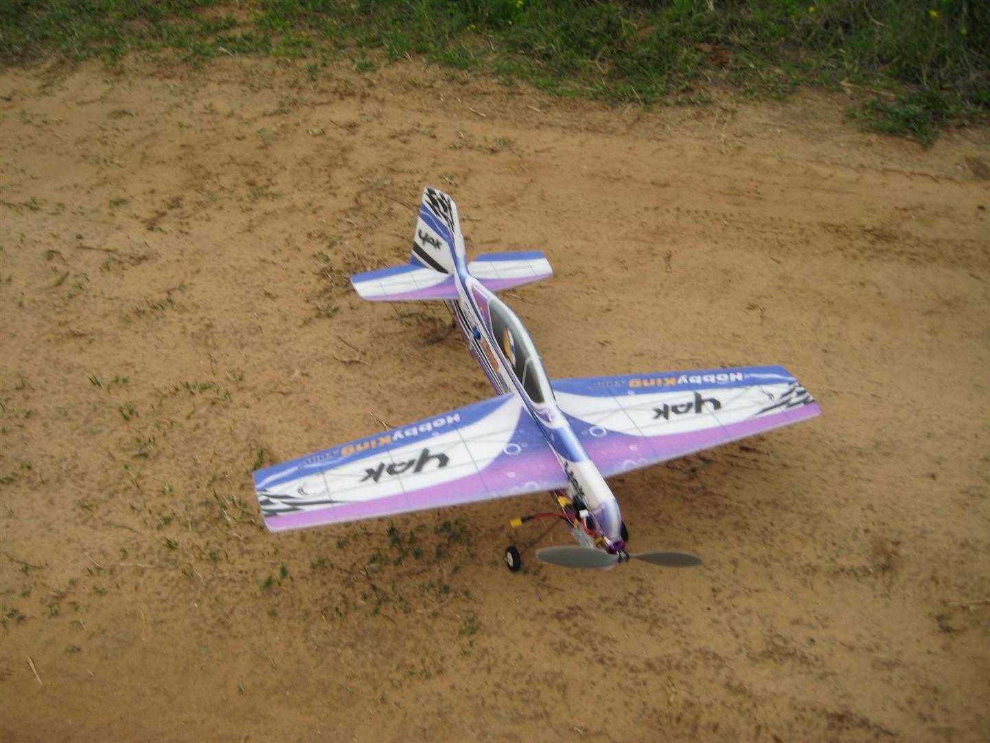

Flying
One click of trimming was required for this model.
I'm not a 3D master but was able to hoover and do some basic aerobatics very easily.
