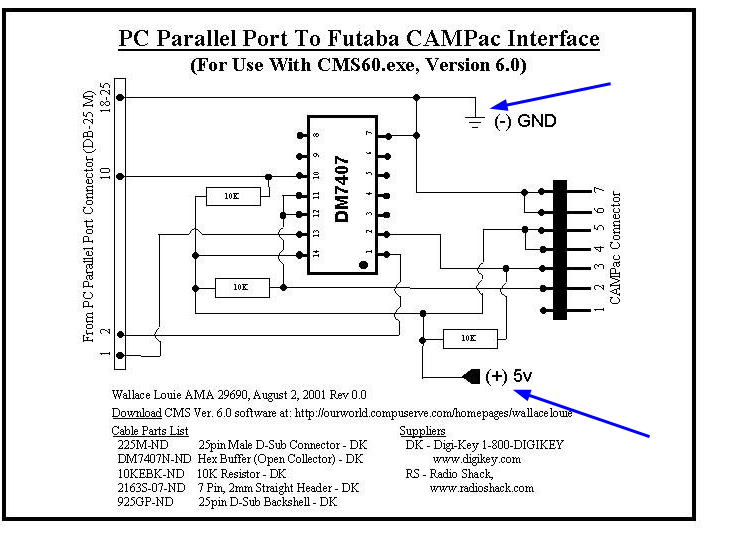

    I'm about to try to build this campac
    Did you managed to build 64k ? 128k ?
    Is this the connector that fits the Fuaba ?
    http://www.digikey.co.il/product-det...S-07-ND/202202
    I also found nice tool for data migration from the Campac to the PC - But here he presents different scheme for the home made Campac
    http://pierre.rondel.free.fr/images/...c/index_en.htm
    Or else I supposed to use the attached scheme
    http://www.diyrc.com/c6cbl.jpg

    the bent pins one is better

    I bought connector (receptacle) but it doesn't fit.
    Its pitch is 2.54mm.
    Do you know what is the correct required pitch?
