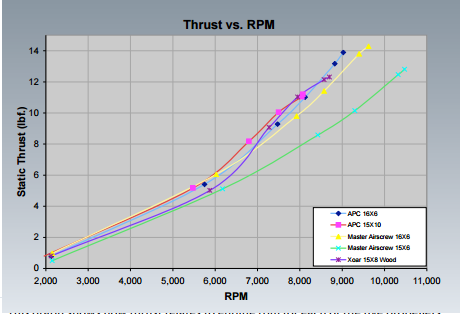

    It turns a Master Airscrew clasic 16X6 prop at 9,625 RPM - making 14.3 lbs thrust
    is the same result like the os 110a
Name:	ביצועי פרופ.png‏
