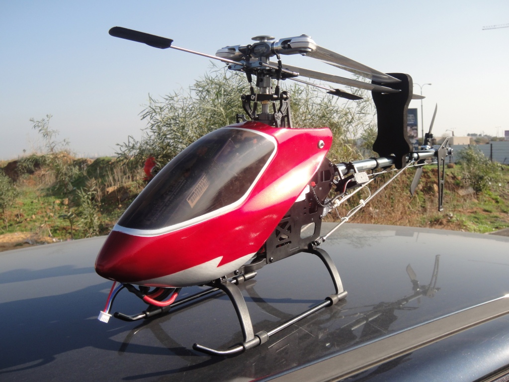

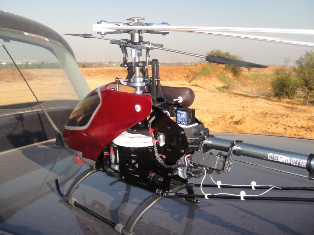

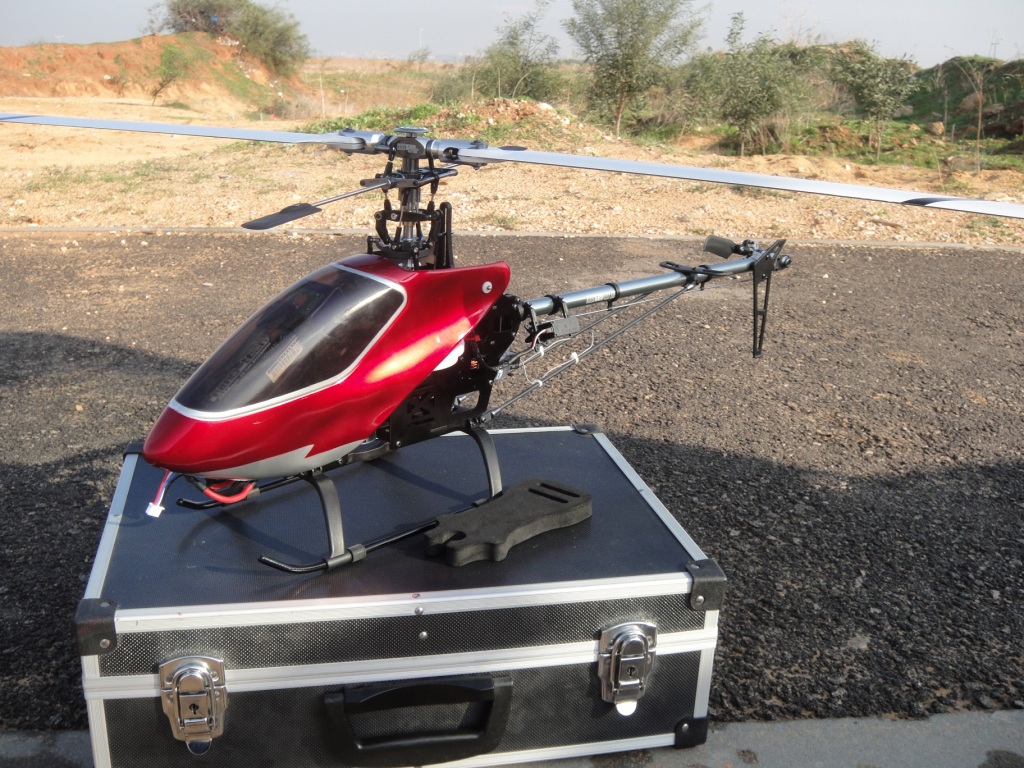

    Some pictures from the field
ID:	38017Click image for larger version.
ID:	38018Click image for larger version.
ID:	38019Click image for larger version.
ID:	38020Click image for larger version.

    Test Flight Video
    Review and Assembly Summery and Conclusions
    To summarize this review I can say that this heli is very nice and fun to assemble and pretty nice to fly.
    For a everyone that looks for a large heli with less budget this will be a great choice!!
    In flight, it was very smooth and stable and it was quite fun to fly it. As for 3D capabilities, well I believe that it truly can do this but maybe
    it would be better to upgrade the gyro for this.
    However, I truly recommend it to my friends!!.
