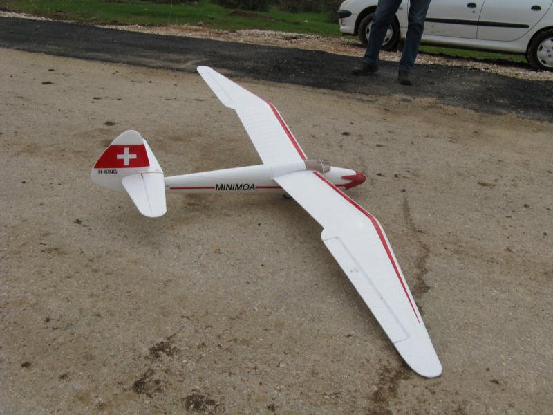

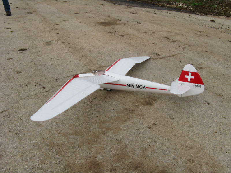

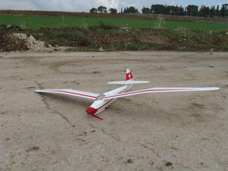

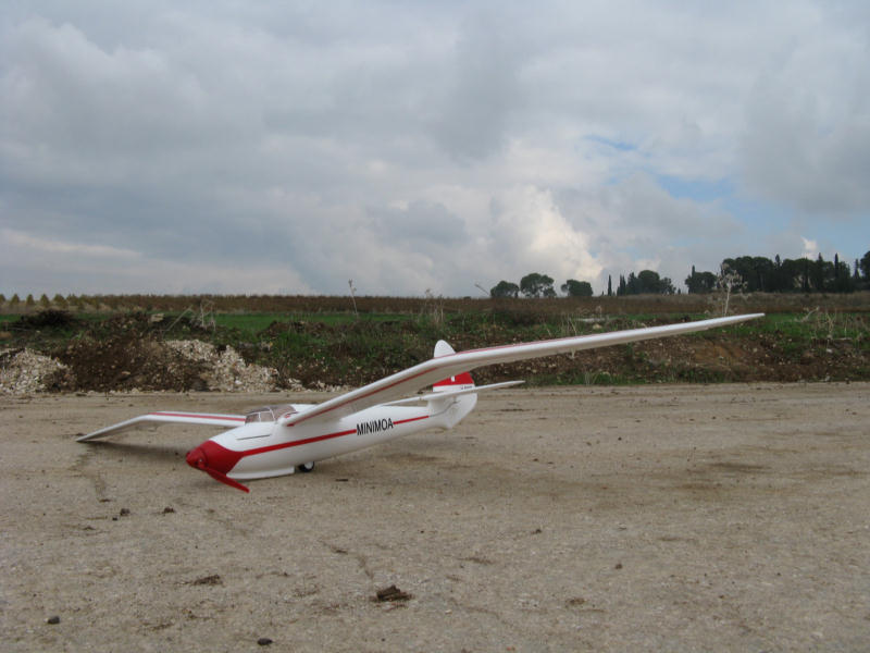

    Introduction
    The Minimoa sailplane, build in the mid 30's, was one of the first sailplanes build by Schempp-Hirth company, a most famous and largest glider manufacturer in Germany and in the world.
    First flown in 1935, the Minimoa with its amazing silhouette was probably one of the most famous gliders of it's time, It was one of the sailplanes symbolizes the German soaring. Because of it's technological breakthrough it was the glider which helped many pilots quit the slope flying and explore the thermal or even the wave soaring. It was a big step from experimental soaring to pure sport flying. It was the first sailplane to carry water ballast, in a tank behind the cockpit.
    In the late 30's (1938) the Minimoa established the world altitude record of 22,000 foot during a flight in a cumulonimbus cloud.
    Richard du Pont and Chet Decker flew Minimoas to win the U.S. Championships in 1937 and 1939.
    The HobbyKing Minimoa RC glider is 1/8.5 scale of the full-sized sailplane, but of course, an electric motor was added for take off assistance

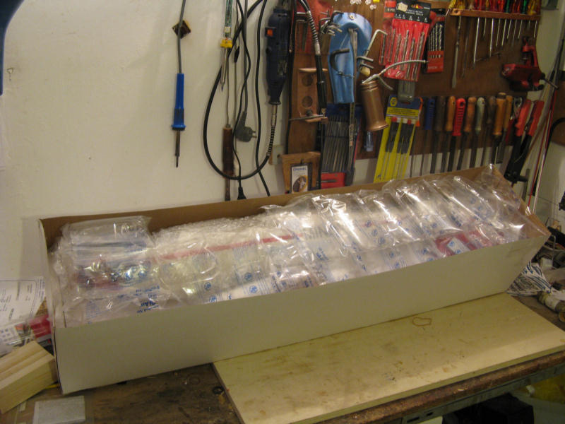

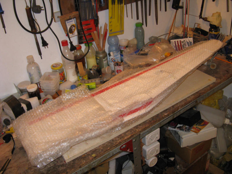

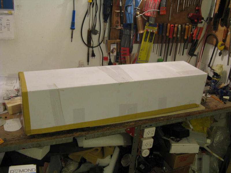

    Kit Contents
    The Hobbyking Minimoa was very well packed, in two cardboard boxes, one inside the other. They use lot of adhesive tape, so nothing could have moved or damage while being on the way. Everything arrived in perfect condition with no damage.
    In the box
    Fuselage with installed motor 1200Kv, 20A ESC, spinner and folding prop', two 9gr servos, landing wheel, pushrods
    two wings with aileron servos, pushrod and aileron horn installed

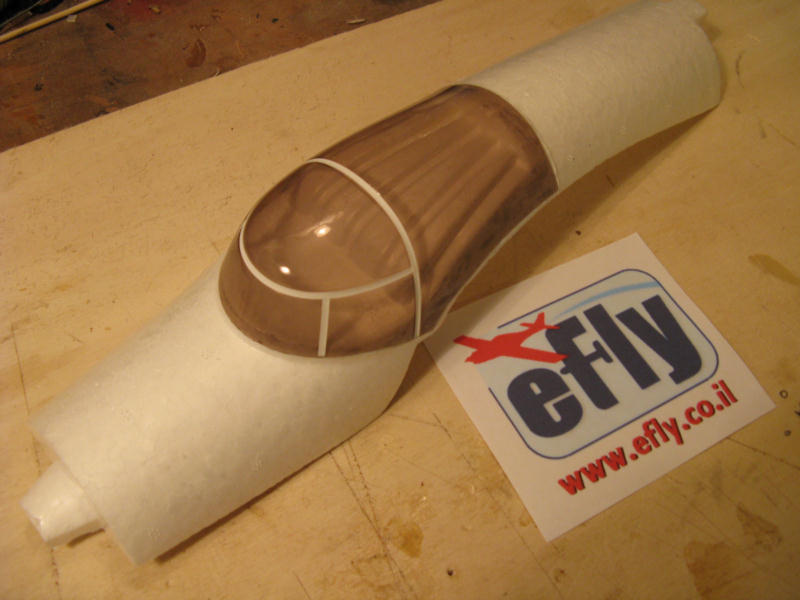

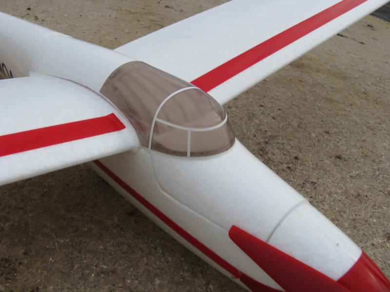

    Canopy
    Elevator with installed horn
    Rudder with installed horn
    Plastic bag contain
    Four nylon screws - 4M - 2 for the elevator, 2 for the wings Phillips head screw driver
    a foam double sided tape
    spare props
    Y-cable for aileron servos
    Aluminum made wing joiner
    wing bracket
    small Allen key with 2 x grub screws
    A tube of unknown adhesive

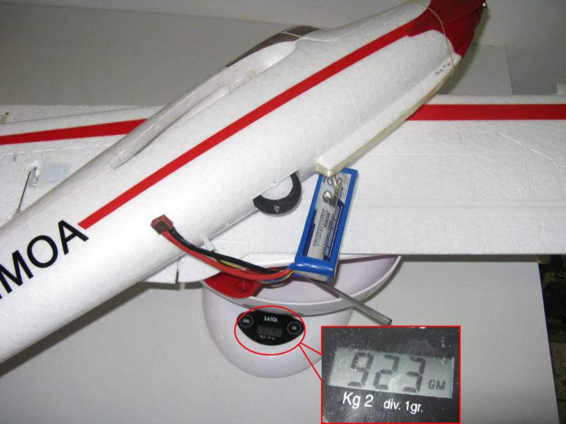

    Weight: 923g/ 32.6oz include battery & receiver - ready for flight

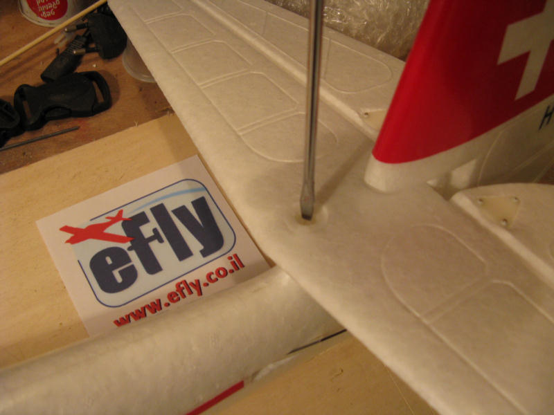

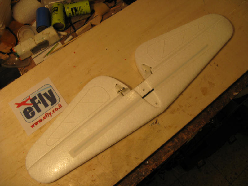

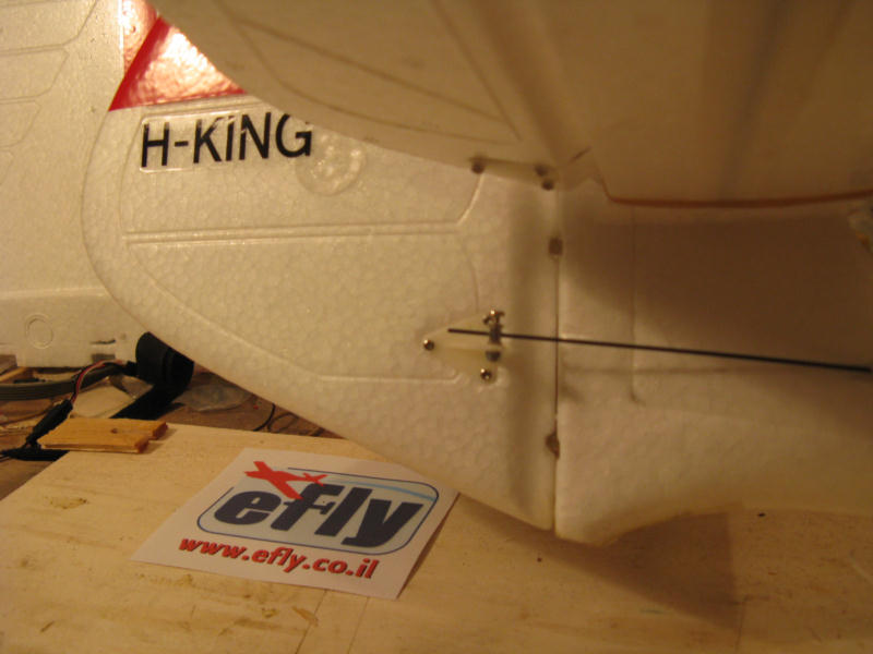

    Tail

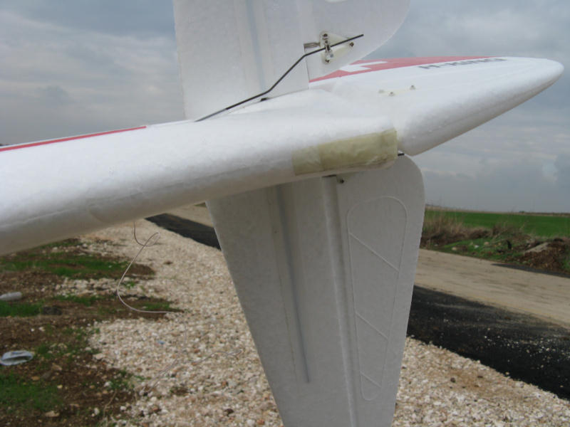

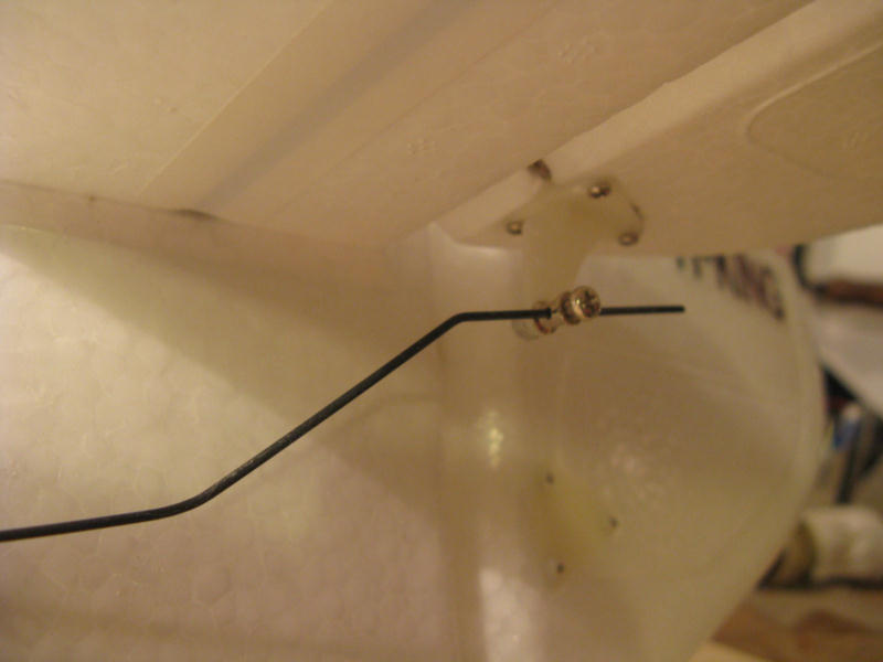

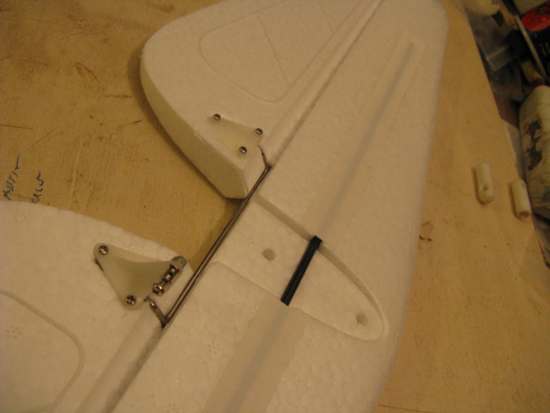

    You should install the elevator with 2 nylon screws (don’t forget to connect the pushrod to the elevator horn first) and than to glue the rudder hinges to the rear part of the fuselage (again, do not forget to connect the pushrod to the rudder horn first)
    Next you have to install your receiver and battery in the fuselage and connect it to elevator and rudder servos.
    Next thing is to balance the glider to the proper CoG.

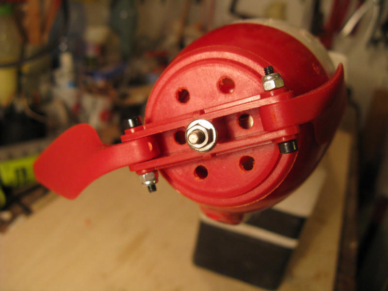

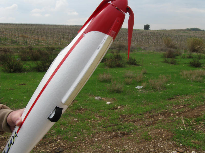

    In order to minimize the motor warm up, I drilled in the spinner's hub 6 holes to allow air to cool the motor.

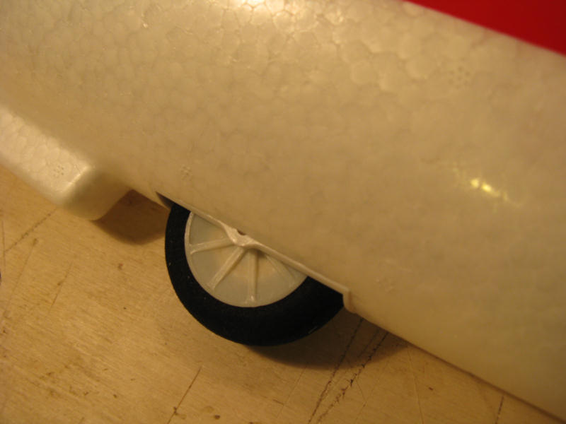

    I put strong piece of adhesive tape to minimize damage to the foam's front and tail skids.

    Touchdown is very smooth with the installed wheel

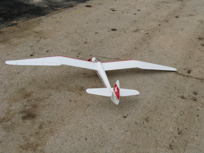

    Conclusion
    I really love the look of the gull wings while watching the Minimoa in flight! Everything worked as it should and the plane showed no bad habits so I only have good words to say about this glider. Using the recommended balance point and original controls throws, the plane performed fine on all flights. The 3s 2200Mah Battery balanced the plane perfectly. Purchasing this sailplane is a very good deal

    Did you notice motor overheating as reported on RCG?
    I'm using an 8" prop to avoid it and it gives sufficient pull.

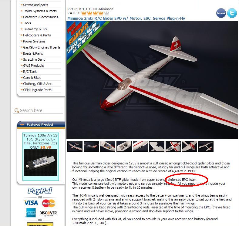

    I have a question regarding the EPP it's made from,
    Is it durable? will it last more then a few flights?

    זה עשוי מ ELPOR.. סוג אחר של חומר מוקצף - זה שילוב של EPS ו EPP. די עמיד אבל לא כמו EPP

    If I'm wrong may I become a cheerleader with a mustache
    WRONG - its EPO

    לפחות בפרסום שלהם כתוב EPO. אני מבין קטן בניואנסים של החומרים המוקצפים, אבל הגימור של הטיסן הזה טוב. הוא חלק מאוד ונראה כאילו יש עליו שכבה דמוית לכה.
