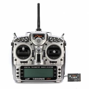

    Transmitter + Receiver: FrSky 2.4G ACCST Taranis X9D Plus Transmitter With X8R Receiver - 236$

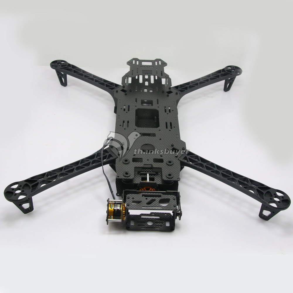

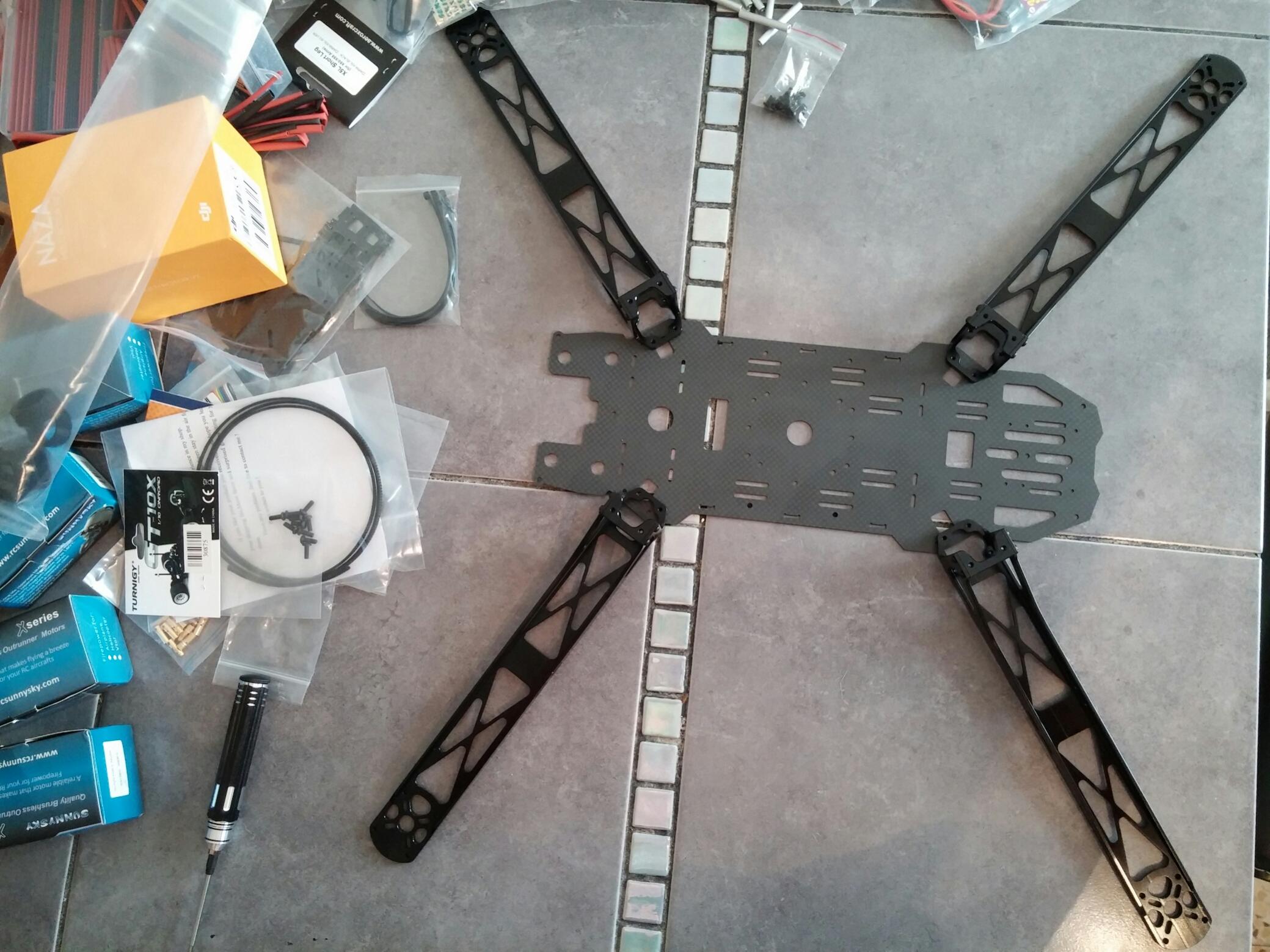

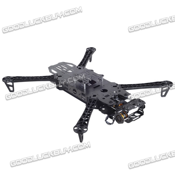

    Frame: FPV REPTILE-550 550mm Carbon Fiber Alien Four-axis Aircraft Quadcopter Frame - 126.60$

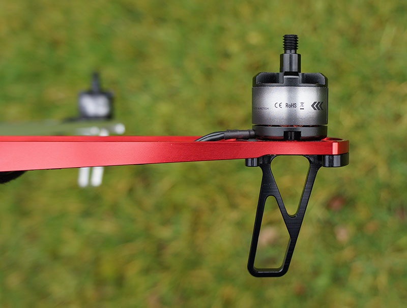

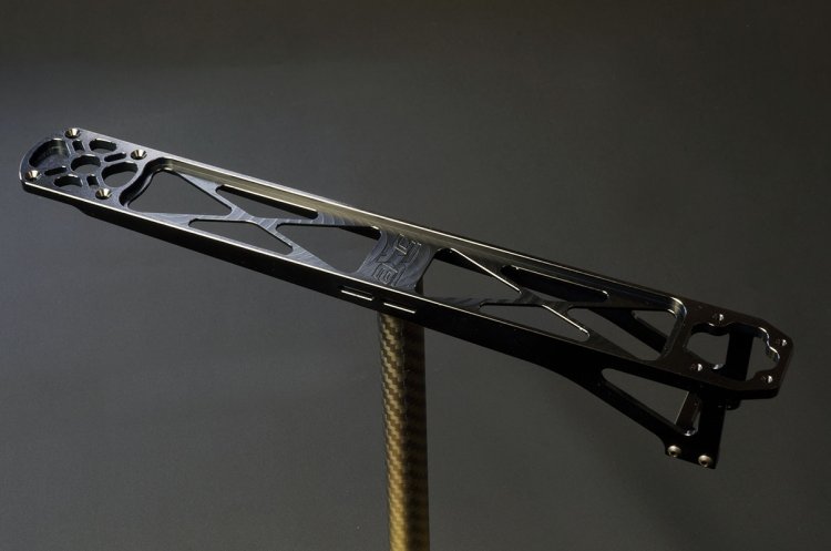

    Arms: X55 Extended Aluminium Arm - 4 * 29.18$
    Legs: X5L - Short Leg for X50 and X55 arms - 4 * 7.57$

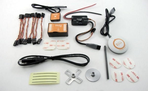

    Flight Controller: DJI NAZA-M V2 - 267.77$

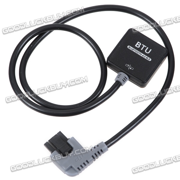

    DJI BTU Module Built-in Bluetooth for NAZA-M

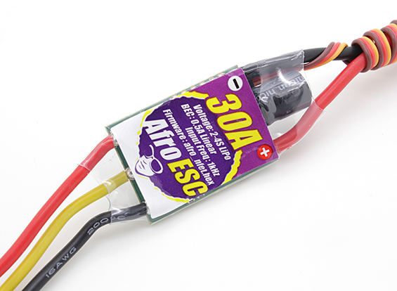

    ESC: Afro ESC 30Amp Multi-rotor Motor Speed Controller (SimonK Firmware) - 4 * 14$

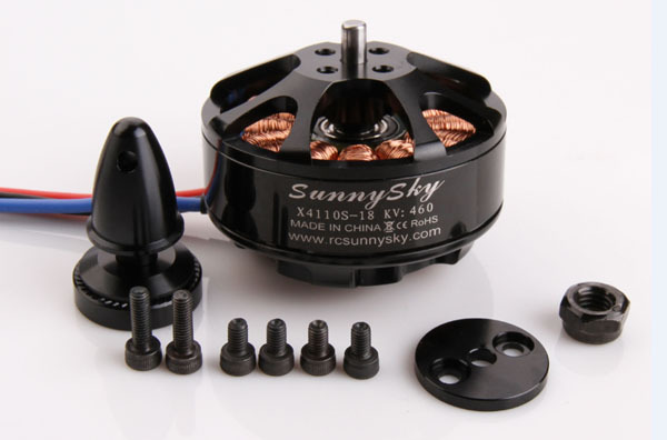

    Motors: Sunnysky X4108S 690KV High Efficiency Brushless Motor for Multicopter 4S - 4 * 39$

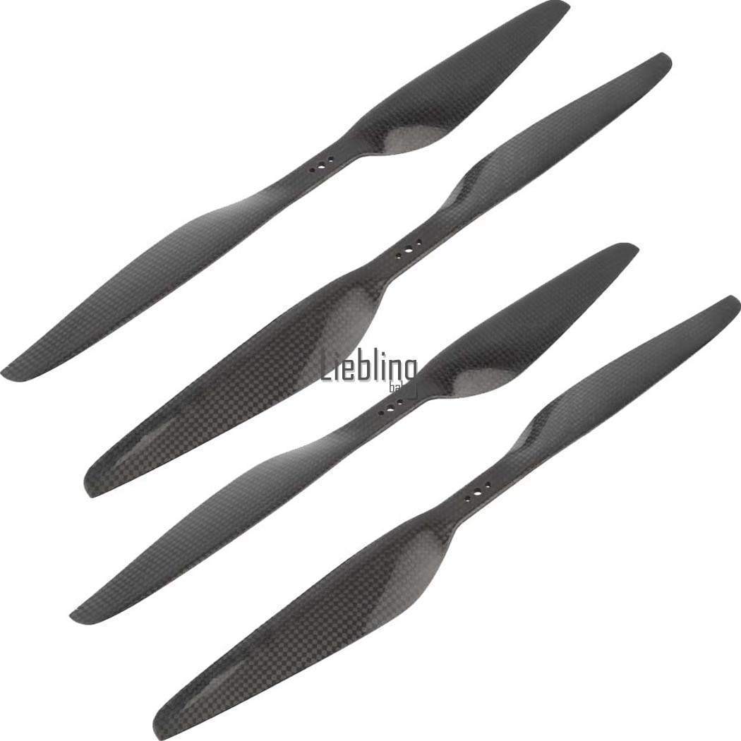

    4X 1448 14*4.8 Carbon Fiber Propeller Prop CW/CCW For T-Motor

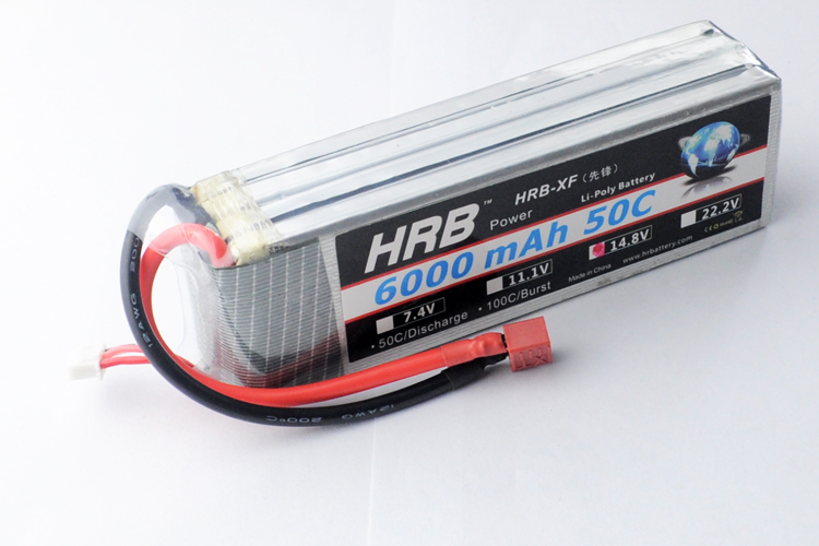

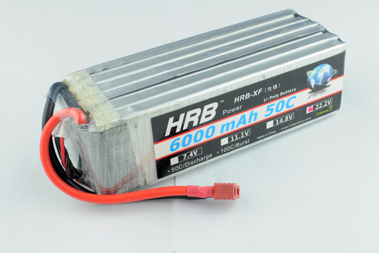

    14.8V 6000mAh 50C Max 60C 4S 4Cells Li-Polymer Battery

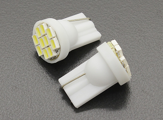

    front LED Light: LED Corn Light - 1.63$

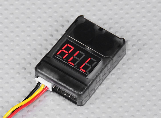

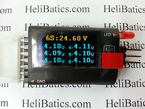

    Cell Checker Low Voltage: Cell Checker with Low Voltage Alarm - 3.80$

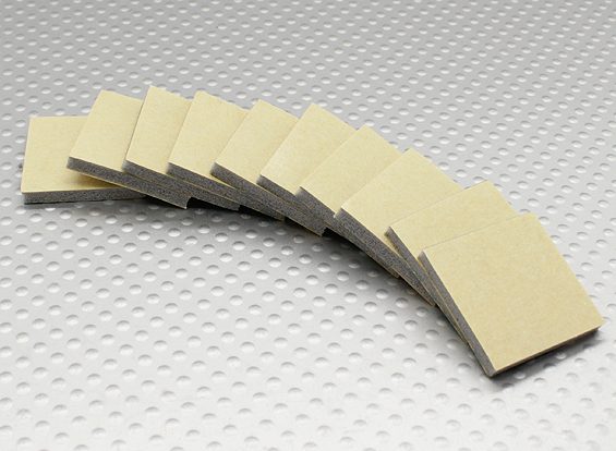

    Flight Controller Mounting Pad: Gyro / Flight Controller Mounting Pad - 1.99$

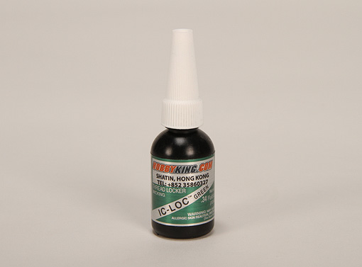

    Thread Locker: TL-242 Thread Locker & Sealant Medium Strength - 0.99$

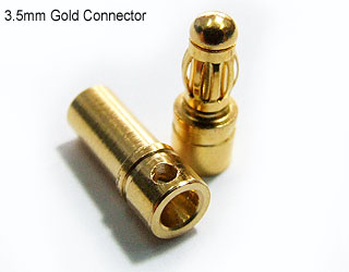

    Gold Connectors: PolyMax 3.5mm Gold Connectors 10 PAIRS - 1.83$

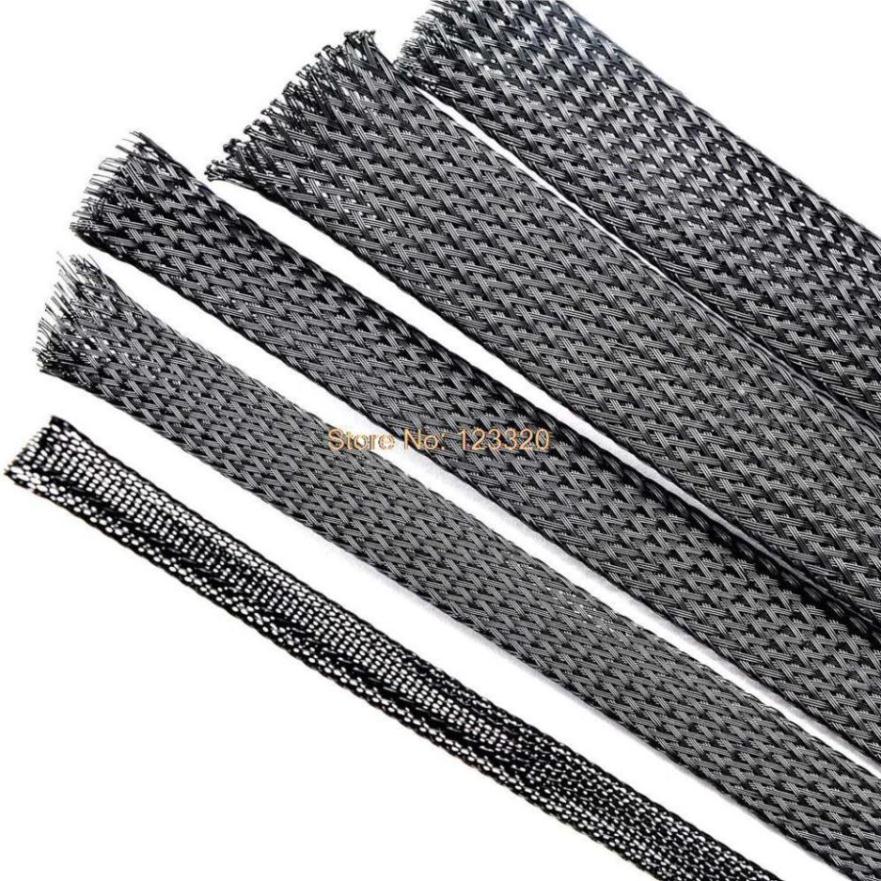

    wire mesh guard: 10 meter Snakeskin mesh guard wire mesh - 6.55$
Name:	20meters-lot-10mm-Knitted-net-snakeskin-network-font-b-wire-b-font-font-b-mesh-b.jpg

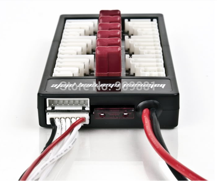

    Parallel Charging Board Charge Plate: Parallel Charging Board Charge Plate For IMAX B6 B6AC B8 Charger - 7.90$
Name:	Parallel-Charging-Board-Balance-charge-Plate-Up-to-6-packs-2-6s-Lipo-LiFe-Lion-Battery.jpg

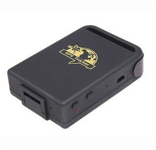

    gps tracker: TK102B 4 band gps tracker - 17.20$
Name:	Mini-GPS-Tracker-Car-Vehicle-GPS-GSM-GPRS-Tracker-TK102-Mini-Global-Real-Time-4-bands.jpg

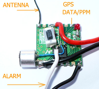

    Solutions for finding lost RC aircraft
    fmkit RF beacon

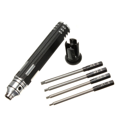

    Screw Driver Tools: 4 in 1 Hex Screw Driver Tools Set Kit 1.5 / 2 / 2.5 / 3mm for RC Helicopter - 5.74$

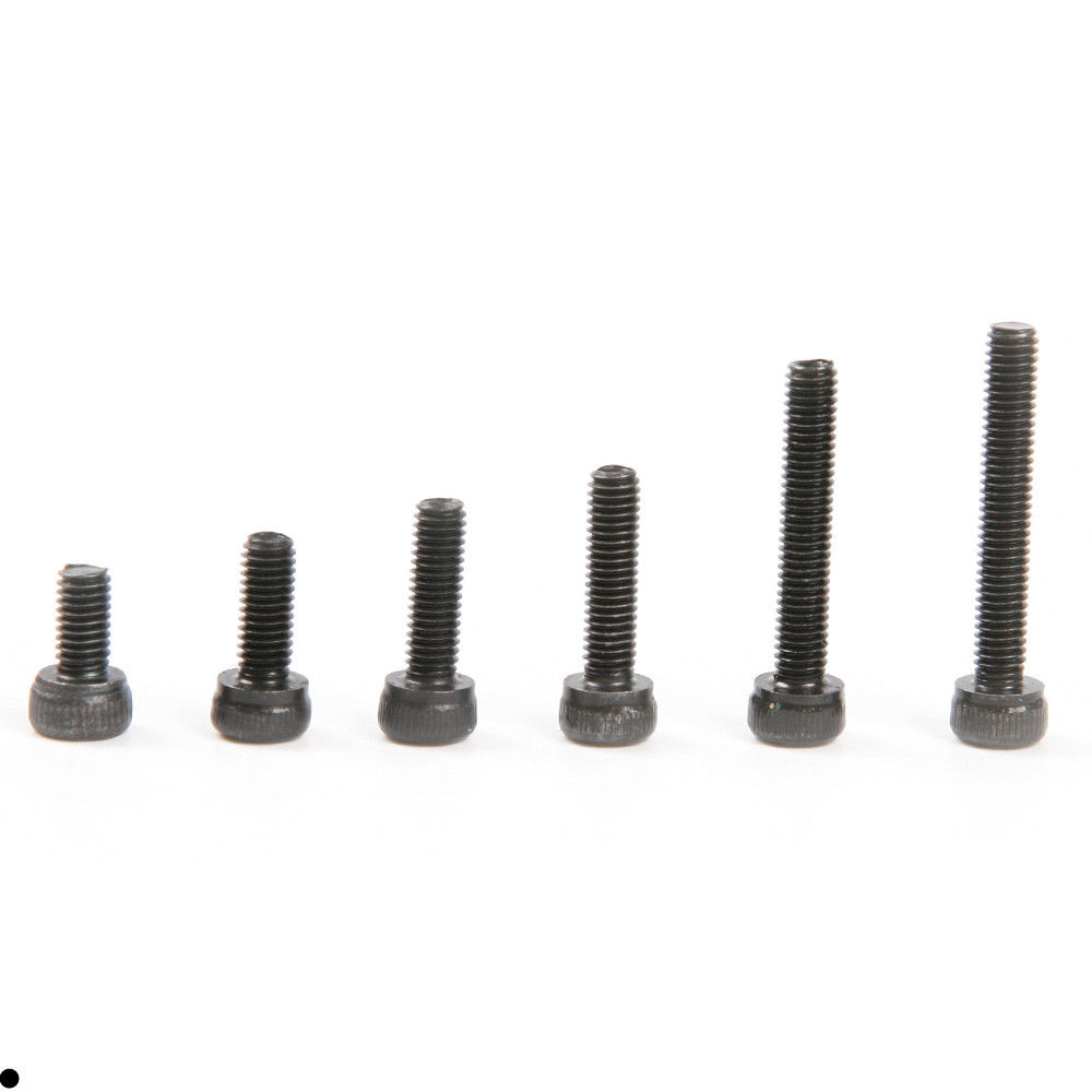

    20pcs Black Thread M3 Alloy Steel Hex Socket Head Cap Screw Bolts 8mm

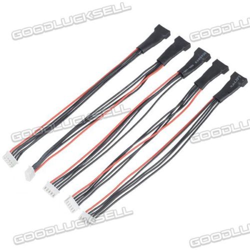

    Battery Balance Charging Extension * 5: 4S Lipo Battery Balance Charging Extension Cable 20cm - 14$

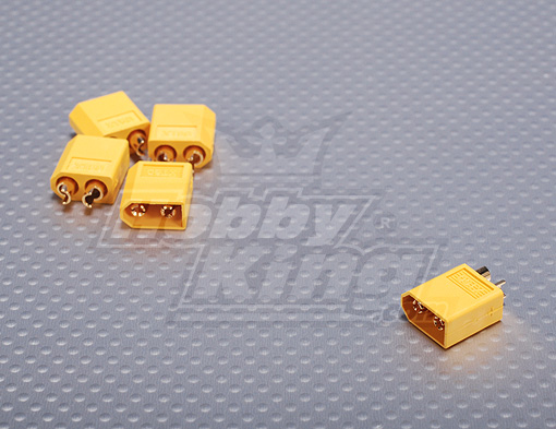

    Male XT60 connectors - 1.94$

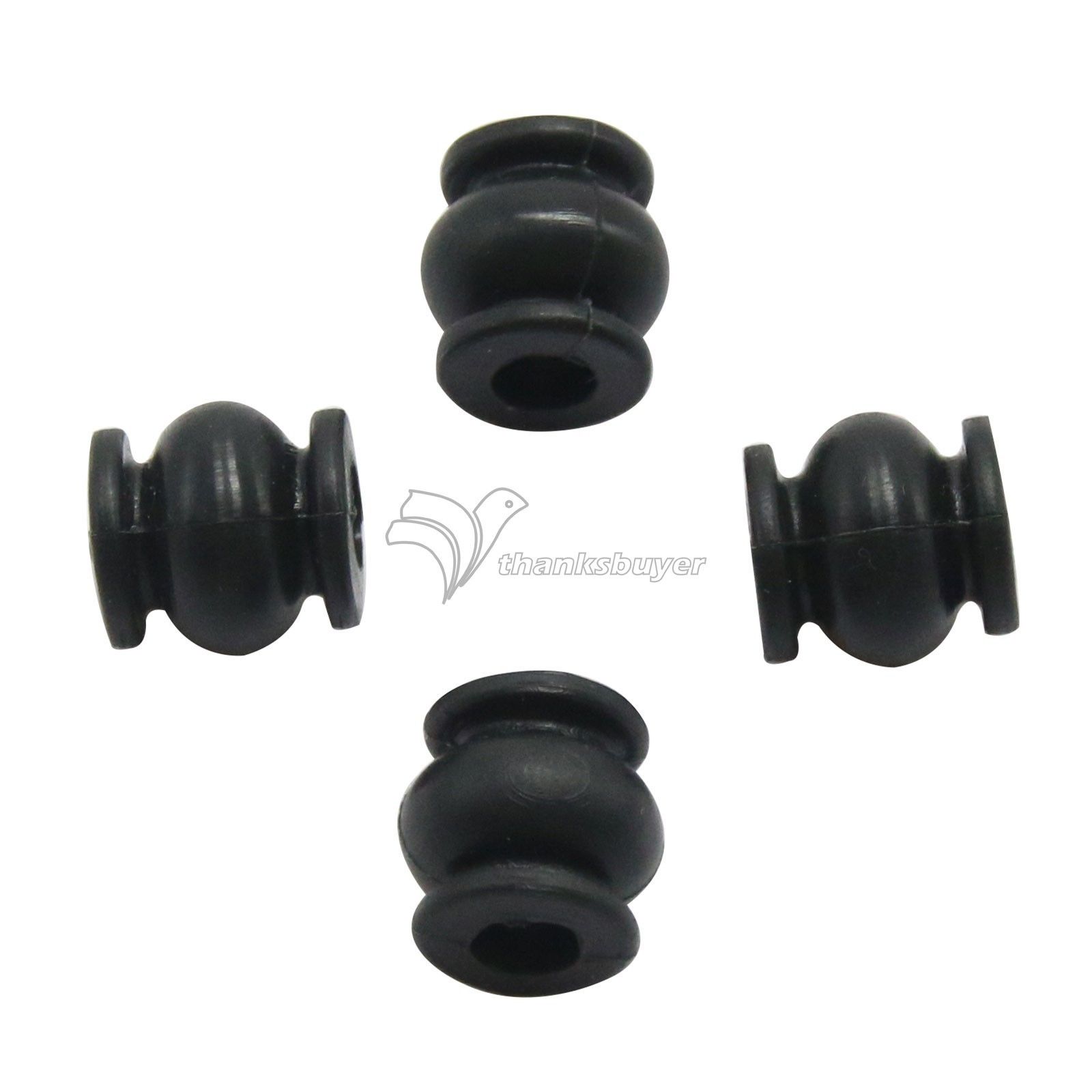

    4Pc Round Anti-vibration Rubber Damper Ball f/ Brushless Camera Gimbal FPV Black

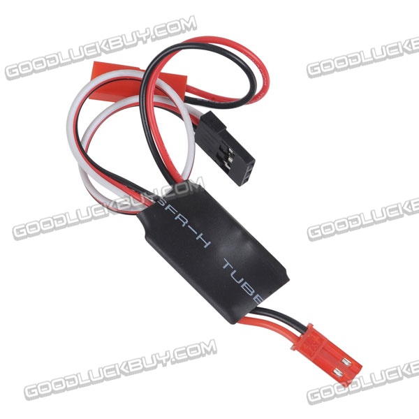

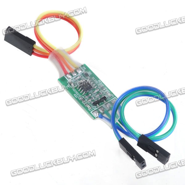

    DAL 2A Single Channel LED Light Controller Switch for RC Multicopter Night Flight

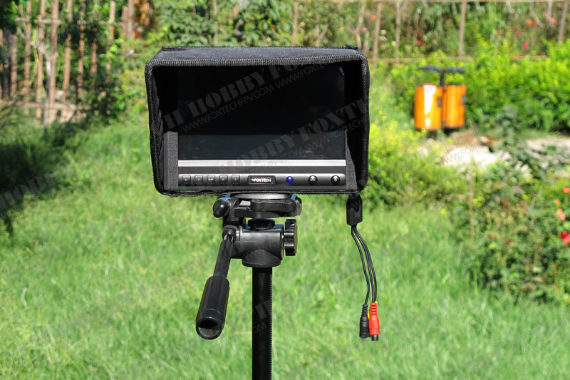

    Foxtech M800 8" monitor - 83$

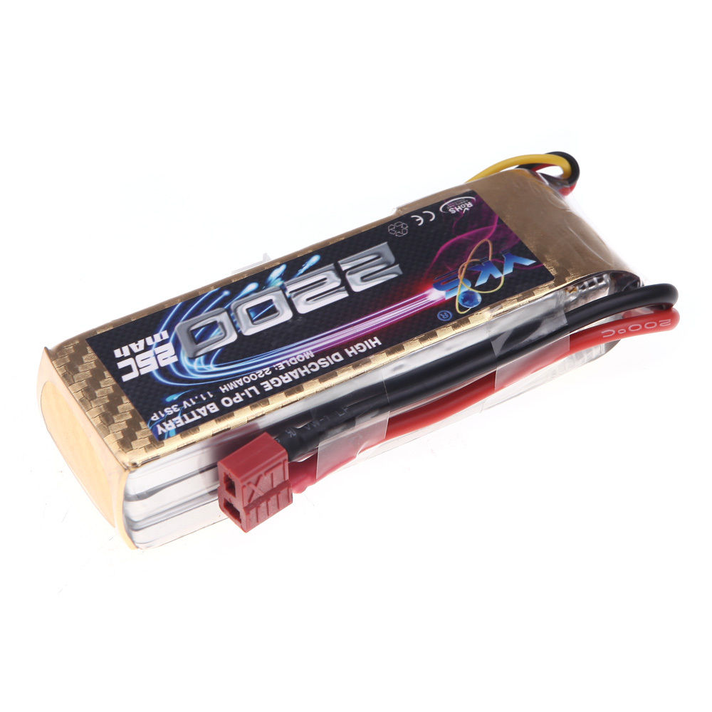

    YKS 11.1V 2200mah 25C Max 40C 3S Lipo Battery

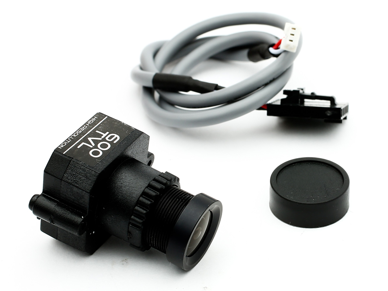

    Fatshark 600TVL CMOS V1 Fixed Mount FPV Camera NTSC PAL - 41.89$

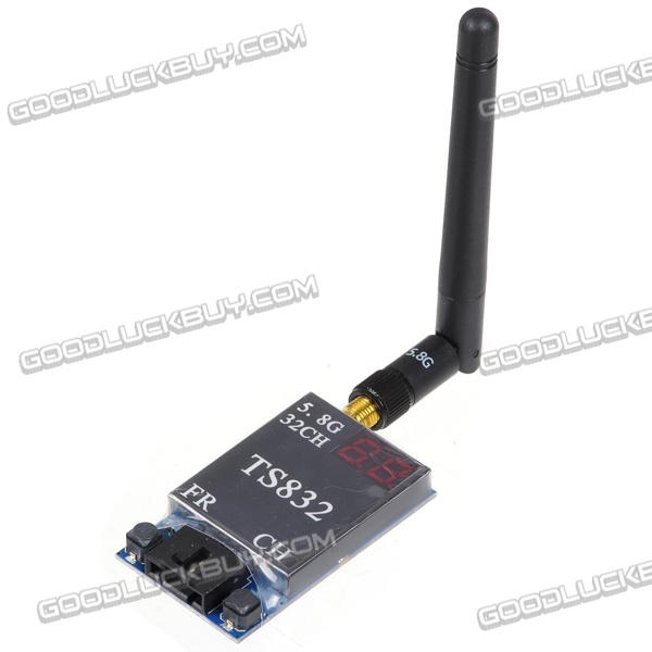

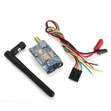

    FPV 5.8G 600mW 32CH A/V Transmitting (TX) Module TS832 RP-SMA - 34$

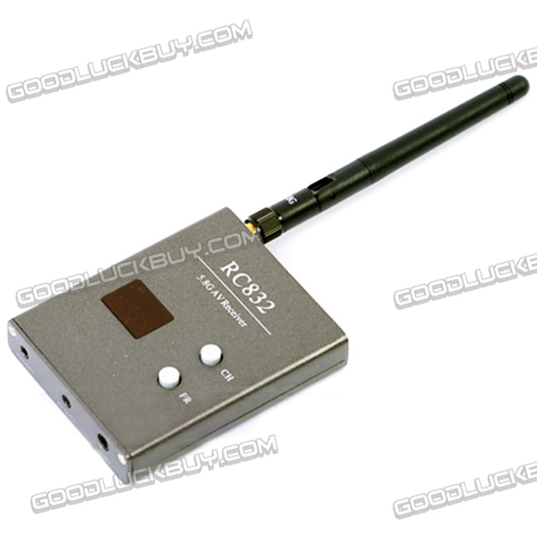

    FPV 5.8G 32CH A/V Receiver (RX) W/ LED Channel Display RC832 RP-SMA - 39$

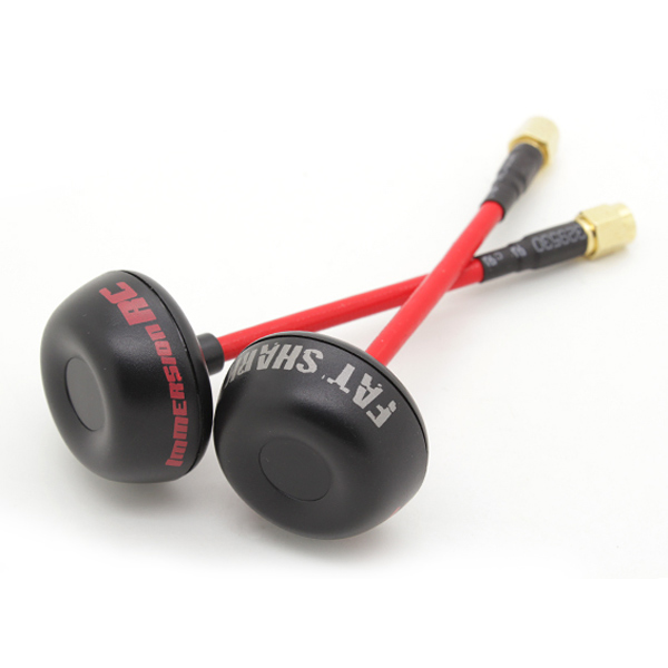

    Fatshark ImmersionRC SpiroNet 5.8GHz RHCP Antenna TX RX Set

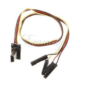

    TS832 Telemetry Transmitter Special Gopro AV Cable Power Cable DJI Phantom Vision Compatible

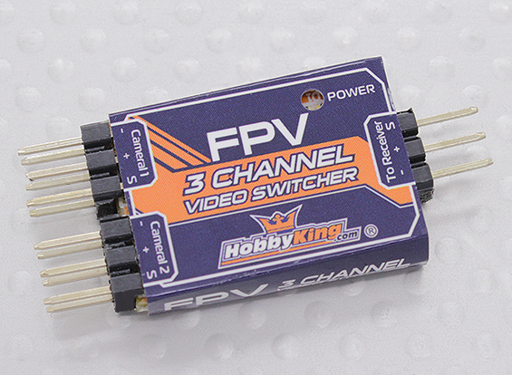

    Hobbyking 3-Channel FPV Video Switcher - 4.92$

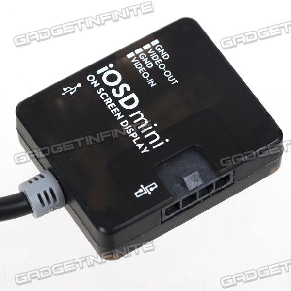

    DJI iOSD mini Module Naza-M Compatible - 58$
Name:	DJI-IOSD-Mini-BTU-Module-Built-in-Bluetooth-for-Wookong-M-NAZA-V2-Supporting-iPhone-iPad.jpg

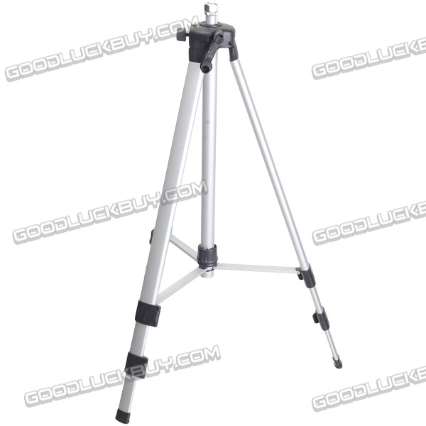

    FPV Ground Station Aluminum Retractable Tripod

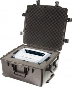

    מארז קשיח לרחפן + שלט + מסך FPV
    Pelican StormCase IM2875

    תשמע, מוריד את הכובע! לא אחד ה... אל הסטאפ הכי טוב ומושקע שראיתי ממתחיל בהתחשב בזה ששום חלק כמעט לא סטנדרטי, שאפו!!!
    אם היית מתייעץ שנייה לפני הייתי ממליץ על שלט מ-readymaderc, טיפה יותר זול מגיע יותר מהר.
    הימור גדול עם הפריים, שמתי עליו עיניים מזמן, למה רשמת 126$ ובלינק רשום 190$? בעיה גדולה של כל הפריימים האלו (גם המקורי) אלו הזרועות, ופתרת אותה יופי עם זרועות האלומיניום. יש רגליים דומות ב-Goodluckbuy בחצי מחיר, לא יודע לגבי האיכות ולא לגבי הרגליים לרגליים
    http://www.goodluckbuy.com/dji-f450-...ck-2-pack.html
    הבטריה, קצת לא ידועה (אולי חקרת), קצת יותר מדי C אולי וקצת כבדה אבל זה לא קריטי בסטאפ הזה, אלה אם אתה תתפרעה ועם המנועים הללו היא לא חזקה מספיק, בשיא יש לך סביב 8 קילו דחף על כלי של סביב 2 קילו - מפלצת!!!

    כדאי לך אולי להוסיף Alexmos 32 Mini במקום זה שמגיע, לא חיפשתי מאיפה, אפשר להוסיף אח"כ
    ** מצאתי את הפריים, נראה יותר טוב מהלינק ששמת!
    http://www.goodluckbuy.com/fpv-repti...bal-combo.html

    תיקנתי את הקישור לפריים.

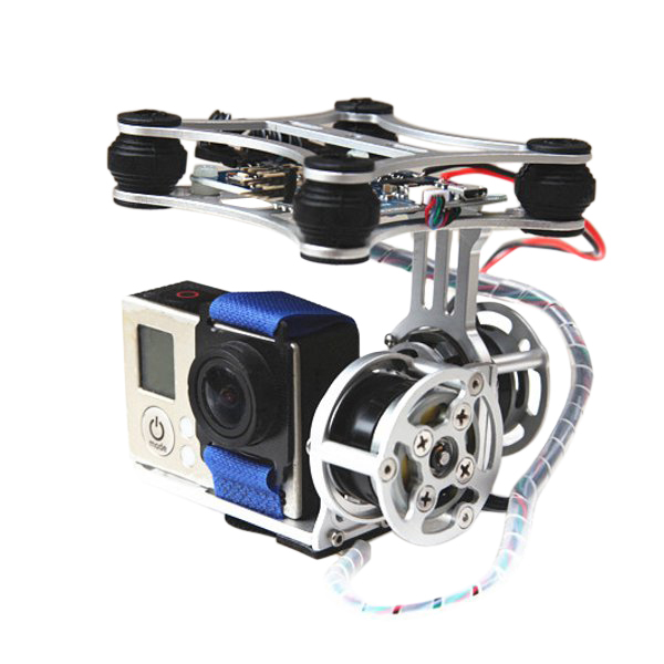

    לגבי בקר לגימבל. מה דעתך על זה..? 2-Axis Brushless Camera Gimbal Stabilization Control Board
    איזה לוח חלוקה אחר מומלץ יותר?
    לגבי הסוללה 4S, הכי זולה שמצאתי עם משלוח לארץ. אנסה אותה וארשום לגבי הביצועים שלה בהמשך.

    לי תמיד נראה שהסיכוך כבלים למרות שהוא יפה זה ביזבוז גרמים מיותרים.

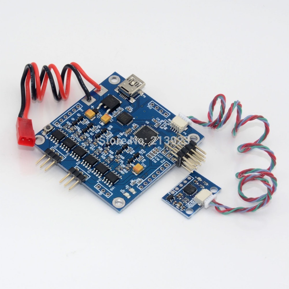

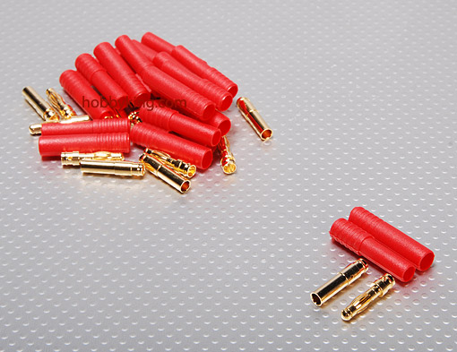

    מנועים מומלץ להלחים בשביל השקט הנפשי ולא מחברי bullet. נתקלתי גם בכאלו שעשרות בניות מאחוריהם שהתנתק להם המחבר בטיסה.
    זה לא מובן מתאור המוצר שאין בקר לגימבל.... אם אין, בטוח כדאי לך להוסיף את ה-32bit.
    אל תיקח את זה שרשמת מהוביקינג.
    הנה ה-32bit בזול מאד יחסית:
    http://www.aliexpress.com/item/NEWES...268711477.html
    הנה אחד קטן 8bit שאומרים שאפשר לשים עליו גרסה רשמית, למרות שמישהו מזהיר שם מלשים יותר מ-2S:
    http://www.goodluckbuy.com/hmbgc-mic...ware-v2-2.html
    זה 8Bit הכי זול ובטוח עם גרסה מקורית:
    http://www.goodluckbuy.com/bgc-3-1-m...st-sensor.html

    הזמנתי בקר לגימבל 8Bit נתחיל איתו נראה איך מתפקד.

    רכשתי gps tracker שיוצמד לרחפן במידה ויחליט להטיס את עצמו לייעד לא ידוע
Name:	2014-New-Arrival-TK102B-4-Band-GPS-Tracker-With-Car-charger-And-Battery-State-Tracker-For.jpg
    Mar 2015
    77
    ברירת מחדל תגובה: בניית רחפן FPV REPTILE 650mm Carbon Fiber
    איזה סים מומלץ ל gps tracker?

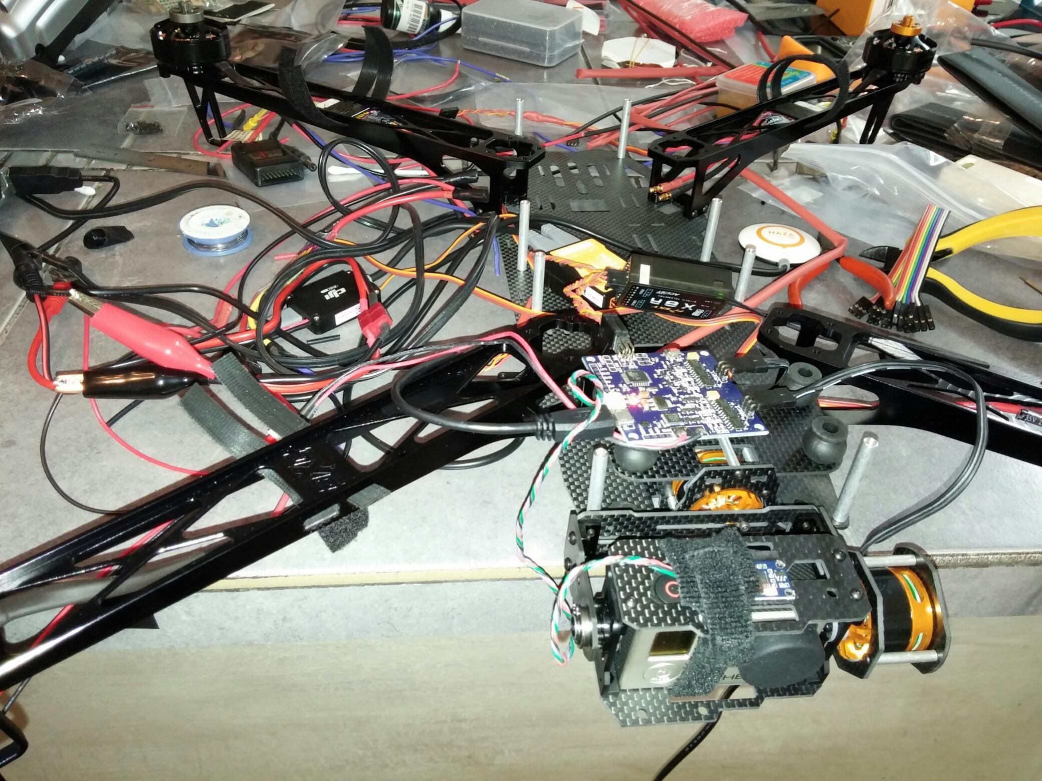

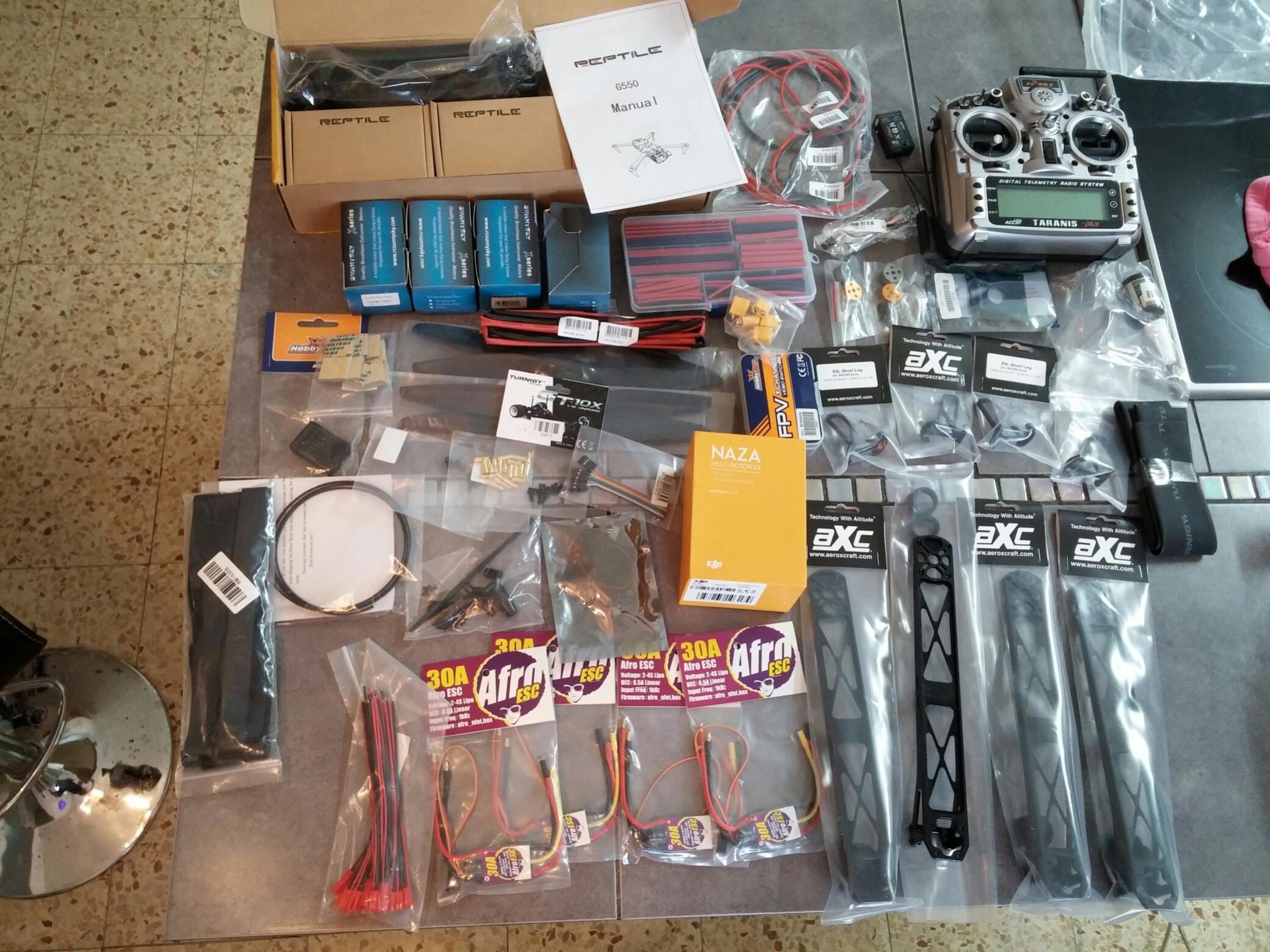

    הכל הגיע. לעבודה ..
ID:	122902 Click image for larger version.

    הגימבל הוגדר עובד יפה מאוד.
    לא מצליח להגדיר את האפשרות לשלוט מה terranis על ה pitch ו- roll של הגימבל.
    הגדרתי בשלט את ערוץ 5 ו-6 LS ו-RS על מנת שאוכל לשלוט על ה pitch ו- roll.
    חיברתי את ערוצים 5 ו-6 מהמקלט לקונטרולר של הגימבל. אך זה לא מגיב .
    יש הצעות?
    בשלט אני על Mode d16
    נערך לאחרונה על ידי liortt; 21-03-2015 בשעה 16:26:41.
    Sep 2012
    1,559
    93
    הודה 218 פעמים ב 170 הודעות
    תתחיל בלי הגימבל, יש לך עוד המון לפניו....
    הגדרת את הפרמטרים לשלט בתכנה של הגימבל? (תיזהר לא לשדרג אם זה לא גימבל שתומך גרסה מקורית)
    Mar 2015
    77
    כן הוגדר. אוליי בגלל שמחובר למקלט רק ג'מפר אחד (Mode d16)
    שאר הערוצים לא יעבדו כי הכל רץ ל naza בערוץ אחד..?

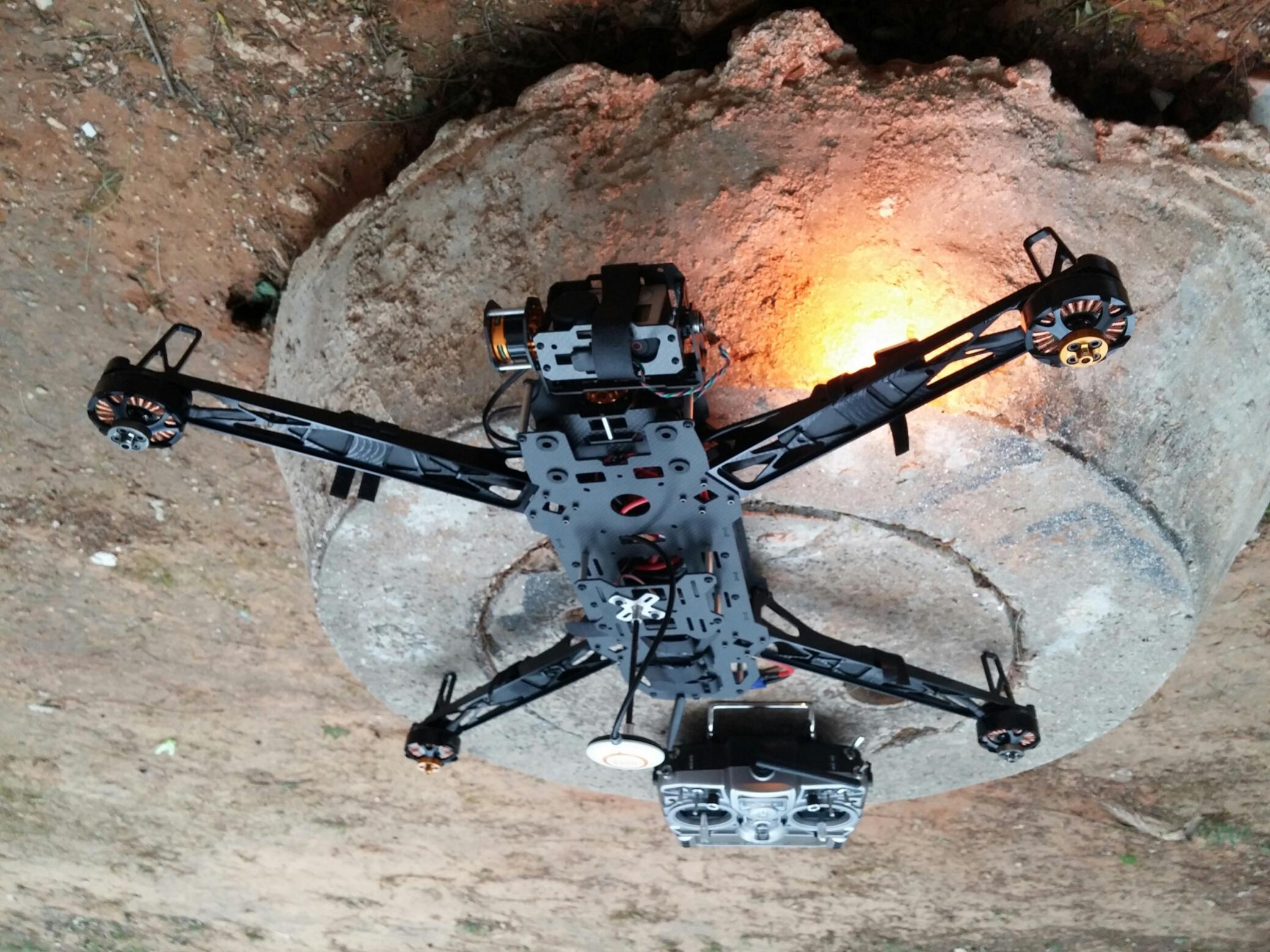

    Mar 2015
    77
    סוף סוף מוכן.. נראה אם יעלה לאוויר

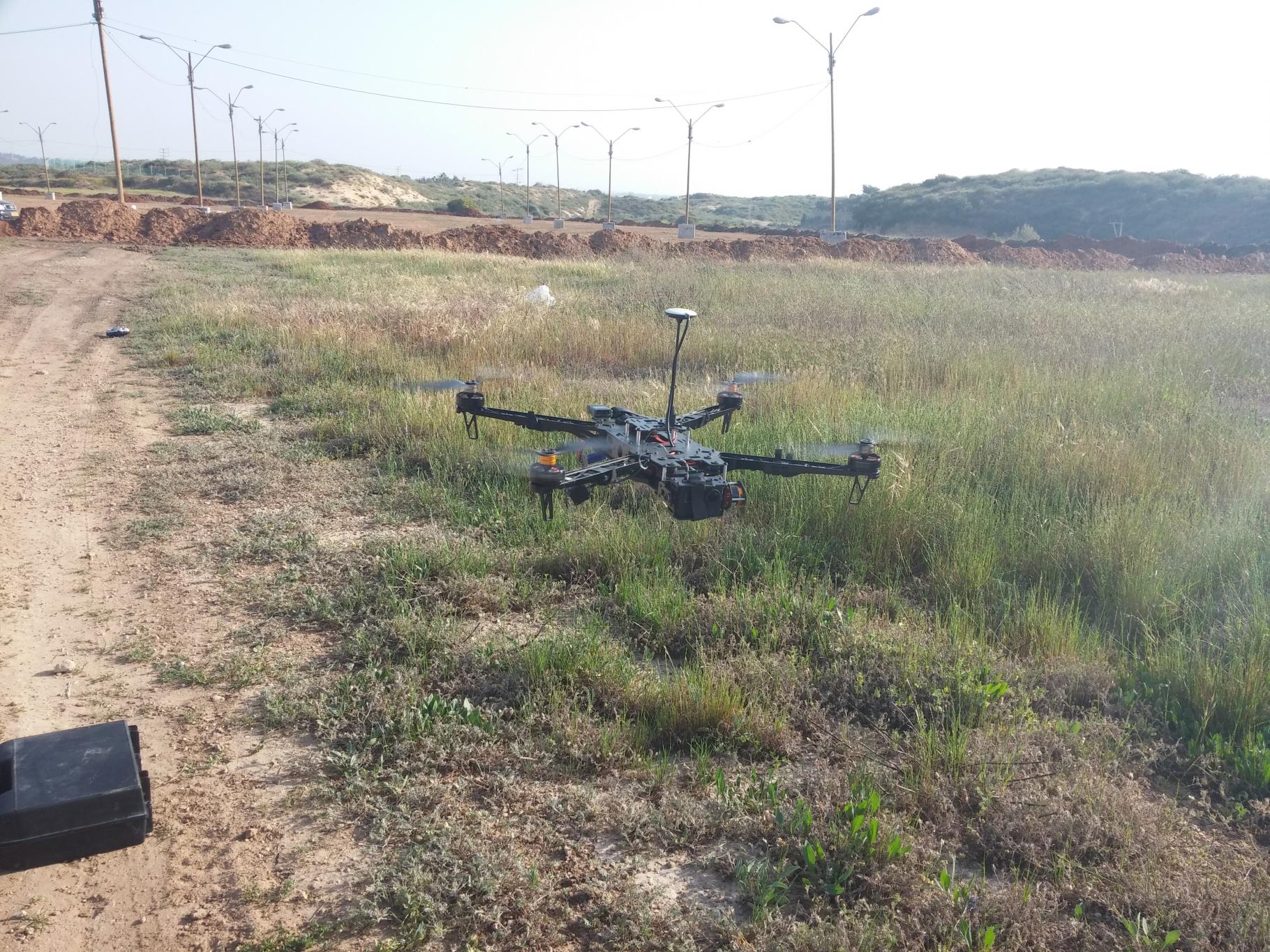

    Mar 2015
    77

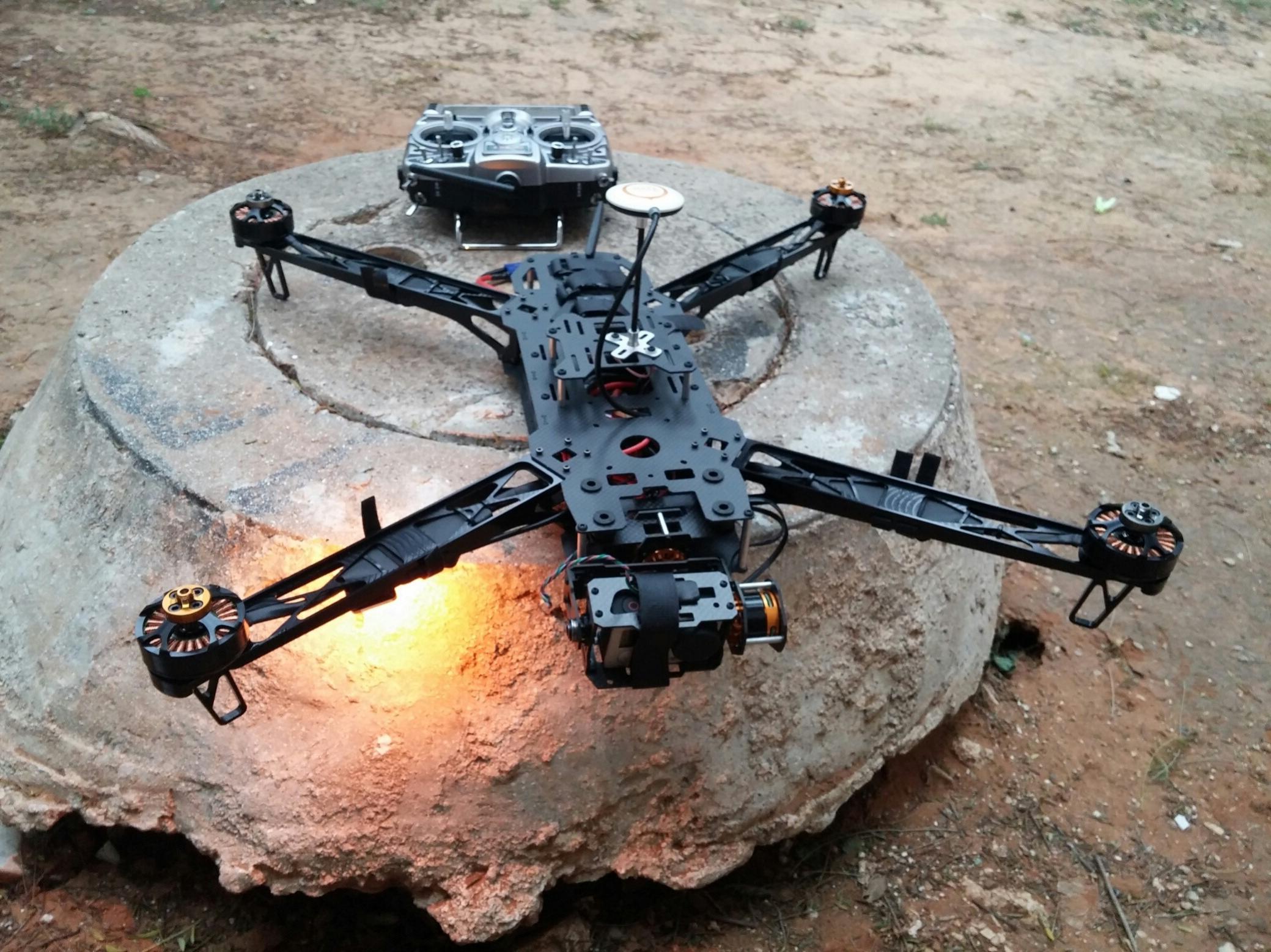

    הרחפן באויר
    נערך לאחרונה על ידי liortt; 30-03-2015 בשעה 22:11:33.

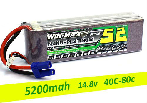

    הסוללות על הפנים בקושי מחזיקה 5 דק'
    Battery: Winmax 5200mAh 14.8V 80C MAX 4s Lipo Battery Pack - 2 * 33.90$
    יש המלצות?
    4S 5000ma
    Jan 2011
    חיפה עיר עם תחתית
    1,852
    392
    הודה 246 פעמים ב 191 הודעות
    הווידאו פרטי ...
    סוללה ממולצת לרחפן בגודל כזה:
    http://www.hobbyking.com/hobbyking/s...arehouse_.html
    (השתמשתי על רחפן TBS Discovery Pro בעקבות המלצה של חגי וגיא - מתאימה יופי ונותנת כ 9 דקות אם אני זוכר נכון)
    No good deed goes unpunished
  19. המשתמשים הבאים אמרו תודה לAmitB על הודעתו:
    guyst (30-03-2015)
  20. #19
    Sep 2012
    1,559
    93
    ציטוט נכתב במקור על ידי liortt צפיה בהודעה
    יש המלצות?
    4S 5000ma
    פרטים? מה המשקל המלא הכולל ?
    מתי ירדת עם הבטריה, מה הראה המד בלי עומס או עם עומס?
    מה עשית בטיסה?
    כמה הטעין המטען את הבטריה אחרי?
  21. #20
    Mar 2015
    77
    המשקל המלא כולל gopro
    2.1 קילו.
    היום הצלחתי להטיס 5 ד' לאחר טעינה מלאה.
    חייב לרכוש סוללות 7000 לפחות, איכותיות.

    Mar 2015
    77
    אתה בונה כזה? דומה?
    הנחיתה שלו מצויינת רכה.
    הייתה רוח באותו יום של הסרטון.. ריחף במקום בסדר גמור.
    הסטאפ מושלם רק כרגע צריך לשפר את נושא הסוללות.
    ייתכן ואצמיד לו 2 של 5000ma

    הורדתי את ה gopro החלפתי לפרופלורים 12x4.0" מעמיס פחות על הסוללה.
    באויר 10 דק' בקלות. יש שיפור
